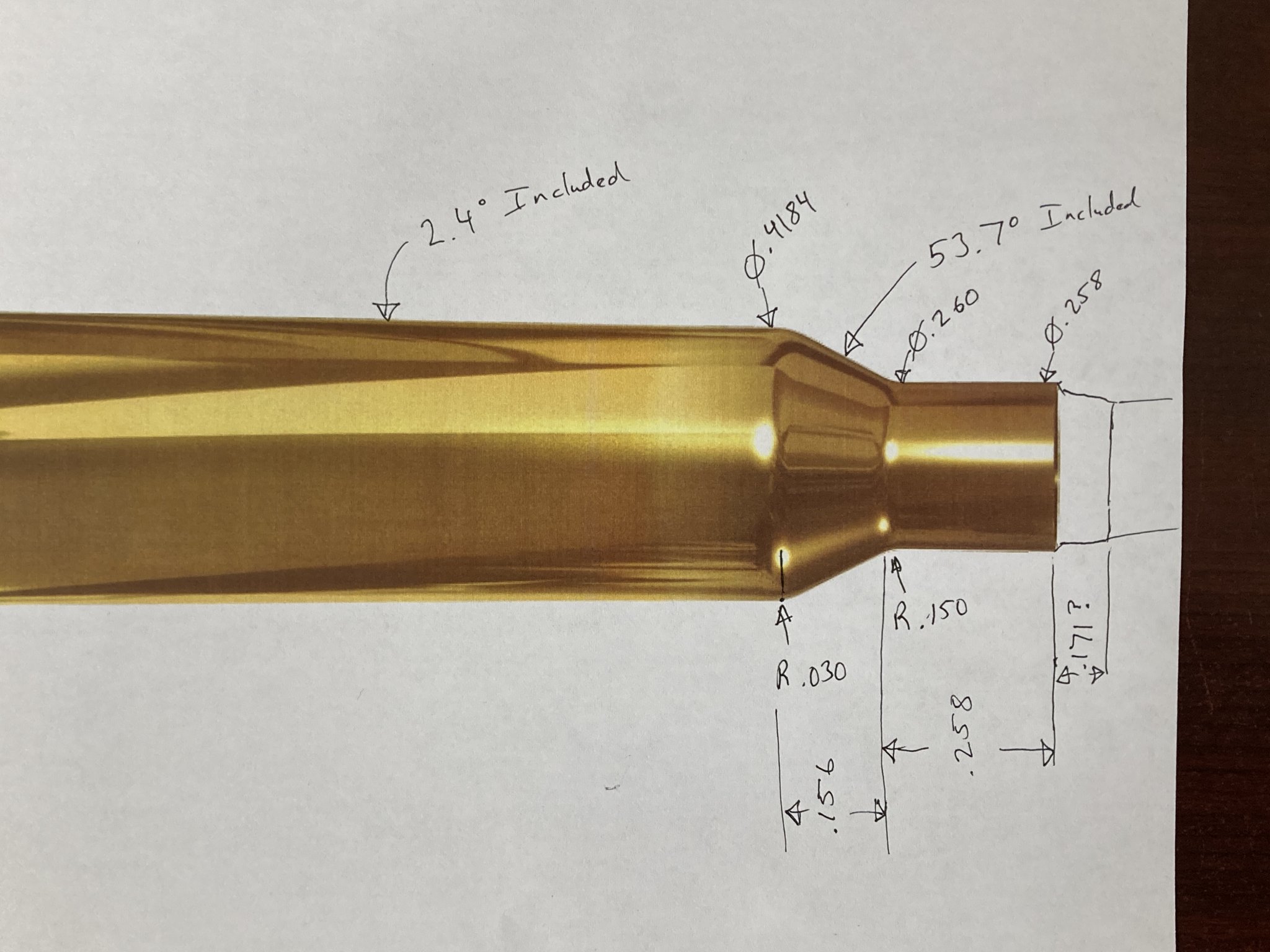

Local gun show today led me to these. They may work to size brass close enough to fire form. Talked with an older gentleman who has dies for 22 varminter as well. Hopefully one will turn out
Did you go to your gunsmith and see what he say's the cartridge actually is?
Don’t have a cartridge yet. Just the rough formed one from super annealing and closing the bolt. I was hoping this set of dies would work, but they are too long and don’t touch the neck of my 250 savage or 22-250 brass. One of the old guys I talked to today said that could be a possibility since some of the reamers made back in the day didn’t all match up.

It was not the standard 22/250 but was close. Smiths made up their own reamers in those days.
Different shoulder angles on most back in those days from what I have read. 22-250 made one common angle

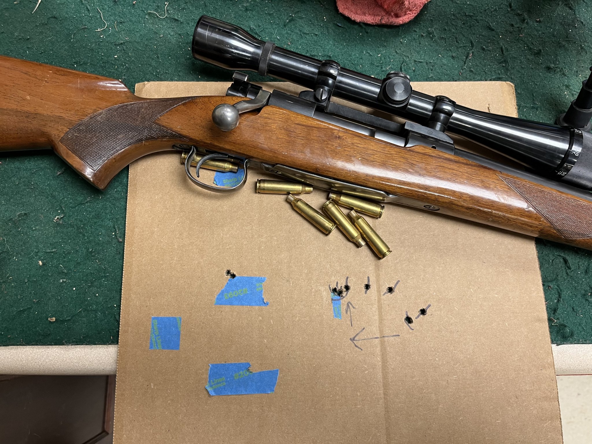

Sooooooooooo, let’s circle back around to this blaster. I got bored the other night and pulled a bullet from a 22-250 case, stuffed it into the “magazine” and closed the bolt. Left me dumbfounded cause the bolt closed on a 22-250 case where it had not before. So I repeated it and got the same results, two smashed primers and no hard to close bolt. Funny thing is if you just drop the round into the chamber, the bolt is very hard close though.

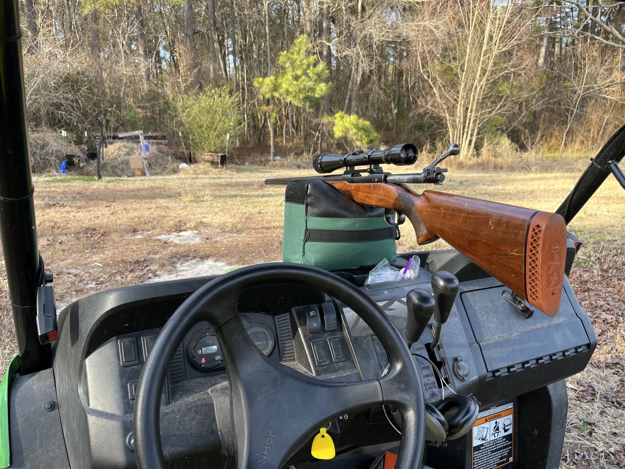

Fast forward to today, took a few 50g JHP bullets to the backyard blasting place. First trigger pull was a pucker factor of 2 million. Fired about 10 rounds through it today and it shot like a champ. I walked it into a rough zero and then stepped back to 50 yards. Zero is a tad high but should be close at 100, I will get there this week maybe if the weather cooperates.
A smooth shooting rifle and the trigger isn’t just absolutely atrocious. I believe the barrel has plenty of life left. I’ll dig the modified case up soon and check it out some more.
