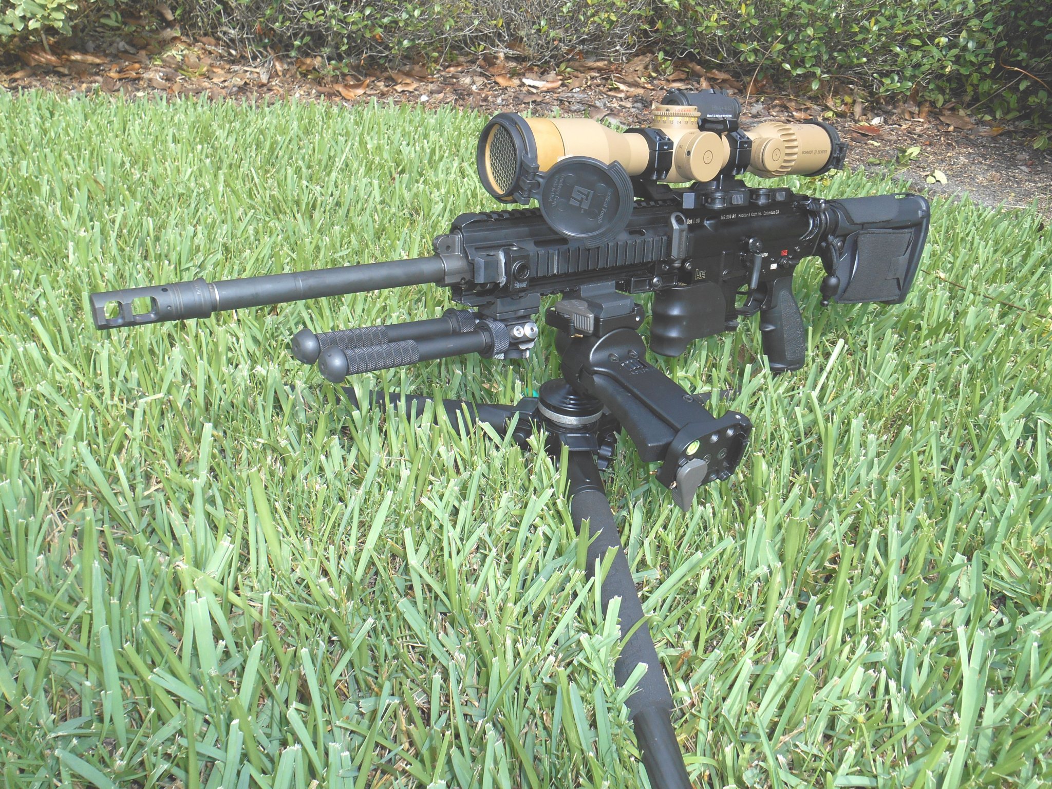

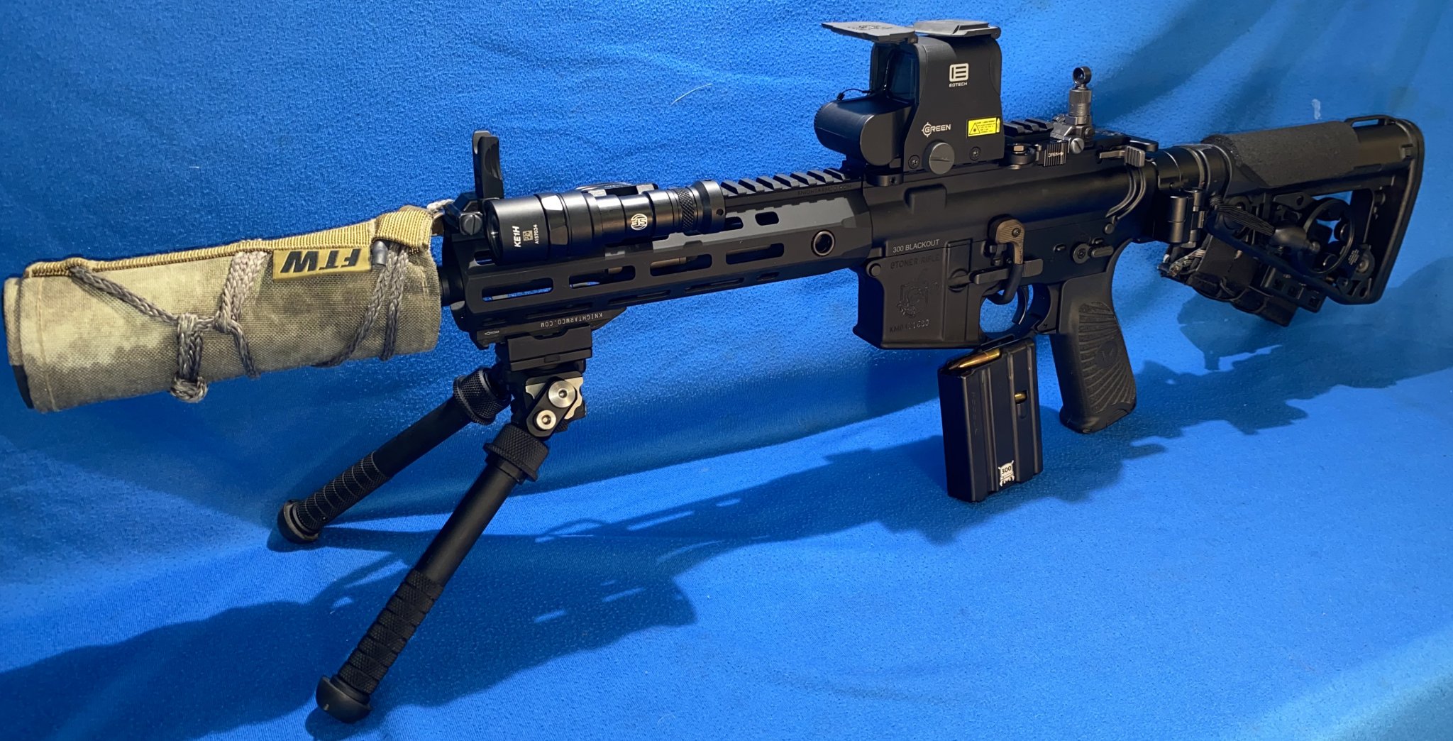

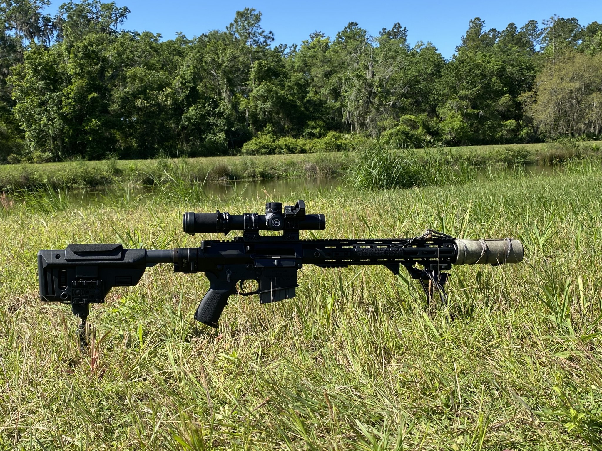

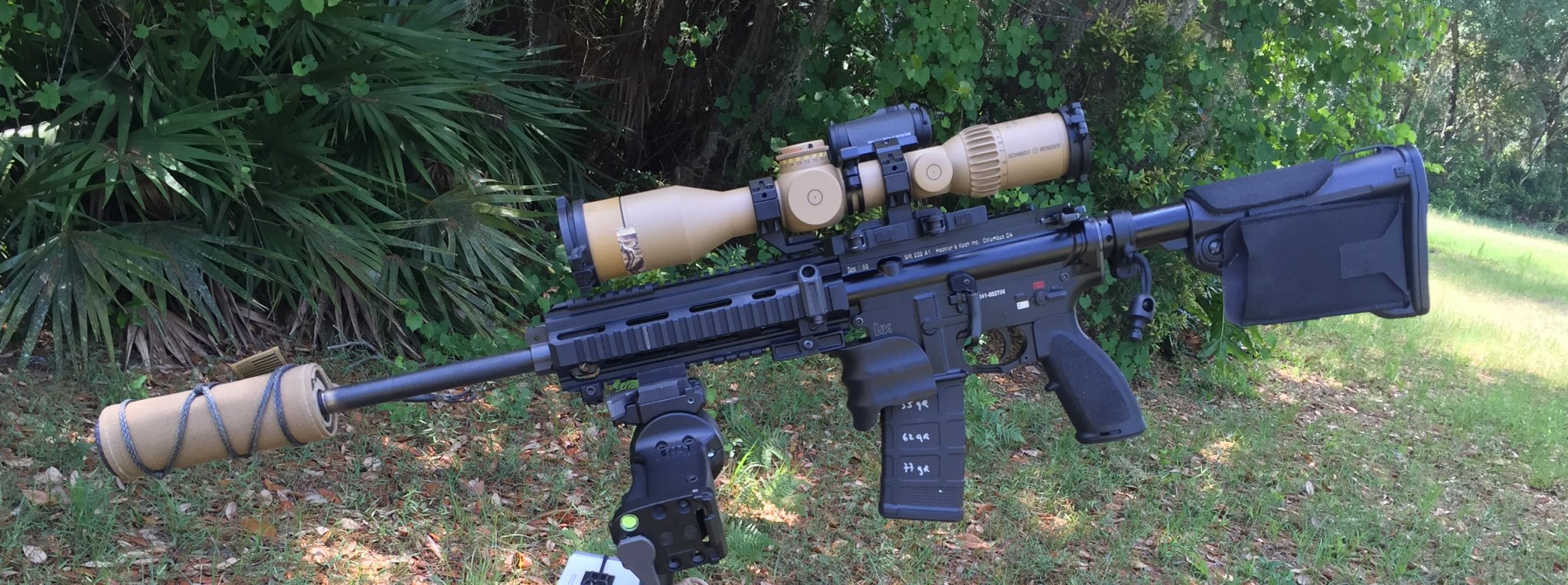

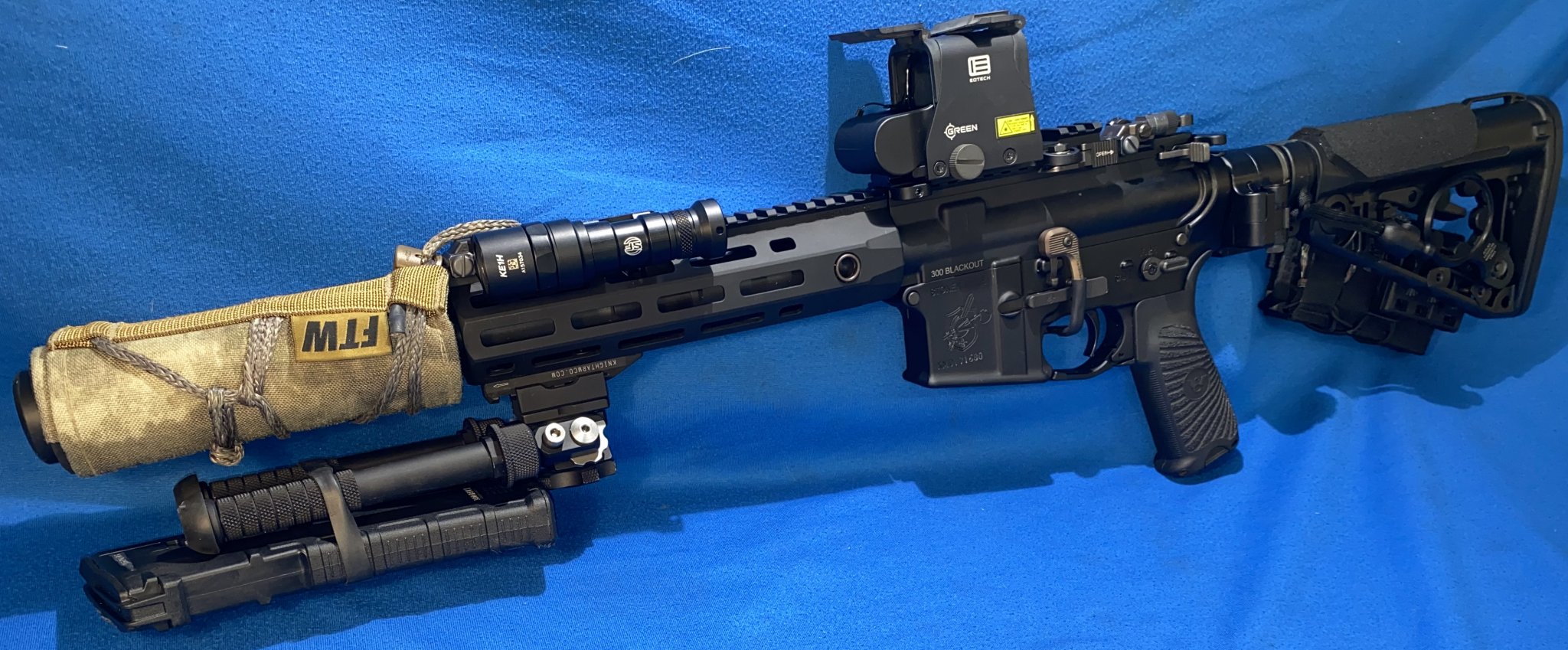

A few I shoot.
IMG_0182KAC SR-25 WITH SUPPRESSOR BLACK SCOPE & SLING RMR MOUNTED POOLSIDE 07.30.21 ANNOTATED ...jpg
IMG_2687Cracker Swamp KAC SR-25 6th Session 04.10.22 600 METERS CAMERA SHOT copy.jpg

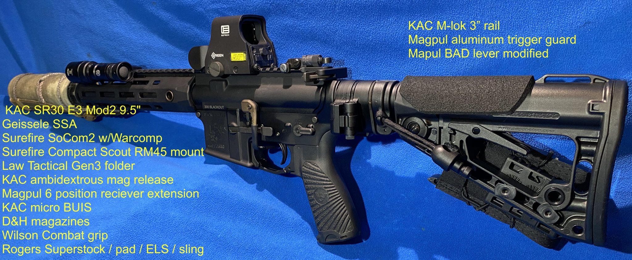

KAC 300 Blackout Eotech XPS2 with SurefireIMG_4499 copy Annotated Nov 2020 copy.jpg
