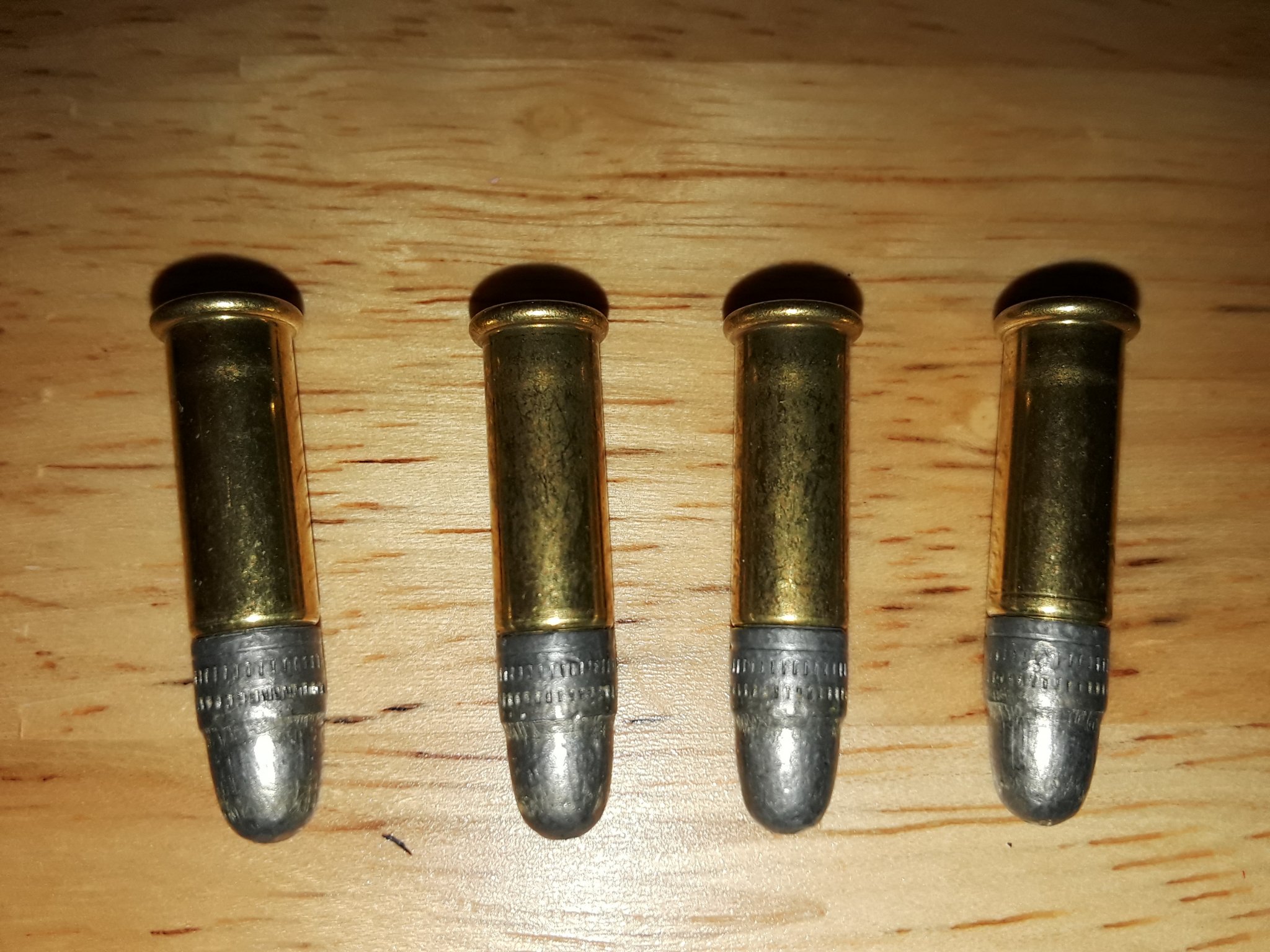

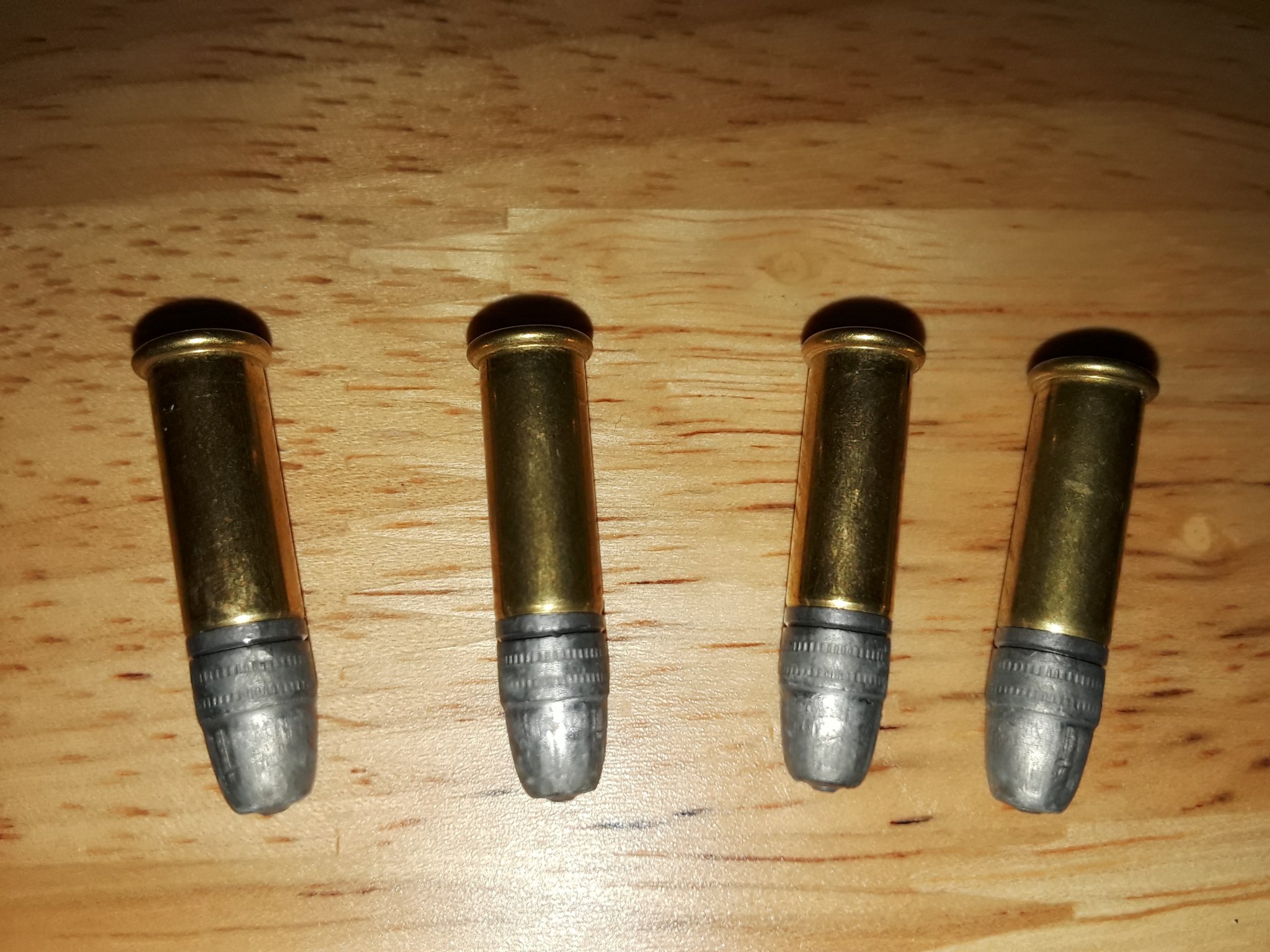

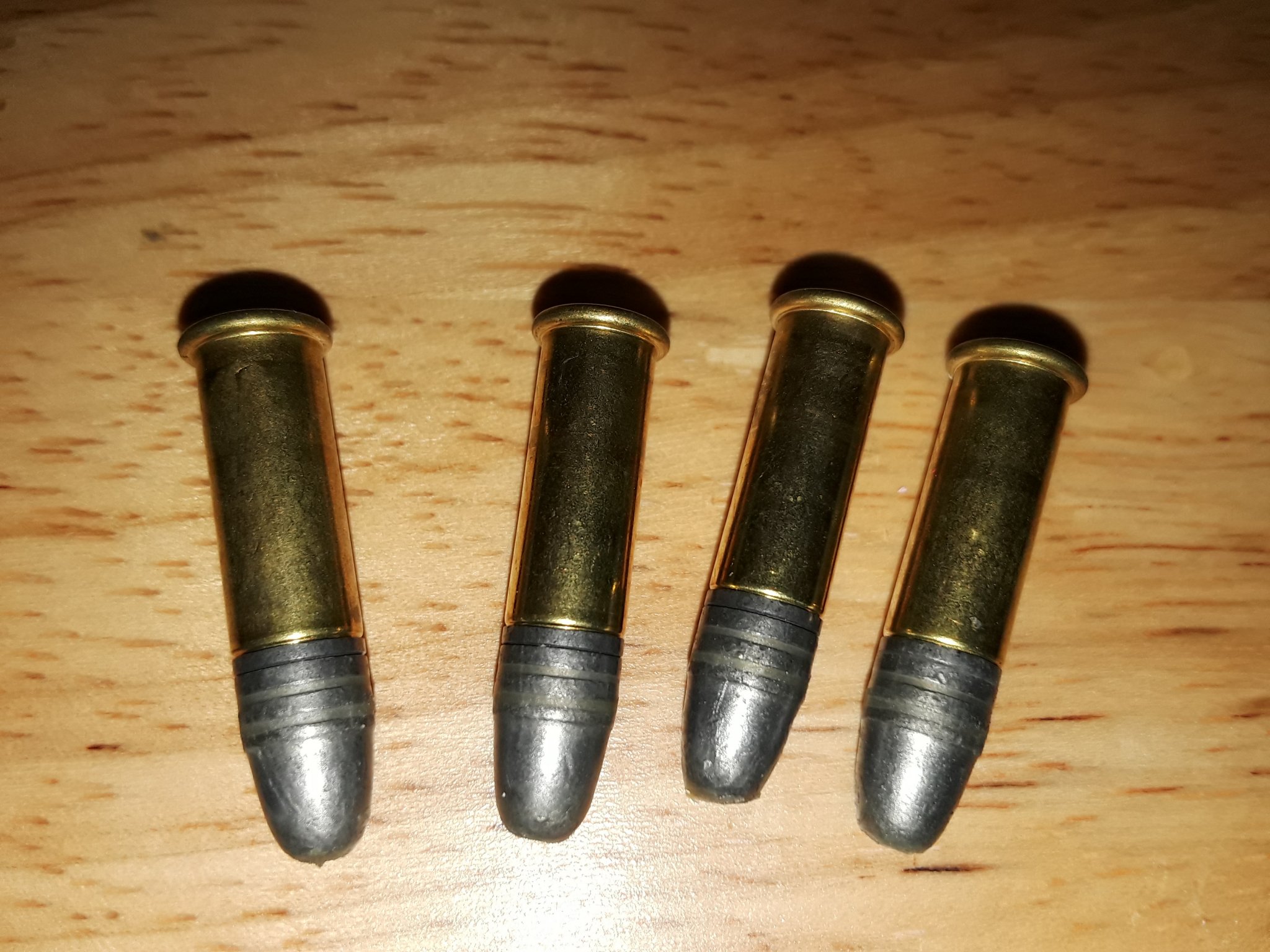

A continuation of the pics @justin amateur posted above...
Below are 3 brands of 40gr LRN. Which of the pics do you think match these 3 brands?
-Eley Match (black box)
-Geco Match
-Federal Auto Match (loose bulk pack)
Ball peen effect, canted shoulders says #1 is Fed.
Smooth round nose clean crimp shows #2 is an RWS product.
Dimple tip tells me #3 is Eley.
I've noticed some lots from Eley, the flat of the dimple isn't square to the centerline of the cartridges.
Those don't fly as consistently as those that are square.
Asymmetic projectiles don't track well.
Crap, I just realized, I didn't have to think about it.
I just knew. It's possible I've spent way too much time testing and inspecting rimfire ammo. ;)

Well you went 3 for 3 LoL, so you might be right. The Eley match has never performed for me, out of any of my 22s. The Geco IMO looks promising, will see on Sunday.
The Auto Match does have a slight ball peen effect, but they are fairly consistent IMO.
One small concern and maybe the photo is to blame, but the rightmost Geco bullet looks "off-center" to my eyes...
Y'er probably right about the Geco, OS.
Not a surprise.
It's not top of the RWS line, so you will find a few cartridge defects and mv spread.
For short range, 50 yards or less, it'll do.
Watch the Eley Match. Those non-square tips are going to pop a few strays.
for me right now sk red box match is giving me the really nice 10 shot groups at 100 yards so did the sk 100 yard off white match , cci standards and the mini mags the eley tenex had higher sd's than the sk at 16.3 but the smallest ten shot group of the bunch . I want to try them further at 200 yards next . good luck in finding what your gun shoots the best .

OS, look at pic 1, the Feds, those skirts, the back edge of the bullet at the crimp,
they're canted, not square to the center line of the cartridges.
Those are going to be subject to tipping as they exit the muzzle.
Uneven pressure release is going to result in trajectory spread.

I do see the bullet is slightly canted on the feds.
Interesting. When I have a bit more time I am going to sample another lot.
It doesn't take much of a defect to cause strays.
At short range, time of flight doesn't allow any atmospheric interaction
so you won't see much in the way of effects.
By the time you hit 35 yards, the defect caused spread has been amplified to where it's results are easily seen.
At 50 yards they show up as outlying strays.
Get in the habit of inspecting before chambering, it explains y'er results.
What you thought was your fault is probably ammo related.

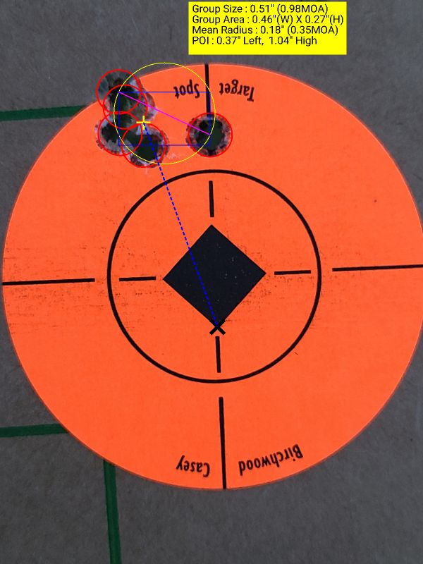

I shot this 5 shot Automatch group this evening through the Bergara. It isn't as accurate as SK Standard but I'm pretty happy for the price paid.
