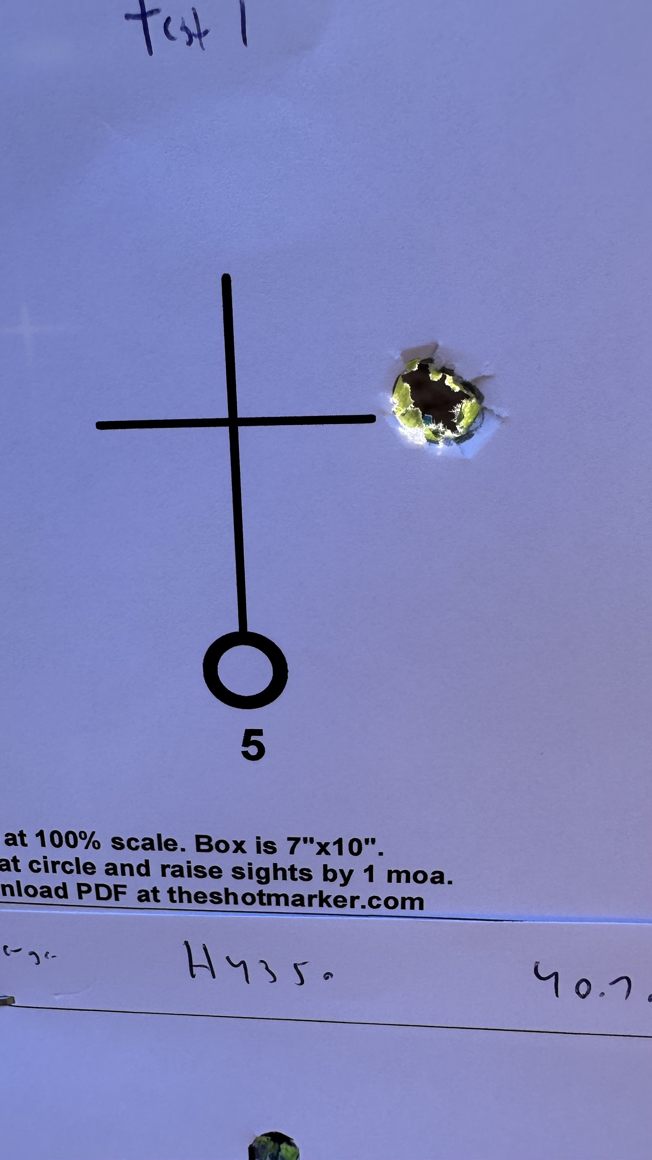

Just got an Osprey prefit in .223 Wlyde, .062 freebore, .750 taperless.
I broke it in with cheap 55gr. fmj ammo and it did not particurly like it, hovered around 1.5-2" groups. About 100 rounds in I finally fed it some handloads and it perked right up. Just a load I threw together with no work up. Looks like it will hunt. This mirrors my experience with my 6mm Osprey, great accuracy in that one too.
Hornday 68 gr BTHP
25.0 grains of Varget
Nosler brass
CCI-BR4
5 round group
20 round group

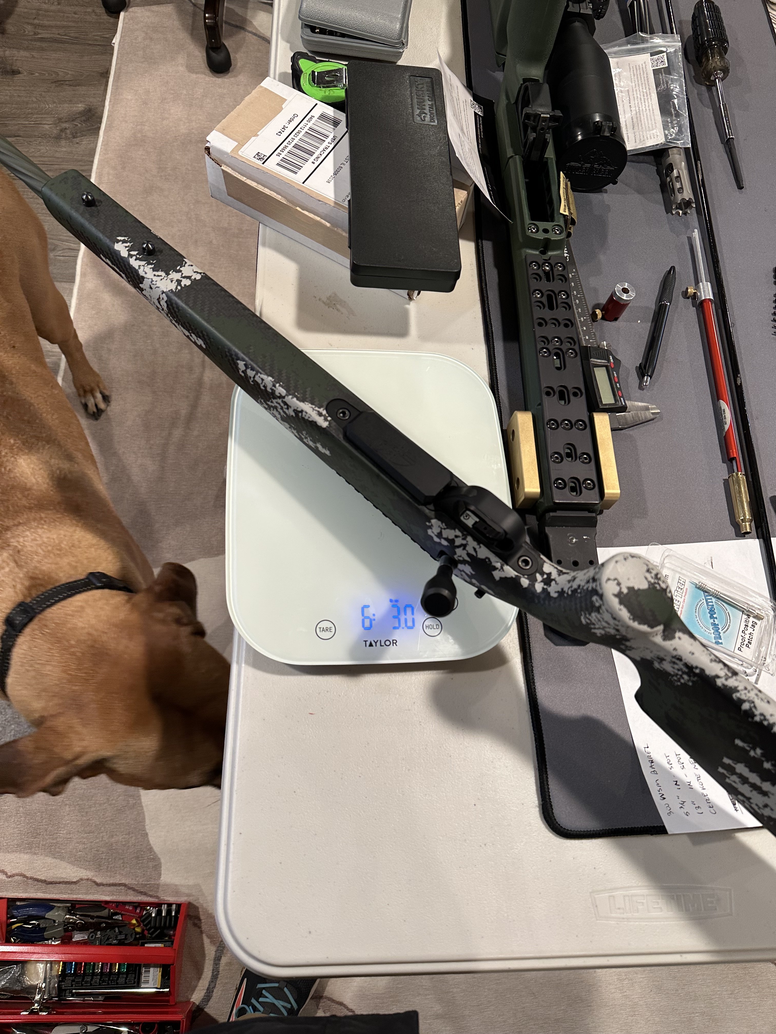

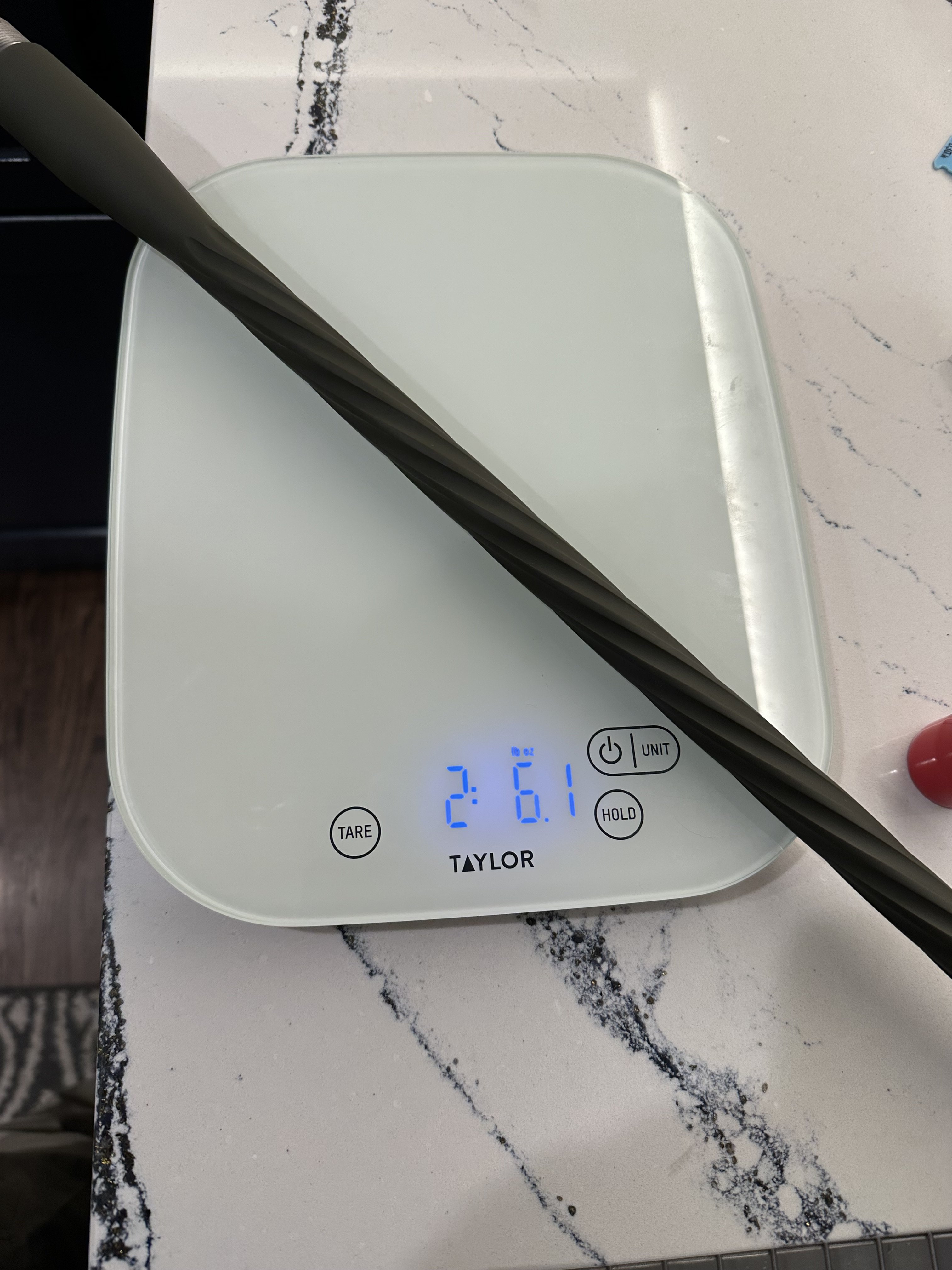

Did you weigh that 20” spiral fluted barrel before mounting it? Looks like a perfect size for a suppressed set up. What can is that?
Chose a 6CM PVA prefit for my Tikka hunting rifle I'm building because of this thread. Should have it within the next few weeks I imagine. I'll only be shooting factory ammo through it but I'm also not looking for uber-precision. Just functional hunting rifle precision like a 20 round group under 1.5 MOA or something.

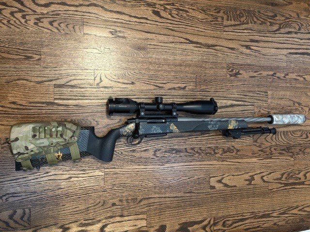

I did, its actually 18" and weighs 38.5 oz on my scale. The can is a Thunderbeast Ultra 7.
I think its great hunting profile. To compare, I took off an unfluted 18" Prefered Barrel Blanks #2 Sporter in 6.5 CM that weighed in at 46.4 oz. So in the barrel swap I saved about 8 oz for the same length barrel in a smaller caliber.
Reactions: KYAggie
I thought that looked a little short for a 20”, I’m not sure where I got the idea it was that long. That barrel hammers. I have a 20” 300WSM of the same profile and flutes showing up this week for my short action Origin. I have high hopes for it. What stock is that? I have Peak 44 Bastion for mine, although I’ll likely put it in my weighted KRG-b for breaking and load development. Why bench a 8# gun when you can make it a 12# gun for testing.
Reactions: santee116
Its a Stocky's VG2, I really like the ergos on it, its been a great stock. I actually have a Peak Bastion on my Tikka, great stock as well.

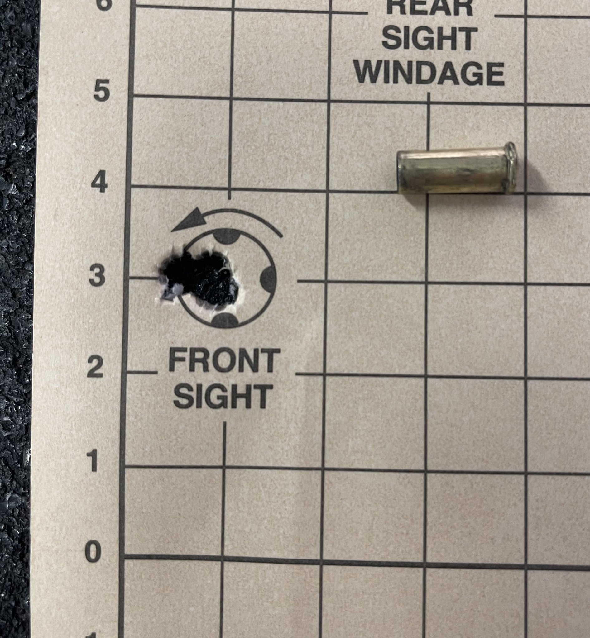

Adding to an old thread.
Got a PVA 6mm barrel. Sent it to be chambered in 6GT. So far I’ve shot 45 rounds through it.
This is the best 5 group it’s shot so far, and the best group I’ve ever shot period!!!View attachment 8648502
I was able to get basically the same grouping with 107 SMK FGMM ammo, but nothing else would group that well from a factory ammo perspective with my PVA heavy contour BBL (which PVA is looking at for me - granted, I haven't heard anything back from them). Edit: heard back from them today and they had to re-ream the throat… all good and being returned. I somehow doubt you’d see that kind of service for anybody else so quickly.
That said, the CF Bull 6 Creed they spun up for me shoots most factory ammo pretty well, and some factory ammo REALLY well, and also shoots my 107SMK bullets through the same hole...

That’s great to hear. CS is so important nowadays, good to hear that they are on it.
I forgot to put in my post, that 5 shot group was 0.142” and is Factory Hornady 109 😳
I can’t wait to handload this!!!!

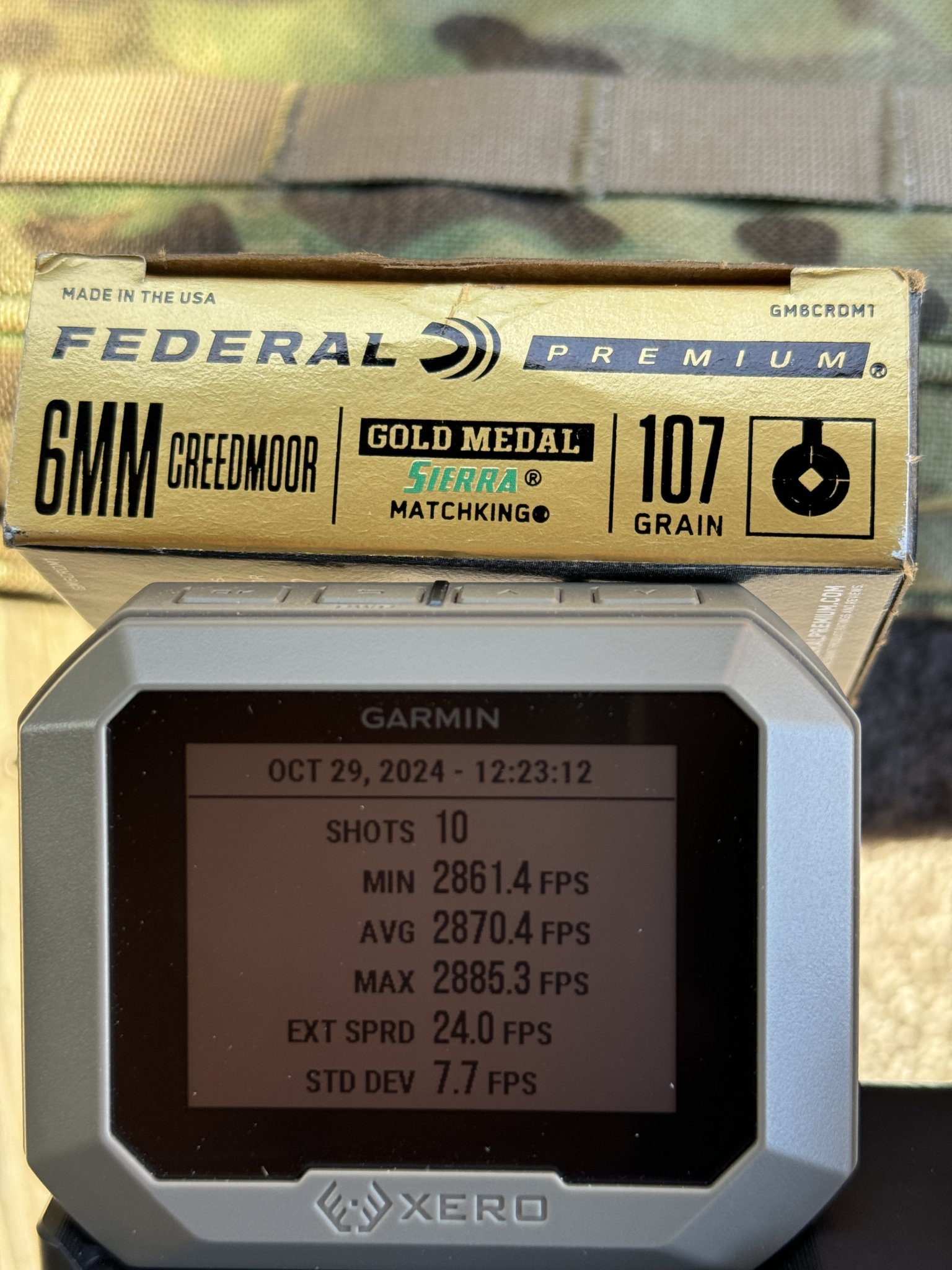

My best 5 shot group at 100 yards with a PVA prefit. 6.5cm with about 1400 rounds on it. It’s always been a tack driver and still is. 2400 rounds now and checked zero before my match this Saturday and shot a group not much bigger. Have a 6BRA barrel coming tomorrow from him and have no doubt what it will be capable of!
5 shots? Damn dude... want a job test shooting barrels for us?
Is that the steel barrel we just returned?
Yep, but the only thing I could get to shoot extremely well in that barrel were 107 SMK. It would not shoot any other factory ammo really well like that… and specifically that’s 107SMK in the lower node.
Any other bullet it would shoot OK (1 inch or slightly larger), but it would not group like that. When I say I tried other factory ammunition, I tried every other available factory ammunition, and none of them would group like that.
It’s just kind of weird, and it’s not something I’ve experienced before. Usually, you’ll find at least two or three specific bullets and factory ammo that will have really good SDs… and sometimes crappy SDs, but they’ll still group surprisingly well.

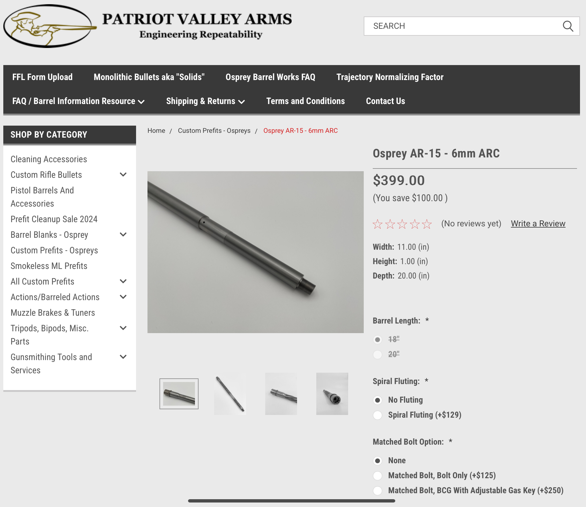

AR15 barrels: We just finished up a batch of AR barrels (I apologize for how long it took us)
We have 223 Wyldes in the usual 16/18/20 and we added 16" with Intermediate length gas (using the Noveske spec IM). I didn't make a ton of those so we could see how they would sell, but we do have about 2 dozen available currently.
223 Wylde
22 ARC
6mm ARC

Took the 6arc out today, I was able to put 10 rounds to the same hole with 108 ELDM.
Unfortunately, I don’t have a lot of 6ARC right now, and I’m waiting for the AR 15 6ARC from PVA to arrive….
