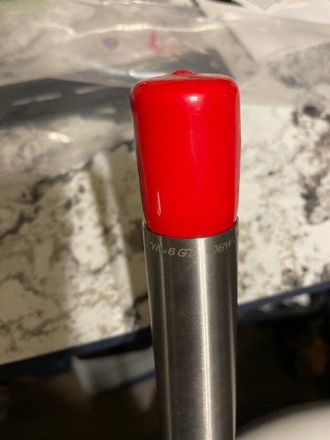

I got a 223 barrel from the CDM prefit sale they had earlier this year. 24" M24 contour with no fluting or threading. After break-in according to their instructions, it shot a 0.320 MOA 4 round group at 100 yards (the fifth shot was off but I know that was me...last round of the day and I hurried the trigger pull). This was using Sierra 77gr "Competition" factory rounds. Ruger American action on an MDT Oryx chassis. Planning on shooting it out to 550 yards this week. Super happy with the results!
It should shoot well past the 550. You shooting it at Woody's?

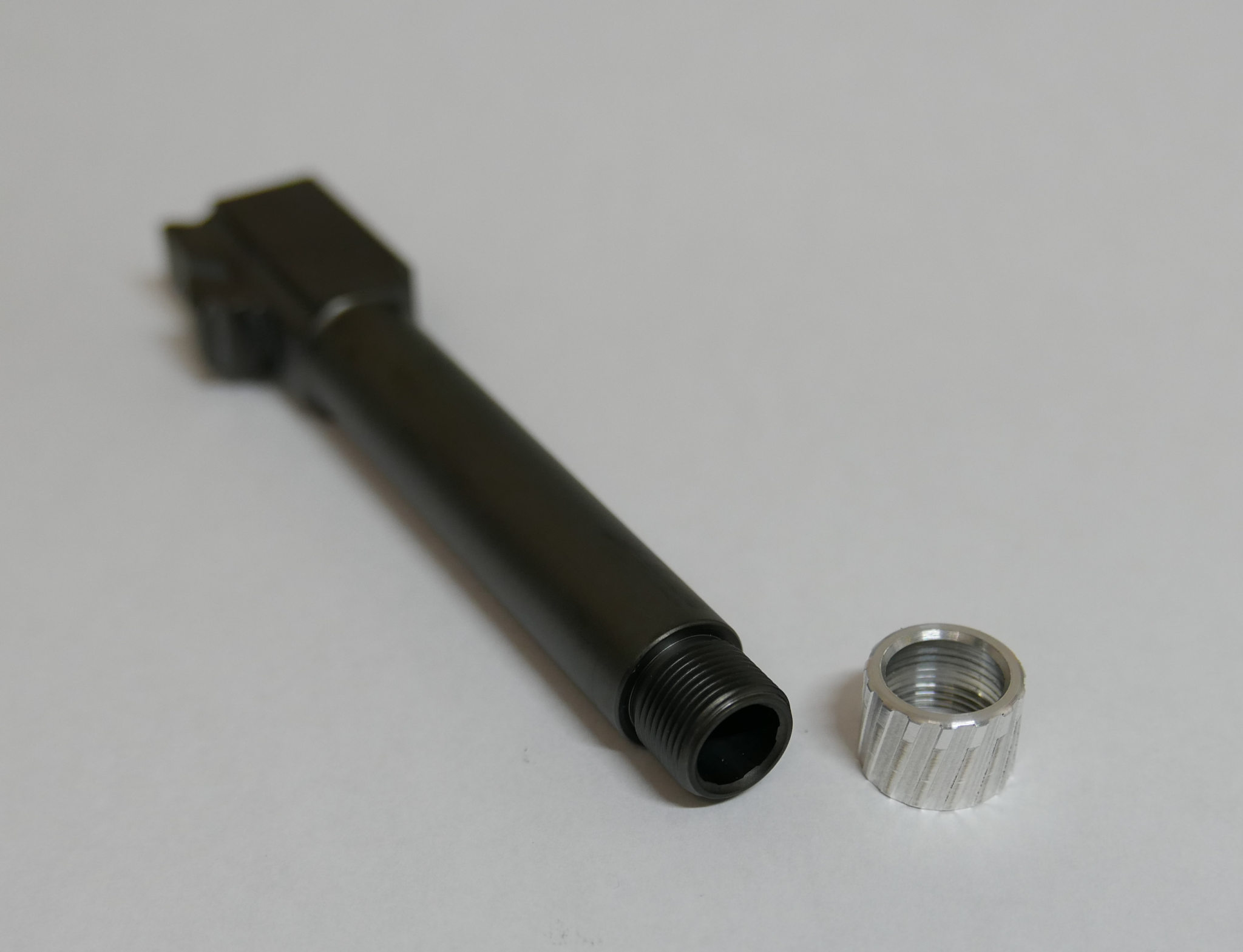

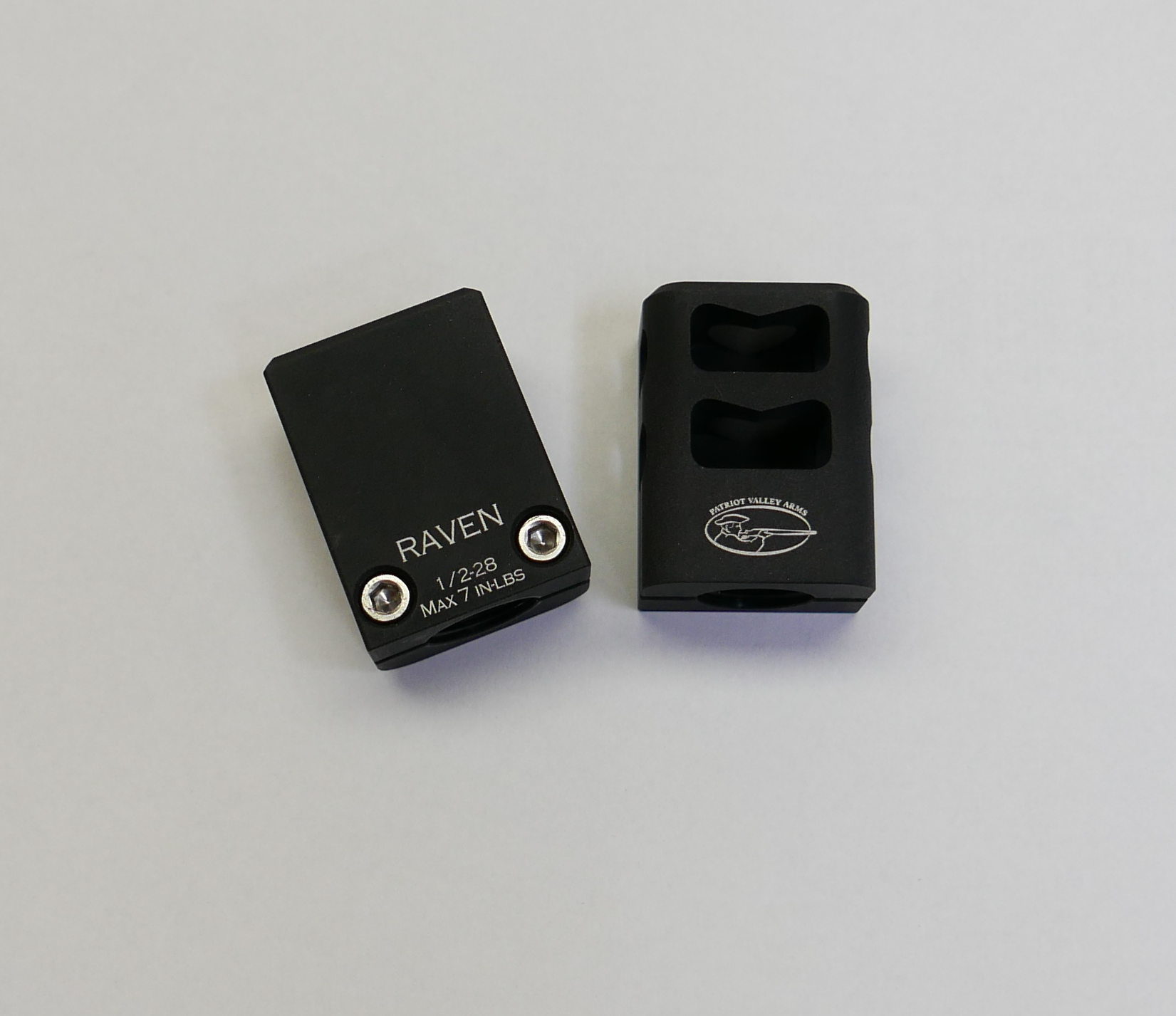

There doesn't seem to be a sidearms area on this place any longer, so this seems like the best spot to announce these.

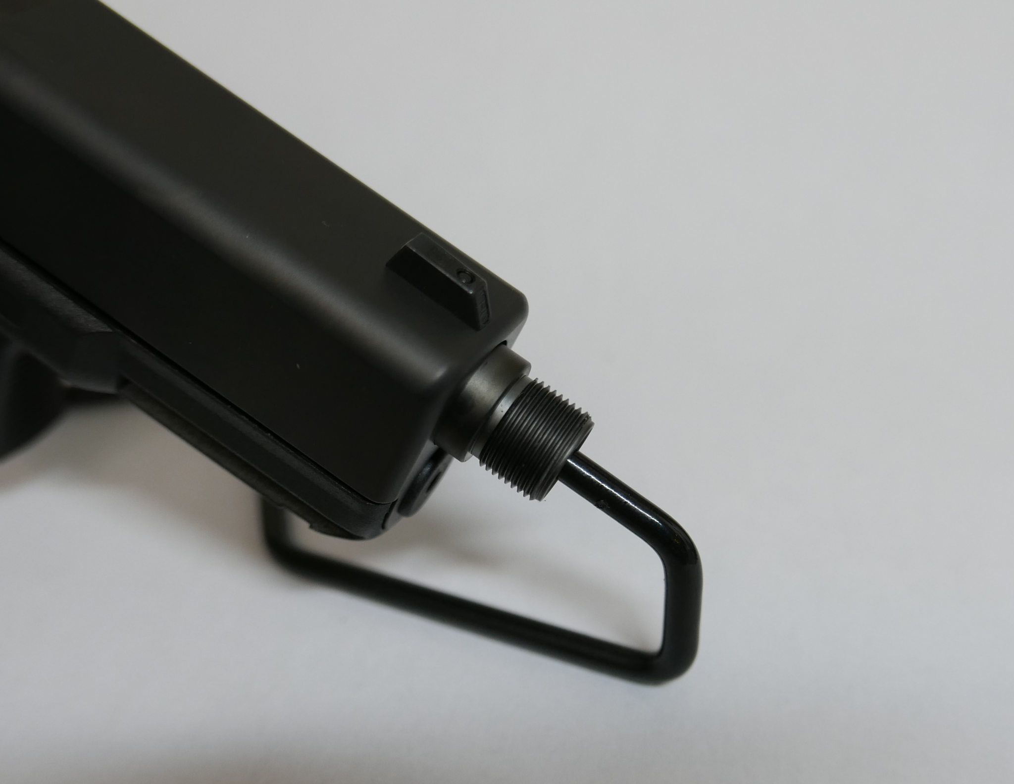

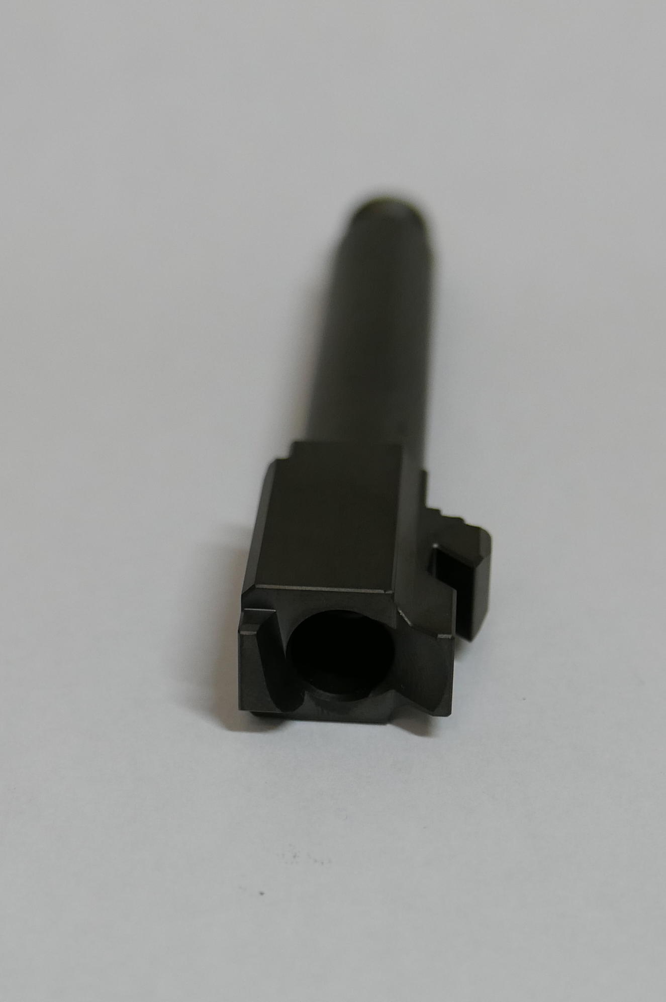

PVA is using precision rifle grade blanks and leveraging the CNC capabilities that we have to bring high end, conventionally rifled, drop-in Glock barrels... "prefits" if you will.
Threaded 1/2-28 Class 3A, 416RR and DLC coated as standard. These are not just another white-label from the big house in Florida that makes most of the other Glock barrels on the market.
PVA's using precision rifle level blanks to make pistol barrels. Ready to ship, endorsed by Olympic Pistol Shooters.
Here's a 5% HIDE Member code for these too "GlockHIDE24" The intro price is 10% off retail and the HIDE code will give you another 5 until the first batch of production runs out. These are in stock and ship immediately. Other models are coming shortly, we're running them in batches by model and sending them to DLC.

Well shit you have done several of my other barrels and I was thinking of a Glock 19.
Looks great Josh. Any other model Glock barrels in the works?
17's are at plating, we have 26's and 43/43x in surface prep now and those will go to plating as soon as the 17's come back. I have a small batch of 45 and 48 that just started in the machine. It's a pretty work and cash intense process so we decided to roll them out as soon as they're ready instead of waiting to do all the models at once.
You know you need one... and you won't see a better price than the 10% at launch plus 5% for Hide members ;-)
