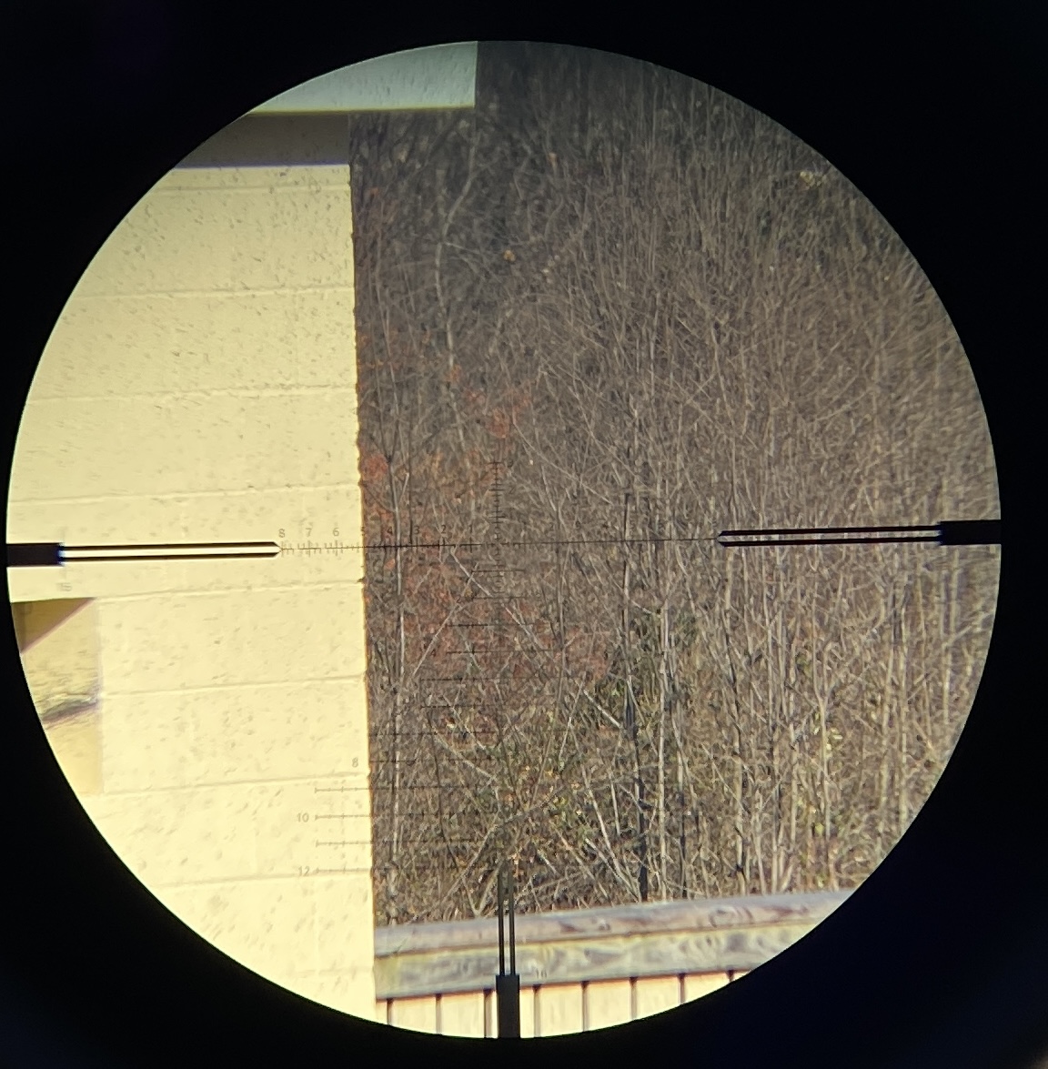

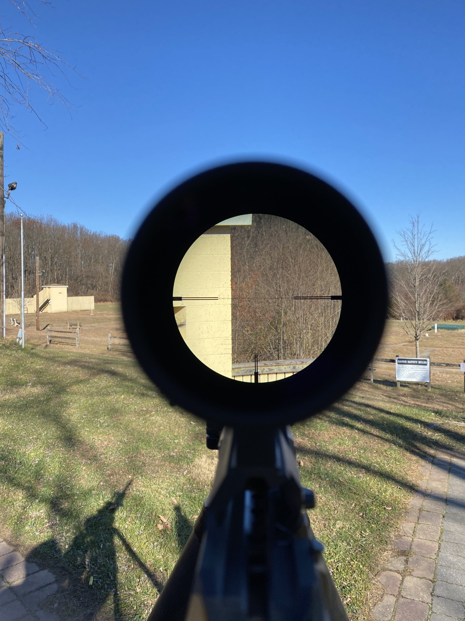

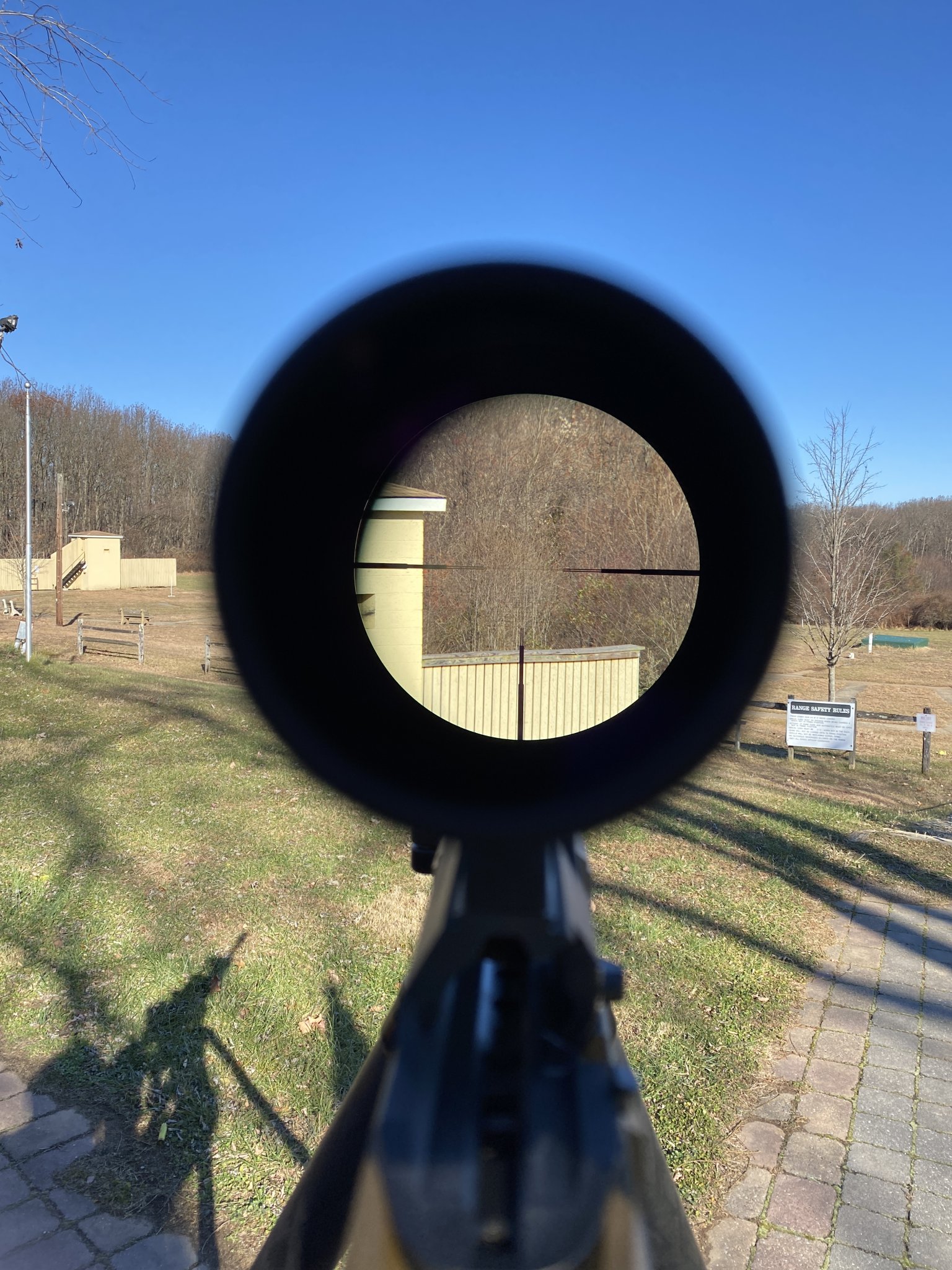

So I did pictures through the S5, an S&B 5-25 (PM II), 4-16 (ultra clear), and 5-20 (ultra short).
The S5 and the classic PM II are on par with each other.
What really surprised me was that the ultra clear at magnification had some purple on the edges that was very noticeable. Don’t get me wrong, the picture was very clean, just the ultra clear glass was not as nice as the S5 subjectively due to the CA. Which makes me wanna try the S5 scope with the lower magnification… especially given that the 4-16x56 ultra clear is a big scope.
The 5-20x56 ultra short at full magnification did not have as nice picture as the S5.
It was definitely easier to get clean pictures through the Schmidt and bender 5-25x56 PM II.
However, the eye box was much more forgiving on the S5, even though the eye relief on both scopes is the same according to the manuals.
I did find that both of the 5-25 scopes appear to have comparable glass.

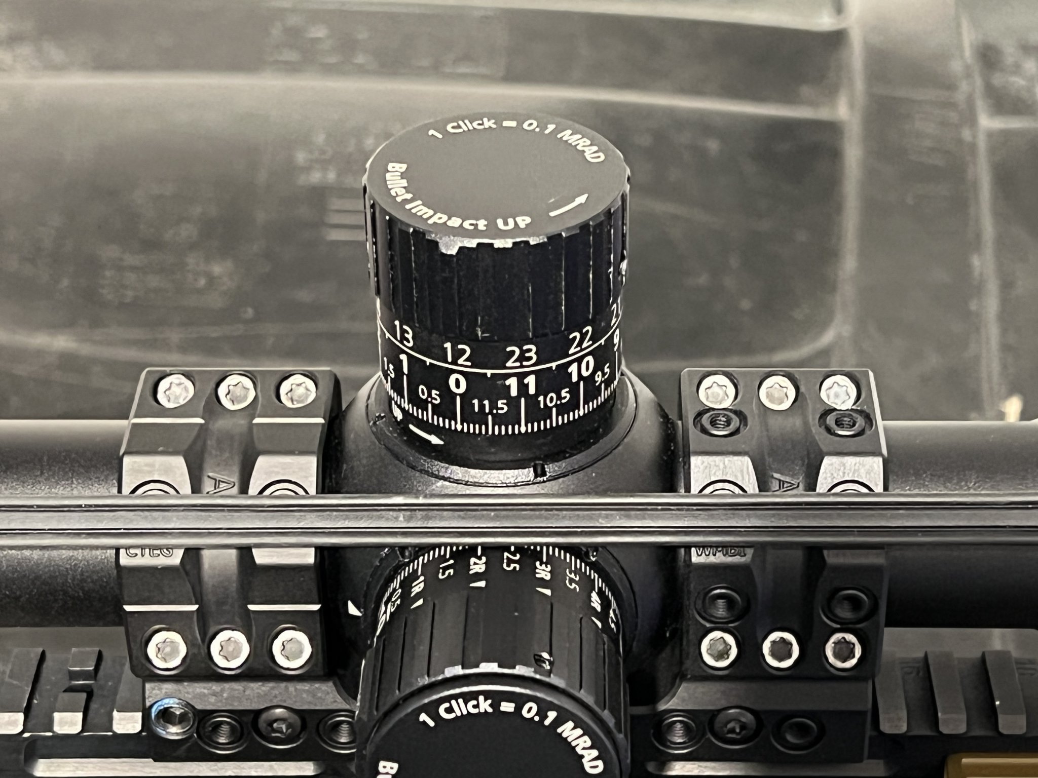

can you guys describe the turrets?
I have been told that’s a little
But of a let down. Only complaint I have been seeing though is that they are large.
I don't know how the turrets could possibly be considered a letdown?
Real nice feel and every mil has a "more tactile click". Having felt them all, I think the Zeiss and Tangent have the best feel, and the MTC is noticeable and awesome.
I have a video I posted in a thread I made over the LRP, if you can't find it let me know and I can link it.
Reactions: Mrhyne and lash
Yeah, I echo Tyler's comments. The only issue with the turrets is the sheer size. The actual function is very good, very distinct tactile click. Not spongy at all.
Some people get stuck on the turret having 12 mils instead of 10 mils per rotation but that really is a personal thing and several high end scopes don't have 10 mils per revolution anyway so 🤷‍♂️.

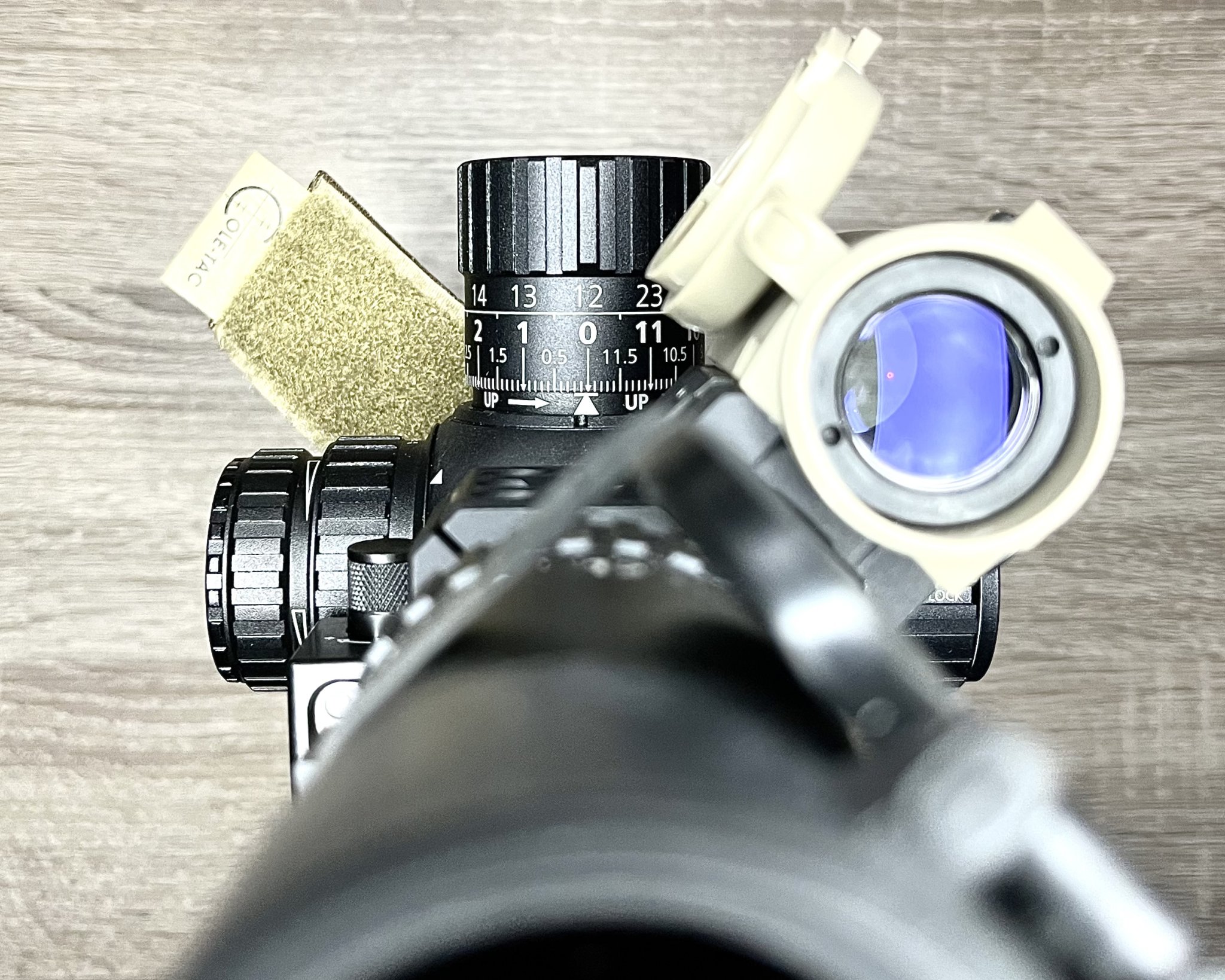

How does the zero set work? Any way to micro adjust alignment after loosening the set screws?
PS - I'm not a fan of tall turrets, but I do like how they printed their numbers with bold full mil values and thin 1/2 mil marks and 2nd rev numbering, just wish they would have shaved off half of the knurling up top.
Negative, the cap rests into a machined channel exactly at 0 (that's what it feels like).
Aaaand the warranty department is observing a holiday schedule.
I see now, at 0 it is fine, but after moving it beyond zero it seems to be off. I'm assuming you just received the scope, you should contact the dealer and ask for an exchange, many Hide dealers give about 14 days to return, just a thought instead of going through Zeiss warranty.
Reactions: Nik H and lash
I would be doing exactly that
Reactions: lash
I dunno of a single vendor that will let you return a scope once it's been mounted in rings* if they can tell 🤣
other than taking mine out of the box to take a look at it, haven't had a chance to use it. Looked to day, sure enough , lands smack dab in the middle of the marks to each side. I'll b giving tyler a holler later today
Unfortunately my windage turret has that problem sitting offset in the middle of the turret indication marks.
Gonna need to hit up Zeiss Sporting division to let them know someone is fucking up quality control.

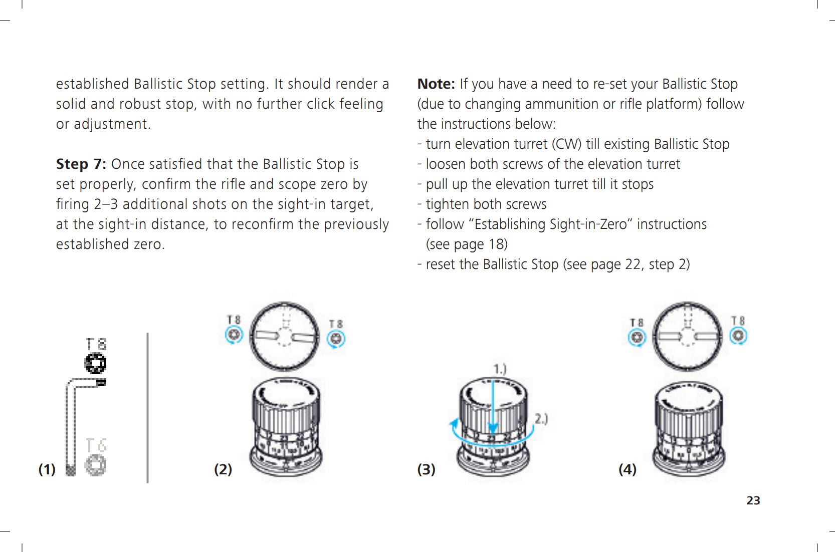

Kyle brown says when you go
To zero it, you can line the marks up. You loosen the screws, pull the cap all the way up, then push the turret all the way down while turning it clockwise till you hit the stop. Then you should be able to line them up. Tighten the screws. You have to hold the turret while doing so. I received this after I sent the scope back.

Can somebody explain to me why they use oddball Torx sizes and DIFFERENT ONES FOR WINDAGE AND ELEVATION (T6 and T8 respectively)?
The different sizes make no sense, and I didn't have T6 or T8 in my range bag the other day.
