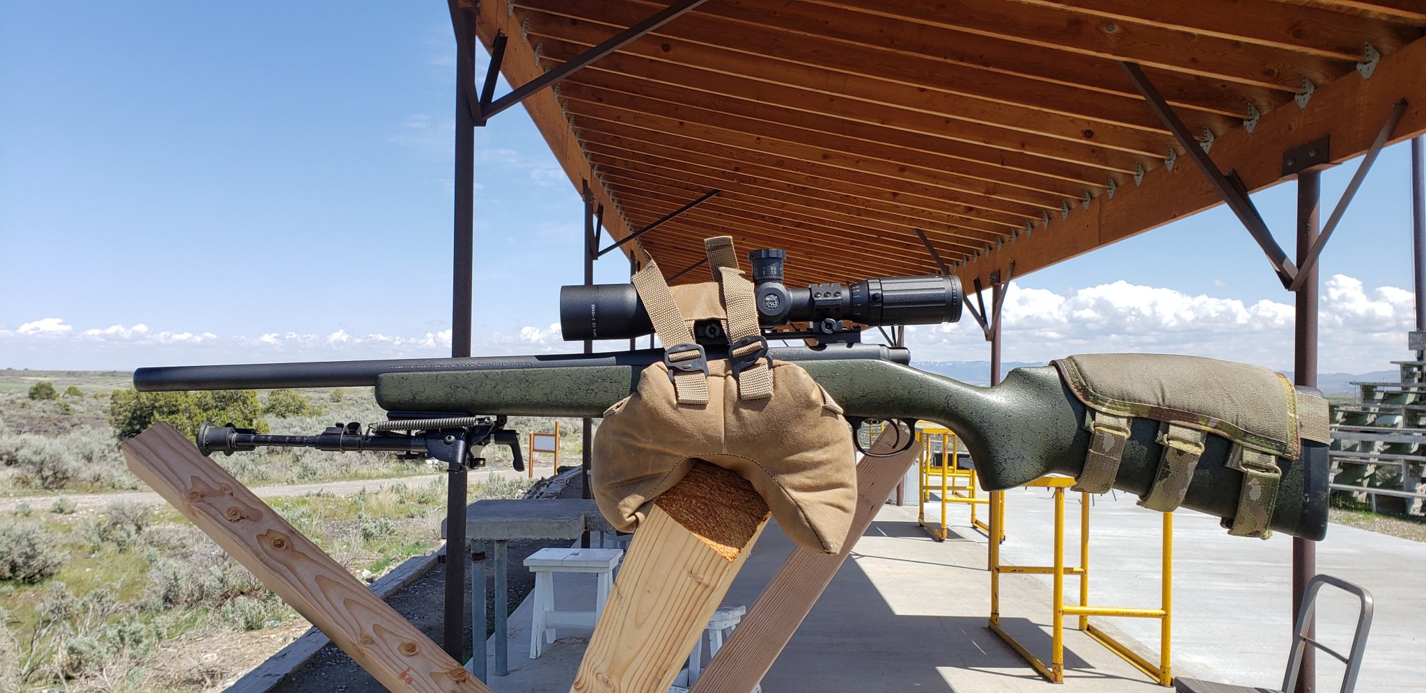

I have a Rem 700 SPS Tactical .223. Its wearing a BC Medalist stock. This is my.little do it all rifle. It gets carried on Coyote hunts it gets to go ground squirrel shooting, and its my little long range trainer. I love the gun but one thing I noticed yesterday is I much prefer the fit and feel of my RPR compared to the traditional stock on the Rem.
I've been considering dropping it in a KRG chasis. My biggest concern is the magazines. Anyone build a .223 chasis rifle and regret it? Any lessons learned or wisdom to share?
I am hoping everything settles down. This next spring I am thinking about rebarreling with a 24" proof barrel. I'm also on the fence of going AI or not. I shoot 90% reloads in this rifle. Does the 223AI play nicely with the AICS pattern mags?

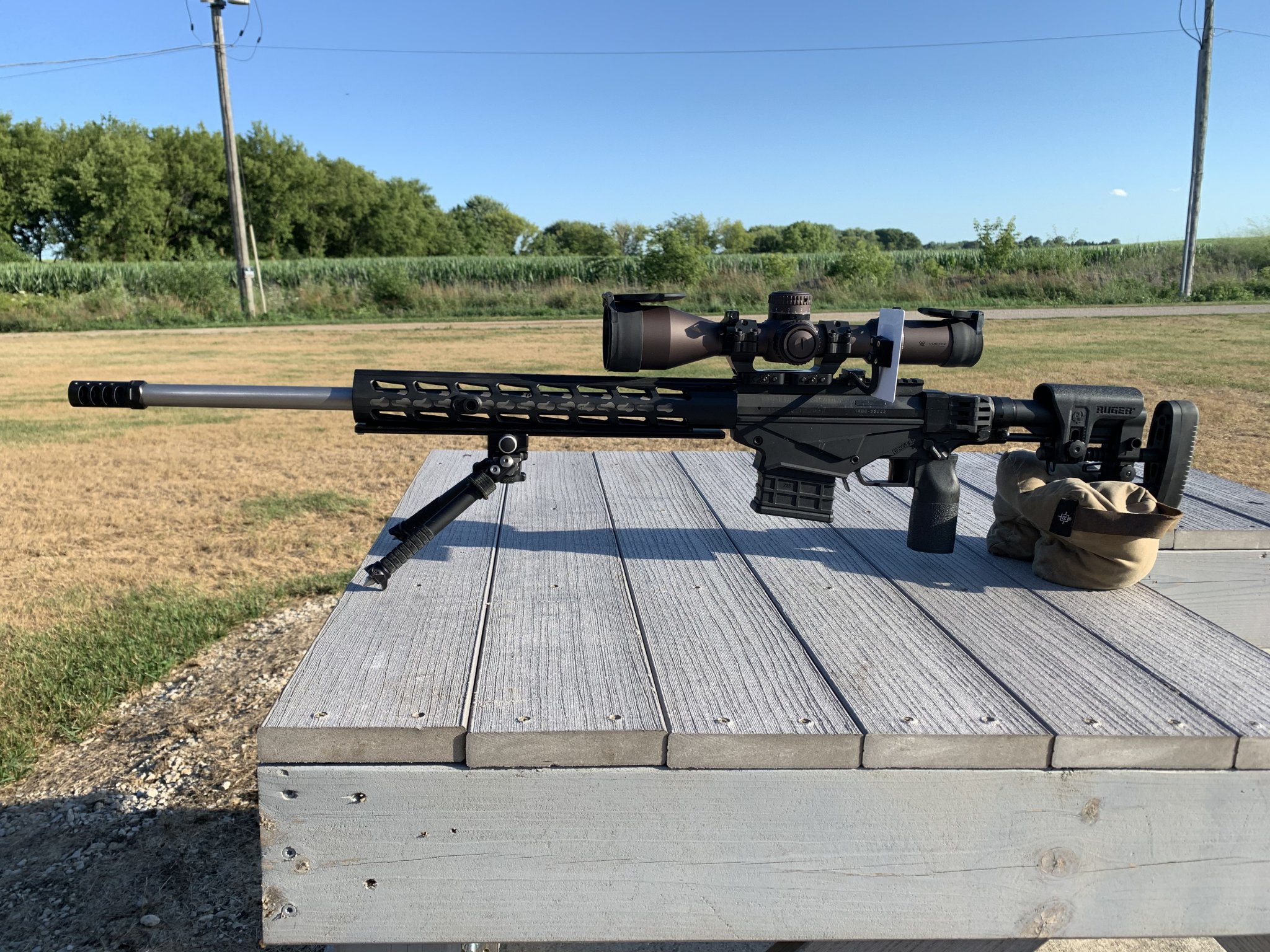

I run 223AI in a Ruger RPR for the local 600yd PRS/NRL matches. I use MDT and Ruger mags and it feeds great no issues. I am running 75gr ELD bullets at 3000fps, with no pressure and no problems in the rain. It’s a laser.

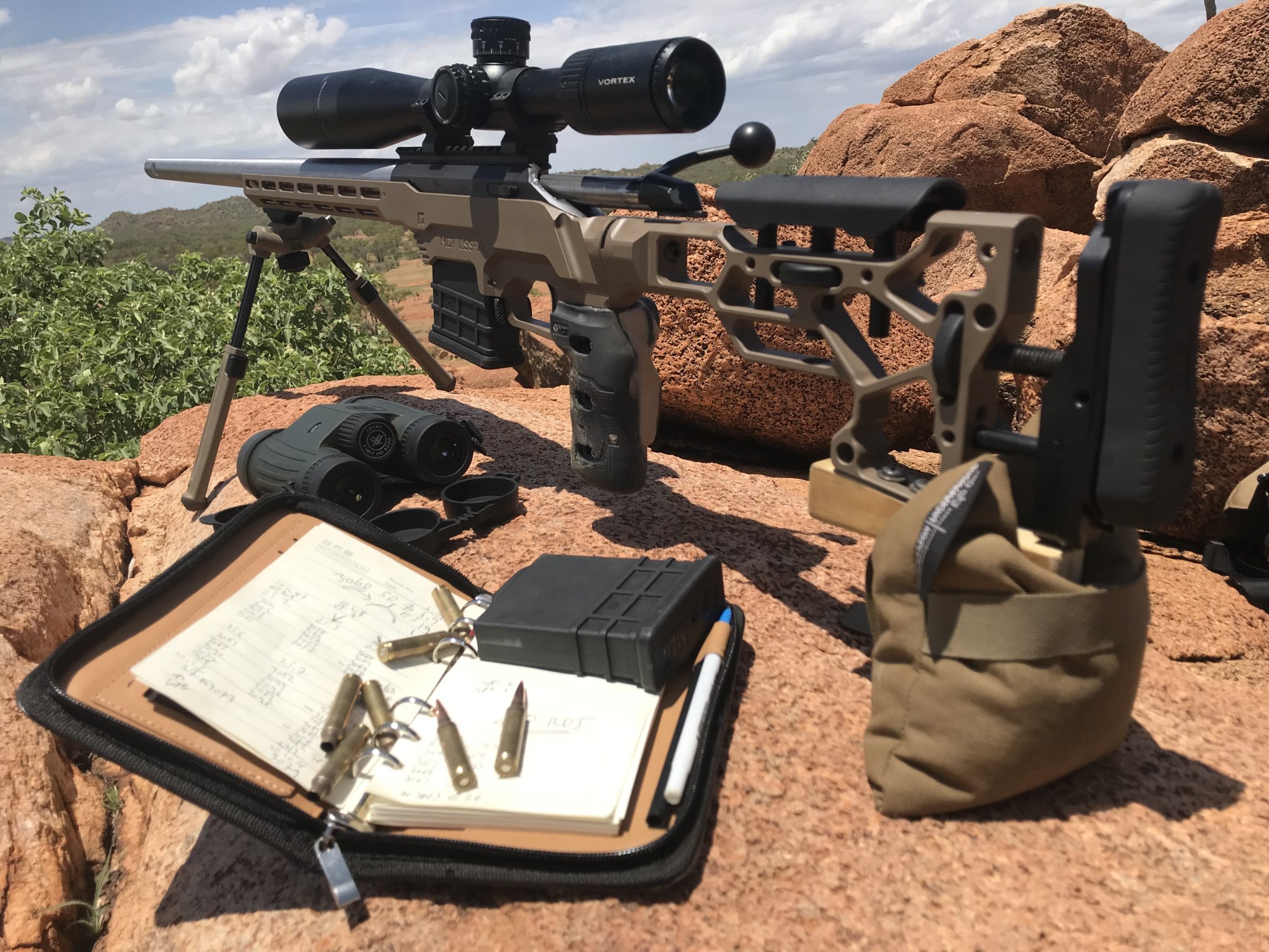

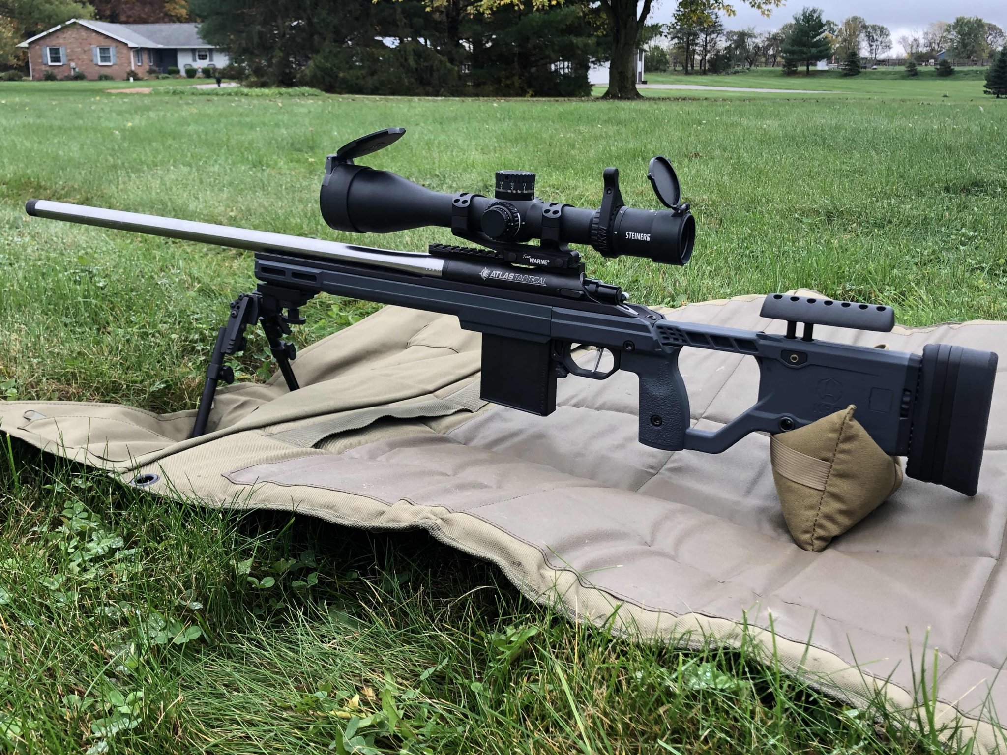

Just picked up a Kelbly's Atlas Tactical with a 24" 223AI Proof steel barrel on it(Sendero Lite contour). Put a Bix n Andy Tac Sport two stage in it, and the KRG X-Ray will be here tomorrow.
I've heard zero complaints from anyone who's owned an AI... its gonna be a fun rifle. I've always preferred traditional stocks, so this will also be my first chassis'ed rifle

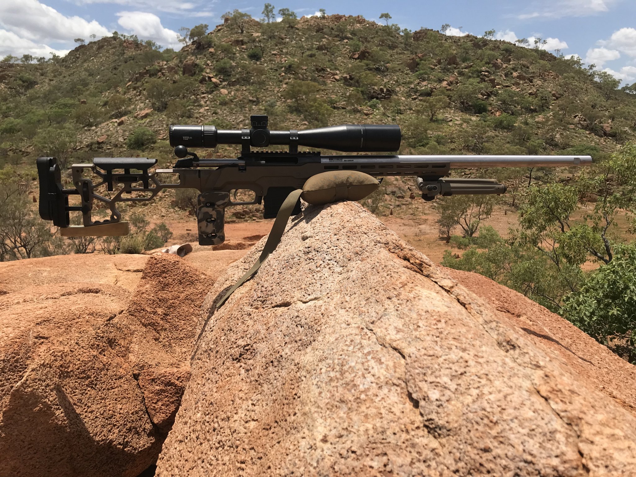

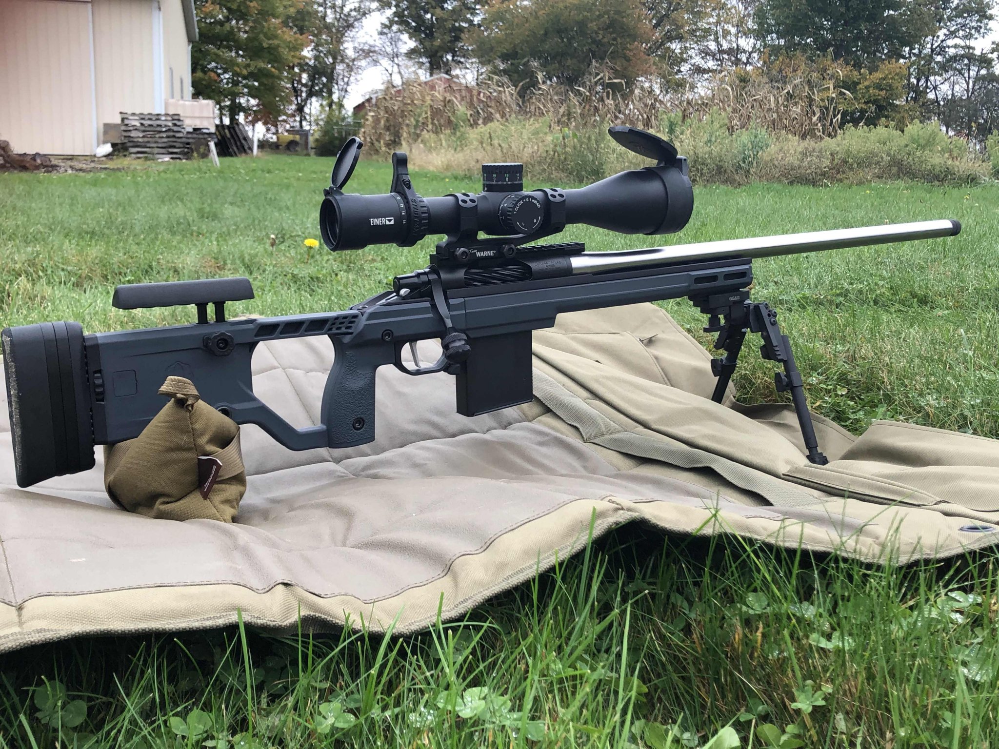

Heres the 223AI Atlas Tactical with the X-Ray chassis. Really liking it so far, although some modification was needed to the X-Ray to fit the Kelbly's action in right. I'm still getting used to the chassis setup and playing around with LOP and the cheek piece.

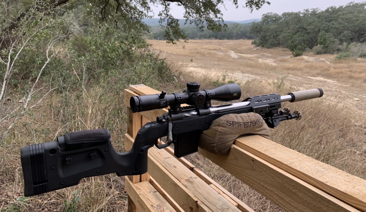

.223 axiom in a bravo chassis with older whiskey 3 back pieced together. Runs good with mdt mags
