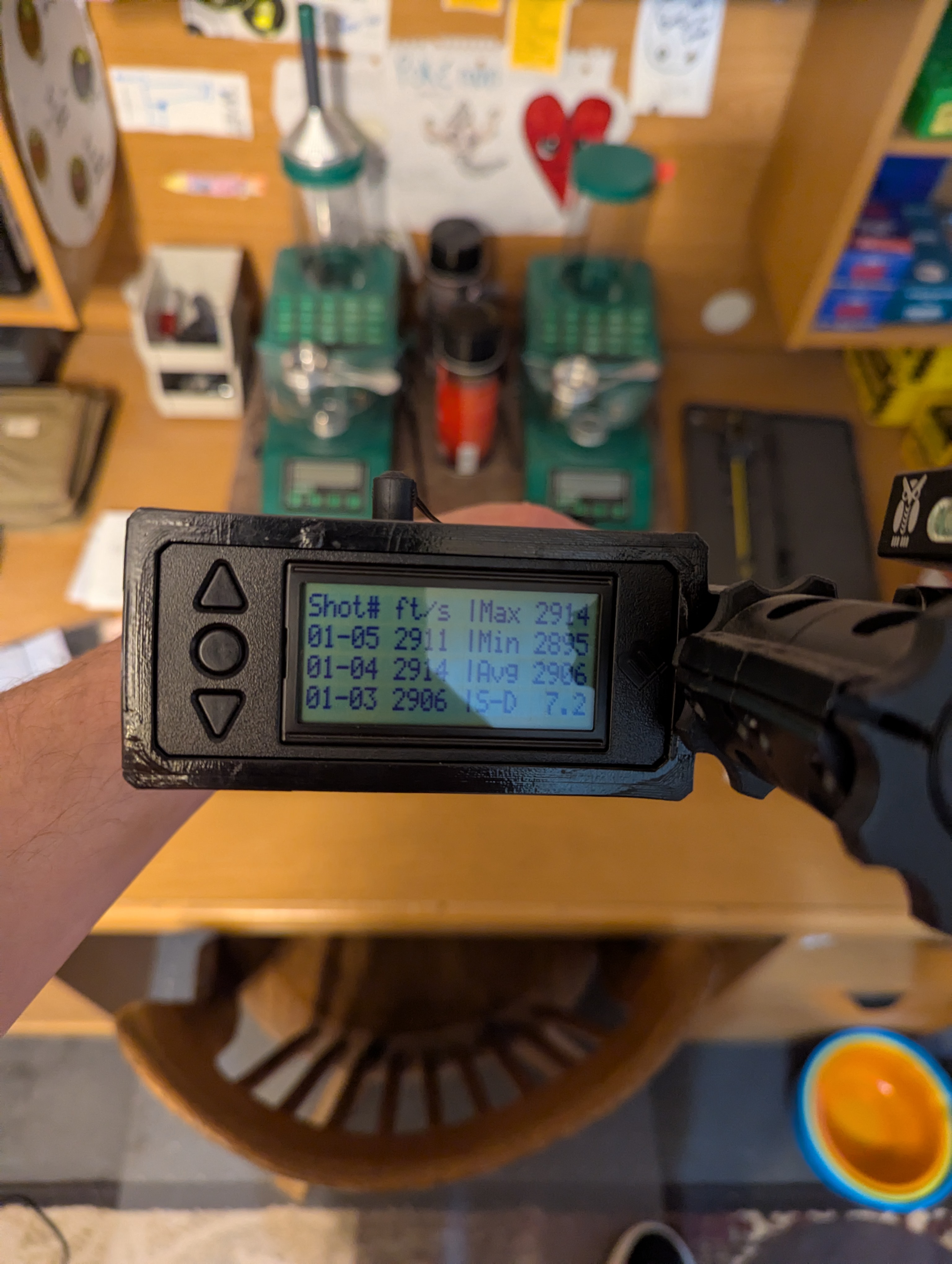

I’ve been working up this load for 300 Norma, AXSR rifle, 27” Bartlein barrel, first time with a magnum, and reached a point where I’m looking for suggestions.
Started with new Lapua brass sized for .002 neck tension, 230 A-Tips .050 from lands, 9 1/2M primers and H-1000.
I did a powder charge test from 82.1-85.1 in .6 gr increments OCW style, ascending order, 3 rounds each total. Stopped at 84.5 because it was flattening the primers pretty hard by then. Went from about 2900 fps up to 2980 fps. Best groups and ES were at 82.1 and 84.5.
I loaded up five rounds each of 82.1 at .030, .050 and .070 from the lands and fired them in the same ascending order style and got these results.
Loaded up 10 rounds at 82.1/.070 to see if I could confirm it and it looked like this.
Decided to test the same load again to see if this was me and to check neck tension results so I loaded up ten each at .002 and .003 neck tension and got these results. ES at .002 was 21 and at .003 was 49.
I shot every test at the same range, same time of day, nearly identical conditions prone on a bipod with a rear bag. My 215 Berger load I did is pretty consistently .5 MOA but this 230 load after that one outlier seating depth group is closer to 1 MOA.
Looking for some outside input. Time to change powders? Drop the charge a little?
Repeat a previous test?
What say y’all?

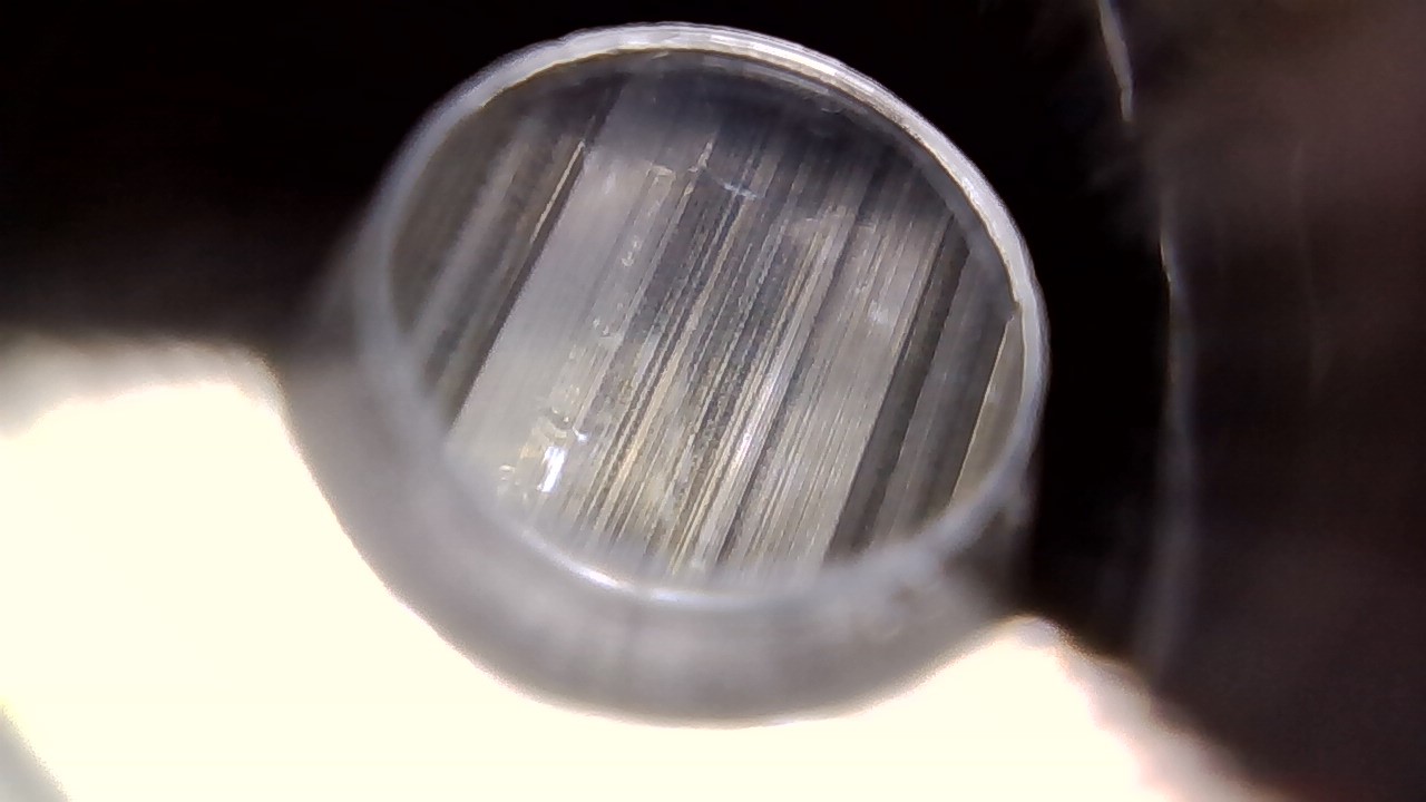

Question on Proof barrel after bore scope

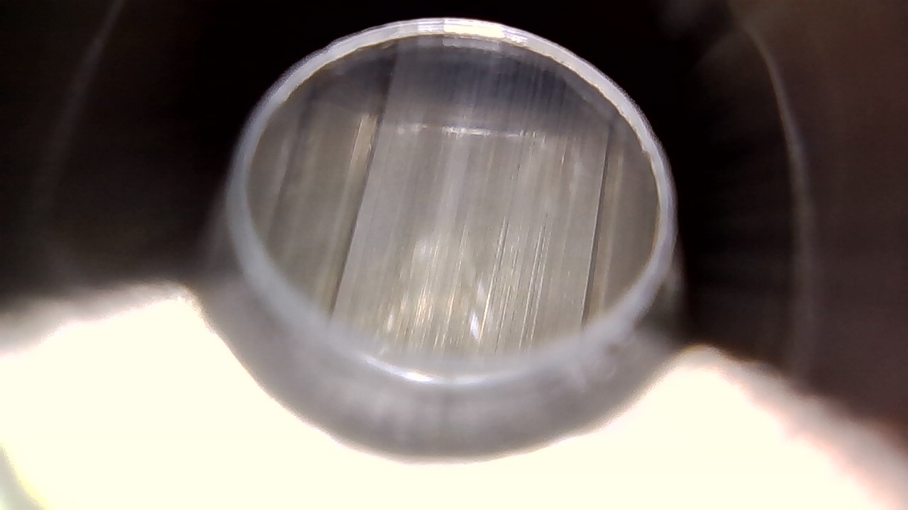

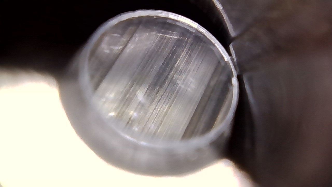

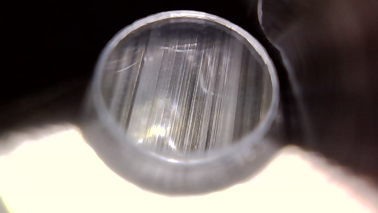

Just had a question after using a Bore Scope today. Normally i don’t use these often, but having a weird gas issue with another rifle so wanted to check my new 16.5” Proof 6.5cm custom bolt build. Approx 65 rounds fired and did a barrel break in as well and want to make sure i didn’t do this or if its just weird machine marks. Barrel shot good and accurate no issues. Anyways the first 1/4 of the barrel looks rough but last half looks perfect. Anyway here are some pictures and it was also build by Altus which i know they do good work and never had an issue just wanted to see what’s normal. I believe last picture is where it looks good which is about half way until the end of barrel.
