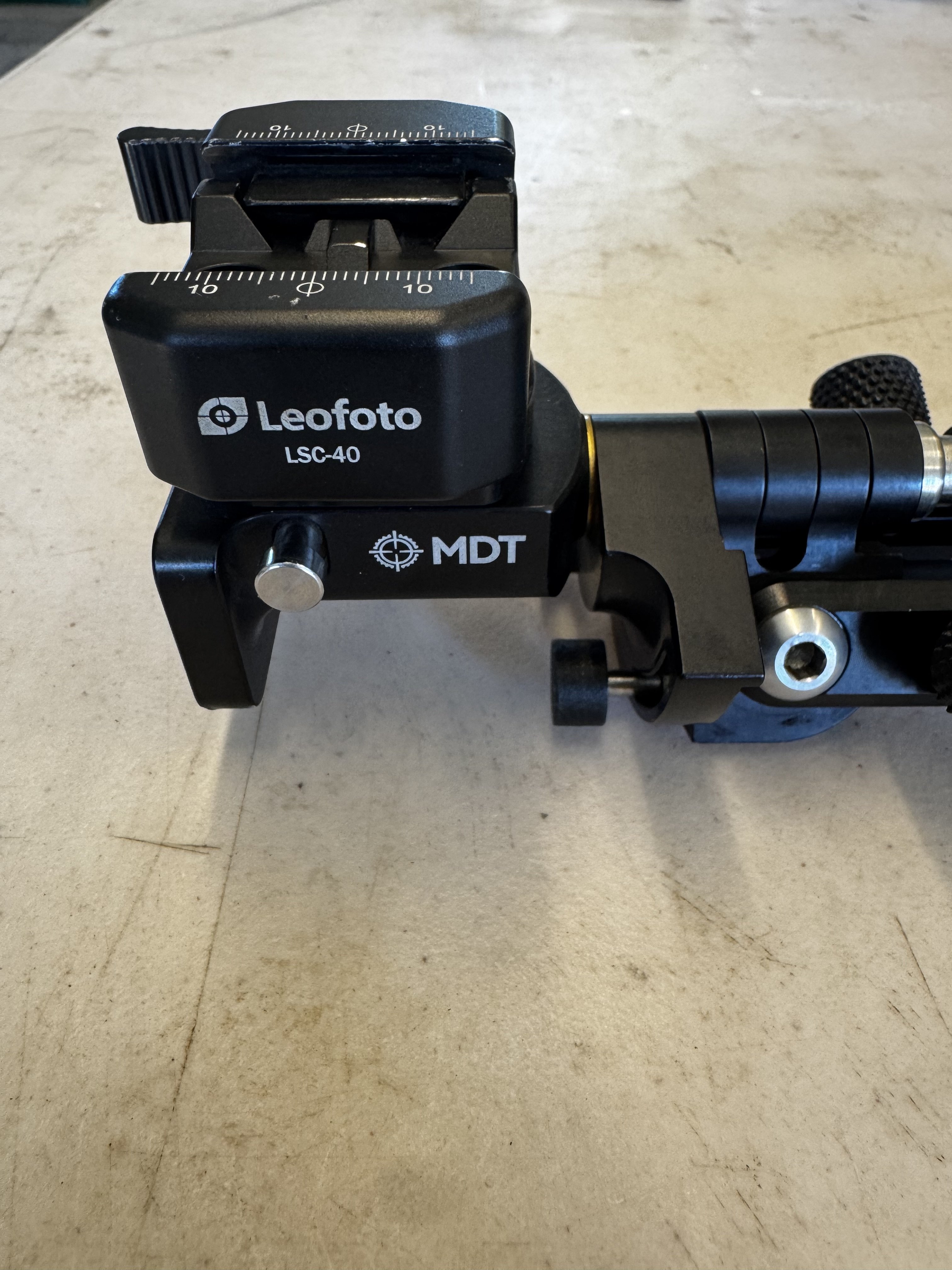

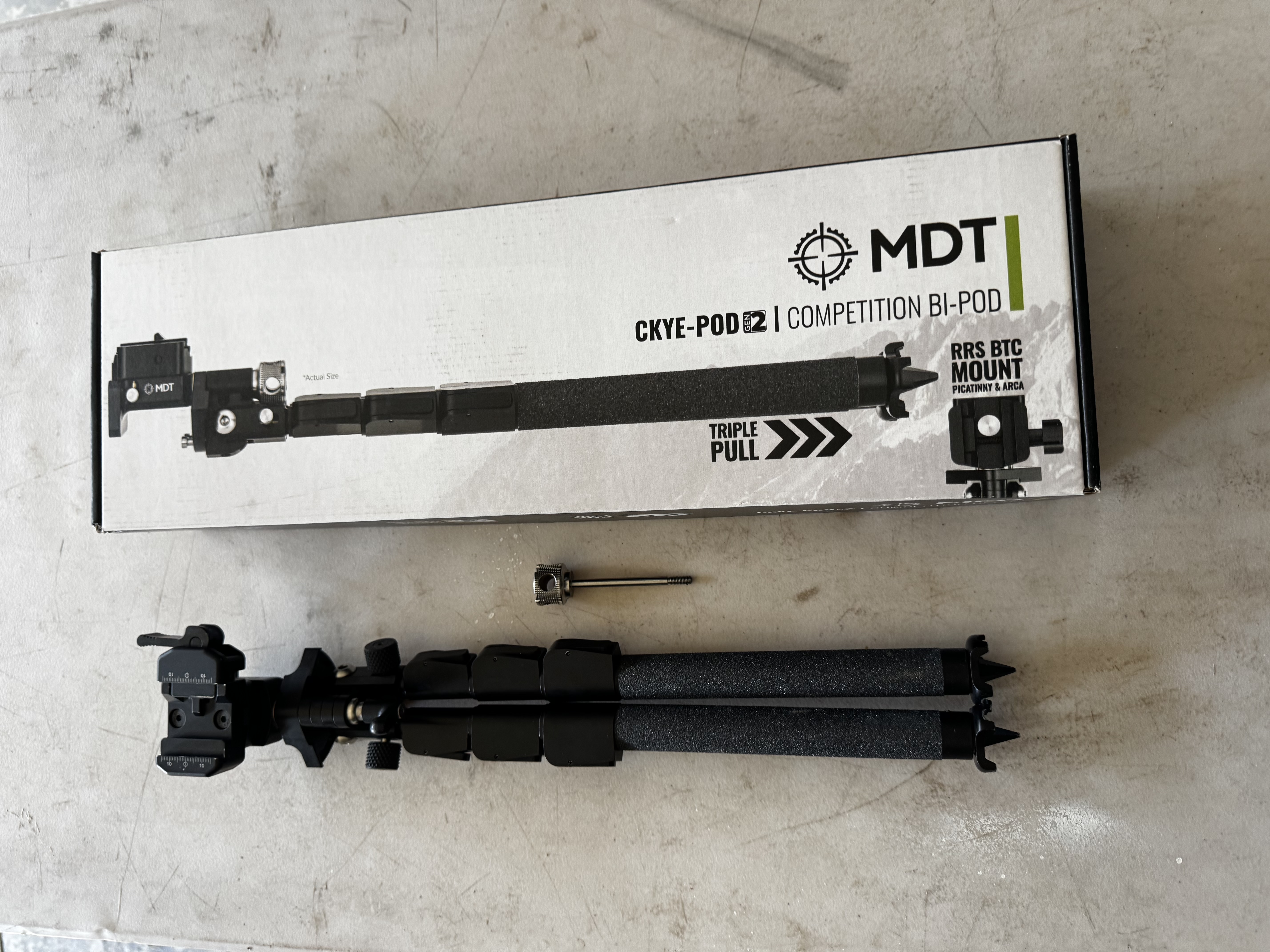

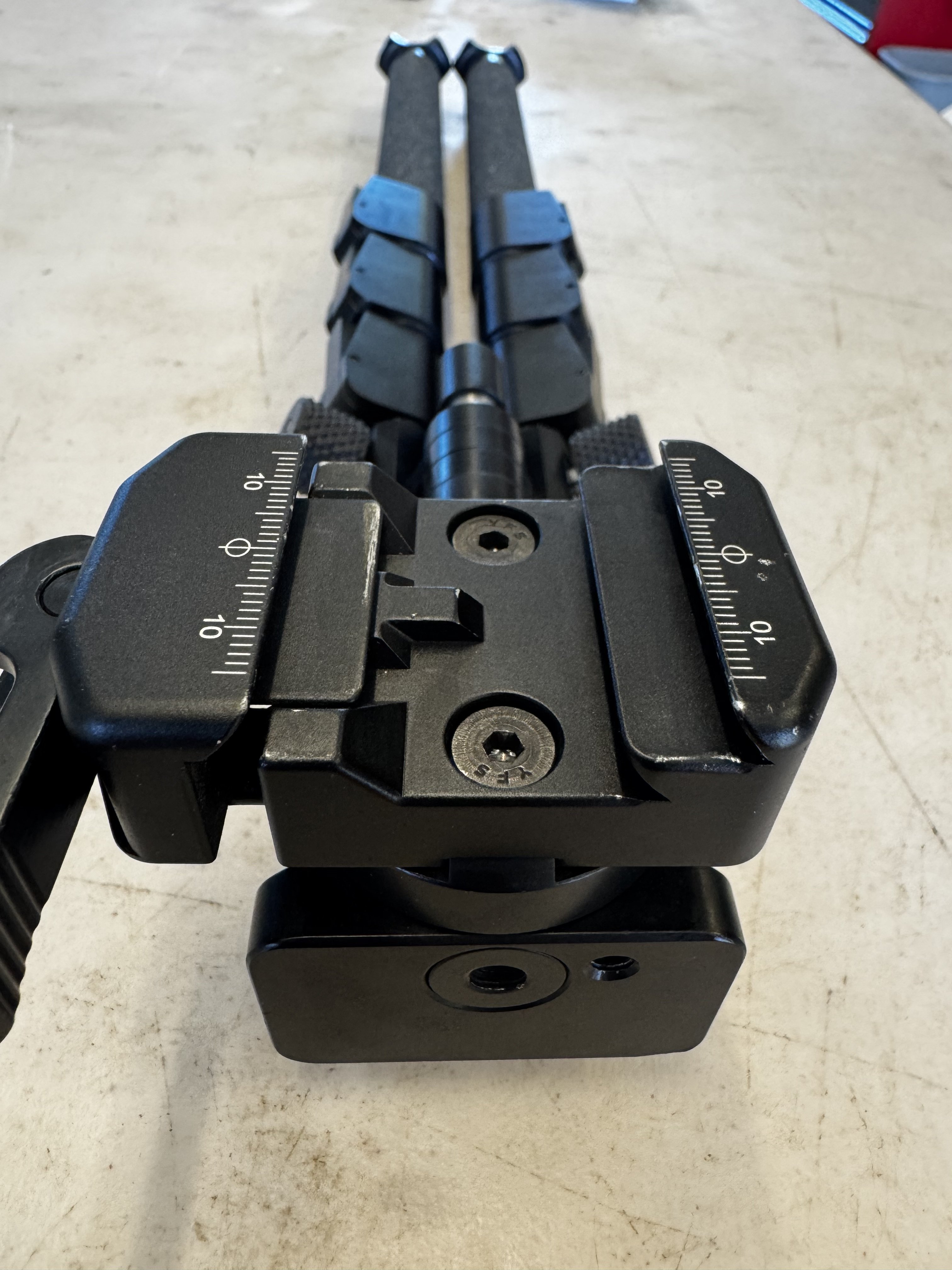

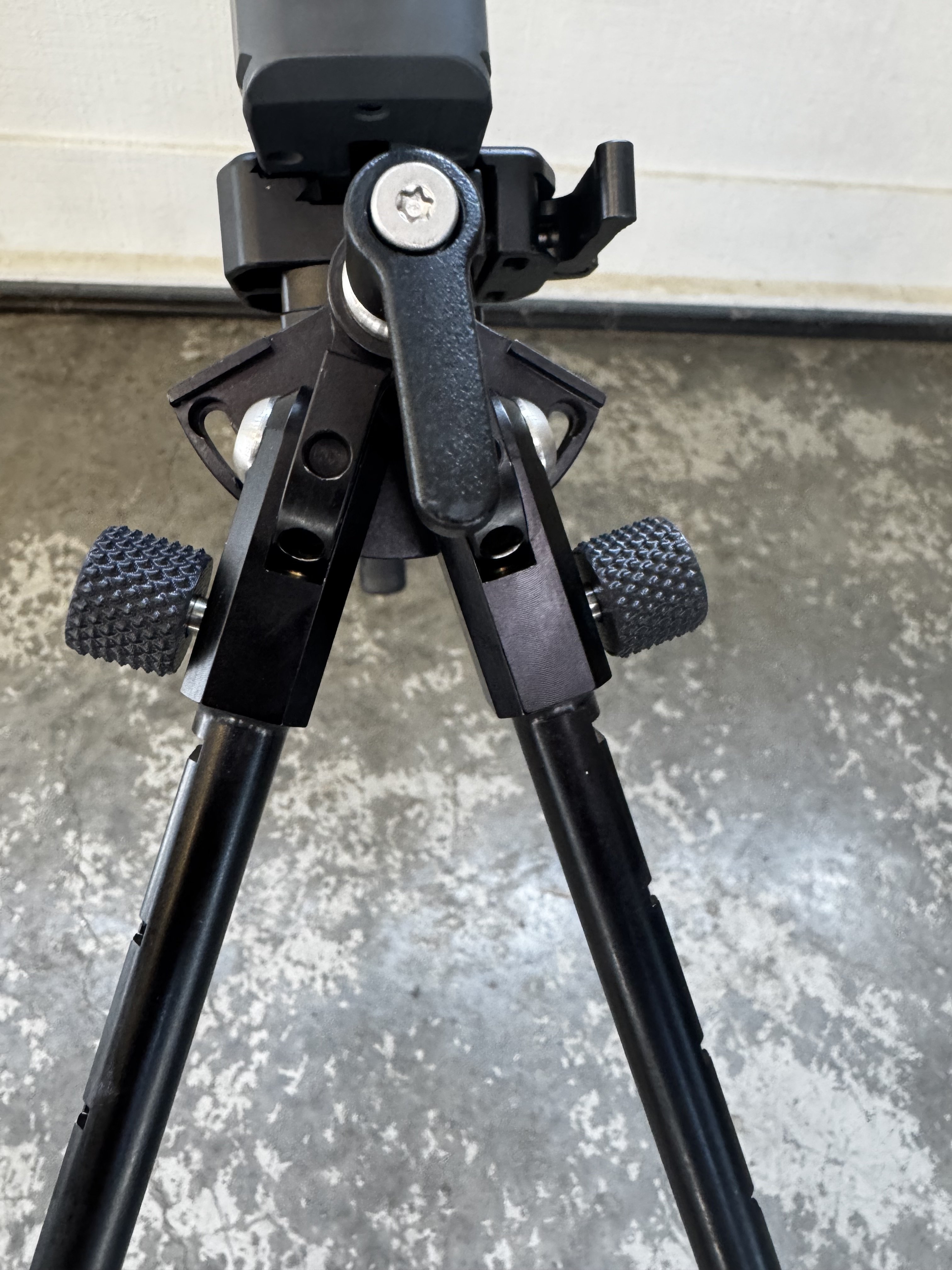

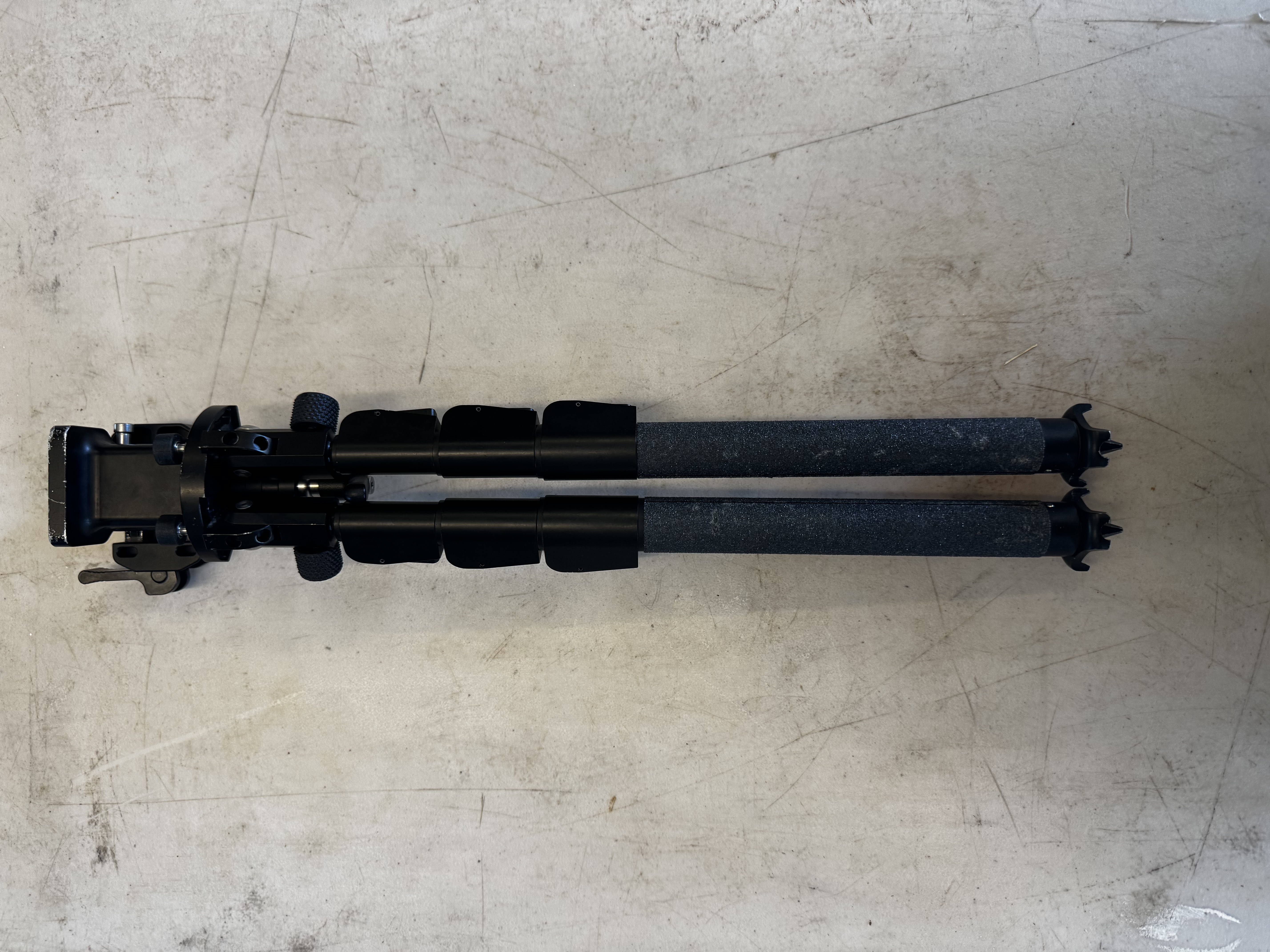

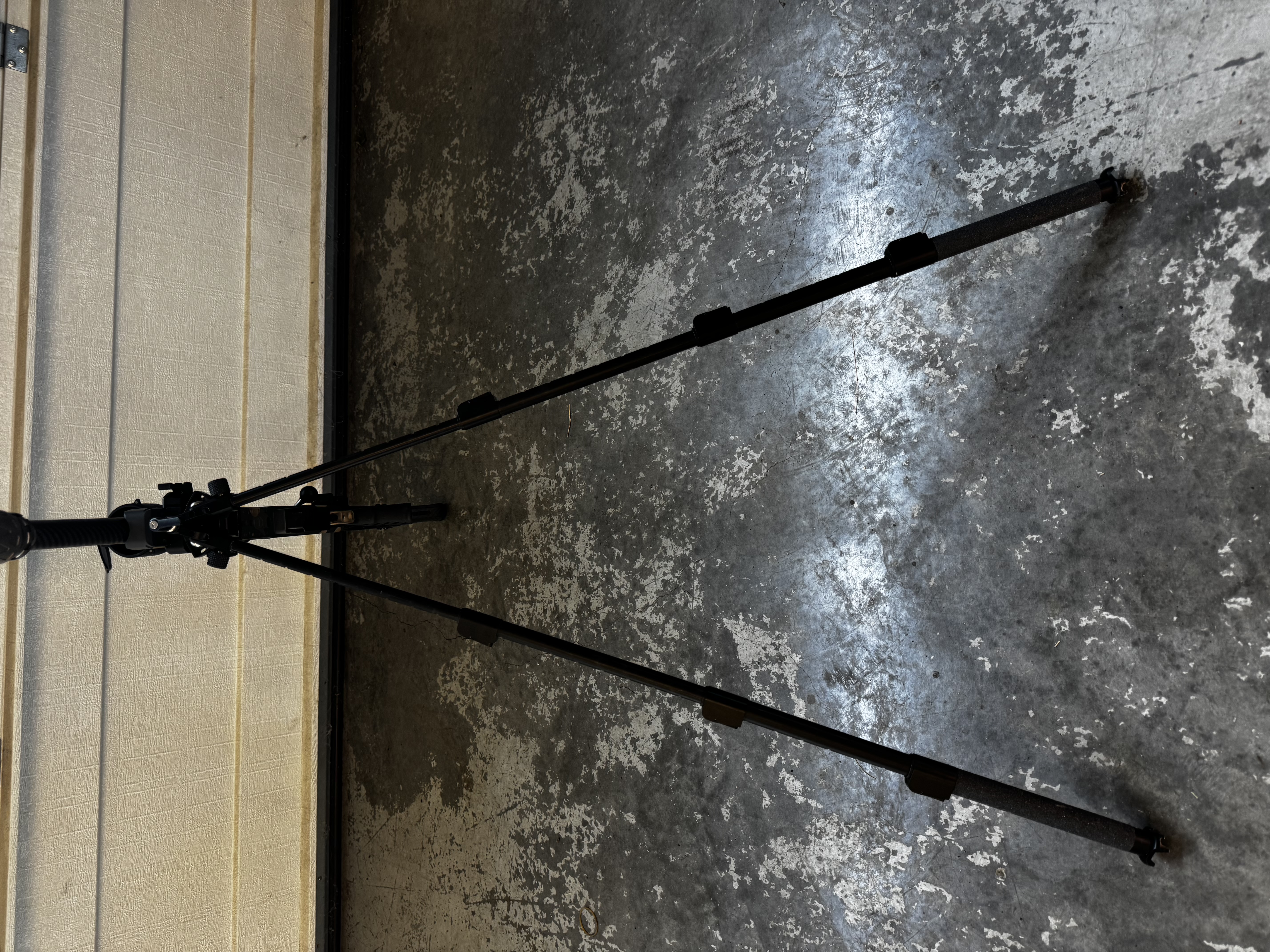

SOLD Ckye Pod Triple Pull
MDT Ckye Pod Triple Pull Gen 2. Good condition, no issue. Pod knobs.
$800.00 obo tyd conus
Trade for LH Impact 737 action +cash

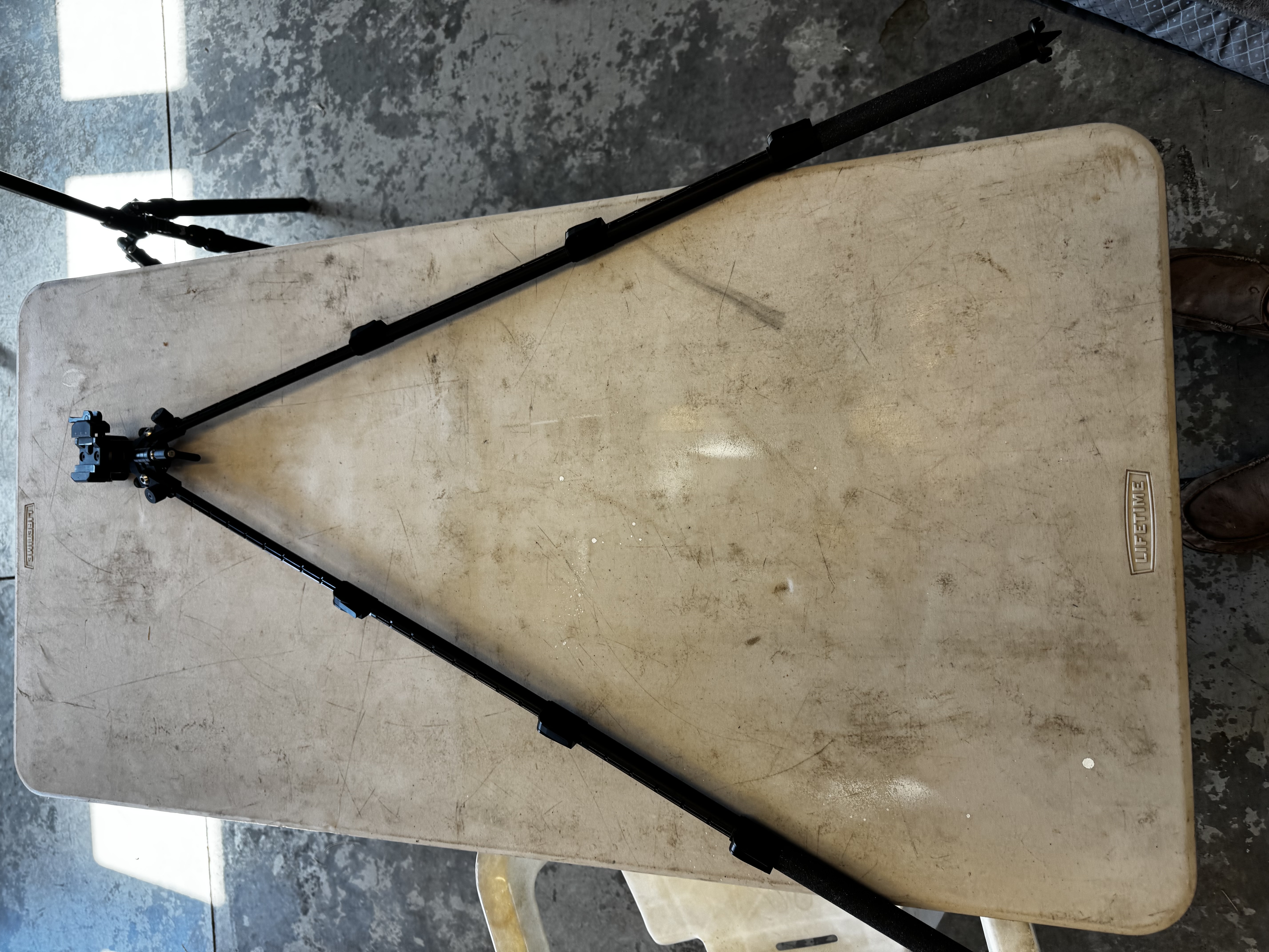

Firearms Thermal setup
T3x chassis gun by J&A outdoo, Nocpix ace l35 , and i have either a warrior tripod setup that can go, or a 2 vets QDT v2 with invert 60 head that can go with it. Scope it less than6 months old, be a good package to hit the fields with. If interested reach out and i can go over any questions. The rifle is listed on here separately.
4500$ bundle, shipped to ffl , insured.
Yes i will ship!
