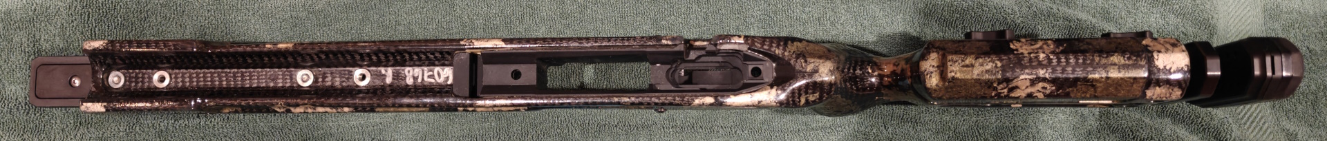

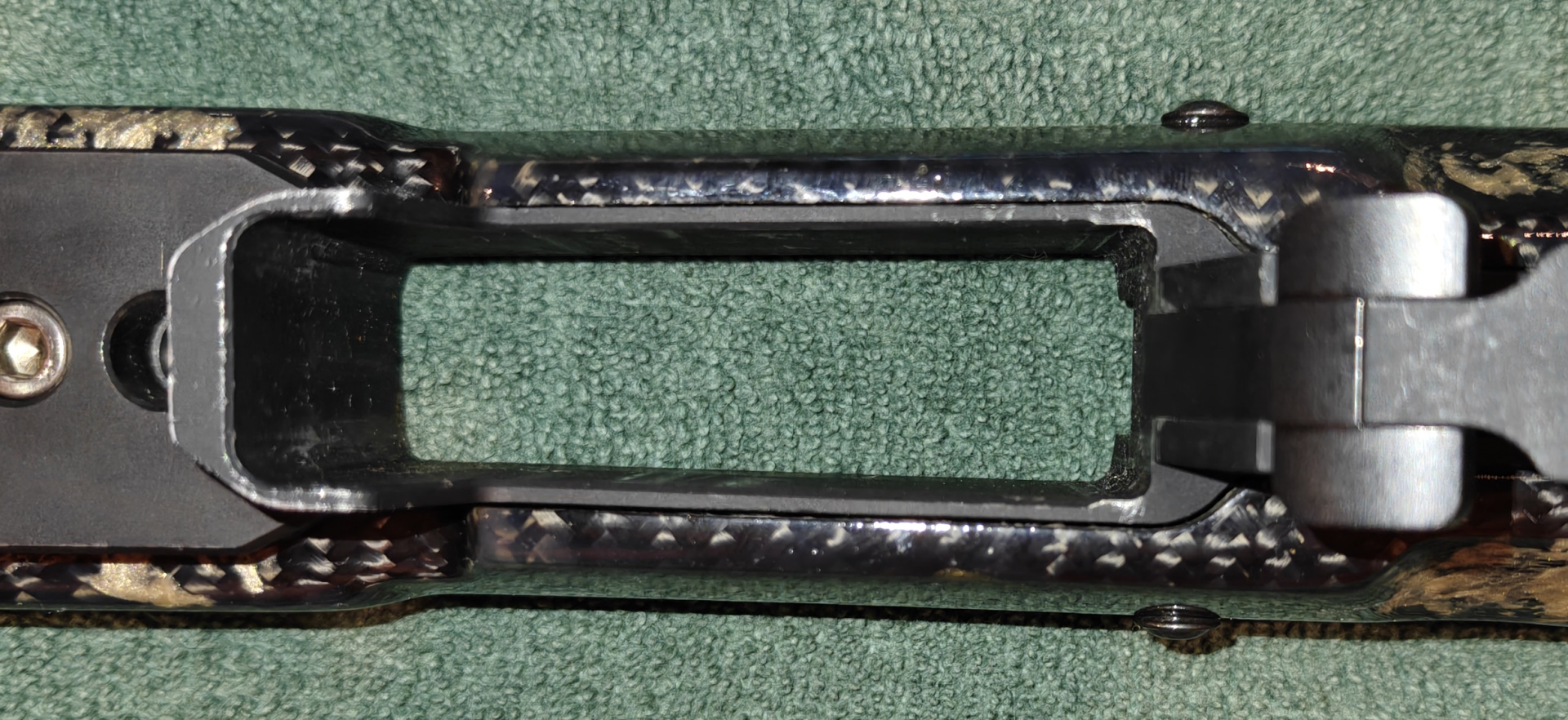

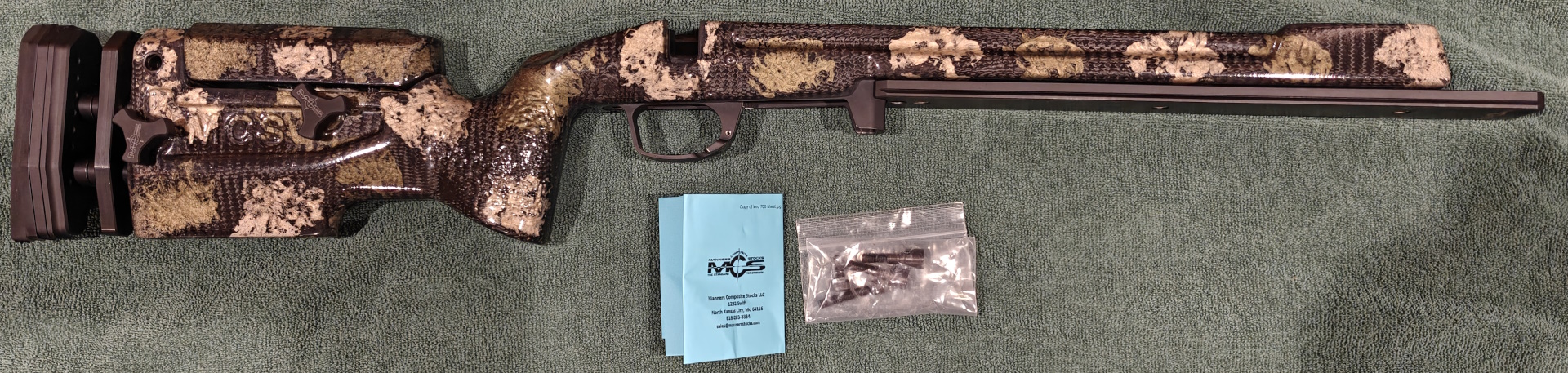

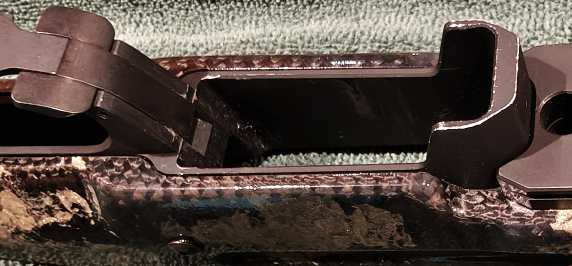

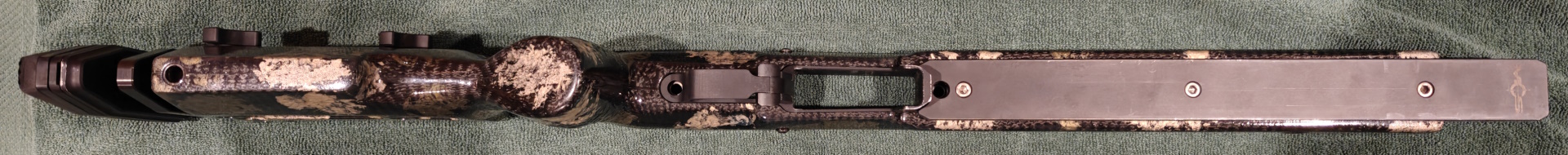

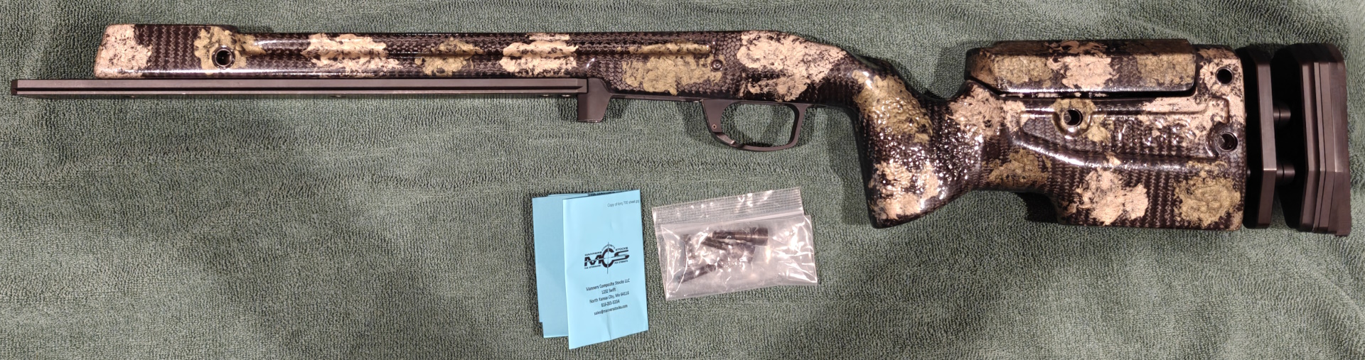

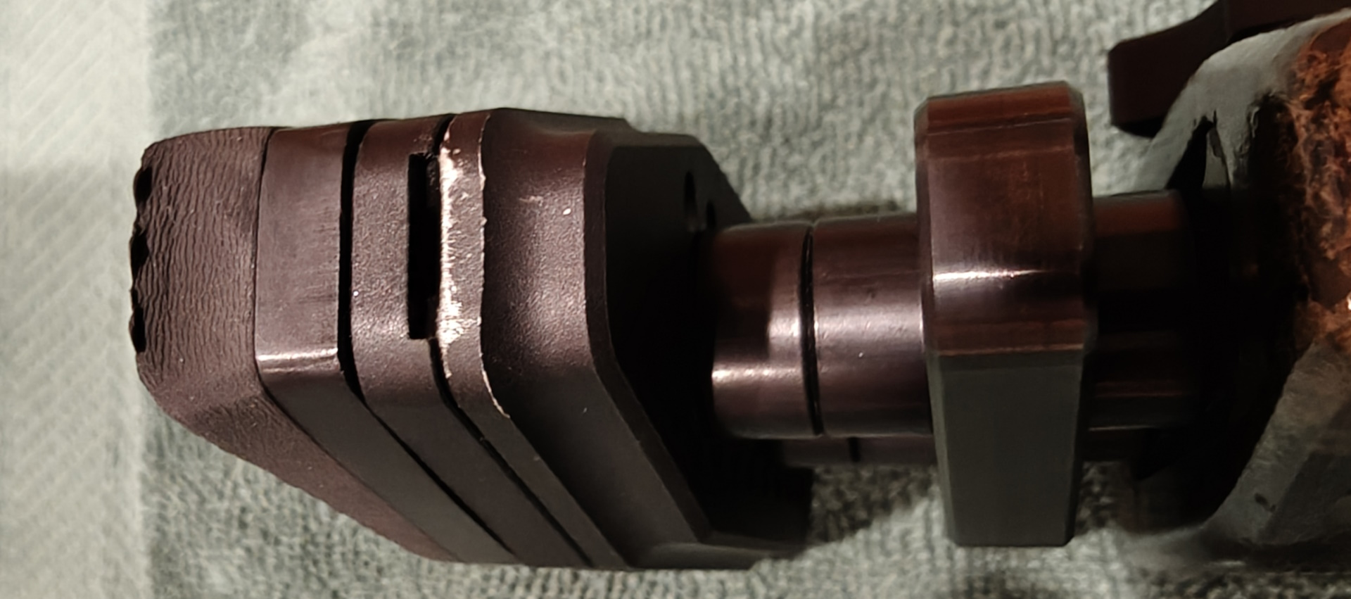

Up for sale is my 338 lapua. I purchased this in August of 2016, it had 80 rounds down it and i've put 18 since then. I sighted it in and it's been sitting in my safe since. I forgot most of the specs about it. But I looked in my email and found a few details. Its a R700 7 digit action, PTG fluted and threaded bolt, trued face, oversized recoil lug. Has a Schneider 10 twist factory fluted barrel. David Tubbs brake. David Tubbs speedlock full firing pin assembly. I had it in a Cadex chassis for years. Now its in a Mega arms Orias long action chassis with the night bridge and xlr buttstock. Which does take 3.850 mags. I just bought it basically to sell the rifle. The second owner who I purchased it from told me he never shot it. Purchased it out of NC, it shot 1/2 moa and the smith was a guy who worked for IOR Valdada. I don't have my target photos anymore but i'm recalling that it did shoot about 1/2moa. I kept it for so long because i'm a big Schneider barrel fan. I don't recall the contour but its got to be like a m40 ish. The price of the rifle doesn't include the scope, rings, scope mount and bipod. 2 mags are included with the rifle. $2200. I will entertain trades for a 5-25 scope. If I need to add money I can. You can message me here or call or text me at 720-998-9688 my name is Glenn. Thanks,
