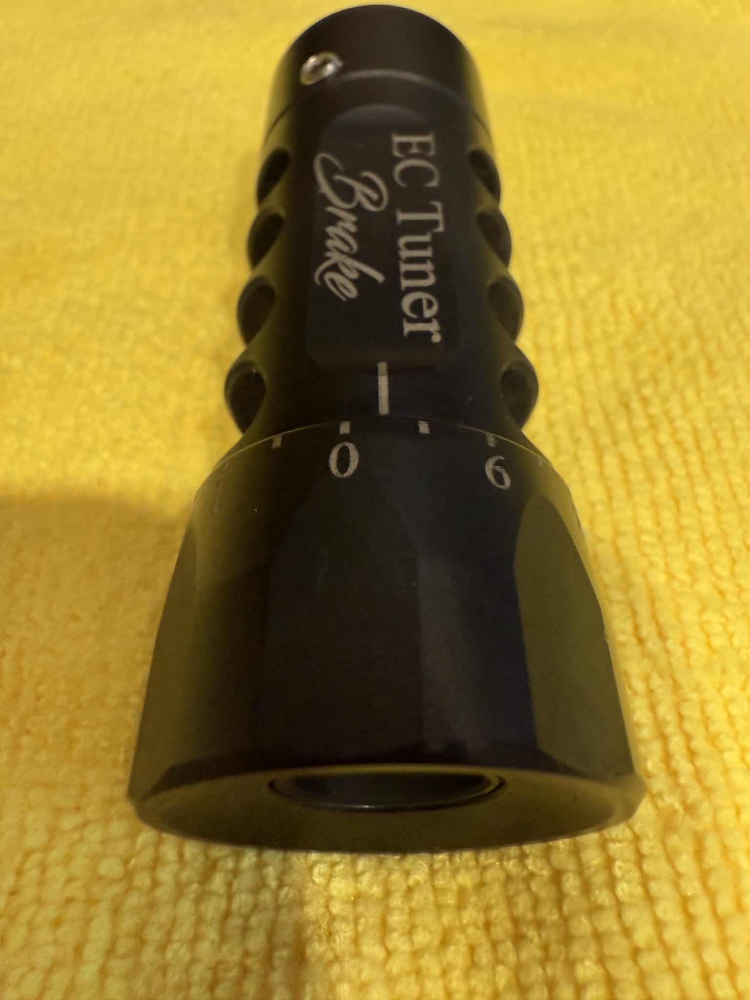

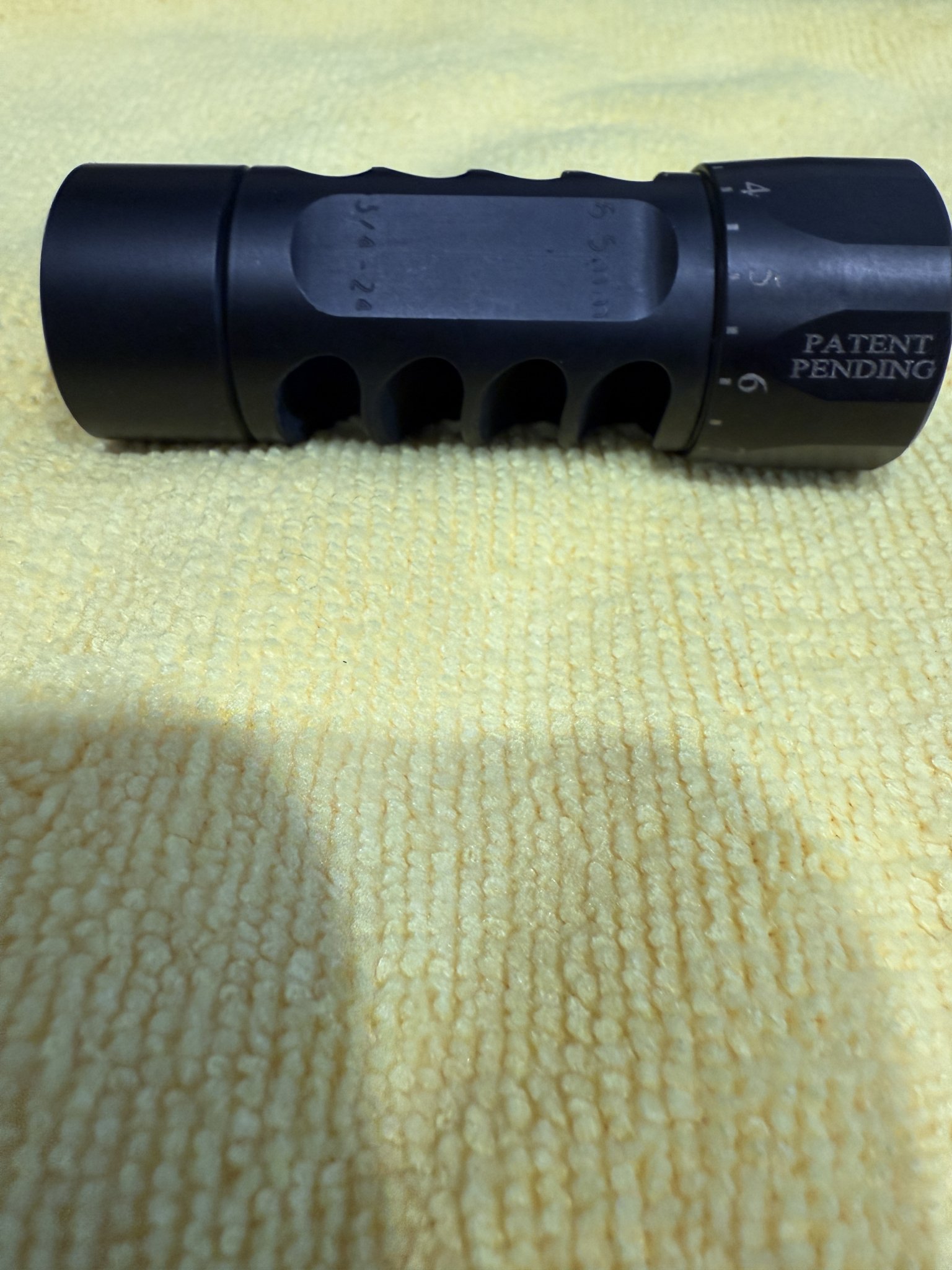

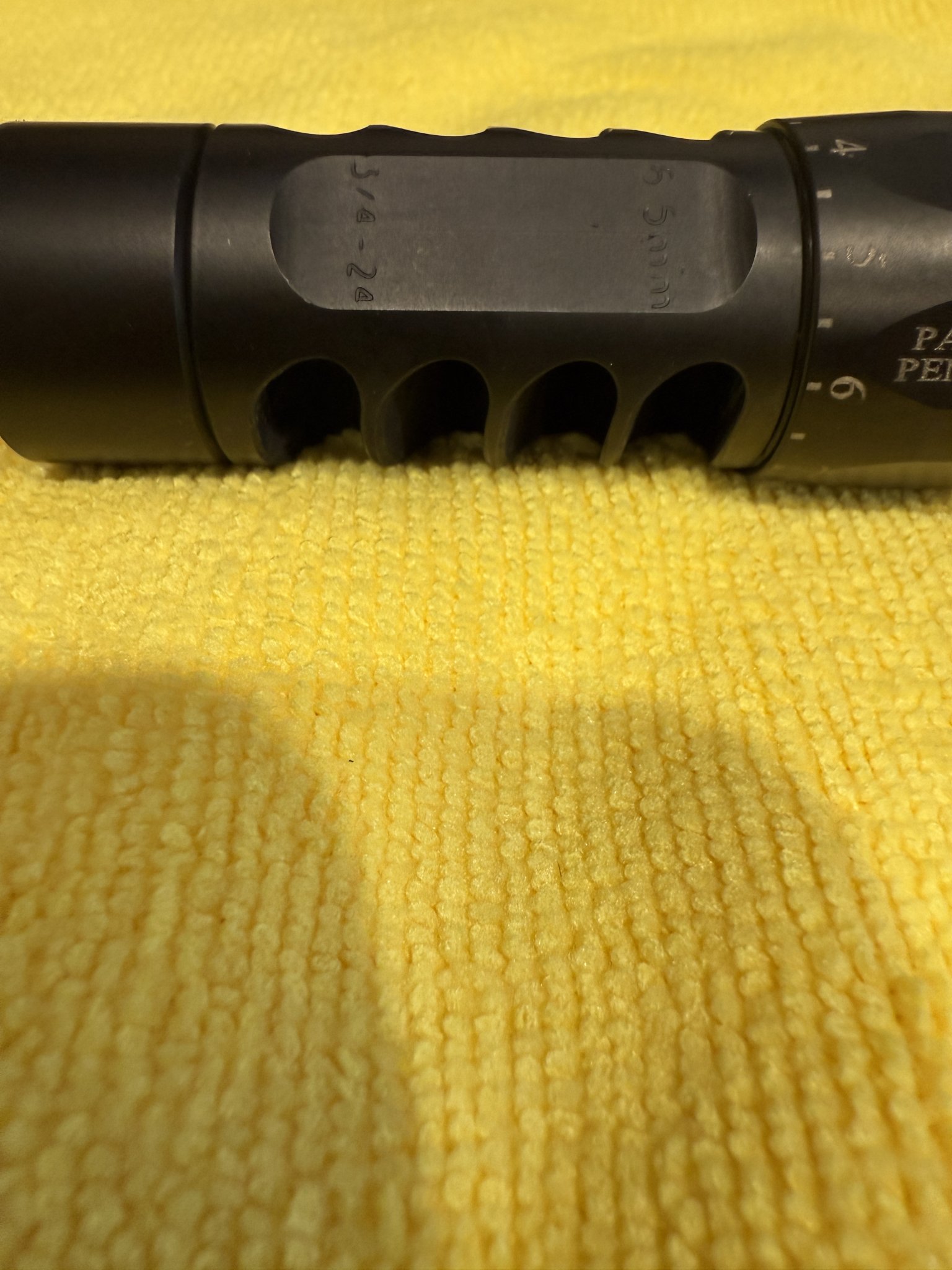

SOLD Eric Cortina Tuner Brake 3/4"x 24 6.5mm
Eric Cortina Tuner Brake, 3/4"x24 threads, 6.5mm. Bought new about about a year and a half ago and recently started using a suppressor on this rifle so no need for this. $140 shipped via FedEx 2 Day or local pickup in the Houston area. Venmo or Apple Cash
