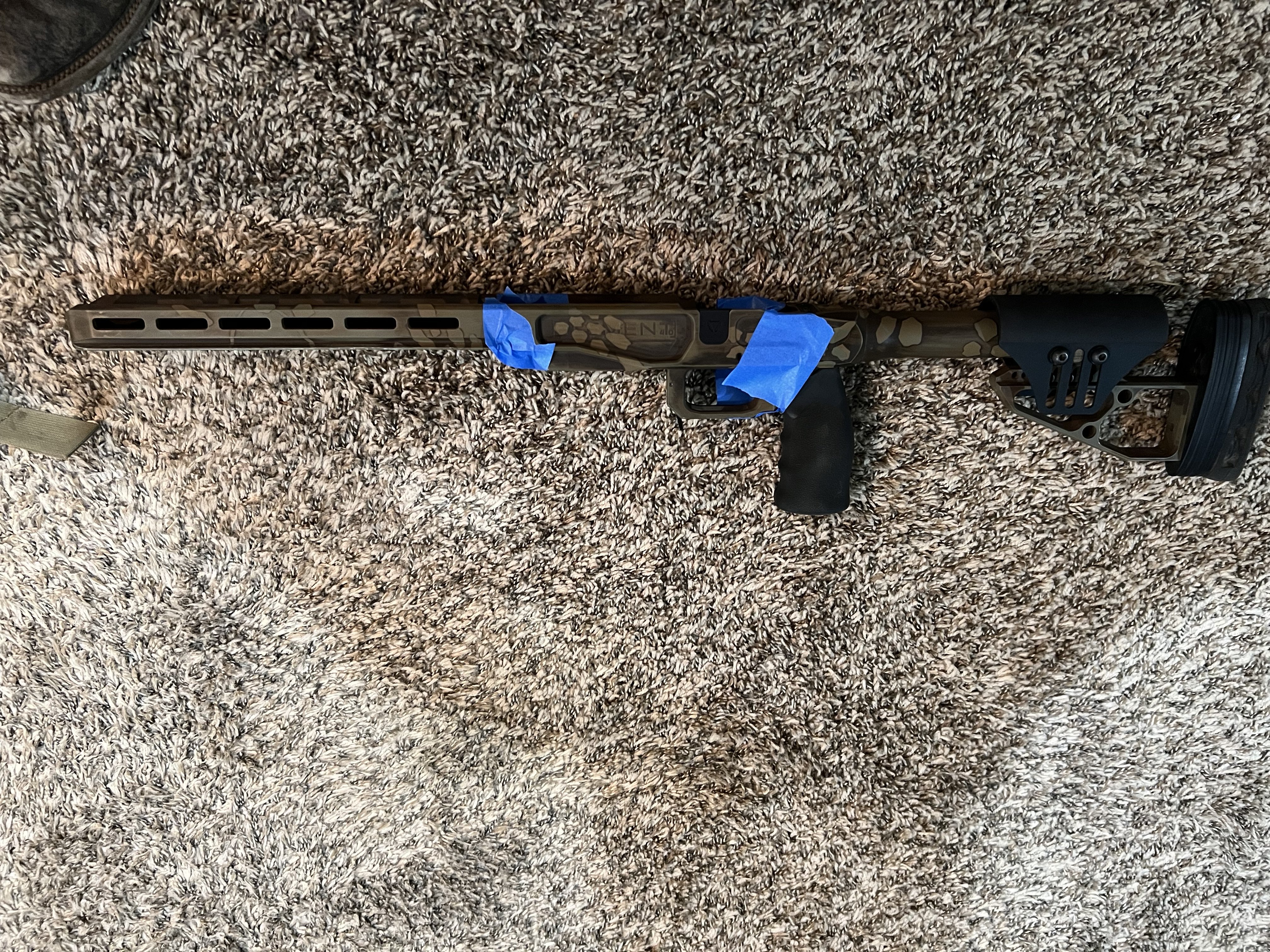

SOLD KIDD Supergrade barreled action in Oryx & Grey Birch chassis
  • KIDD 22lr Supergrade barreled action factory assembled by Kidd 20" Black Steel .920" Bead Blasted - $1,300 (build sheet in photos)
  • Grey Birch MFG La Chassis 10/22 DLX Chassis 10” $525
  • MDT ORYX RIFLE CHASSIS - $780 assembled
  • MDT VERTICAL ADJUSTMENT BUTTPAD
  • MDT ORYX CHASSIS ARCA RAIL
  • MDT MDT VERTICAL GRIP ELITE
  • JAMMER BAG RIDER
  • Everything Total New = $2,600 + tax
KIDD & MDT & Grey Birch chassis = SOLD RELISTING MDT
Kidd & MDT chassis = SOLD
Kidd & Grey Birch chassis = RELISTING MDT chassis
Shoots .35 MOA at 100 yards with Lapua Biathalon. 1 yr old.
