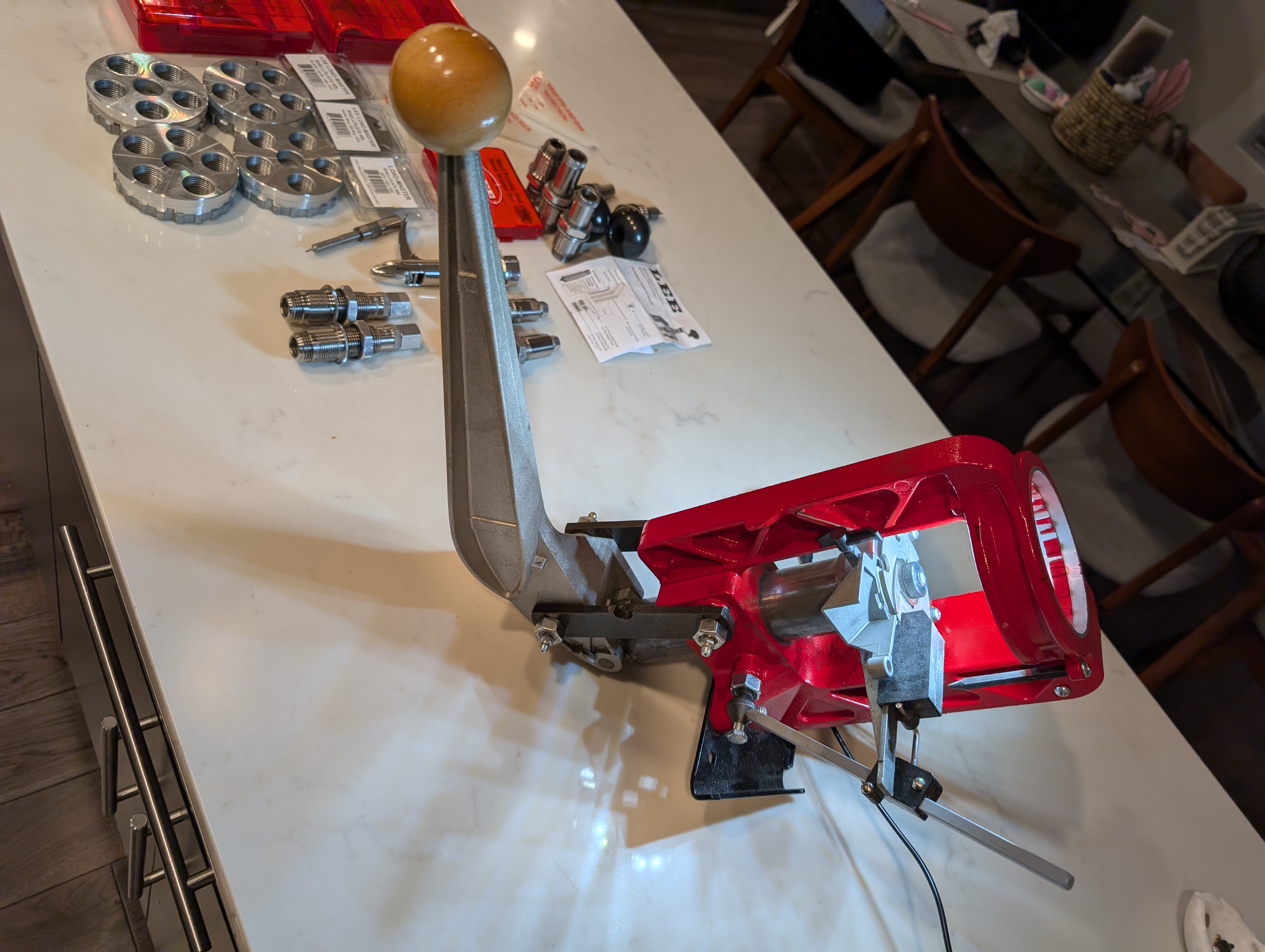

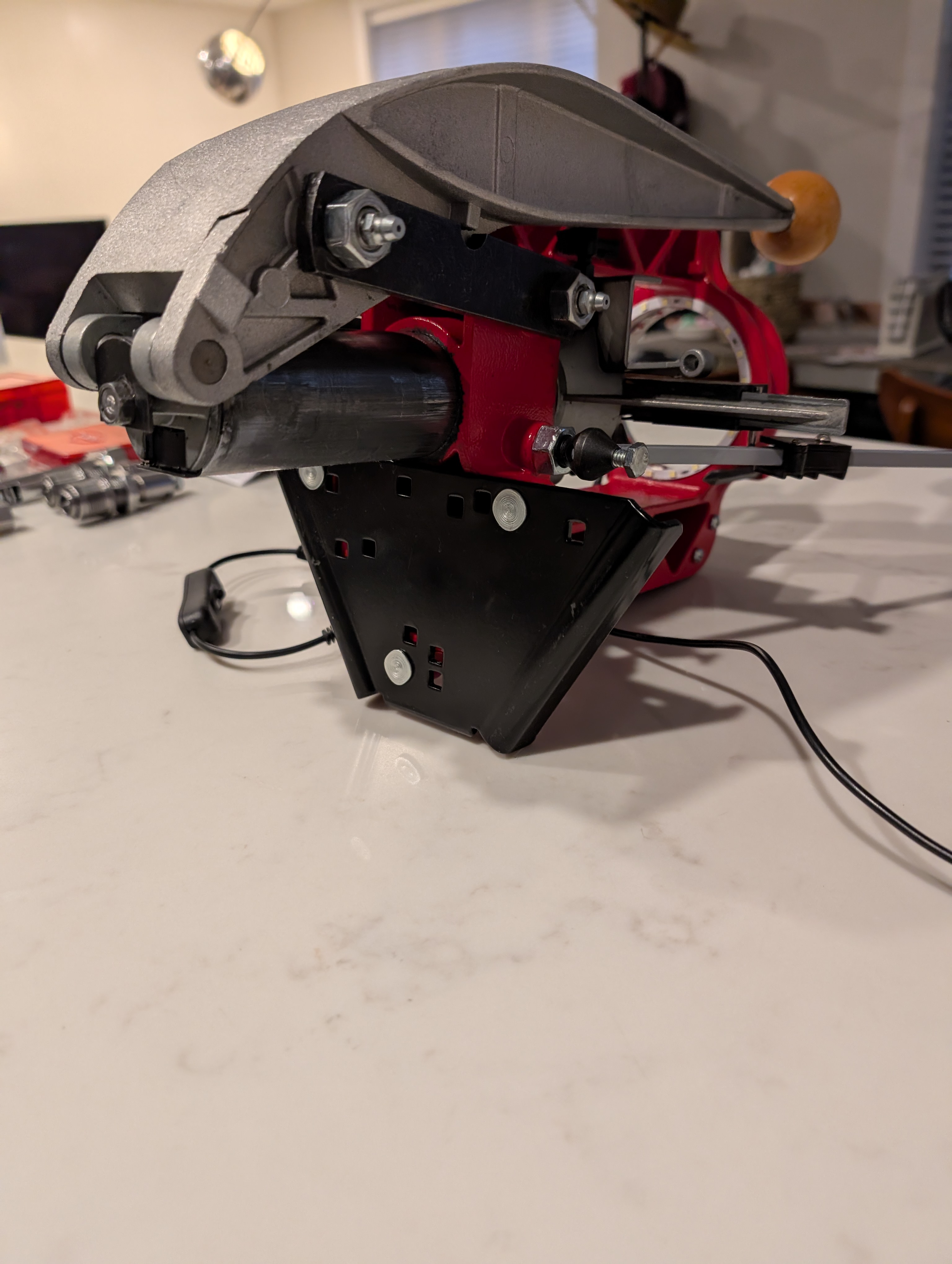

SOLD Lee load master turret press.
Selling only as a compliment package.
3 shell plates, 2L, 5L and 4S.
Other accessories as can be seen in the pictures.

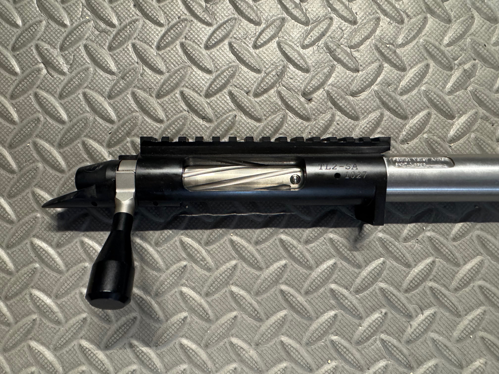

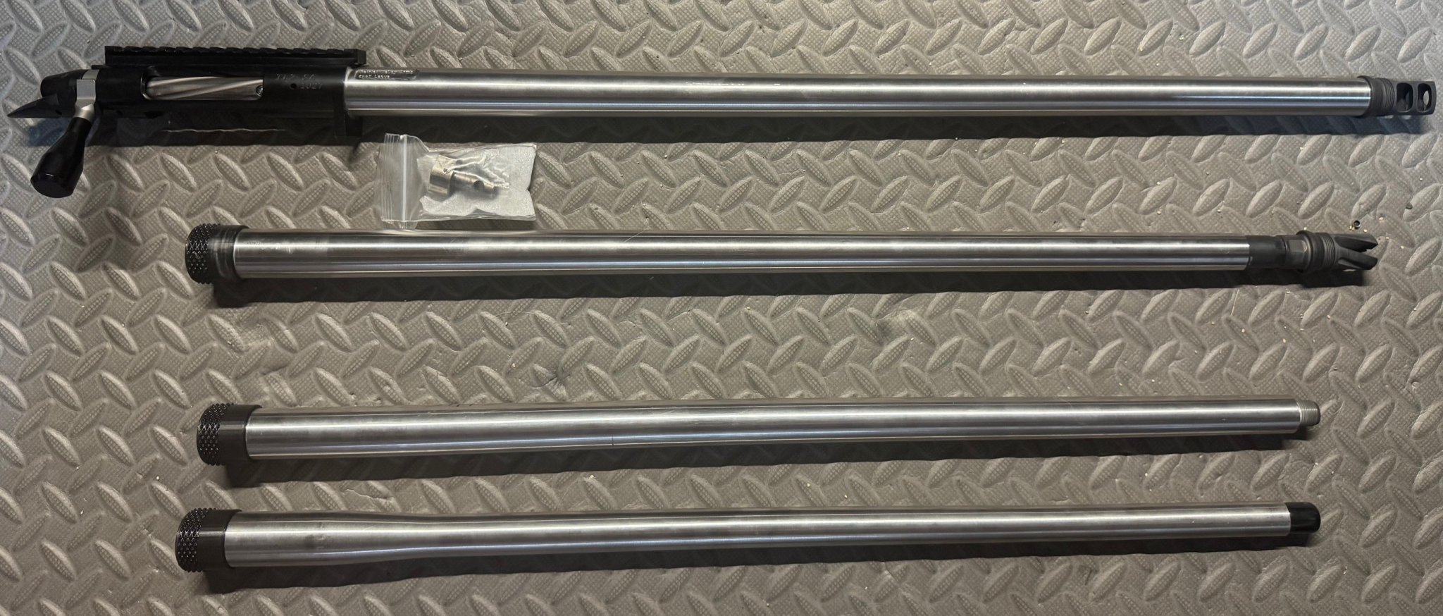

SOLD Bighorn TL2 BA 6x47&223
Bighorn tl2 dlc coated extremely smooth action (can send video of it running on the range)
Comes with
-3 6x47 barrels 26" 5/8threaded 1-has 1000 rounds 2-has 500 3-is brand new
-1 223 barrel 26" 5/8 thread has around 600 rounds on it
-223 bolt head
-300 plus 6x47 lapua brass
-6x47 foster fl die
Thunderbeast breaks are not included
This gun shoots lights out I have a load for both calibers I will give to the buyer. Included are some pictures of it in the stock nothing in those images is included besides the barreled action.
Only selling to pickup another impact.
Only trade would be for an impact 223 barreled action or other caliber impact ba
$1600 shipped to the lower 48
