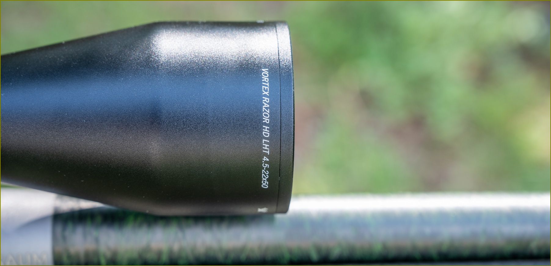

Rifle Scopes Vortex Razor HD LHT FFP 4.5-22x50 Review and Comparison to Bushnell ET LRHSi 4.5-18x44
The 21.7 oz Vortex Razor HD LHT FFP 4.5-22x50 represents the best crossover design we’ve seen to date if saving weight is your primary goal.

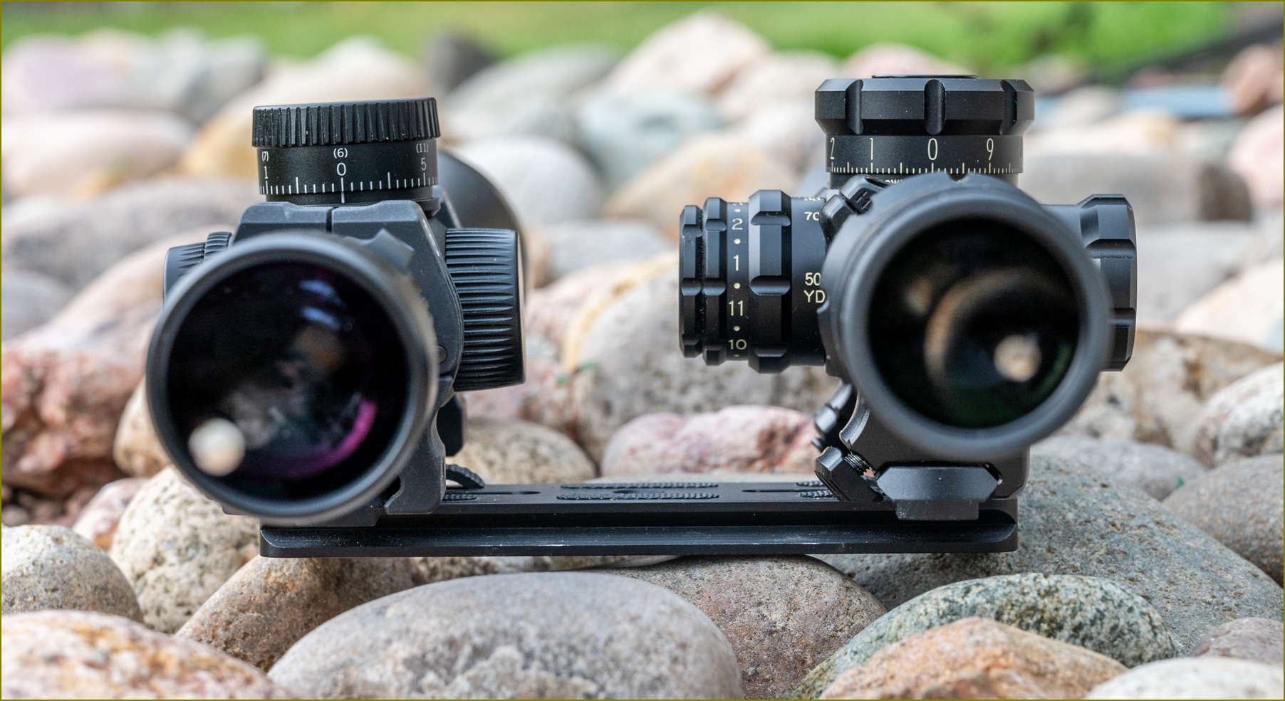

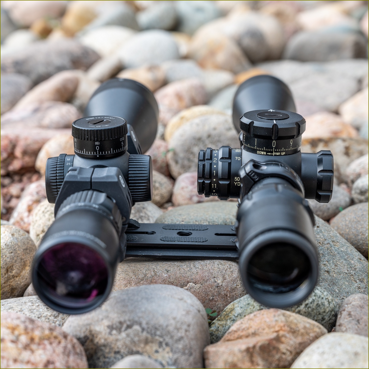

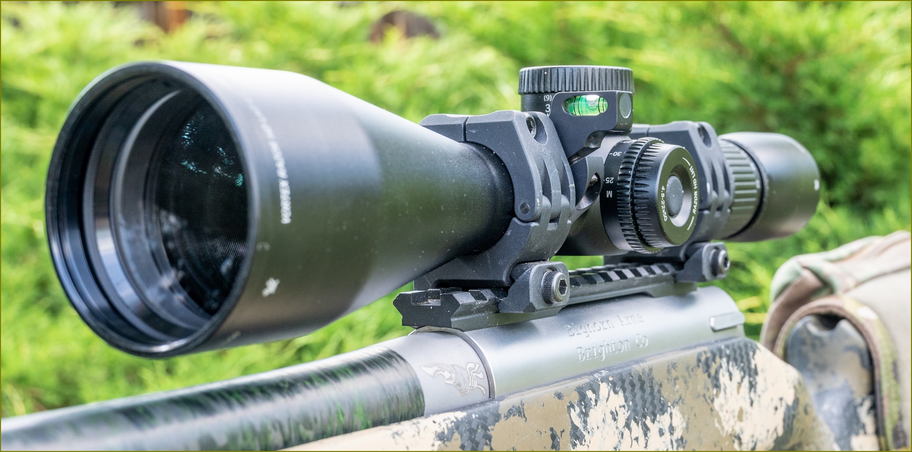

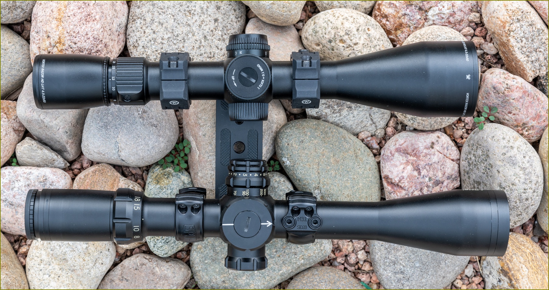

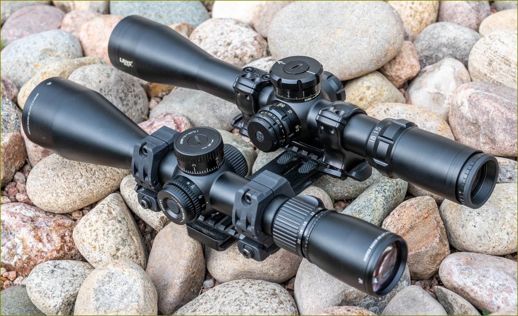

Vortex Razor HD LHT FFP 4.5-22x50 and Bushnell ET LRHSi 4.5-18x44
For a number of years now the Bushnell Elite Tactical series has represented some serious value for what you get – price/performance but when Bushnell came out with the LOW designed LRHS it brought mixed results, the magnification range seemed odd (4.5-18) and the shear size (length) of the scope seemed to put some off; however, the weight of the scope was a refreshing sight for the crossover community coming in at under 27oz. For those used to “cheaper” SFP scopes this scope made little sense but for those who preferred the benefits of a FFP scope it soon became a common recommendation whenever threads popped up asking for “Lightweight FFP scopes”. Bushnell soon came out with the exact same scope but in LRTS form with a different reticle aimed more at the tactical community rather than hunting although I prefer the G2H reticle for both crossover and tactical style (AR platform) rigs due to the extreme usability at the bottom of the magnification. But outside of some blowouts the LRHS and LRTS series soon began to disappear and one had to wonder if a replacement was coming and sure enough, early in 2021 GAP announced they had Bushnell design a new LRHS2 and many speculated (including myself) that the new scope would be shorter and lighter than it’s predecessor; and much to the dismay of many, that was not to be the case, instead of designing a new scope GAP/Bushnell opted to use the same exact optical formula as in previous generations but replacing the glass elements with the new ED Prime glass. So why am I NOT comparing the new Vortex with the latest scope from GAP/Bushnell and I can sum that up in two words “NO ILLUMINATION”. Yes, I’ve seen George’s posts about how illumination is not needed with the reticle design but having the same G2H reticle in my LRHSi I can tell you that in low light situations the illumination certainly does help. Is illumination “needed”, that is for each individual to decide but I come from the group that believes “better to have it and not need it rather than needing it and not having it”. So this review will focus on the aspects that make a great crossover scope.
In the image above you can quickly see that the Vortex LHT is shorter than the LRHS series, the 50mm objective bell also looks quite a bit larger which leaves one wondering what engineering genius did the Vortex engineers come up with to shave off so much weight, and were any compromises to durability made to achieve such. My preliminary review does not have enough time in the field to give you a full report; however, Vortex’s reputation with the Razor line is pretty well regarded so my expectations are that this scope will hold up well to crossover use in the field, but for more conclusive results let’s wait until after the big fall hunting season to hear if anyone has experienced adverse effects during field use before we jump to conclusions not based in real world experience.

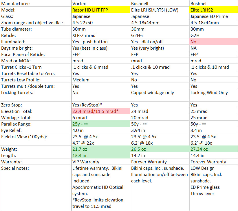

SPECS
The below specs are provided by the manufacturers which provides a good baseline for what these scopes offer. Vortex and Bushnell LRHS2 are highlighted in yellow as they are new for 2021. Highlighted in red is a potential drawback and in green is a potential benefit. Why did Vortex go with 4.5-22 range instead of 4-20 I cannot tell you but I wish it was the latter, I think a 4-20 scope has more use as a crossover design than does a 4.5-22 and some could even argue a 3.5-18 would have been even better, but since no other scope even comes close in weight I'm willing to let that go for now but it does open the door for another competitor down the road.

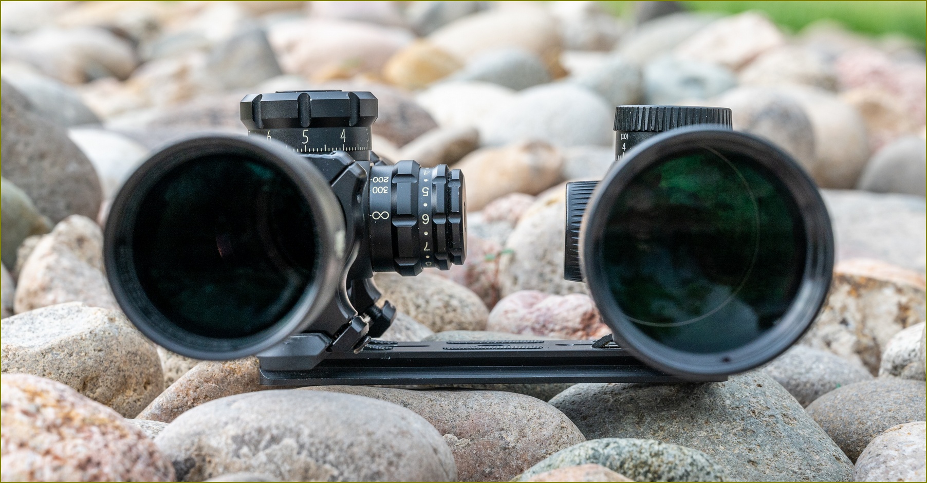

As mentioned previously, one of the most notable differences comes in size, the Bushnell represents the traditional “long” scope design while the Vortex LHT represents the newer trend of “short” scope designs and is about an inch shorter than the Bushnell while offering greater magnification range. But other areas of note are:
  • Weight: The Vortex is about 5 ounces lighter
  • Field of view (FOV): Both scopes match exactly at 4.5x, these are not wide angle eyepieces like with the Burris XTR III
  • Close focus distance: Bushnell has a typical 50y while Vortex offers down to 25 yards
  • Zero Stop: Bushnell has a zero stop that does not interfere with the elevation travel while Vortex’s RevStop limits travel to just 11.5 mrad.

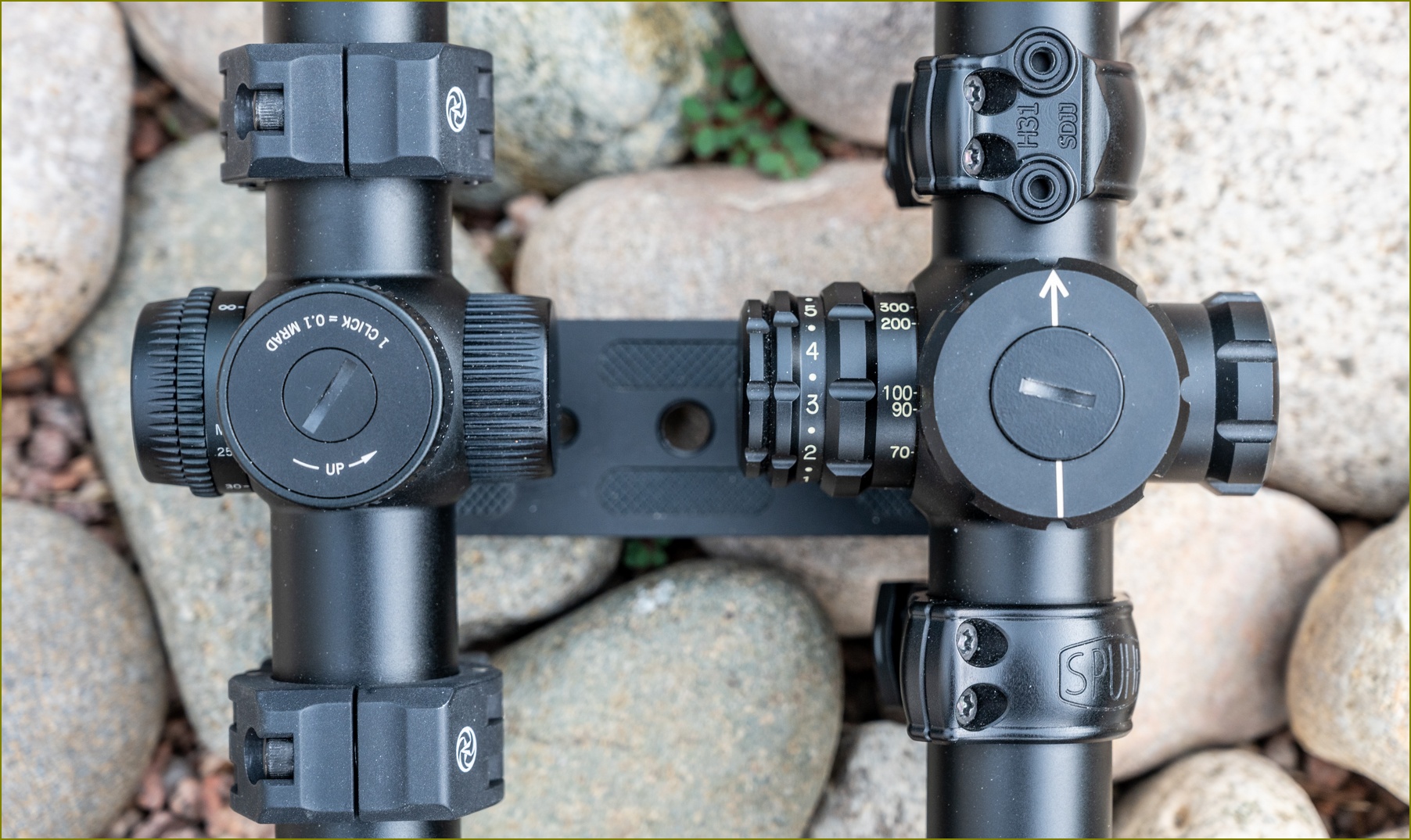

TURRETS
This review does not cover the accuracy of each scope but covers the functionality – since any manufacturer is capable of producing a lemon it’s always a good idea to test your scope to ensure its mechanical accuracy.

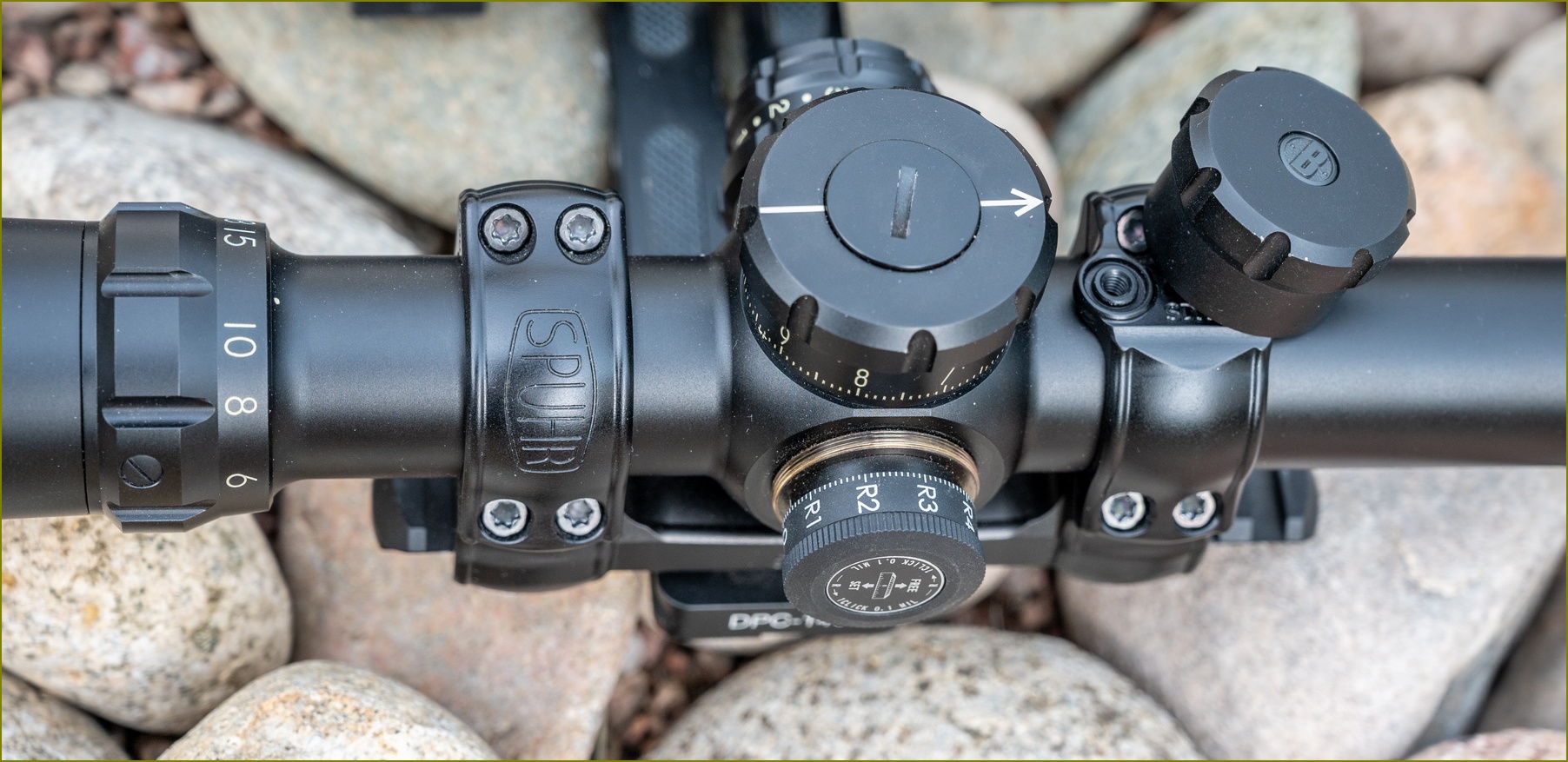

Bushnell Elite Tactical LRHS/LRTS Turrets
The LRHS/LRTS style have always been decent turrets, not too high and being pretty large in diameter allows a secure grip even if wearing gloves. Turrets have had a good track record of being repeatable. Capped windage which is a nice feature for a crossover scope that isn’t going to be dialed for wind.

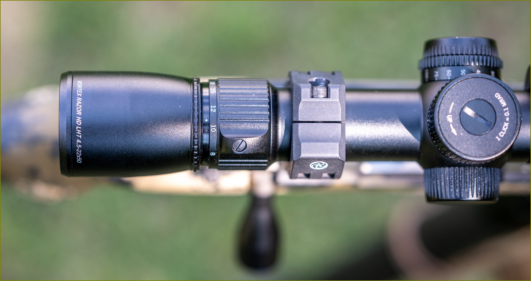

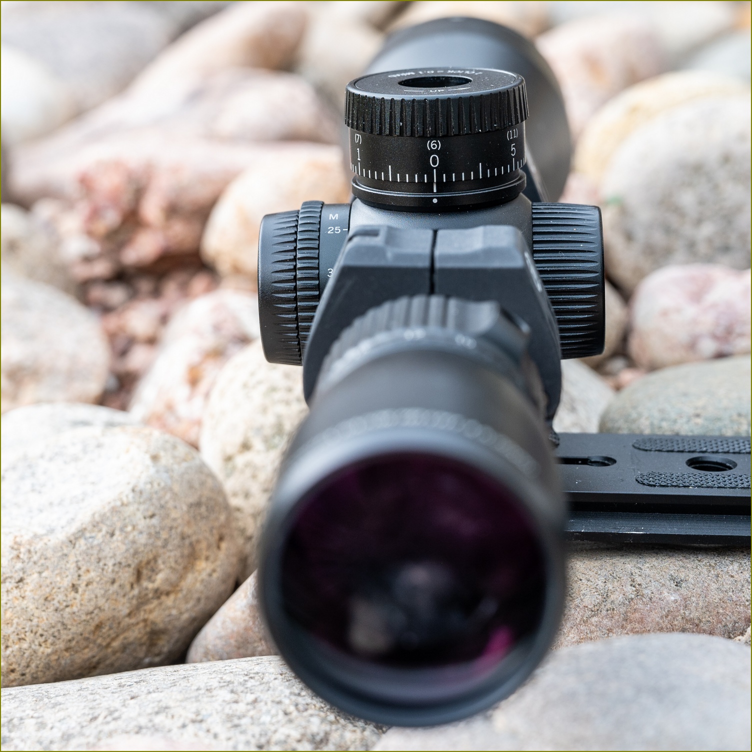

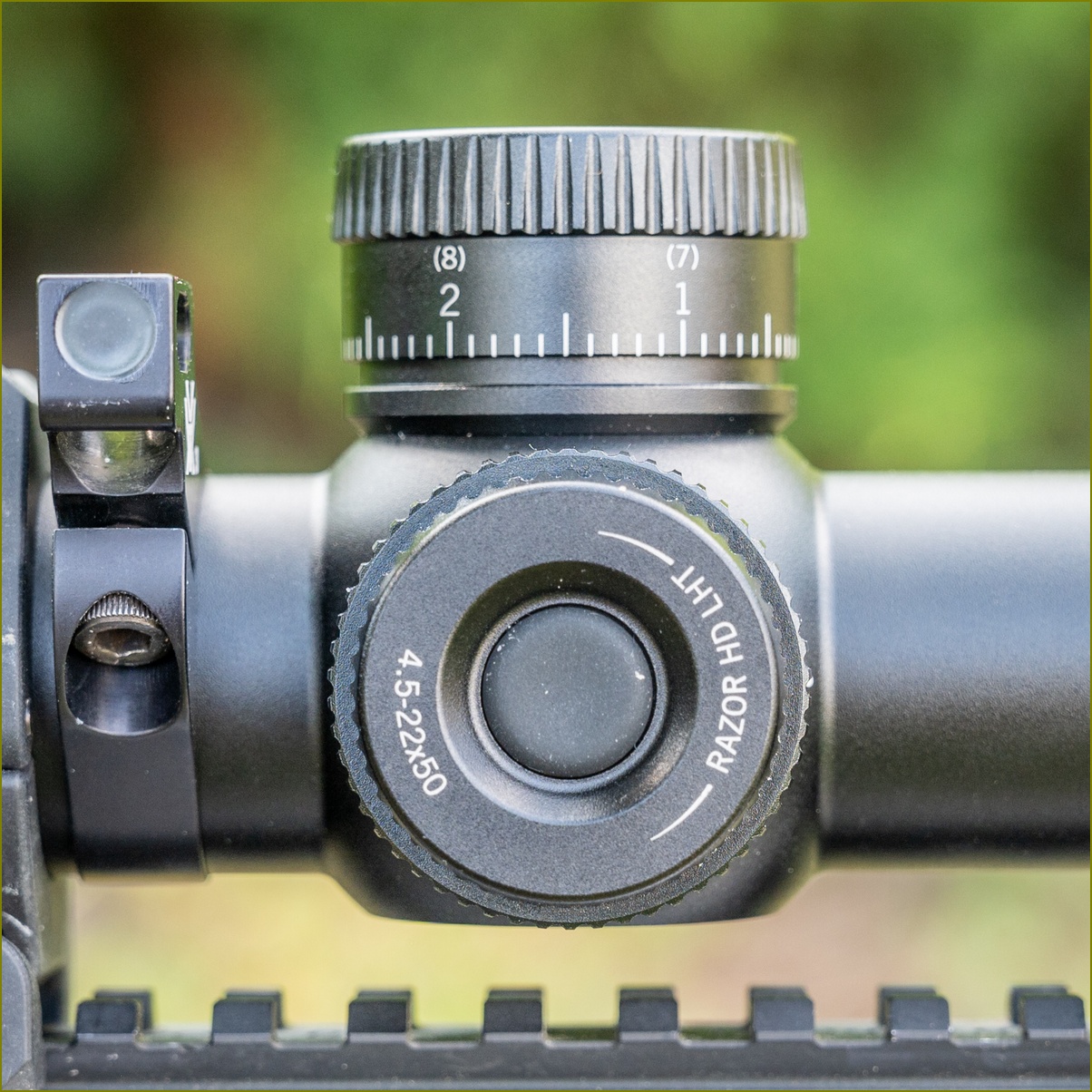

Vortex Razor HD LHT turrets

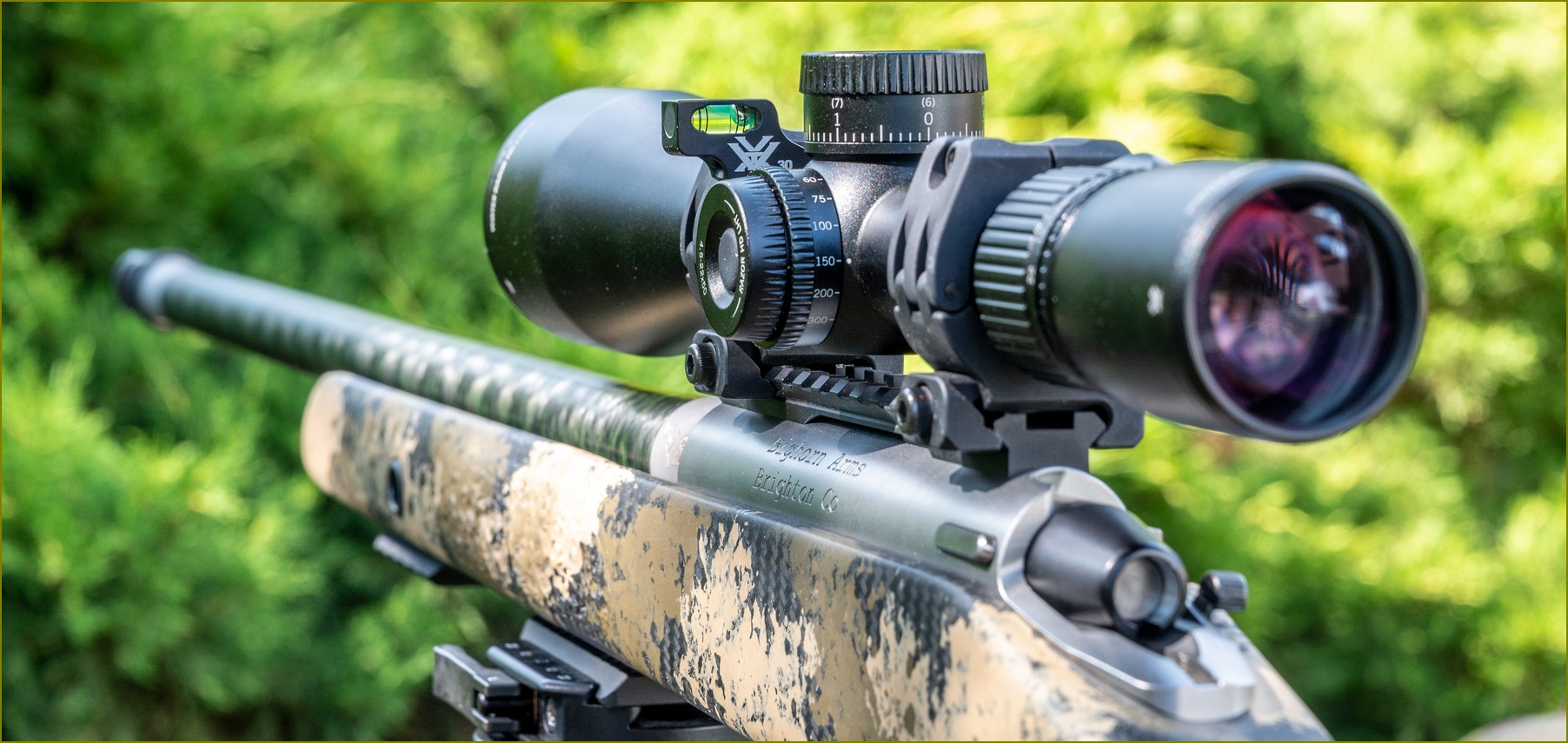

Being a brand new design and part of Vortex’s revered Razor line I have to be honest and say I was expecting a bit better turret here (with regard to feel), but having had some experience with the previous LHT SFP 3-15 scope I would say the turrets have pretty much the same feel which is to say they are decent. Capped windage which is a nice feature for a crossover scope that isn’t going to be dialed for wind. Neither of these scopes offer anything close to a Tangent Theta experience.
Turret in the unlocked position
Turret Mechanical Assessment criteria (rating 1-10 with 1 being worst and 10 being best):
Turret Click Spacing – Advantage Vortex LHT: Vortex LHT – 8 | Bushnell LRHS – 7
This is more or less a personal preference, but my hand feels better with wider spacing. While the Bushnell has a larger diameter elevation turret it is 10 mrad per rev and the Vortex is only 6 mrad per rev giving it a slight spacing advantage.
Turret Click Feel – Advantage Vortex LHT: Vortex LHT – 7 | Bushnell LRHS – 6
This can be very subjective, but I am drawn to more distinct click sounds with very little play between marks, the Vortex has distinct clicks with little play that is somewhat muted, the Bushnell has more “wiggle” between clicks and also muted.
Turret Alignment – Advantage Bushnell LRHS: Vortex LHT – 8 | Bushnell LRHS – 6
Both Bushnell LRHS and Vortex LHT turrets aligned perfectly through my testing running the turret out to the extreme and back. Because of Bushnell’s translatable design, it does rise pretty high above the center mark which gives a slight perception you are off mark if your eye is not perfectly centered. I much prefer the non-translatable design of the Vortex LHT which does not rise or fall with revs of the turret.
Turret Reset Zero and Zero Stop – Advantage Bushnell LRHS: Vortex LHT – 6 | Bushnell LRHS – 8
In order to reset zero on the Vortex LHT you have to remove the top cap on the turret housing using a coin, flathead screwdriver or cartridge rim, then lift up the turret and spin the turret to align zero and push back down and re-tighten the cap, if you want to have zero stop you must use the included RevStop tool and place it inside the turret mechanism while it is removed; however, use of the RevStop will limit your elevation travel from zero to only 11.5 mrad. The Bushnell uses a similar feature where you use a coin, screwdriver or cartridge rim to remove the turret screw at the top of the turret then remove the turret knob and return it to the turret with the “zero” mark on the knob lining up with the vertical index line on the turret. To reset zero – loosen the three Allen set screws found on the perimeter of the black inner locking ring. Turn the RevLimiter disk clockwise until it contacts the fixed pin at the bottom of the turret. Return the turret screw to top of knob and tighten making sure the knob is in the “lock” position so the knob does not turn while tightening the screw.
Turret Locking Mechanism – Advantage: Vortex LHT – 8 | Bushnell LRHS – 0
No contest here if you’re looking for locking elevation as the Bushnell does not offer it while the Vortex uses a lift up to unlock mechanism similar to that found in the AMG series long range scope.
Total Travel Adjustment – Advantage Bushnell LRHS: Vortex LHT – 5 | Bushnell LRHS – 7
Vortex LHT offers a total of 22.4 mrad of elevation travel but reduced to 11.5 mrad when using the zero stop tool while Bushnell has 24mrad of usable travel even with zero stop. On the windage side the Bushnell offers over double that of the Vortex with 20 mrad of travel vs. Vortex’s 6 mrad.
Overall Turret Mechanical Assessment – Advantage Vortex LHT: Vortex LHT – 42 | Bushnell LRHS – 34 (50 points possible)
If a locking elevation turret doesn’t matter to you the numbers may be a bit skewed because Bushnell gets a zero for their lack of a locking feature, if we were to eliminate the locking mechanism section then the results would be tie with Vortex at 34 and Bushnell at 34.

Mag Ring, Parallax, Diopter and Illumination Mechanical Assessment criteria (rating 1-10 with 1 being worst and 10 being best):
Magnification Ring Movement – Advantage Bushnell LRHS: Vortex LHT – 6 | Bushnell LRHS – 8
There may be sample variance here but I can only assess the scope(s) I have in hand. The Vortex has pretty significant resistance requiring quite a bit of force with just two fingers while the Bushnell has very good resistance using just two fingers.
Parallax knob Movement – Advantage Vortex LHT: Vortex LHT – 8 | Bushnell LRHS – 6
Parallax resistance between both scopes reveals the opposite experience of the magnification with the Bushnell having very tight resistance with the knurling digging in a bit in order to turn while the resistance of the Vortex was very smooth.
Parallax Adjustment – Tie: Vortex LHT – 7 | Bushnell LRHS – 7
Both Bushnell LRHS and Vortex LHT has distance numbers marked, this doesn’t matter much to me as atmospherics can throw off your parallax settings from day to day so I’m almost always turning to a place where image is in focus and parallax eliminated. Both scopes offered very good parallax forgiveness.
Diopter Adjustment – Advantage Vortex LHT: Vortex LHT – 8 | Bushnell LRHS – 6
Both the Vortex LHT and Bushnell LRHS offer a “fast focus” diopter allowing for quicker adjustments, but only the Vortex offers a threaded locking ring to help keep the adjustment from moving after being set. Resistance on both was ideal.
Illumination Dial – Advantage Bushnell LRHS: Vortex LHT – 6 | Bushnell LRHS – 8
Vortex LHT is using a rubber cover over a push button for on/off/setting functionality on the side of the dial, when at the top or bottom of the highest or lowest settings the illumination will flash letting you know the next push of the button will be in the opposite direction. The Vortex will remember the last setting after turning off so when turning back on it will revert to the previous setting. To turn off you must hold the side button in for more than three seconds. I find the Vortex to be difficult to quickly adjust up or down. Bushnell LRHS uses a dial with on/off positions as you rotate from lowest to highest power settings with on/off in between which gives it an advantage.
Overall Mag Ring, Parallax, Diopter and Illumination Mechanical Assessment – Tie: Vortex LHT – 35 | Bushnell LRHS – 35 (50 points possible)

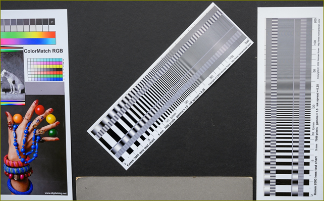

Special Note on Resolution: As you can see in the chart below as you move from left to right the lines get closer together, with each scope I would place the optical center/crosshair where the lines began to blur together and I would note which section that occurred.
MagVortex LHT 4.5-22Bushnell LRHS 4.5-18
4.5x9-10 lp/mm9-10 lp/mm
8x18 lp/mm18 lp/mm
10x20-22 lp/mm20-22 lp/mm
15x33-35 lp/mm35-37 lp/mm
18x38-41 lp/mm38-40 lp/mm
22x41-45 lp/mm

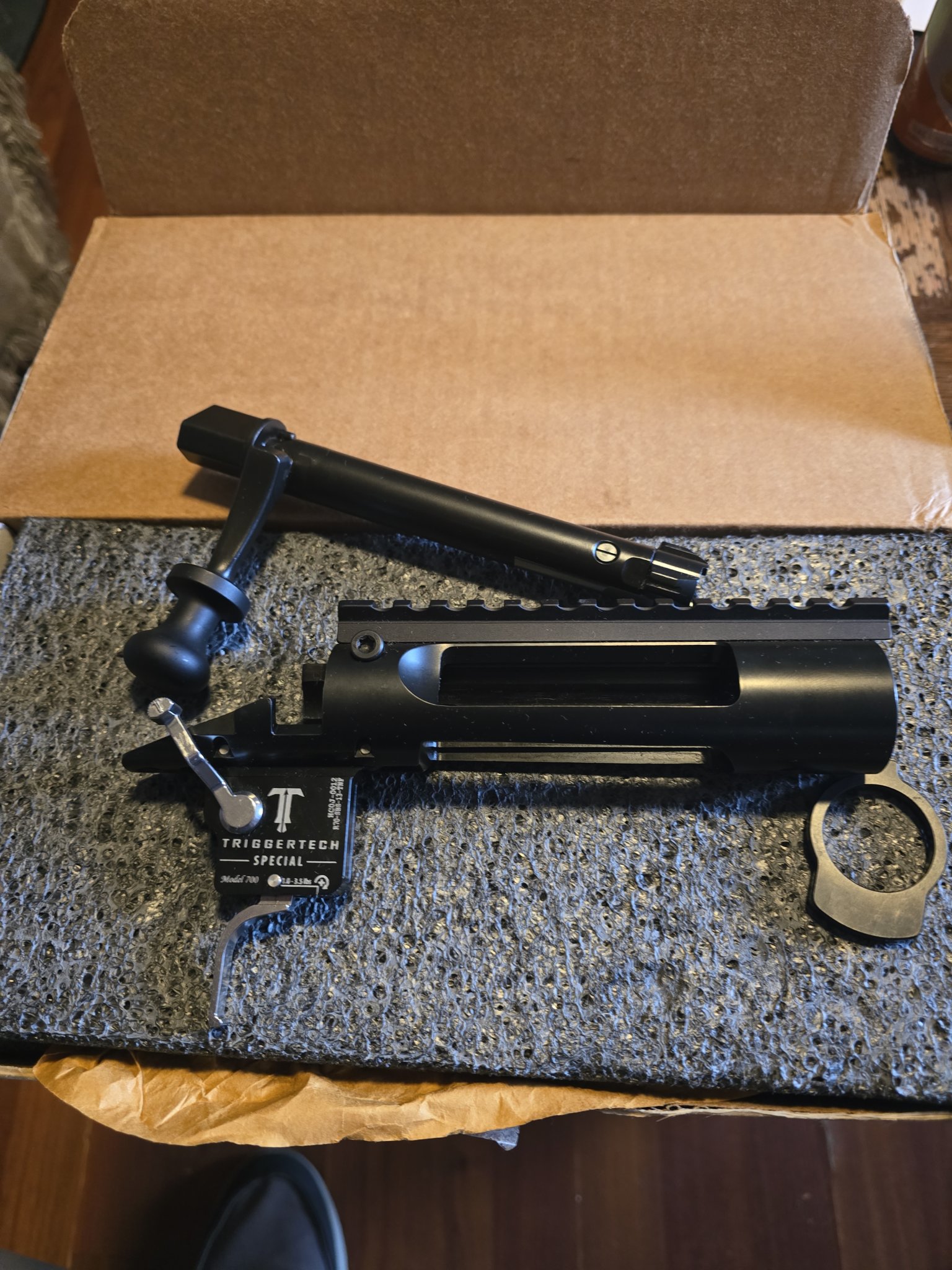

Accessories Traded:: RH- TAC21 CHASSIS- NIB-$400
I bought this on mdt sale. It's for a Rem700 action (not a rem clone with integral rail like my dumb butt has). This is a factory 2nd but it's perfect in every way I can see and NIB.
$400 shipped. If you live close then it could be less but won't be more. I just want my money back which is a ton less than what they cost new.
Trade: chassis for rem 700 clone- RH with adjustable LOP for kids use. Like LSS chassis or some XLR's, but I don't want one that's beat up.
Venmo or cashapp - CONUS

SOLD Manners LRH
Looking to trade a SA Manners LRH w/the mini chassis and OTM tactical DBM
Manners specs
Back in black color palette
Rem 700 SA RH
Mini Chassis
M24/proof sendero barrel inlet
M5 DBM bottom metal inlet
Looking to trade for a lighter FFP mil/mil optic. Something like a Trijicon tenmile 3-18, maven rs1.2.
Would also sell for $1100 TYD
