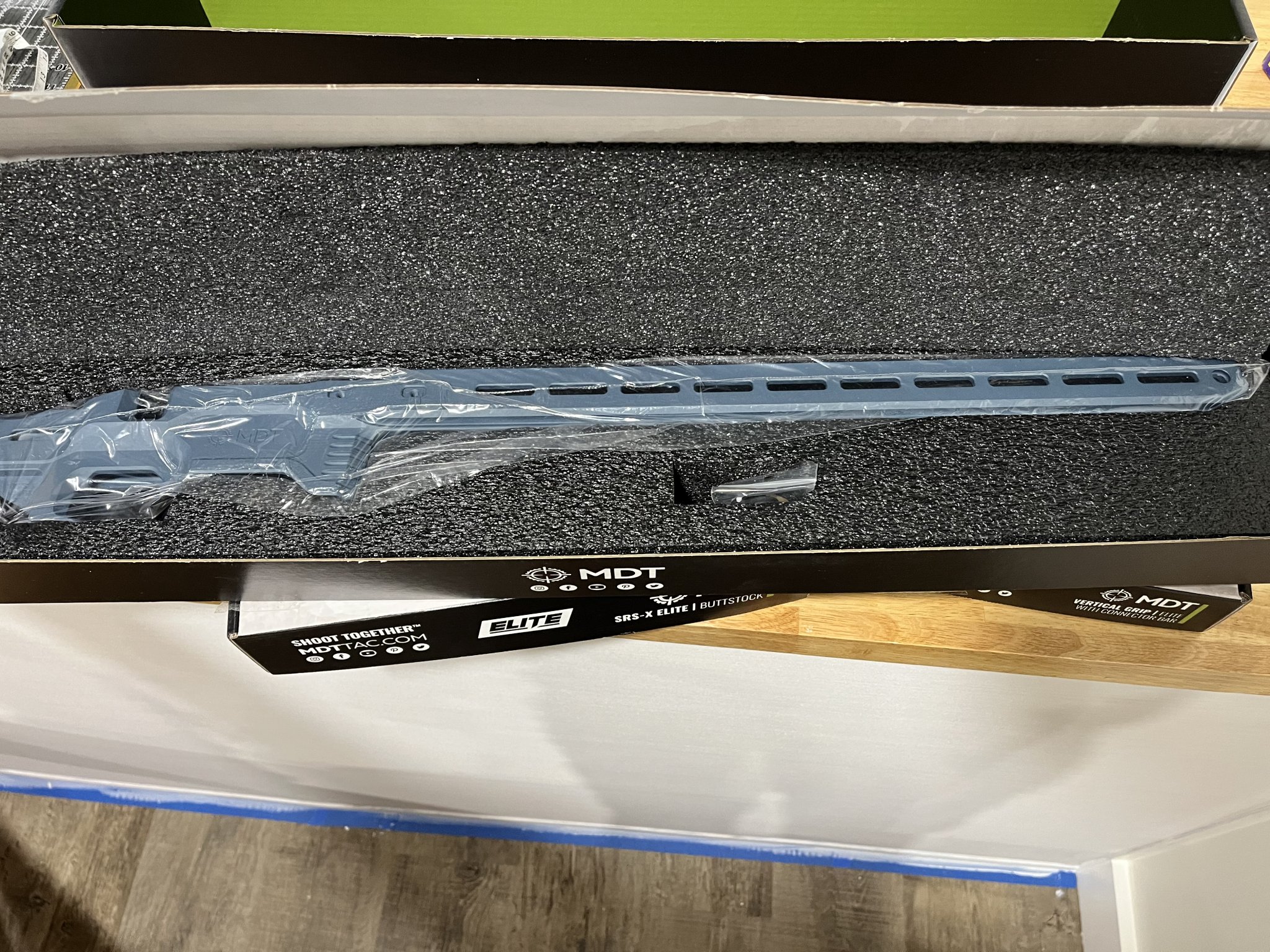

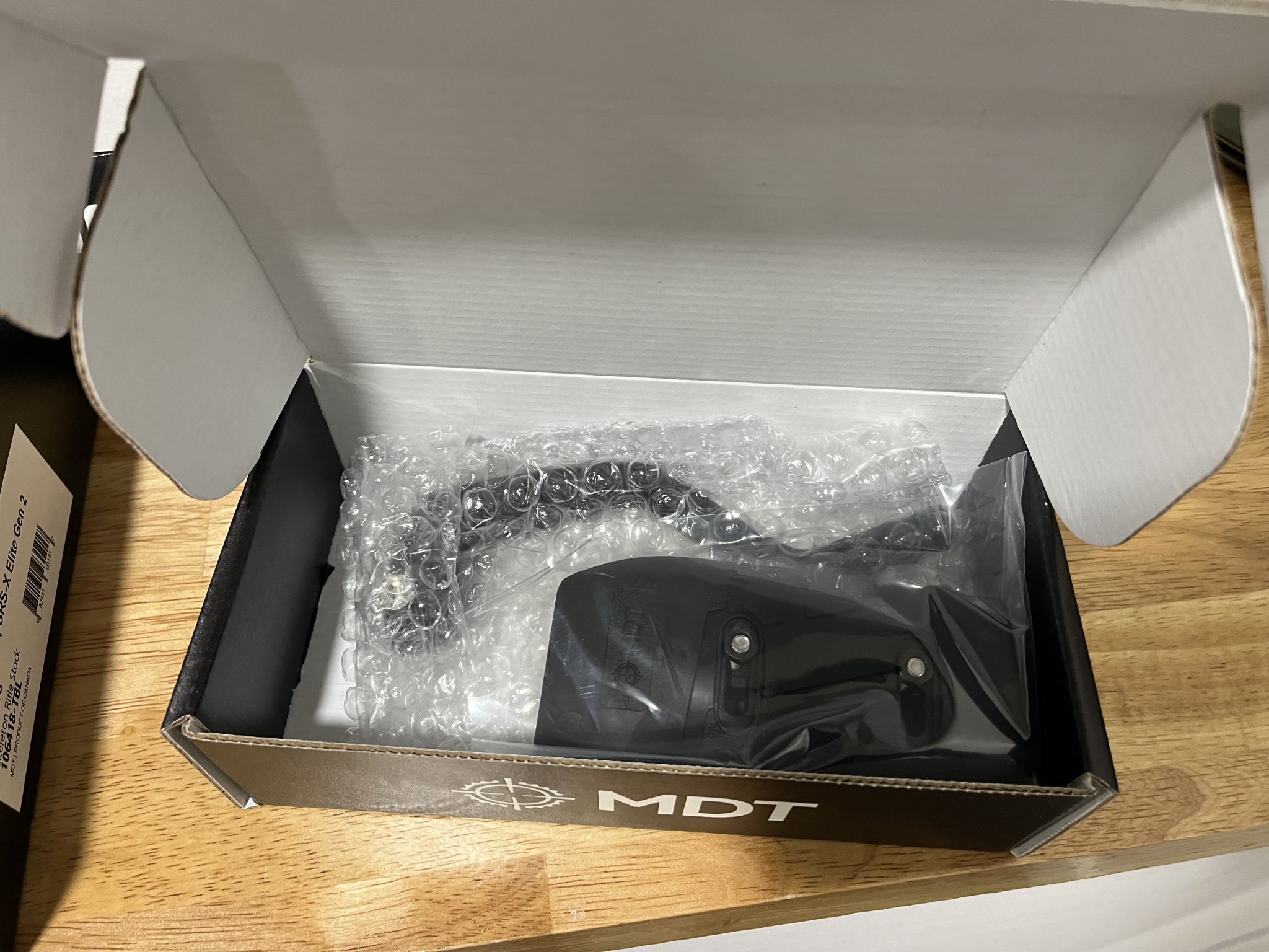

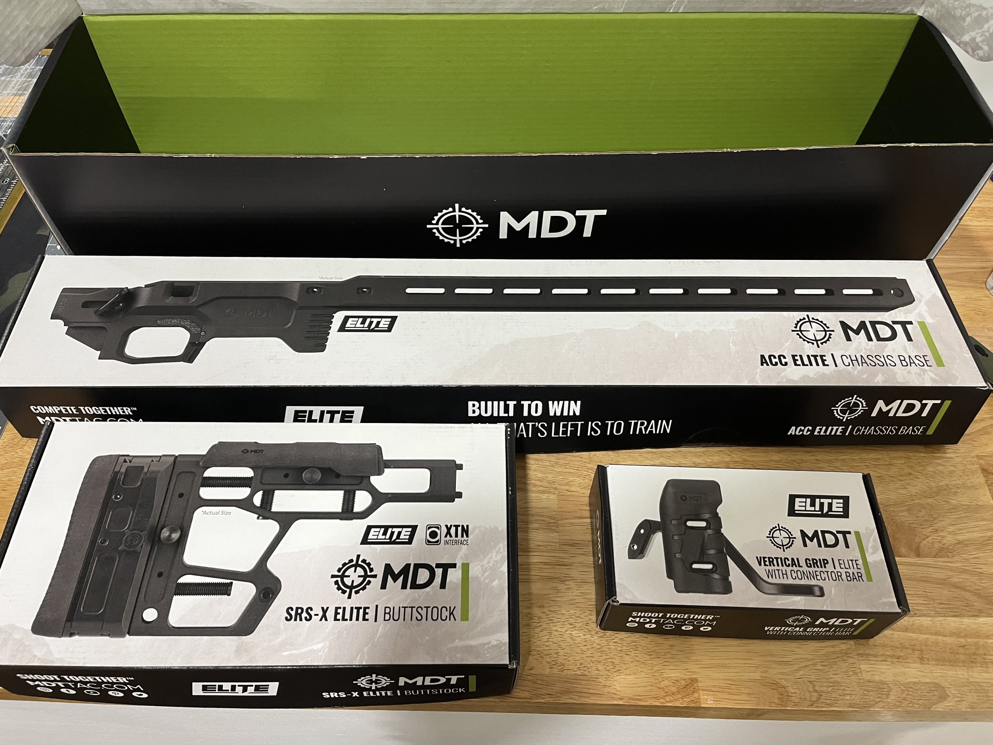

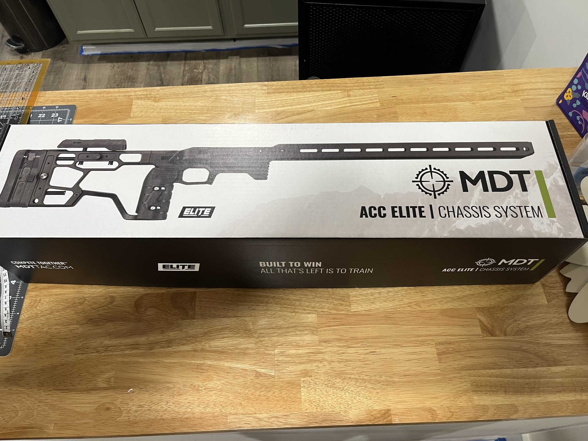

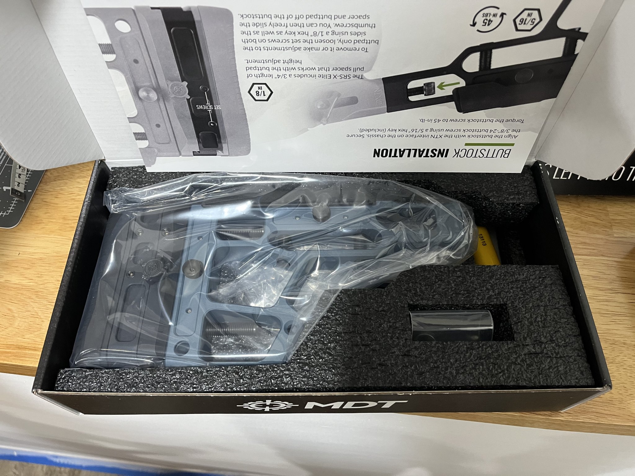

SOLD MDT ACC Elite Titanium Blue R700 SA
Brand new in box ACC Elite in Titanium Blue (see pictures). Offloading some gear from builds I’m not going to complete soon to have extra funds for Christmas. Sold.
