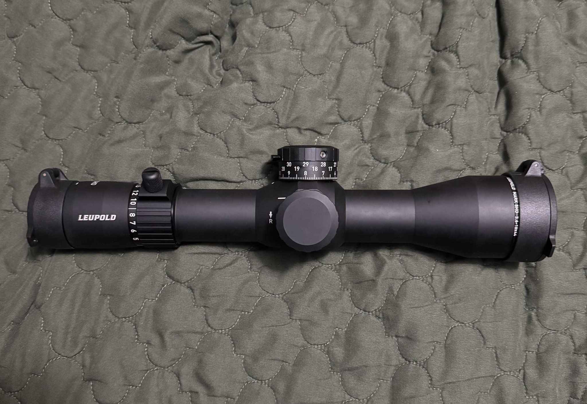

Optics WTT/WTS Leupold Mark 5 3.6-18 TMR MIL
View attachment 8601469View attachment 8601470View attachment 8601471View attachment 8601472Looking to part ways with this, Mark 5 3.6-18 TMR reticle non-illuminated. Would like to trade for the same scope but with pr1 reticle. Or would like a Nightforce with MIL C depending on model I would gladly add cash in my end. Would also go for partial trade for other high end optics Kahles,zco etc. I won’t turn down a reasonable offer if somebody wants to buy it either. Scope is in brand new condition just taking out of the box or pictures.

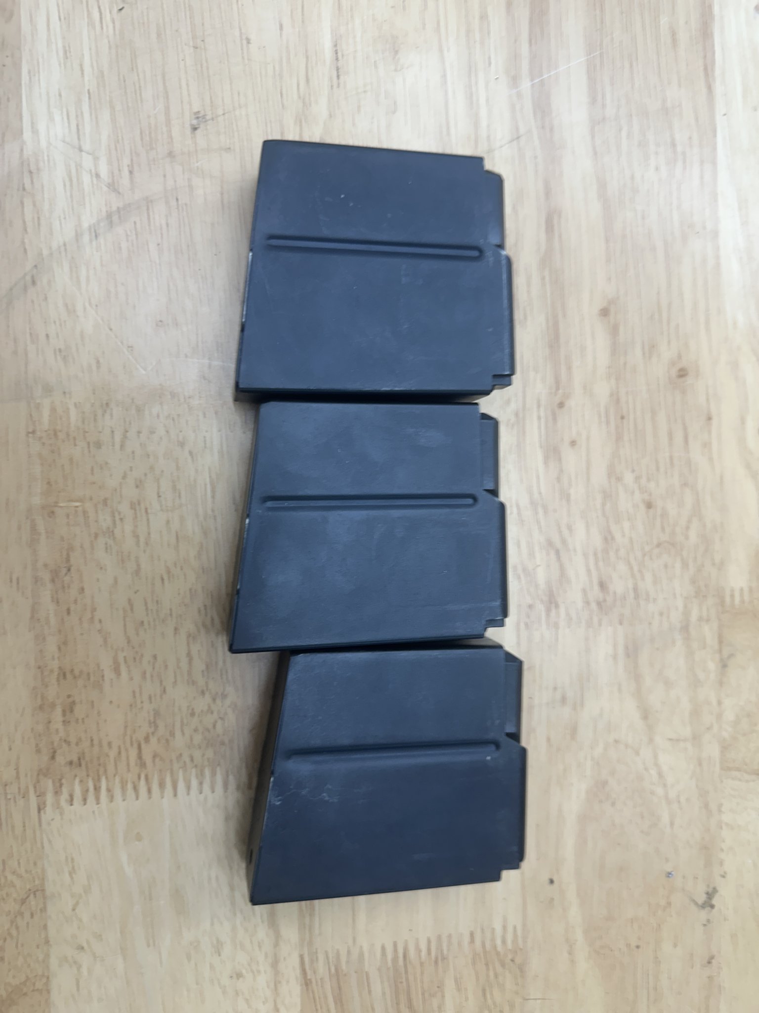

SOLD Bergara B14 HMR 308 and extras
Helping a buddy move this Bergara B14 HMR in 308 with a 20 inch barrel, Primary Arms SLX 5-25 FFP scope in MRAD, Harris 9-13 inch bipod, three 5 round magazines (one Bergara mag and two Magpul mags) and 125 rounds of Hornady 168 grain AMax bullets loaded by Freedom Munitions.
Looking for $1400 shipped for everything listed above. From my FFL to yours.
