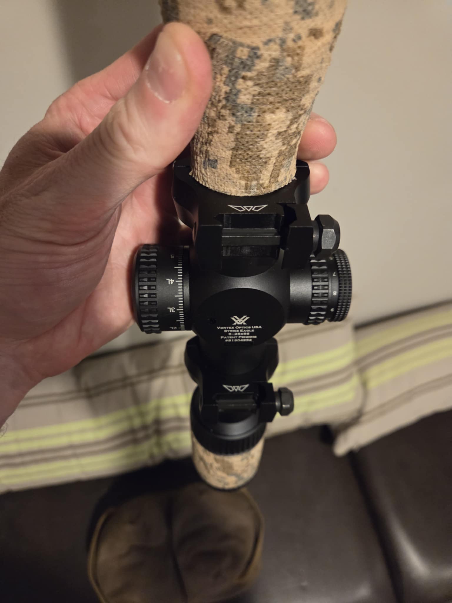

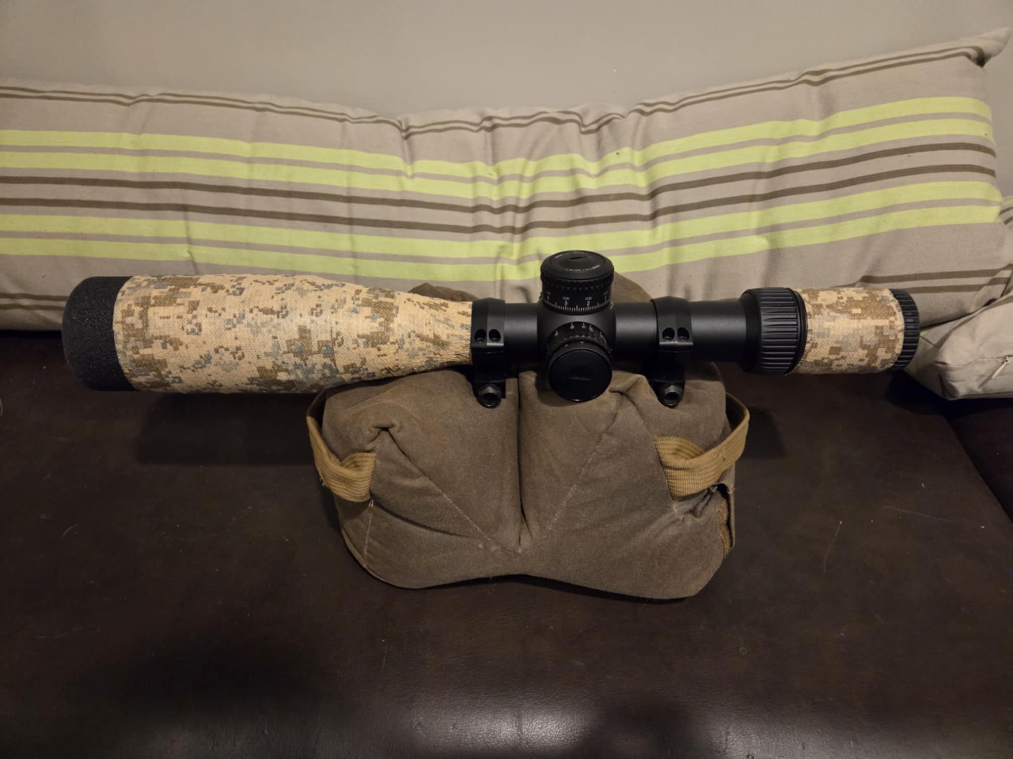

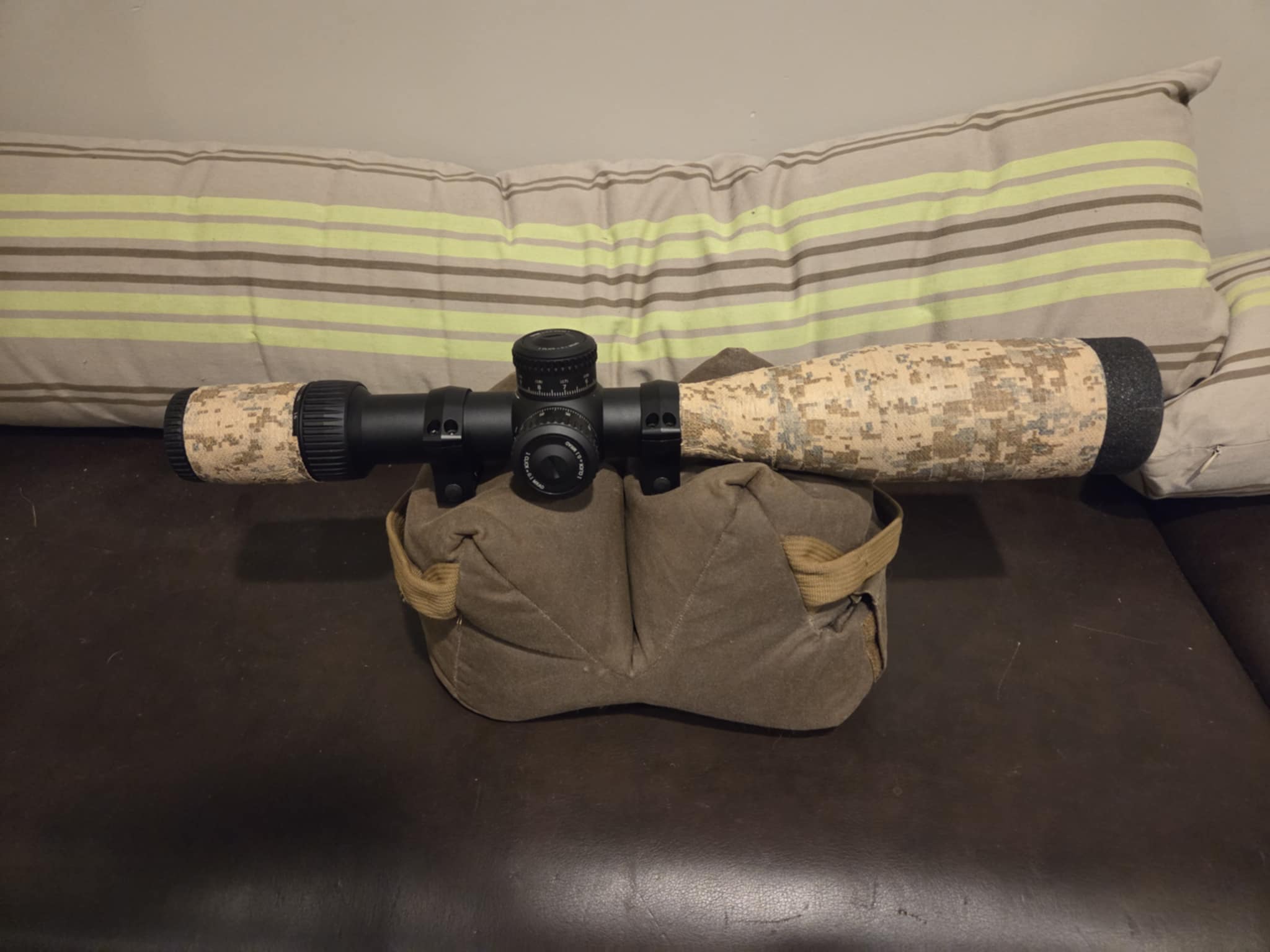

SOLD Vortex Strike Eagle 5-25 mil
Strike Eagle 5-25 EBR-7C mil reticle in Warne rings leveled and ready to shoot.
Not a scratch on it as it's wrapped. Only 200 rounds down it.
$600 shipped F&F or pay the fees Con US

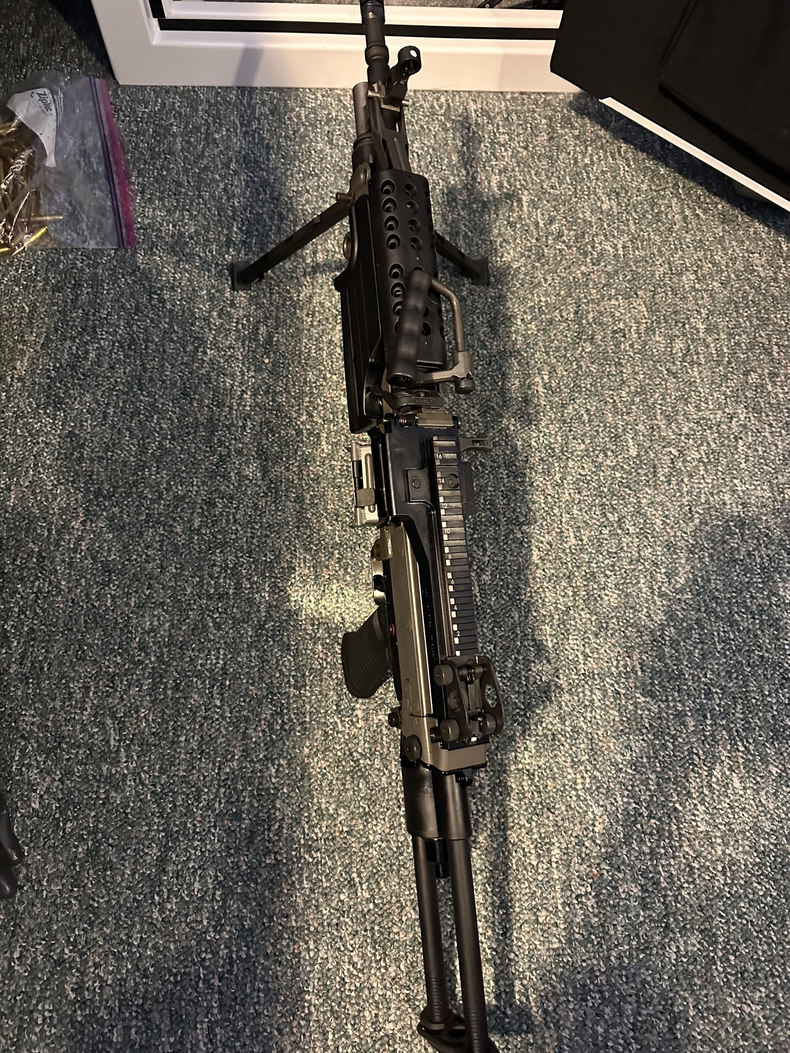

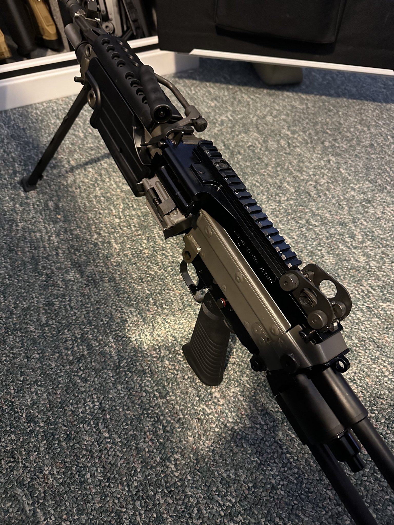

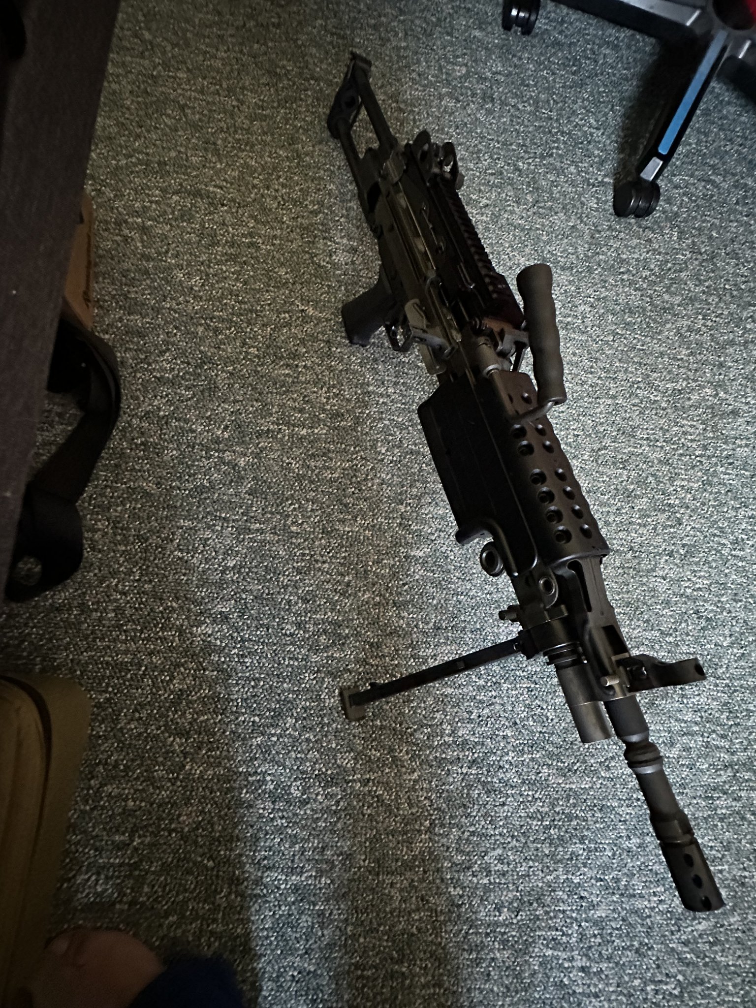

SOLD FN M249s para
WTS Almost new. 150 rounds fired. Nothing wrong with it. Original boxes, manual, magazine, ammo link are included. Asking $8300 shipped. No trades.

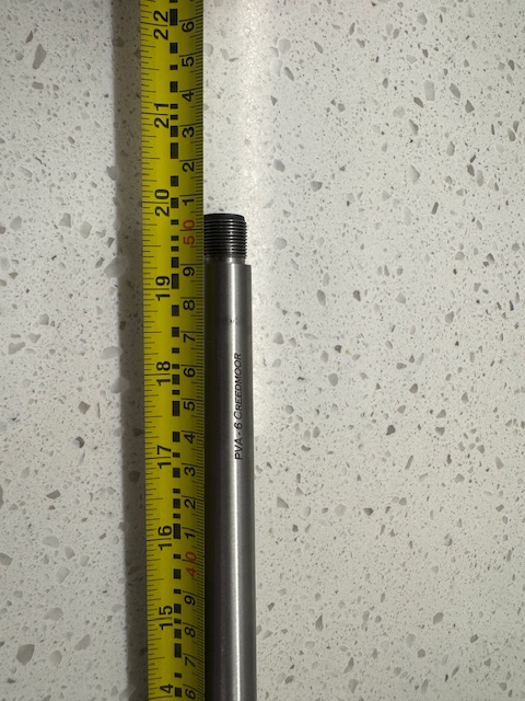

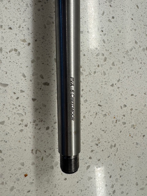

SOLD PVA - 6mm Creedmoor Tikka Prefit
Selling a PVA 6mm creedmoor barrel. This was from the rock creek barrel nut prefit run of barrels. It measures 20” and is their #5 profile. Threaded 5/8-24 and twist is 1-7.5. Selling with barrel nut and has around 140 rounds down the tube. No group photos but has shot eldm and eldx really well. Only factory rounds have been ran in this barrel. Asking $350 shipped
