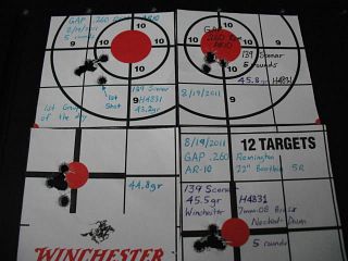

I found some old pics of my very first groups out of the GA Precision-built LR-260 for me, using a Bartlein pipe.
I should shoot it more. Freaking laser. I actually ended up settling on 130gr VLDs because they’re so flat at 1000yds.
I should do the same. Ive got a 20" gap 10 in 260 that I shot my best ever 1000 yard group with. 6 in 5 inches off of a bag and bipod. It does chew up the brass on ejection and shows pressure signs on moderate loads. Thing is kind of a pig and its so much nicer carrying a little Grendel around that she stays in the dark most of the time.
