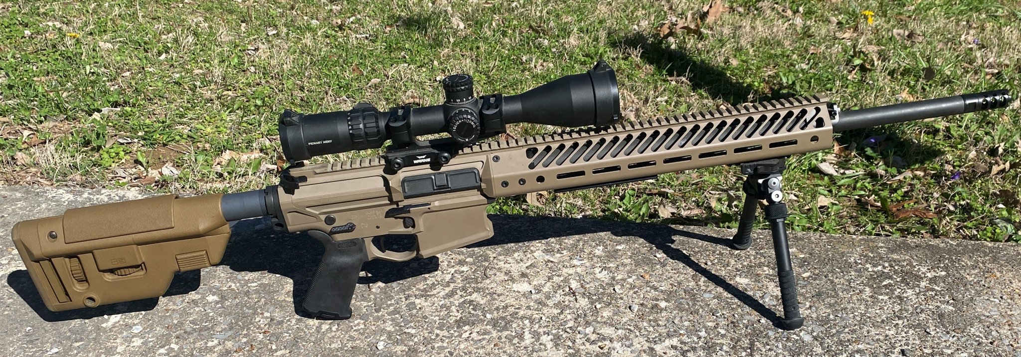

That looks really promising. I’ve been toying with the idea of trying the 153’s in my stick. It’s the identical copy of yours but with a Bartlein Gradous barrel. I’m having outstanding success out to 1600 yds with Berger 140s HT and 144 LRHTs. I’m getting just at or slightly under 2900 with the 140 and about 2830 with the 144s. I feel like the 153.5 is a bit too heavy with a .260 as you can’t get then fast enough to take full advantage of the BC. I think the heavier bullet is better suited to some of the short magnums, 6.5 PRC, etc. I’d be interested to see the wind difference between a 144 and 153 at say 1200+ yds.

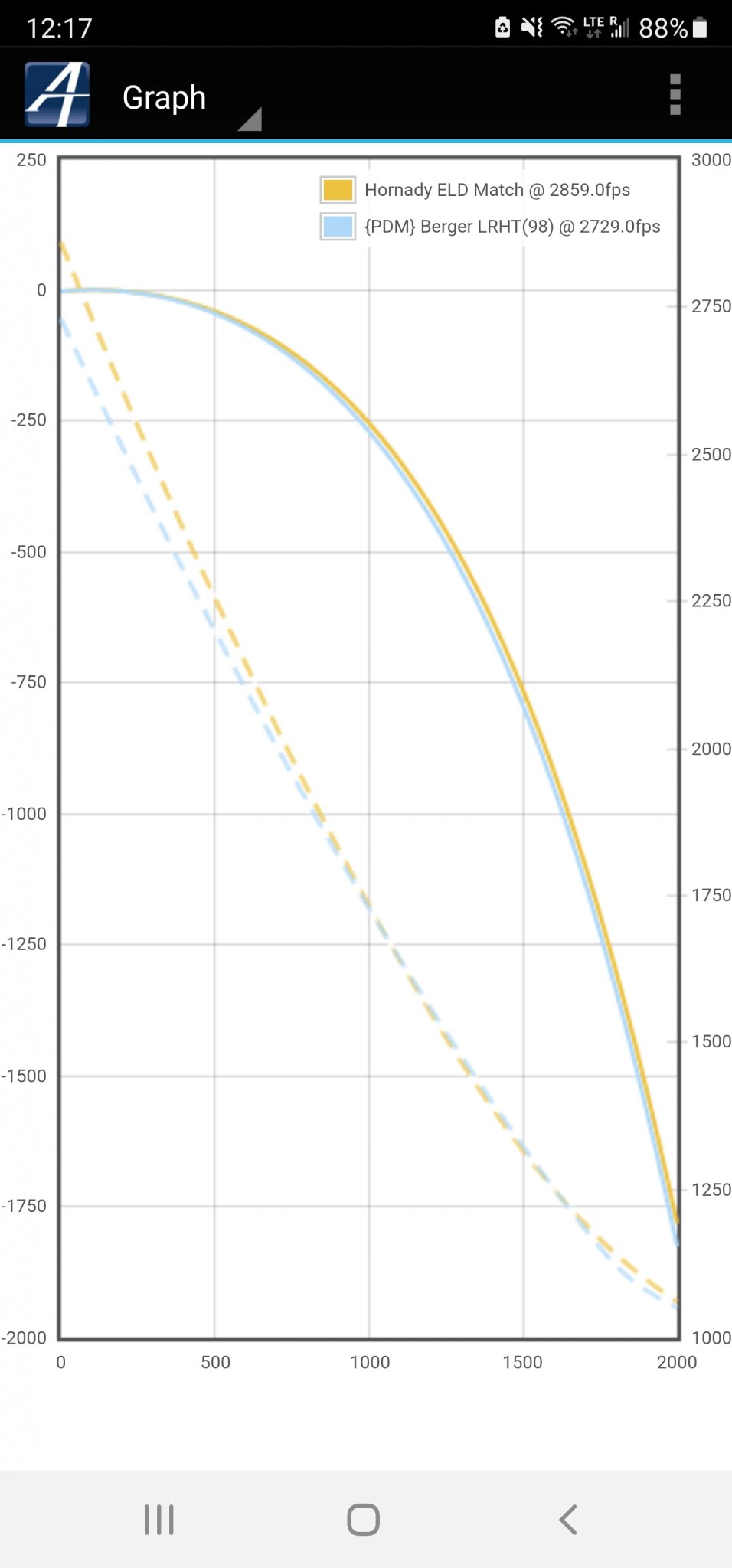

That's pretty much where I'm at as well. I have a really good load worked up w/Hornady 147gr ELD-Ms and I'm not sure that making the switch to the Bergers is worth it, at least not PRS distances I see here.
Here's AB graph for a drop and drift comparison of the 153.5gr vs 147gr ELD-M. Looking at the table, I'm only seeing about 0.10 mil wind drift at the distances I plan on shooting most often.

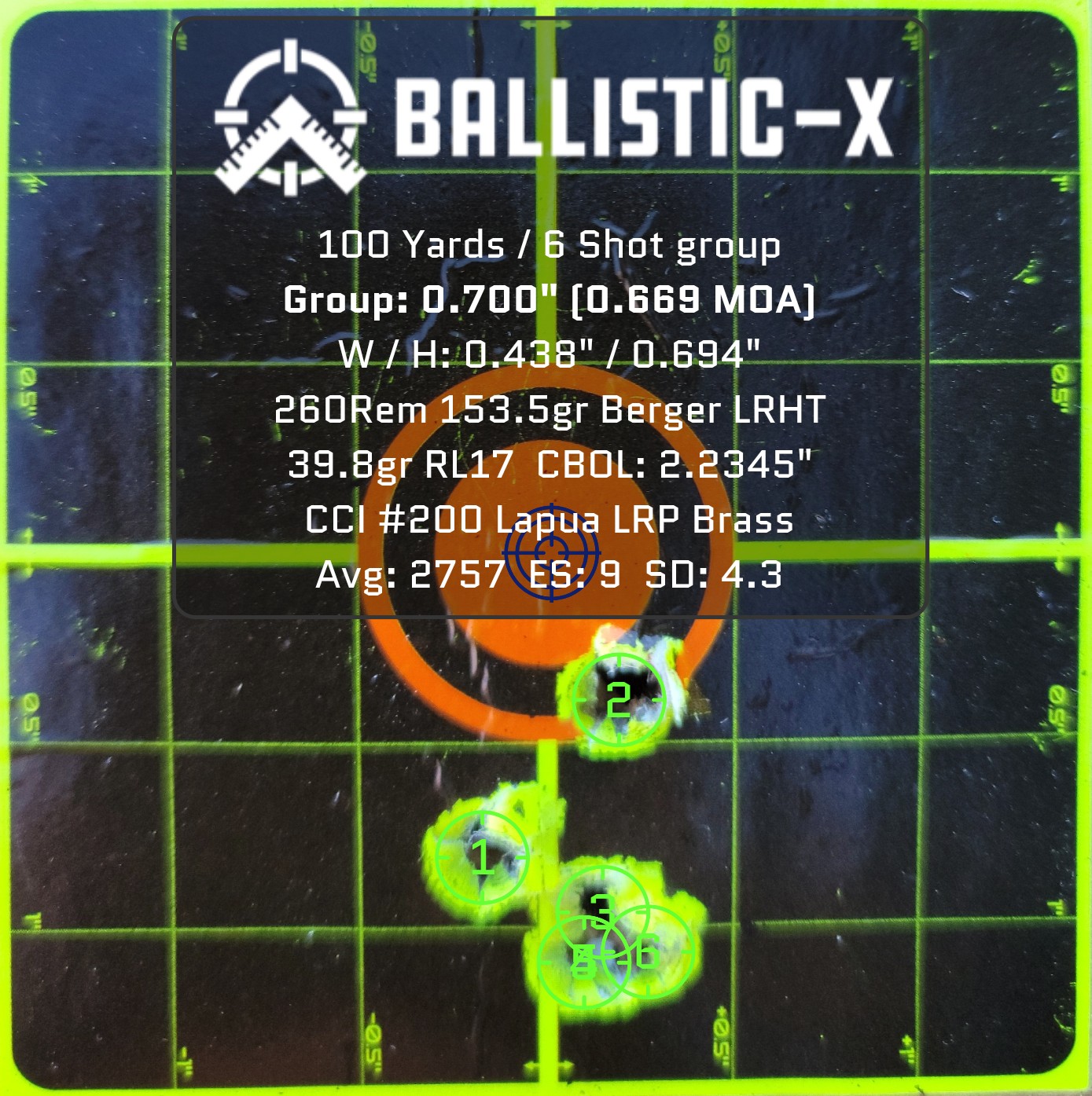

AI AT 26" 1-8 Bartlien bbl
153.5gr Berger LRHT
Lapua LRP & CCI #200
CBOL: 2.2345" / 0.030" off lands
39.8gr of RL17
Avg: 2757 ES: 9 SD: 4.3
Last week, I loaded these up in .3gr increments from 39.5gr to 41gr with RL17. 39.5 & 39.8 both grouped well, both w/SD in single digits. I had heavy bolt lift and ejector swipes at 40.1gr, so I stopped there. The 39.8gr load shot well enough that I decided to just try it.
Loaded up 50 rounds over the weekend and took them out today. Wind was only about 4-5mph from 1-2 o'clock, so no good data on how they handle that. I held center of target and hit all the way out.

Hopefully we'll get a little better wind conditions to see how they handle it. Kestrel showed about a 0.1 mil difference in drift @ 1k and was pretty dead on too. The 147 ELD-M was only7.0mils @ 1k for comparison.

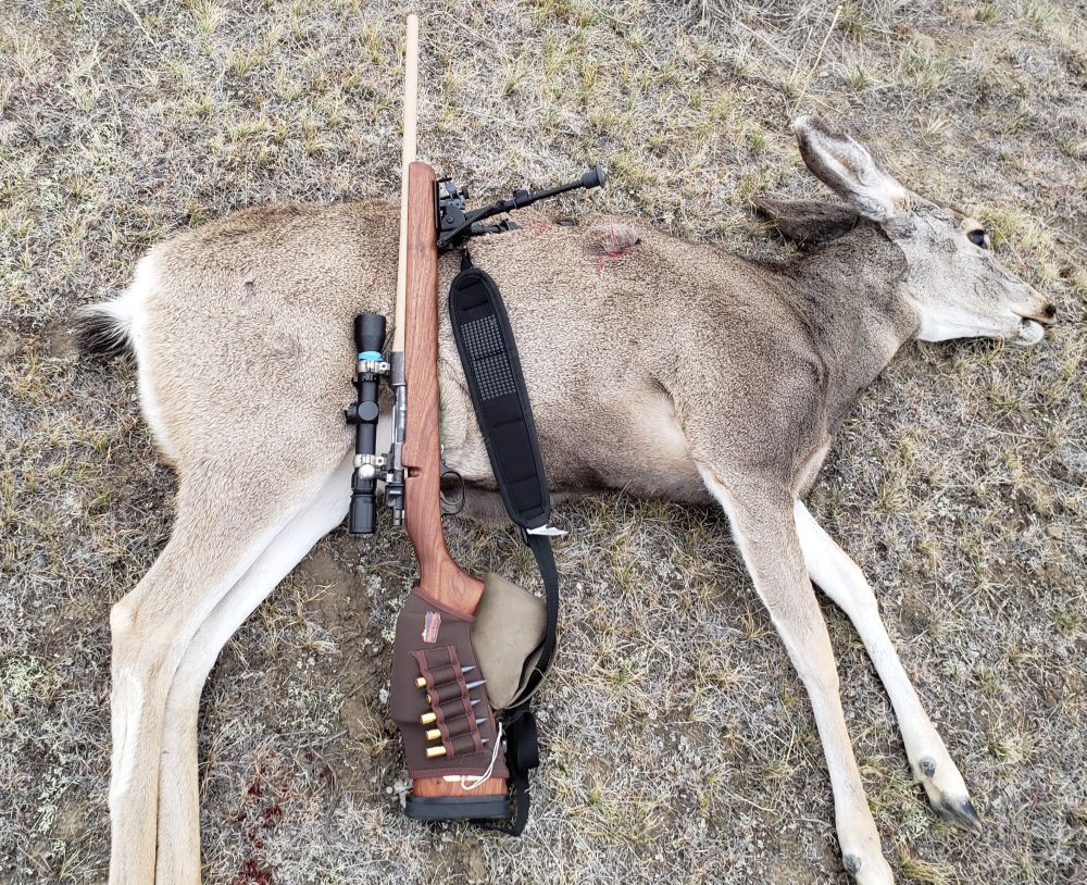

Built a 260 Rem on a 1903 Turk Mauser action, Bartlein barrel throated for 3.1" OAL in September.
Sighted in and got 0.5 moa in October. 46.5 gr IMR-4451, 120 gr Nos Bal Tip, 2934 Quickload, 2849 fps chrono
Shot a deer in October.
Eating the deer in December.

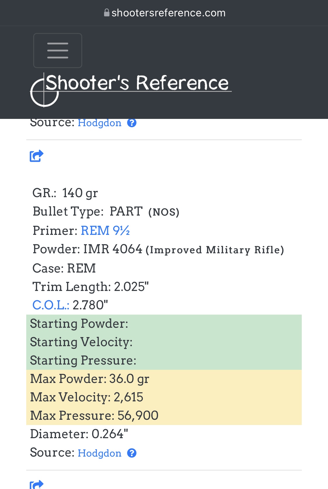

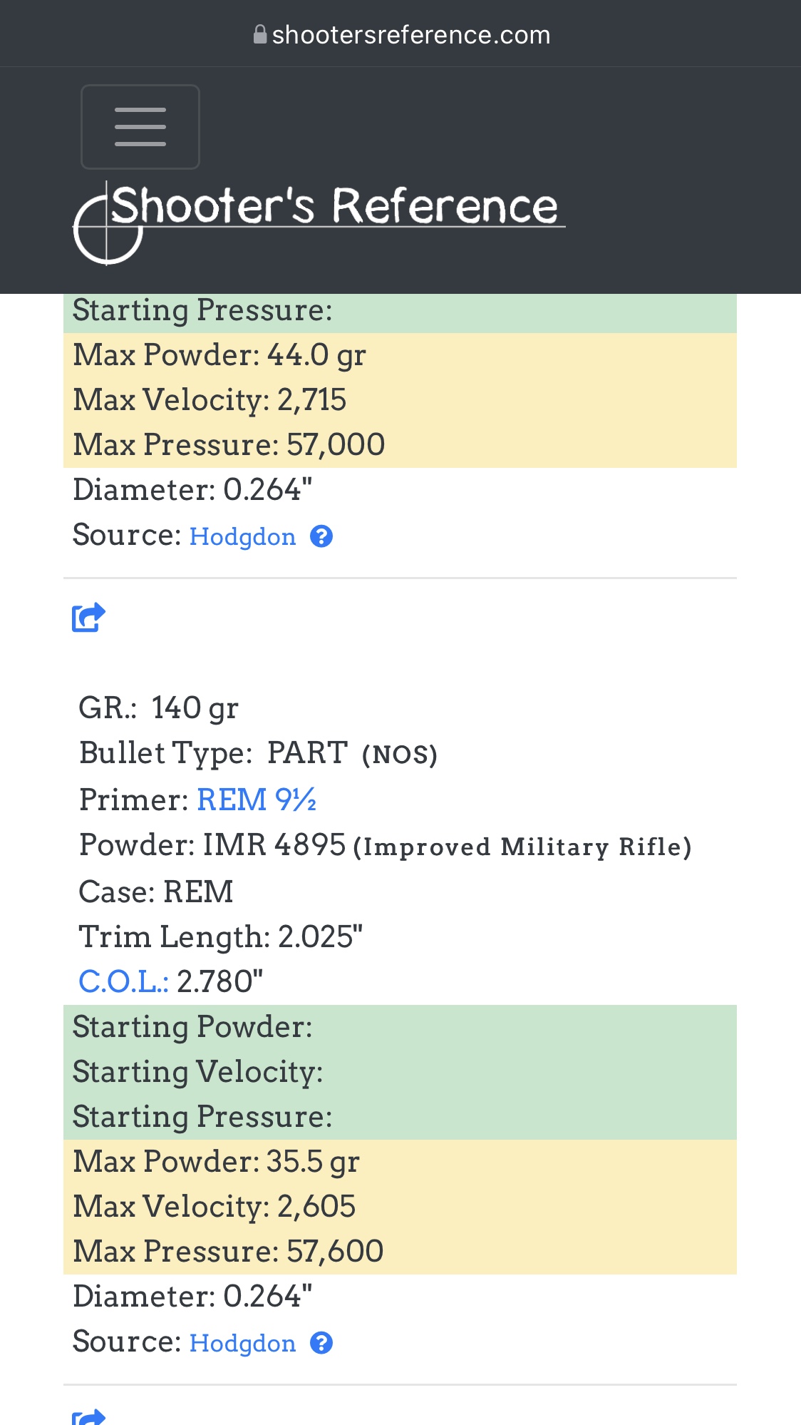

Has anyone here done any loads or have load data for Accurate 4064 or IMR 4895. Looking at either loading 123 SST or 140 ELDs. About all the powder I could get my hands on right now. Any help would be appreciated.
I haven’t, but did a quick search and found these. It does seem like they will work, but are not optimal in .260 from what I’m seeing. Notice that the fill on the listed loads is a bit low at about 36g. Those are listed as max loads and aren’t very fast, but as with any load development, you’ll need to find out what works in your rifle.
Anyway, even though I just noticed that the 4064 I captured is IMR and not Accurate, here’s a couple to get you started:
Note that you will likely have better luck with the 123s and probably get a better fill volume too. Good luck and be careful.
Thanks for the help! Gives me a good starting point. Think your right that I’ll probably have better luck and speeds with the 123s. I’ll report back!

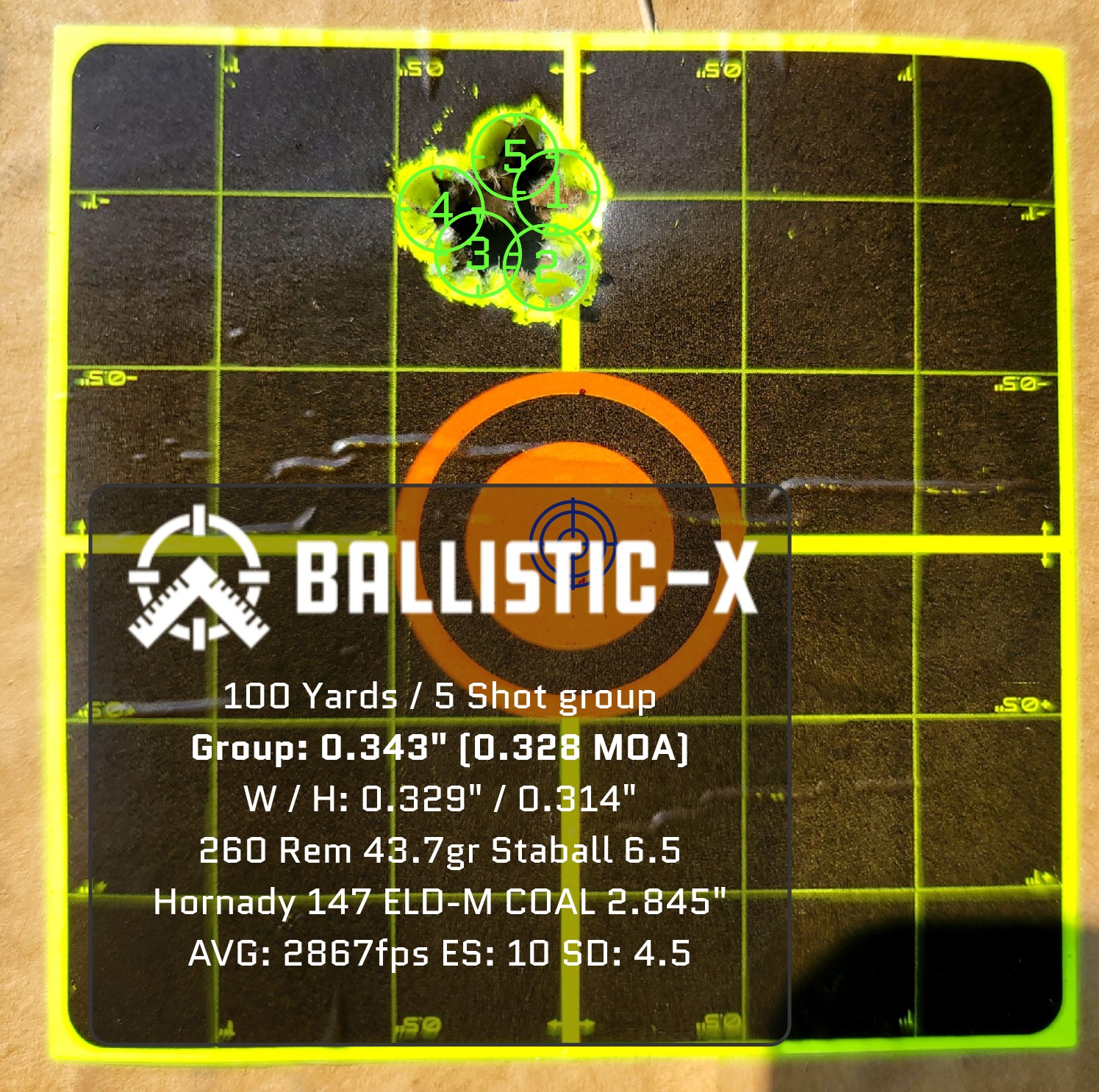

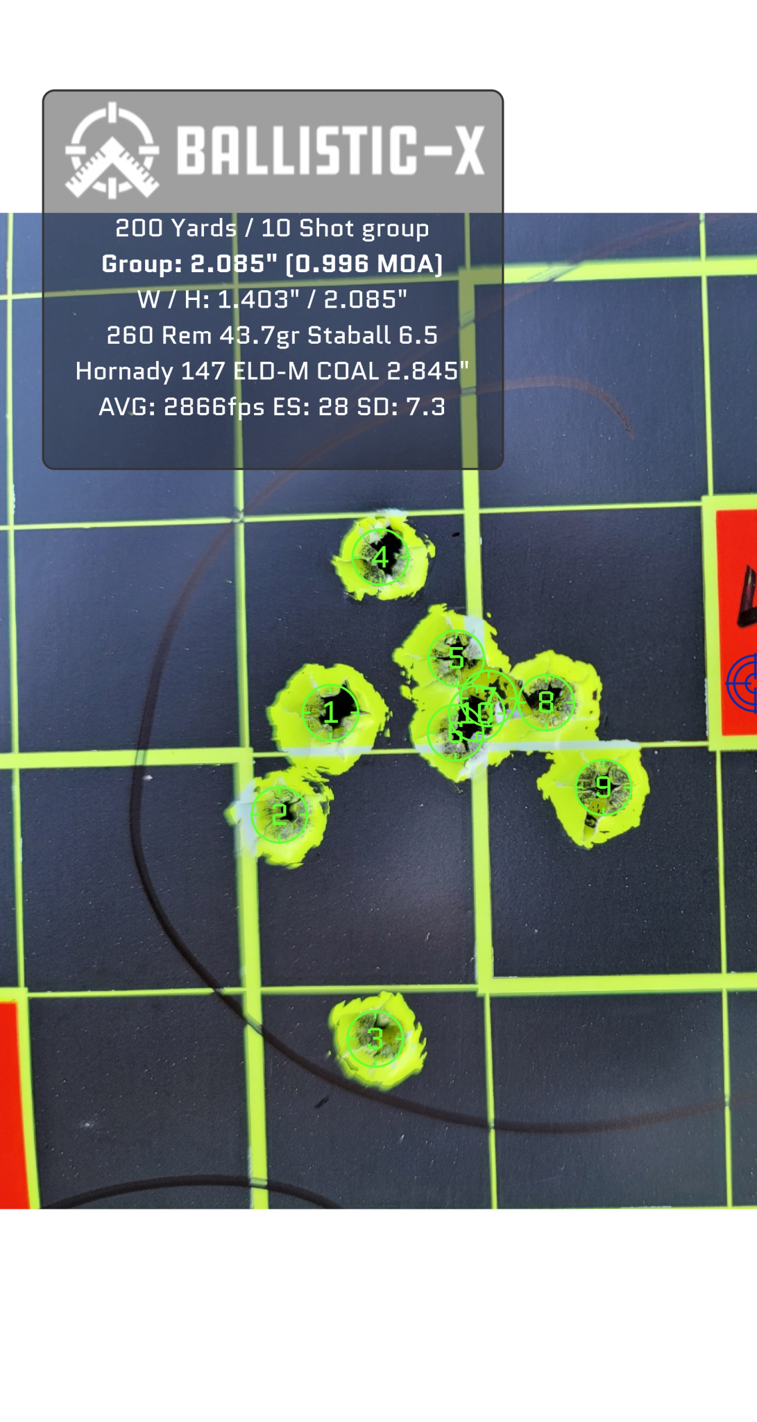

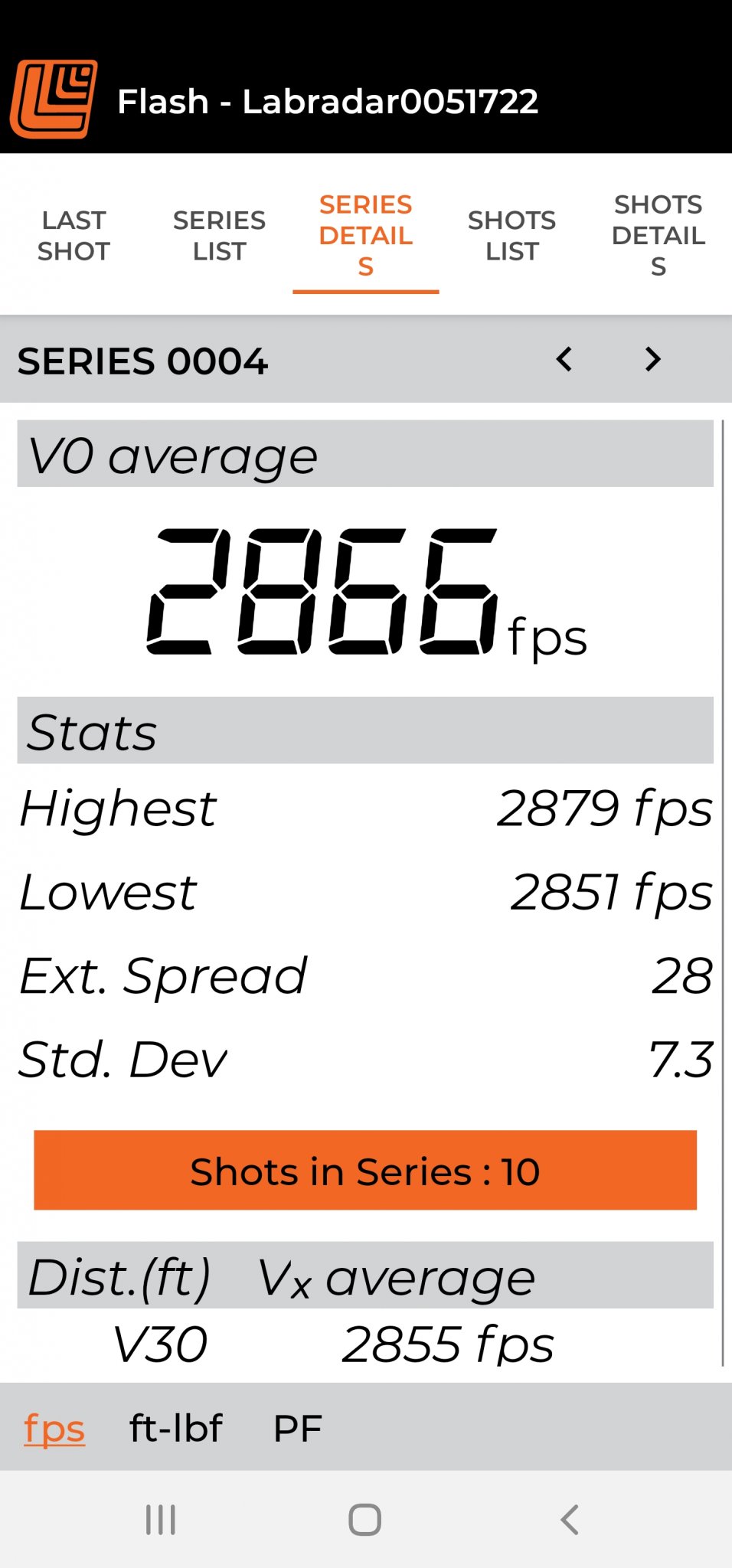

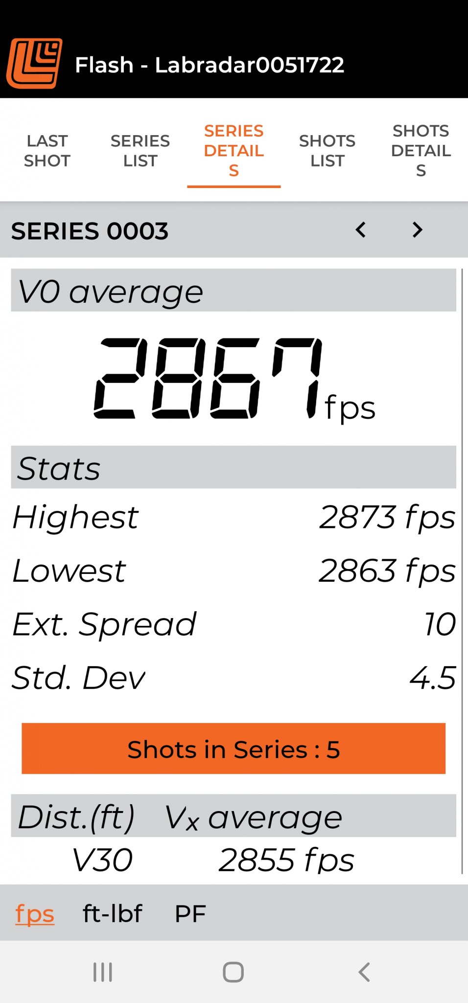

Lapua SRP
Federal 210 Primers
43.7gr Staball 6.5
Hornady 147 ELD-M
COAL 2.845"
5 shots: AVG: 2867fps ES: 10 SD: 4.5
10 shots: AVG: 2866fps ES: 28 SD: 7.3
I shot the 5 round group yesterday, then loaded up 10 rounds each at 43.7-43.9gr. Went back out today and shot them at 200 yds. I wasn't nearly as steady today and the groups opened up. 43.7gr was still the best out of the bunch and the lowest SD.
