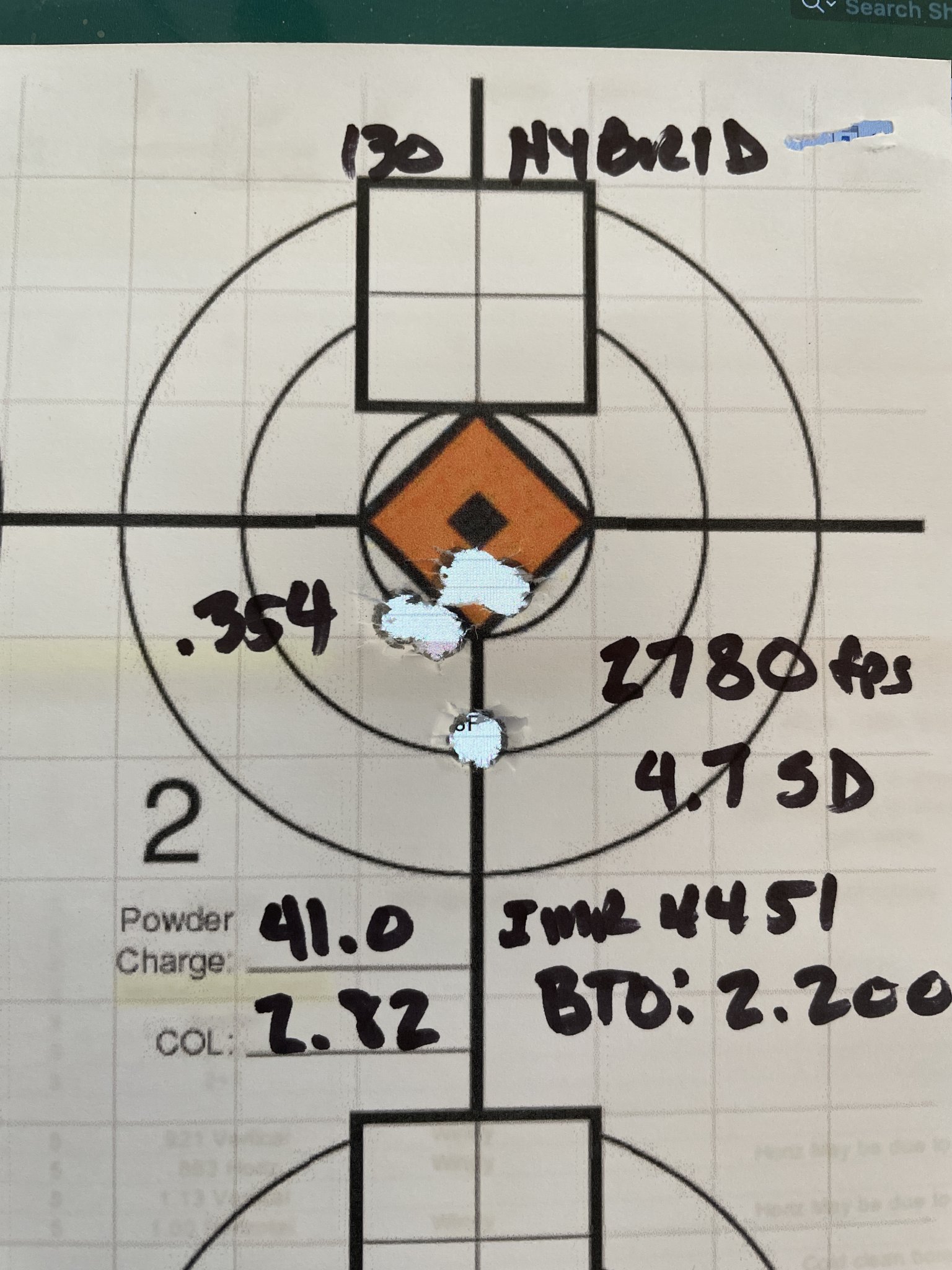

After much laborious effort and chasing my tail because I started too high, I finally settled on a Berger 130 AR Hybrid load with IMR 4451 and virgin Lapua brass that repeated for the new .260 gasser. It was a 111F when I shot it 2 days ago. It will be interesting to see how it shoots in the winter and just how "temp insensitive" Enduron powders are.
Now I just need to finalize the 123 Scenar seating test and get that done with.
BTW - the flyer was all me. I was not warmed up yet and yanked it.
Reactions: LRRPF52
In a gasser that’s pretty reasonable.
In my bolt gun with roomy brass and long throat I was considerably higher charge and faster.
For me 4451 was plenty good in the stability dept and accuracy was excellent.
I also run 4451 in my 260. I've shot it from 88 degrees to 32 without adjustment. Having said that I was only shooting to 300 yards and no chronograph.

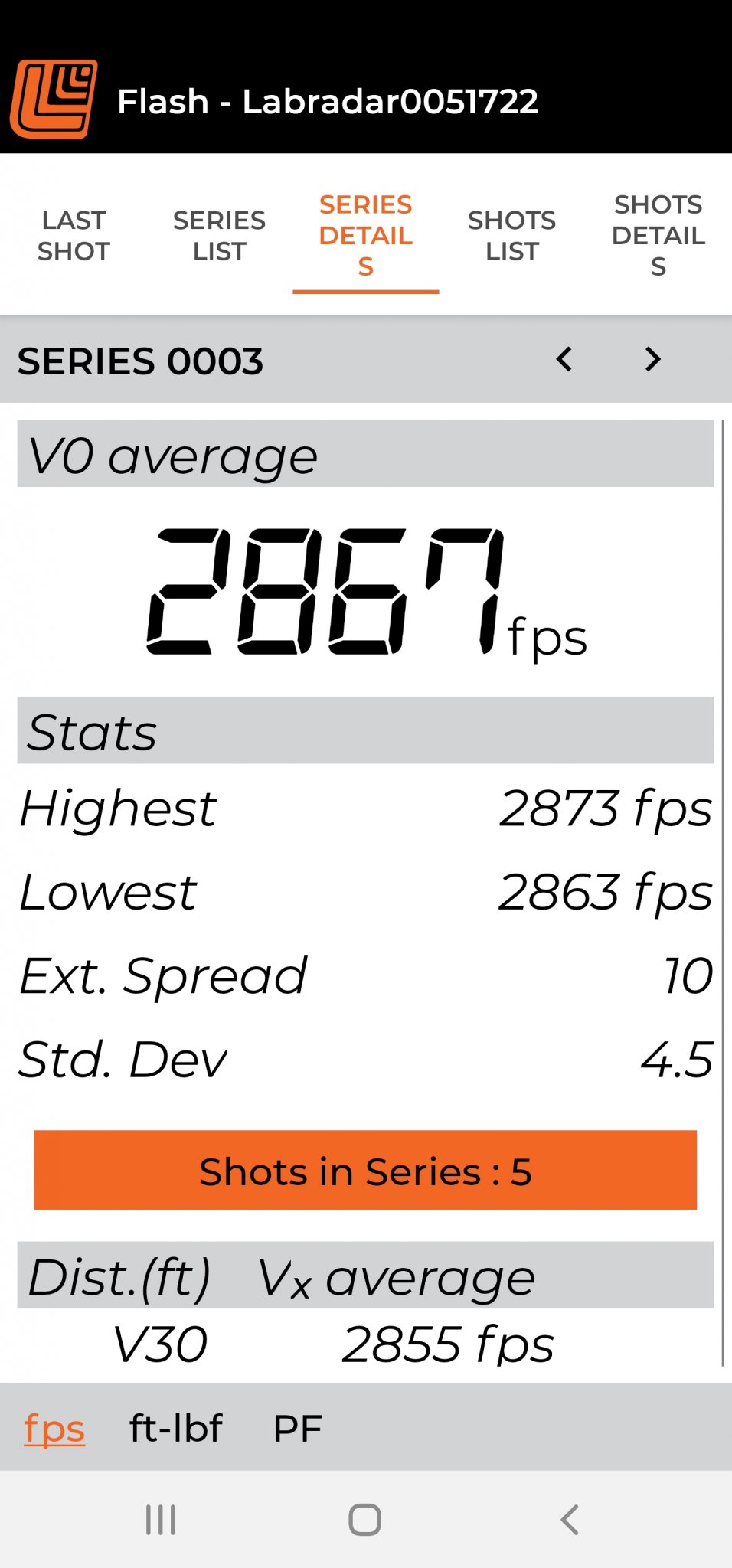

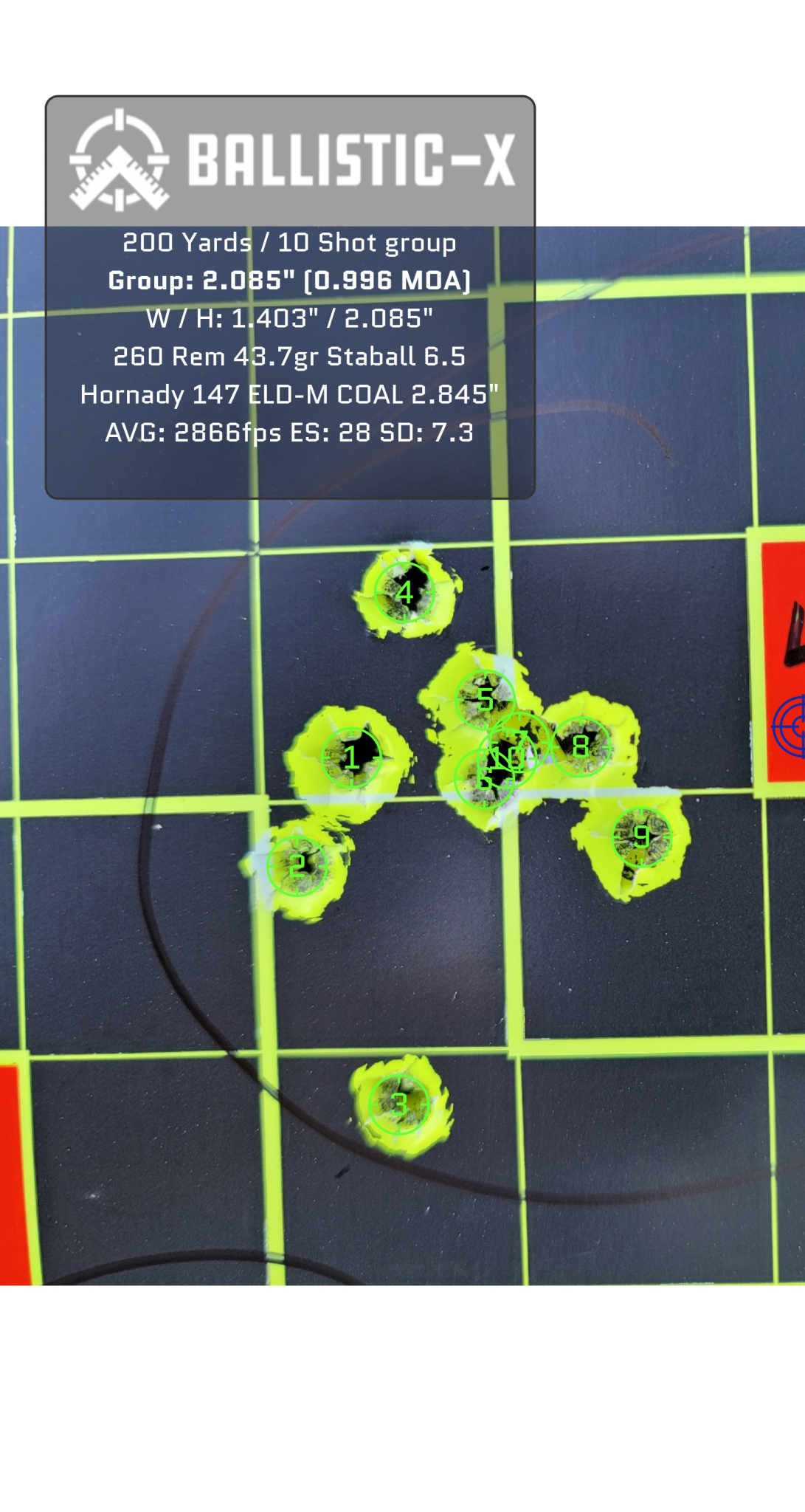

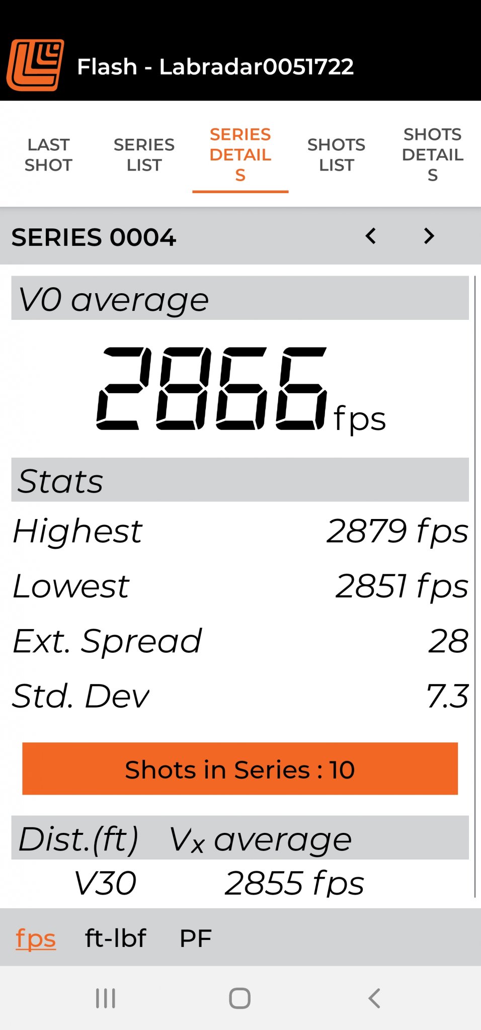

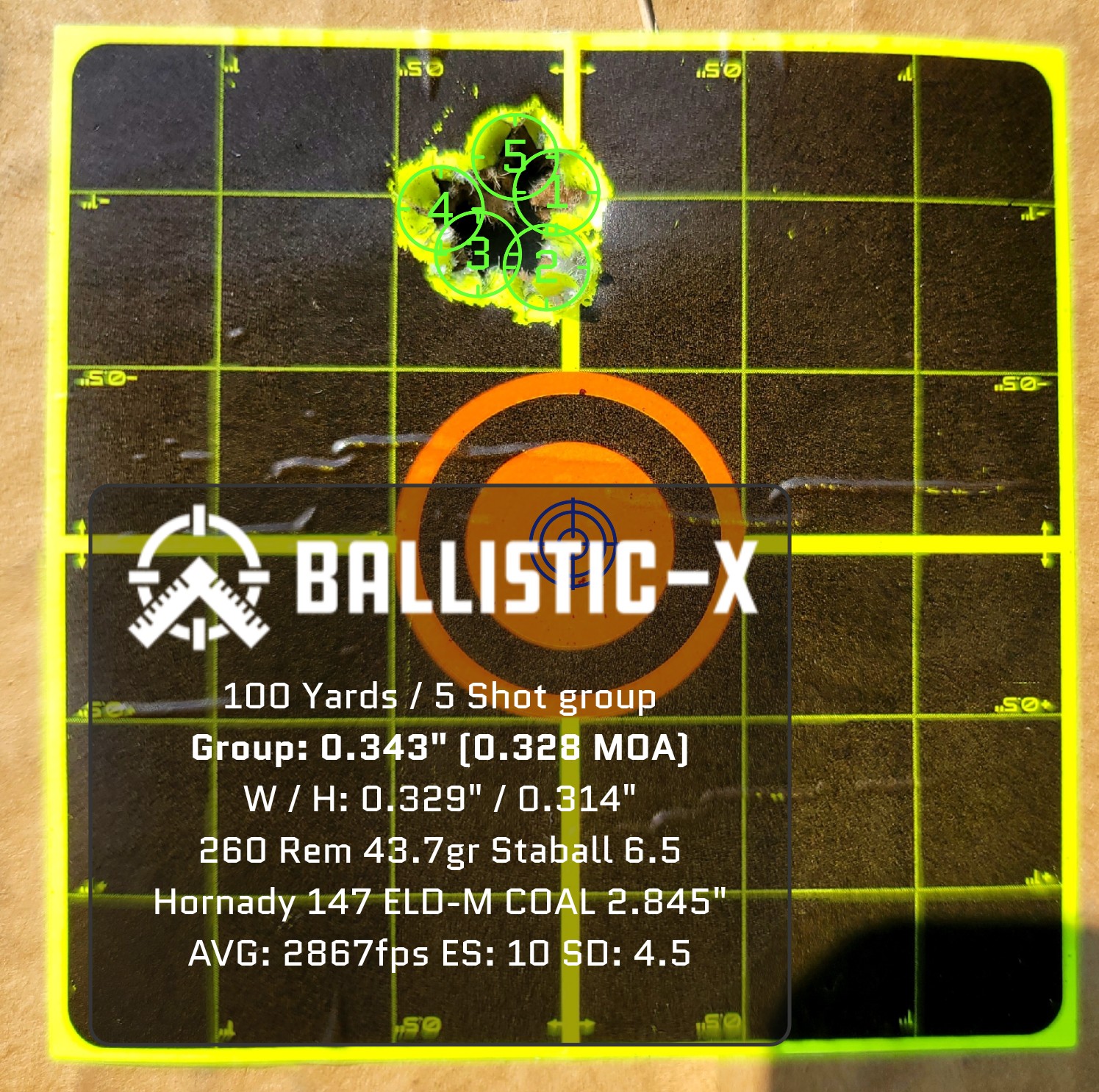

AI AT 26" 1-8 Bartlien
Lapua LRP
Federal 210 Primers
43.7gr Staball 6.5
Hornady 147 ELD-M
COAL 2.845"
5 shots: AVG: 2867fps ES: 10 SD: 4.5
10 shots: AVG: 2866fps ES: 28 SD: 7.3

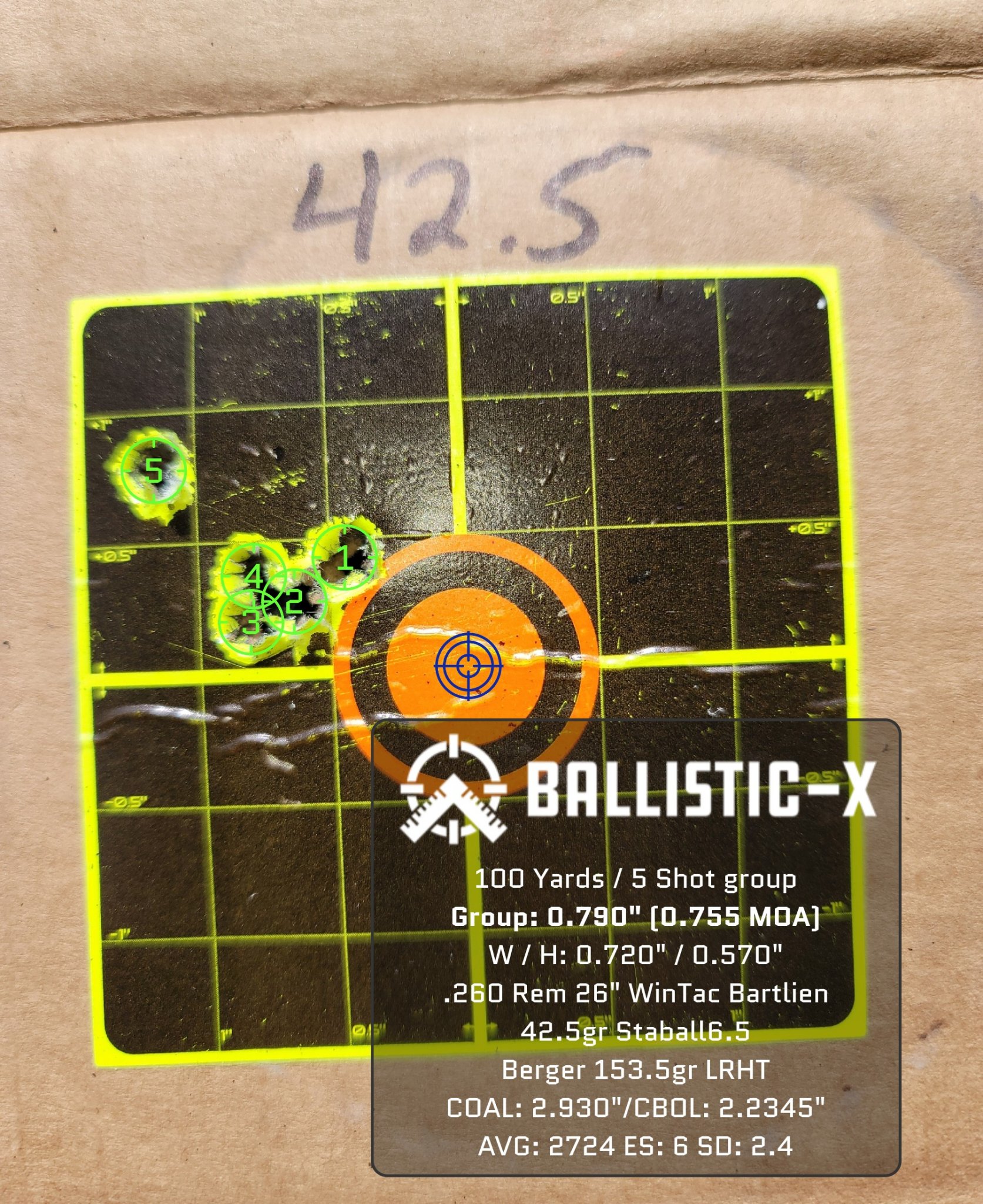

I shot the 5 round group yesterday, then loaded up 10 rounds each at 43.7-43.9gr. Went back out today and shot them at 200 yds. I wasn't nearly as steady today and the groups opened up. 43.7gr was still the best out of the bunch and the lowest SD.
Ballistic-X-Export-2021-09-10 16:44:34.304012.jpg
Ballistic-X-Export-2021-09-10 16:54:53.841755.png

Is anyone using the Berger 153.5gr LRHT bullet? I have some Staball 6.5 loaded up w/some @ 0.030" jump (COAL: 2.930"/CBOL: 2.2345") and I'm curious what jump you guys using it have had luck with.
I have been wanting to see someone post some loads on this bullet. I have loaded the 153 a tips in my 260 with awesome results but I have to run .045 jump to make mag length and get qtr in groups. I hope some people have some info on the Berger 153.5.
Reactions: Snaz
Yes, been testing them for about a year now. I'm using it with IMR 7828 SSC, in Lapua brass with CCI 200 primers. I'm seating them 0.015" jump (this is a single-shot load, they won't fit in a magazine). Shoots ragged-hole groups in my R700 5R .260 Rem. Found a great load, but it's HOT. I don't feel safe recommending it for others, it's that compressed. But if someone wants to know, I'll post it, but it's one of those "CAUTION - ENTER AT YOUR OWN RISK" type of loads. Always work-up safely looking for pressure signs along the way. Not every rifle is the same, and not all will handle the same load.
Reactions: Snaz
I have some loaded w/Staball6.5 from 42.0gr-43.4gr. Hopefully I'll be able to make it to the range in the next couple days. Had a surgery a couple weeks ago and not sure how I'll actually do though. Fingers crossed...

I pulled shot 5 or this wouldn't been a lot better. I'll rework up 42.4, 42.5, 42.6 to see if I can tighten it up a bit. I'll probably do 0.030"-0.020" off the lands in 0.005" increments. I was hoping to pull 2800fps off, but developed pressure at 42.9gr. AB shows 2729fps supersonic until 1800yds at my altitude.
260 Remington AI AT
26" WinTac Bartlien 1-8
Lapua Virgin brass
CCI 200
Berger 153.5gr LRHT
COAL: 2.930" CBOL: 2.2345" 0.030" off
42.5gr Staball6.5

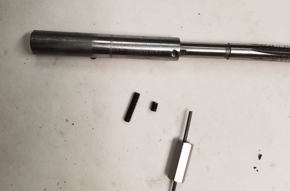

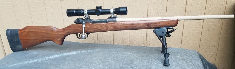

I built a 260 and throated the chamber.
I made a 6.5mm throater holder.

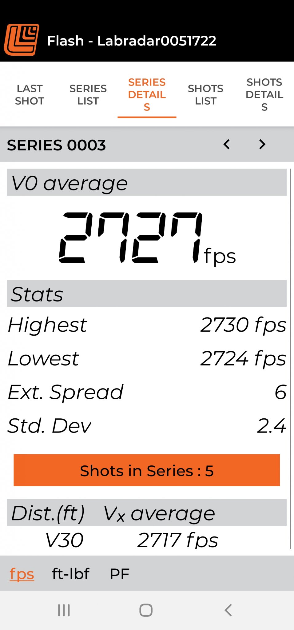

Went and did some more load development today at the range. Did max load testing with Varget and Nosler 140 RDF's at magazine-length (so I can have a repeater) which is a 0.055" jump. So far, looks promising! Groups were all touching and some bugholes. I'm safe at 38.0 & 38.5gr of Varget, and the primers still look fairly good, but the bolt throw upon extraction is a bit stiff. So I'll just work between the 37.5-38.5 range on the next batch, and see what ends up producing the best groups. Whatever it lands on, will then get chromo'd, logged, and batch-loaded for my plinking loads for 100-1000 yard range shooting. I have a nice load using Berger 153.5 Elites and IMR 7828 SSC for really reaching on out there...But it's a single-shot deal (way too long to use the magazine).
What sort of speeds are you getting? I’ve had decent luck (OK but not great) with Varget and 123 Scenars in my .260 gas gun. I think Varget may be a bit fast for 140s.
260 Remington AI AT
Lapua Virgin brass
CCI 200
Berger 153.5gr LRHT
42.5gr Staball6.5
That looks really promising. I’ve been toying with the idea of trying the 153’s in my stick. It’s the identical copy of yours but with a Bartlein Gradous barrel. I’m having outstanding success out to 1600 yds with Berger 140s HT and 144 LRHTs. I’m getting just at or slightly under 2900 with the 140 and about 2830 with the 144s. I feel like the 153.5 is a bit too heavy with a .260 as you can’t get then fast enough to take full advantage of the BC. I think the heavier bullet is better suited to some of the short magnums, 6.5 PRC, etc. I’d be interested to see the wind difference between a 144 and 153 at say 1200+ yds.
