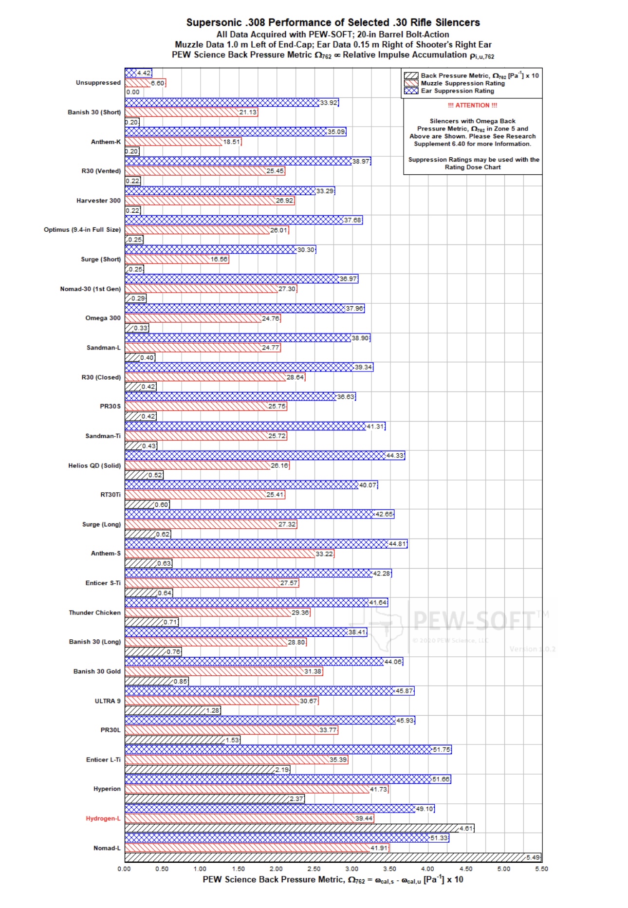

At the time of testing, the Otter Creek Labs Hydrogen-L held the #2 spot on PEW Science, just barely getting beaten by the Dead Air Nomad-L/LT. Now it’s number 3, because the TBAC Magnus is the quietest .30 cal can on the market, and the Nomad-L/LT moved down into 2nd place.
I have all 3 of the top cans. Haven’t shot the Magnus yet, but I wouldn’t have bought one if I ever had any doubts. But after thousands of rounds through each, I can tell you that the Nomad-LT and Hydrogen-L are ridiculously quiet, and worth every penny, and if you had the budget, the Magnus would be the way to go, for ultimate suppression.
All 3 are rated for .300 RUM/.300 Norma mags.
According to the chart you posted, the Diligent is better than both the Nomad and Hydrogen cans for suppression at the muzzle and the ear.
If sound suppression was the main goal, dollar for dollar it's a better value then either the Nomad or the Hydrogen.
The Ti Enticer is $175 cheaper than the Hydrogen and almost $400 cheaper than the Nomad-L (or $200 cheaper than sale prices at say Capital Armory).
It’s so close it wouldn’t even be noticeable to the shooter. And it also lacks at the muzzle report by a noticeable margin. I’m not saying it’s not a good can, just saying they all have pros and cons, and if you balance the numbers, it falls behind.
It can’t be by much…
I just updated my post with prices.
Enticer Ti is $175 cheaper than the Hydrogen-S and almost $400 cheaper than the Nomad-L.
At $675 the Dilinger Enticer-Ti is a hell of a deal with its performance.
