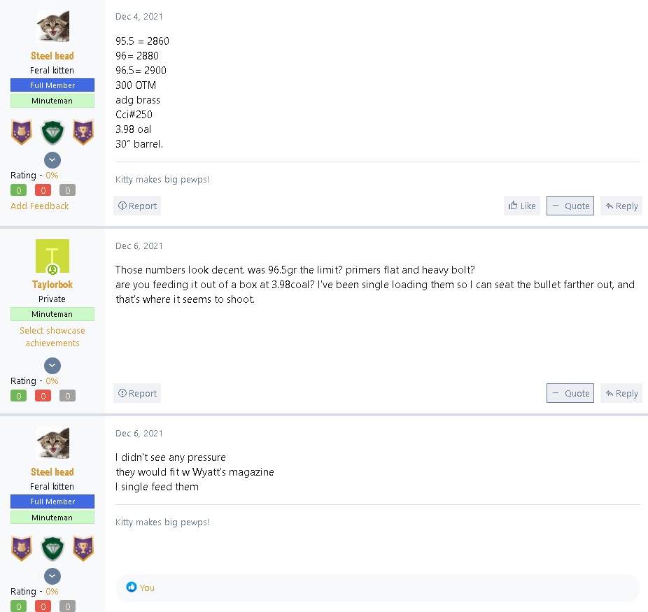

I have a upper limit test with 300 OTM’s I’m running tomorrow with N570.
What were the results of the upper limit test on the 300 OTMs? enquiring minds want to know
screen shot of our chat.
