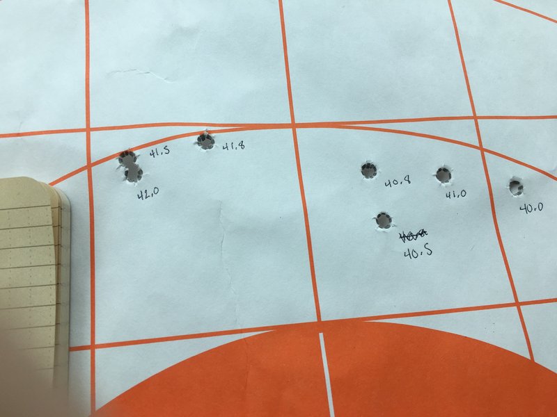

I did a ladder test yesterday at 300 yards using 40.0-42.0 gr of h4350 and I'm happy with the way they shoot thus far. Once I got home I reloaded 36 rounds of 41.8 gr.
case length: 1.912
coal: 2.771
ogive: 2.178
off lands: 0.020
rifle: rem 700 / 24inch Bartlein 1-8
