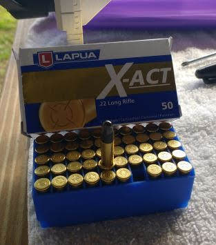

The Lapua X-Act did a bit better
68nHFKhp40wKJFMRPDTwq9_0NMSaKb7TXLBltf-KkYi_s53z_kpjSw4dXDwE80tx-vsqvzelPh6xUNb3l4kyAwJt8pZiRzskeo3BxwfQZcj3VQ3p0mF4rtjyueLKuvizOPkd5mSmVwV1kFv-jQXd99RYsaYIgCRsEXoHeR4a9hc6ZjRMCSAI7RO2qRuHOX-iFC4hPqK8pHq73sSuGDxi48qrB6XVuI5JdhOejtNopEzKrN5PRJCEgXuI834Wf83ElHXTg2Jlvp90MGCfQ4hFaHr-sxr9rZpKME6_OJaKYuu_sxNYHD9HGCSHmXkR9l8UnRCH8xWTmq28DAPehQsLglOsG1GQk3bd_EuRcTzcPISSqxgoW_MScks5X-zRnQbZVQoFOjUSLhL5YvXnB6vvfrtqoL0B74xY3TnpOTThNPjW1k6PDmpyB3vMhf0AgdIEk6opz2ZbNDn9euuAbgjBcsEY3BTkdxU3ePq2349c8LYYOaFiOkkdaetzKYoY13Me0SlmhjFlIkEQ4vO_gZmsP4wyuSJW1tsYi9MqDGsget7mTMSn7TcYOYXi569xbQauBWZjT5qzPvbJhK5PgG_mT_dBwiFDp0QFTw_VZVoRRKbDHo6MWXZTPIFpSHrbnLAdYpCU3j8W9YkjftSNewpxnXiIN4D5NZDII1bONjZrl_0RpE-Wo1-Bl-ImbsAYWi_mFWuqIk5_3SgrOi-QjWBhDtaP=w313-h355-no
E9inB5aMF4Bdu6AoEwHTG58R30yQCX_hdpvqkWlEyFrGrKzVO6BGguPt1cOq4KkVCWfWSG6UFN5rQ7uJWVLspvbxxnwDbqLB67VWgxQWaxXYa_5F4teR53JhztBdDdApVhWLqKqGBLBxRh_4PCoaR2eaKtLe_hyVPsq33qE5F3WwNFrdHyTl2rdkPUaYLl2AbSudWZdQsuYuIPSIqsZ6HPvH3DO5SSJ9WLFzjyCFBBKA4u-psCOsoRYUZ29lu53_1EaRiJ2LjldzZ9mgzBUaAsc8xI8pmCOhAjZPoRE1j68BK6iP6-xAbo_O2OzaXjKLJkp9TvseMML7nredigwZtwXDRAB3esQY6nQRzFncMNi8quzMtq699hlaAfYhh9QKRzcgvQaln1cxgfhzAimPwbG2TFwcWdaYll1LnOBvkZygbgHYSHWs0TAAOSV-Lv_Wx7UH6dpPQyPqNWNg79Om_4qj3xOP1BNrhPNkGM-utZxOPdbk4YegucepleTZNCwLjJWA1rINcwlVnFiL5-jsIB65eCOZ_UHa0-lOEZkNSPxJIX2XziWUXIOiwW-3iiyi5hbipWns7G-TEPJd02FOzV5c7dX7BtV95vgcwzjdyqotv5hZal2XZqv12tnB4sfgUY-6jp7I1CZB0CPd1pvI3lYYLnB_mccizDcFRL9c__OP7ruzeNltS0bHVJXposR-mCUBFiOn8a9IiiKYhpBwsZ9j=w358-h626-no
Brand/label/price is no guarantee of accuracy with rimfire.

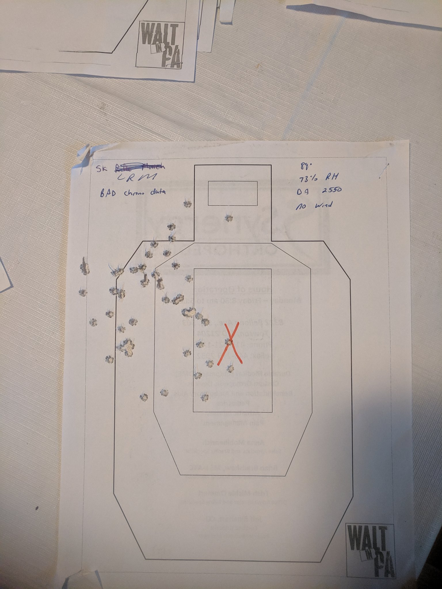

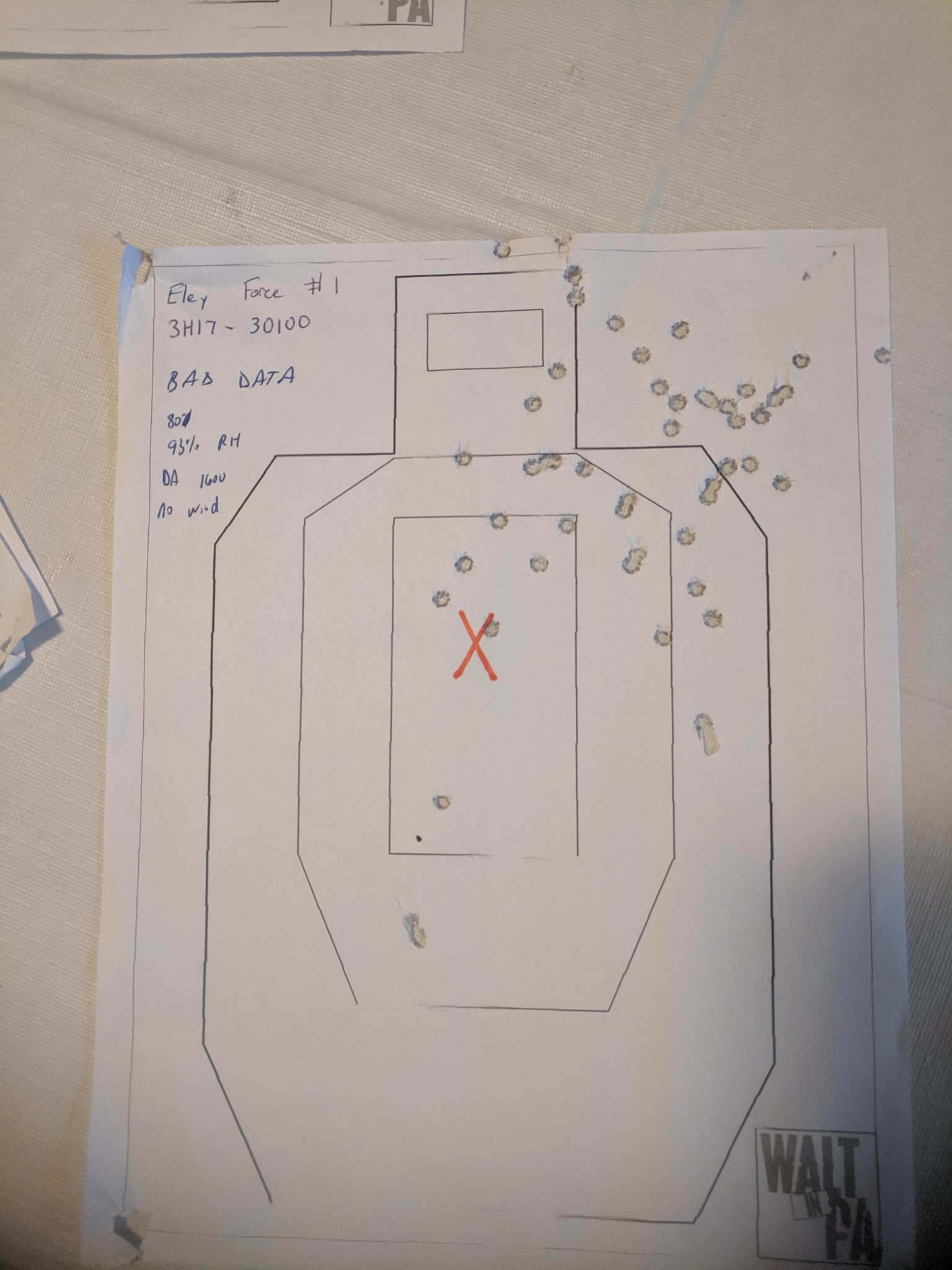

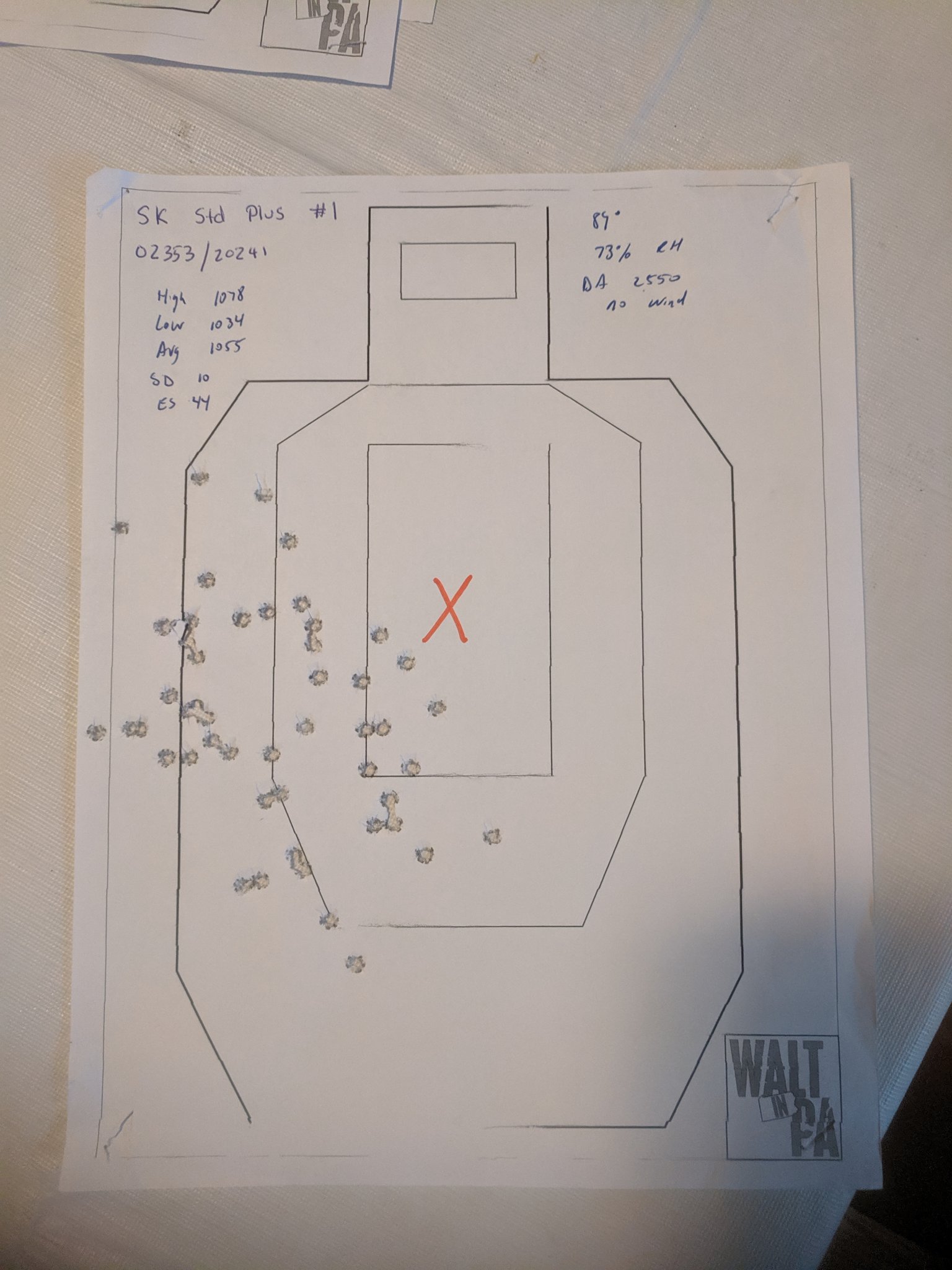

By 10 am the mirage was in effect here in NE Florida.
200 yards with the 455 Varmint, Lilja, Sinclair bipod and Mueller8-32x44 target scope.
I blame the mirage for my senior moment.
Somewhere in the course of sending 50 shots,
I sent 15 of them at the wrong aimpoint.
Couldn't see the shot pattern due to the shimmer,
didn't find out until I walked down to get the target. D'oh!
Lapua Biathlon Xtreme 40 grain 22lr rated 1106 fps
wsBhsTY3kYHDK6XUkv_qHBcSOe0MAmBLyvNmfZGB9eFNCVTa-73rrZwGPSCe22jt6kQtLasLiYAGRanhmrYs7o0cHbagxRuI8QGF-xxdLGOFOEoNiVTMcTFslJN8kCHVslega7n3CTMsQRCKiG57UN5O5fdNnSgItE4MJDxrVHsHeyfo9sc6aiWsbCVtLcilxt4kJibpV4gzNGgwpq3ERt6B4jQs77Lwo1rTwqgOY6gbcXbxOzeqgtBH4qH_dyJjV_CU3waI1j2T3gF1anGrbke_x_GIY7YmhW-ZdiEZ_3aKcS2Kk3OtZDwUyk-M2RPgKEYXfdryJ617vXTxNWOz4a6iJuijQ68fSBC5kIxMrJP4-1jeAxjf3Zq7xRdr5YKyKBW2VZKK6N1fxl66H8K558xOWvTgwNsq9FOuTNamjfXytG5rmsqR1a29bmcI5jhpXwQo0je8swoxHIi8PtM4uTRP_591eKt1U36LFIZqLmQ3boeXa55gKA2VBOtqV6XDGAZhniJL6CSLPJmcCiFJR-epUsbgfzzUAFHxzQXKttlh9VPVnLtpsHPdbsm-f0ccN5zcTaGNvMvAhlfbzZruqORc1plWb1OeyPtYTWTJ9JJMmHSQIdegm6CfV5xlya7l-0qW_fZX64kuf6iqLUjYwz1mMnKp2j5hf-v8vYOVR1PdODDALA8xqZdmXig_2gucXLY3WOjhHrW3QpUILdDuUhES=w316-h541-no
This is the larger group
HY4X8RyuQJXzs2bRo-yKaJijaGUZBe-ytSewSijgezmcTLlb-34lKUQayPgwyatpUG4geUTBpwOvERt86Wf_05cu-CQUsJulKeNTArmARUJPgtkfq4JeATVifUnefKE_Q_41BqgZA3mjYO2KZPffbyqDM61YFW3YqQZun1osLt8tHQgbU4_K7Qj67x8ldpqM3YTOfhU_XpDQdlsUwQeiAGcdyIoEuZFy5Kf6YhH0zPE1JAlK2xCPR5A5XlbWqFpOOWgWYbh6cmWgpt9IYoY6P4_RHgKVLDhotNokWr8EpwsPd9c-033wHiHUSA_WvRomyrKDVAoOB3j2vO8aqgvFV1mxYiJPOXNcv__8AIzp6pO9Fdexrcw56OXo-KfNxZlc7CLSMBKNK2OvoOShD-Xtw2xHhu7Z7cakaUXAZac3PgZOviPLdgFBkk0qru4rQNqMboFBr1wRZnrkxFHcttJLViYrf1BGS9rEBGFzY-hdkfwD9IM69LCQm1QNyG3oYGPtmv_v6HkOEdQaXU51JN16YDCTJfoDgWOOPSY0WmXHZWfCQO9Z7JMokbxVgUdRpBpSAZQtP9jYqd5QKGpt7B2BKlO0g442rGBVoTJNNploSso1RaeCLL42Jb83QjRe8725yYKl3QYDeyQtyfi6UC4Xk0fSZtgHUXShOXq-1W5kFkCA1ZlJUGNW4i-HdZzeh-e2qjERFyZUEfKj8dViRp4_KxaE=w332-h427-no
32 fps ES for the 50 shots
4 inches of spread is acceptable, with the mirage messing with me.

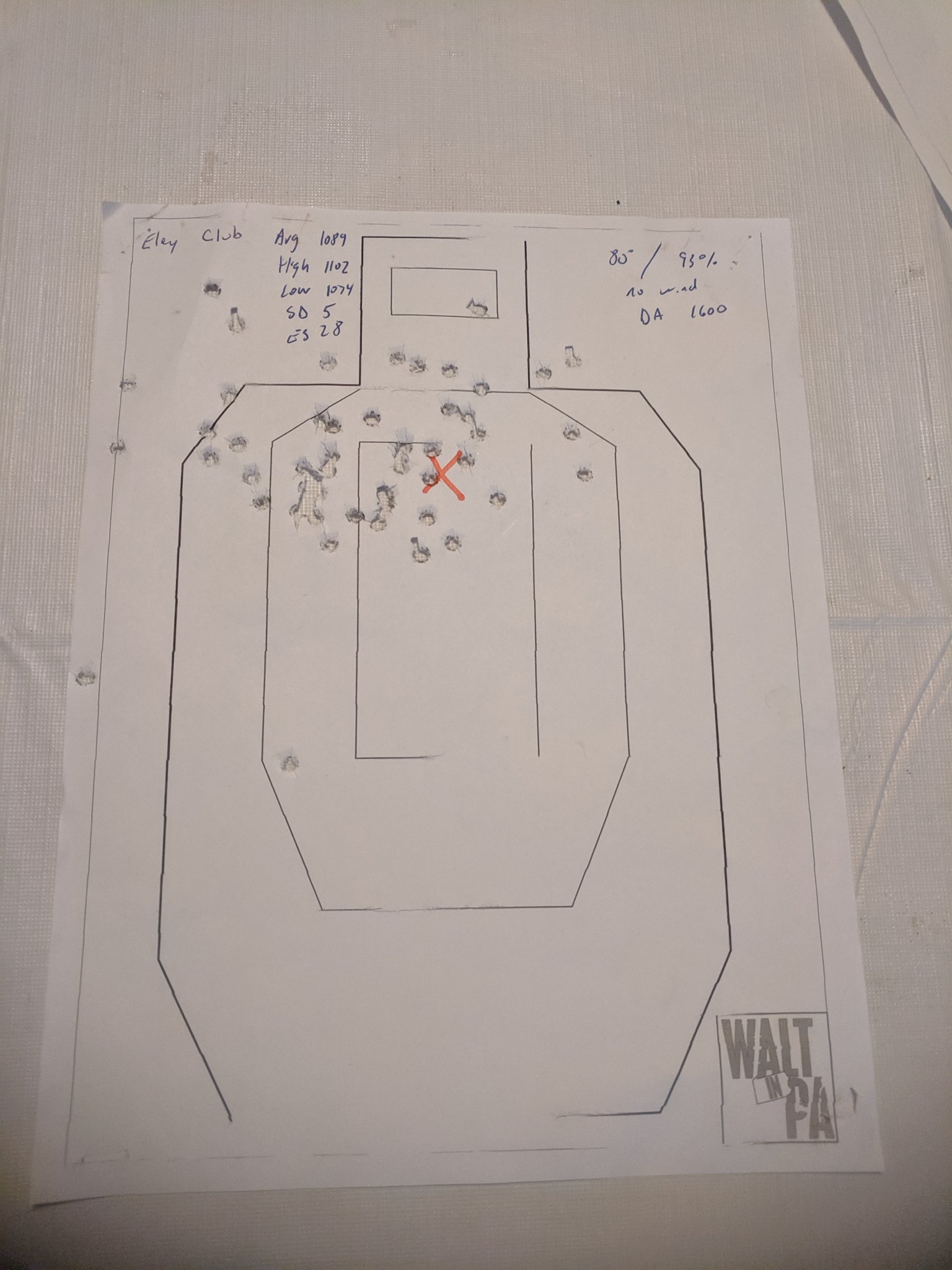

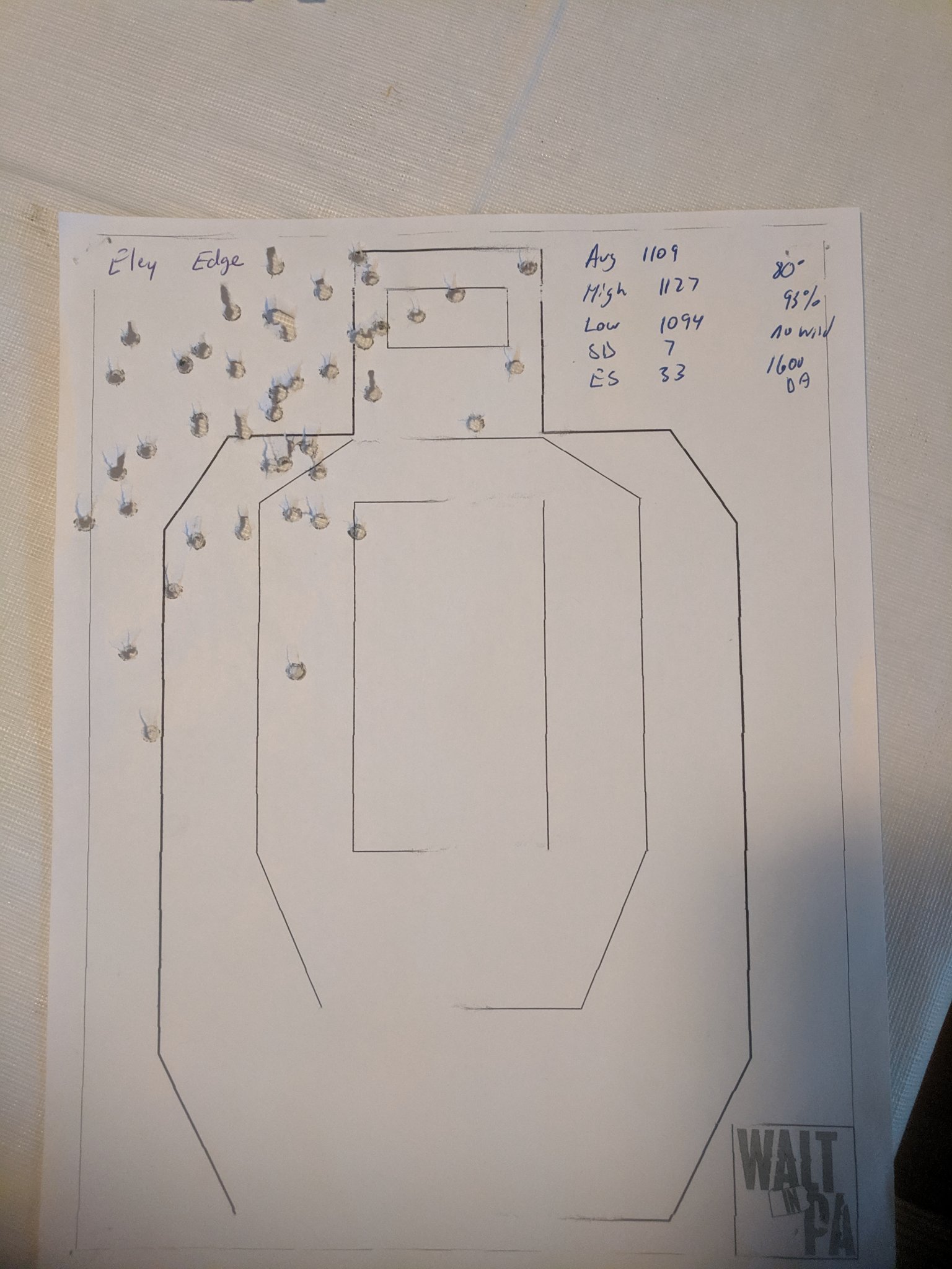

The thing to remember, is we are dependent of the quality of the ammo sold.
Be it 50, 100, 200 yards or more, results are based on the factory rimfire production line.
Even the best rifle won't make low quality cartridges more consistent.
Second rate ammo produces second rate results, even from a first class rig.
Claims of "all day long" or "laser" are impossible to substantiate
when all of us know just much how rimfire ammo production varies.
Get a good batch, great things happen.
Get a batch where the quality control was substandard
results on target will be dismal.
No matter how great y'er rifle is. :(

Norma 40 grain CPHP 22wmr rated 1885 fps
CCI styrene box, CCI manufacture date code, CCI mv spread
Yep, It's CCI 22wmr with a RUAG headstamp and Norma label stuck on it.
455 SOF Feddersen stubby, Sinclair, rear bags
qNzb-ATFS5FytwOP5lFiYWK9XBFEe2lz0ry320AalPcLD4tpFqMNWaCoUmTSqXO849p2EF2Vh9JsU4H4nHxq-USwtpWzzqRGvEebpmrkFbka_PIxTqfBxfKwn81qevT9cF2pSKfDkkTer6v9mjtQPVtHGARhsW0q-Y6VD5W5HXqFTwBvB5siOsfHs_JqpkkCGIZblgq8aIb8LOHiTJpsRR466qwmoDa83t0EneY3JiVIDazq8GFwmoK_g9lqdNAxPbGoC5cIfPEQGT6BCJS9w9iT9eZSqhJHJ00YZCy8OQirA_O5l5aXJGFI18fV3v-YJrmL1nRUqaa5ZWRANfieHM4a6adqQ2YiKNQEgvZ6askvVG5sh8J1G__GhoP6IxaFFuMndFj6idcs2AdmijX83yOGVQ1uBijqAMDc-Ln8aUZ6zkTzfawa7lKl50i1KHDxARIPBXcH7v9GXbMUkybs7pn6D4In9mkoK-ur767M7wnS_K6J26NjJDJqMsNcz7DWJERZmWNA3vr7taj76Yqw07TlpT8IH-s-lB87jgVVPgWBb92KRHMis3ptGpWm4RLUAOaJGrvX81S41ZC0gPv4b1VCuWDSBhoyqA6BDw61UDblqkMschL_RJlixWvlj3sXuuDqHctWM5wjJpoqsM_W7rWH58MvH9Awxt3dfAVPGBAH8XNocfSOI77nFnhEn3DZpdqKfXlbK6HKa8MwBbilFW10=w337-h370-no
q40TrWivnqEhe0NA3BvGYWx8988TB8djcNbv7jf6M82az4nz1B4yNmQ1go8ooqUs1EIMpaUBxqVFlwQNc_caPOF6lSr08erUzBcIEgODTHMzNQ9IhSHbzNxm_fusffXvQIaMwGSyHoJMwQZ8dTxS0X_rgoJH9Mu1WaFlwUzoZnUWGTHxpVZkC8V5YbM-5vgT1y26WNNaAutDV7QYGX-gl4nL9nfl5nCwqSLxcB1UwkiSLKktB-oyDEvAT3s7y0bXTIGJ7KJSeObezsl_lFtIWW840O5F1geYcUo1ghwW1wXVwFYqzOZEjmlKsmhSaGHkQ5BUc7rQLWBzUQFvId7Kg2yY8g2B6rTQ5vq6x29FMq_m2NkdQPt9aYFs4ykyZGGadynUI3TwwhcMgzEsFdHsEGaan2wRBpLjr7J0Nhqb1T_dh6F6T28YwVhgV-fZxhrOdTmzs57xX6LTeoVhhIIMrZvrJXijXp-R_FWMSHYpcc_Xulg33QP5tVnrsgx1TmoC-48Wo-qetSpGqoVbI481QWjtoIuAorf9t1nsdE3mtzwMAw01nNxqEyt3FNWMX90RK_v7SflZXx-B-Dr1ZFyhTv1dqDHVzt7viIddhVzGfP6pjVGuxWGuO65DSAkoH8j8VH9IkkHym9Uap-O6QHNfcUkyvIMvy67EQMsoLXj2RRSDAF199_9jyapMy2UMydpF4OmqrCWbYJEzqIs5Xblqc7xc=w534-h589-no
CCI Velocitor 40 grain CP 22lr rated 1435 fps
455 Varmint, Lilja barrel, Sinclair bipod
RPXfzf5PLY9HDn8Nopn4iNmSH3r6P31h-kUvMloJVzuDujcczjKYxwdDXUIHlvIbdWgAxurRYsPx1nekme5ZoC0EFGOH7G4nkiJO8jJkIpUopZDV5bO0GdHmmcP9AYezZJkbQ8I6nsFoOkwF8n5wfTyEzDskIFJjIsBWjkdoQu6rumDG_AxShVnKvoMUEEA-vkVQYpaoYgzA4TRzf_aCZs0q22Qz0-CrEREZNnt9nOH_RNZkCpyUsYsRpbb_9XOuGzMz2vw3Dt3kLI_MPq0T0GW5zZ2pe6hHHdHS6i1vBDl_iVcOeBGzjG6B5fHoa-YkAr-JVGUrt00nbpB65SuFjrWcIITlNPK0RiqaG5ONt3fXCEqXqtd2BRBwl5kldfYNEzy915KsVFPOhjIPx1jT74labOvBJoD4c0RpfzvekJIeO3Fkxy-7x74gFGgTwPeetGrdIBUpHZ_OhYk6OGEsY-VwJVS66j2OJE7ohDRvBjQ37dSUE8U8n_HIO9miYvrwSIjyMAZ700vSEHOgAFKTBJMOrsJZJu_asu_J1oZT3QY4aNFD7FAsfO_mLJwK-Aijt4-uMprMVKW9FzxHGw51cfIBkY_Qh9qjBKLotyyYMdTYS4karByzbKlXIgTWddmwk0rR2je4ZLJADjrwTyM4oVOdfQB7aEjYjmBfotbXKGp9raRhO5_FueZ2ibF0BhLdyyY77c5E3wxvV6woUTsCNJEn=w390-h613-no
As the picture shows, visible cartridge defects.
Dents, dings, differences in bullet seating and drive bands.
When the nose is beat up, so is the heel of the bullet.
That's how CCI transfers components on the factory floor, dump from bin to bin.
Can't expect repeatable trajectories when the bullets are all shaped differently. :(
uardDaJdiWPkRdsIz4HTlRISFonWQefvJVJatv6lMPnQOYOmqUjS0hRRuL42cv6tfj_8gO6v4qJOX8GS-yCZsjxrZYnnXZzwqbkkqXXSpaBoa-MvkcZ8FetyUiWchLx0WEn9JUFyyPOmtktEQ8lSljrXchtWZvOb0dz1O72u7yO40jqvBPn5e-3psrnwJyuOVFs2DFOrthJ3IO6ek0lg0UstxmBPAYBlIEgE7rrCDdnvGaGR_DC3Z0txodZh3LaMLNGVJy2jVdQB0LVJOUnYrObF5_oy43c7Ow77xWCYv8SoNseixCFR49VTe-zRYQZXvC03s9aqMSGAXfzZ6Bilwy1QIxTBmmkiTLvmume4z8WFli5h4UTPAF-_TTB9EnNGDVnn4p8LlH9nLd9o6RZH8MvWfnqhsP0rUbBioUKqDPhEEuRoSDTLNA2me_9J_-UkzWi-Vq_7yqzQsdkJDV4gwYVF8-r691Q8AlI8KZ_lOlfEFdhg7HhyRiDP4DCeKb0RYjc5_8jT2Ok9IB0YlBZcaubTaRMUiW1kwcXdNEcoHgBJeaFeddRnrucuHw8jtk0GjAsaFJmyOXpC88i0gYzMME67dI4ivHJOLxGLOk1EfLjGZwAam_bOuQqsGJsRT-yoAWqsI2tWYm8wfEx92oRPG0LKmqUJec95gy7EkBA4olLbI_uNNlRW3yFol1sqCp9_37ud2vCzKLCT6Vd2QMRNBHRx=w469-h626-no
That stray, way to the left, came from a dinged up round.
Visibly more dented than the previous few.
No surprise when it hit away from all the rest.
Cartridge defects explain most of the spread.
127 fps ES explains the vertical spread. :(
Don't blame the rifle, or yourself, for poor results
when the ammunition is visibly to blame.

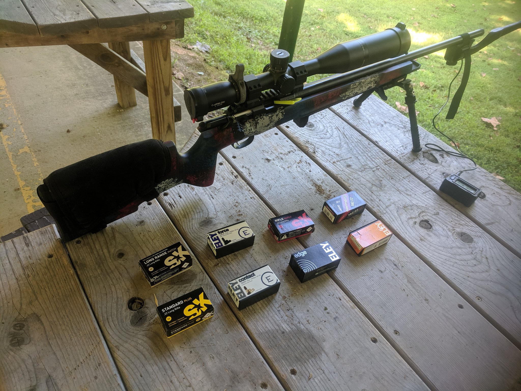

Well I finally had my opportunity to contribute to this thread. I was able to spend a good portion of a HOT and HUMID (for the peoples republik of marylandistan) Sunday at the range running a bunch of different ammo through my 457 VPT. While I doubt that I was any where at scientific as the rest of you all I thought it might be helpful for me to put my data out there too. I used the following protocol to test. I shot 50 shots at a single aiming point at 200 yards. I used an 8.5" x 11" sheet of printer paper with a reduced IPSC as my target. I shot 5x 10 round groups with only the down time to reload the mag between each. I then took about a 5 minute break between boxes of ammo. I used a Magneto Speed Chronograph to get my data and used Ballistics ARC with a WeatherFlow meter to get my environmental data. I tested all the Eley ammo first and then all the SK Ammo. Needless to say, it was a fun and interesting learning experience.
I tested the following
2 different lots of Eley Force
Eley Contact
Eley Club
Eley Edge
2 different lots of SK Std Plus
SK Rifle Match
SK Long Range Match
IMG_20190819_184357.jpgIMG_20190819_184406.jpgIMG_20190819_184433.jpgIMG_20190819_184445.jpgIMG_20190819_184454.jpgIMG_20190819_184507.jpgIMG_20190819_184526.jpgIMG_20190819_184602.jpgIMG_20190819_184738.jpg

i did not run the numbers yet but just eyeballing the group size and comparing to the ES I can see the correlation. The lower ES for sure have a smaller vertical spread.

Here is a pic of the rifle and the ammo, I shot off of an Atlas CAL bipod and used an Armageddon Gear Game Changer as a rear bag.
