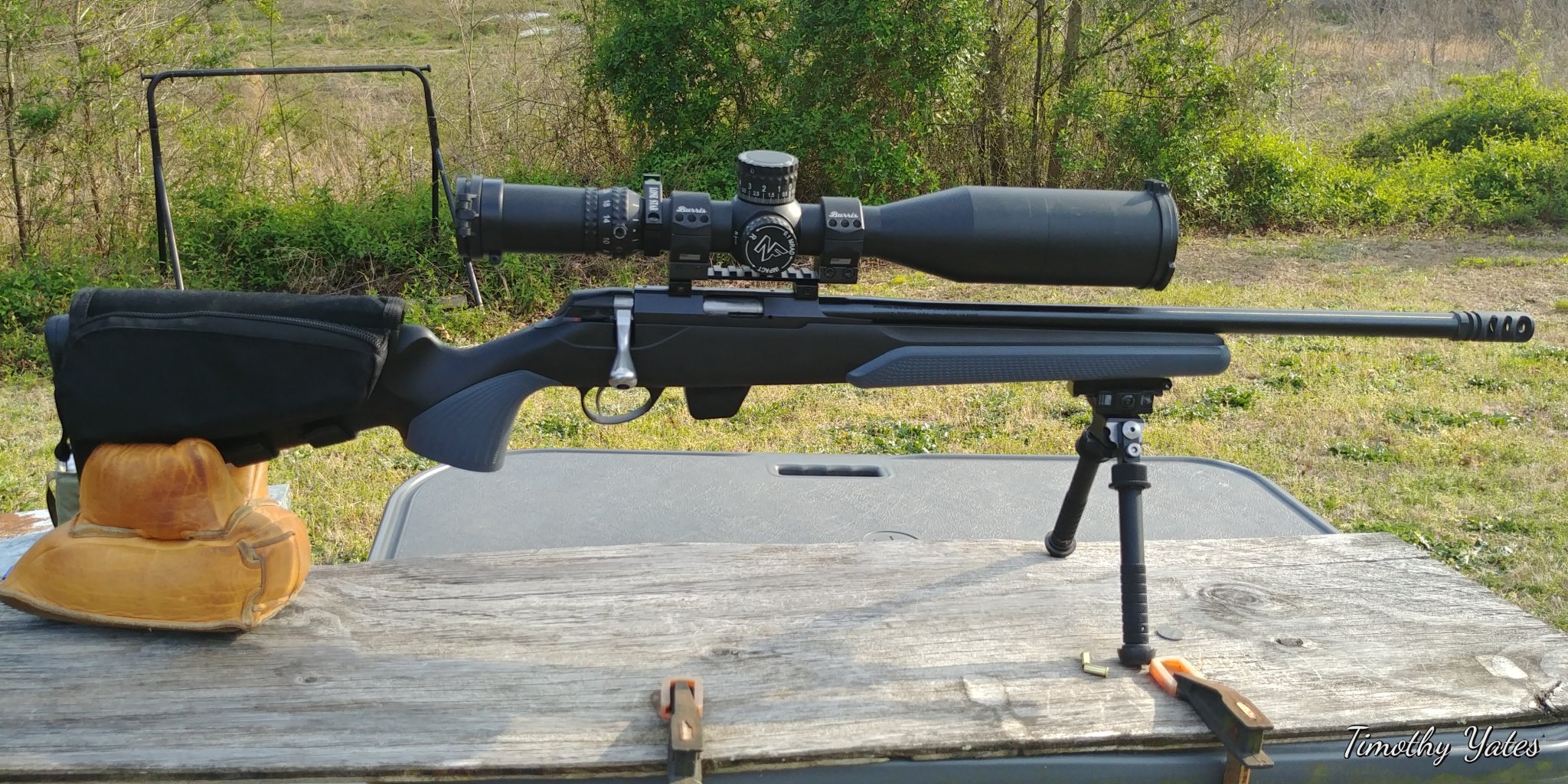

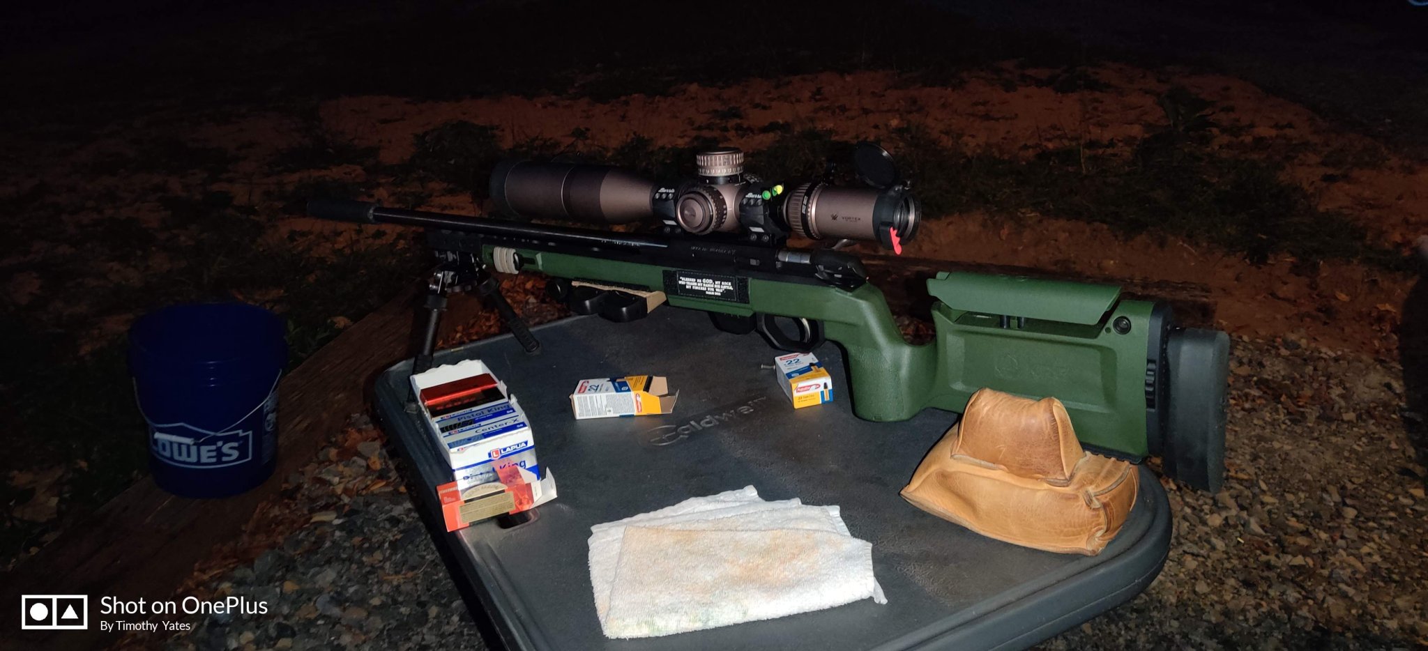

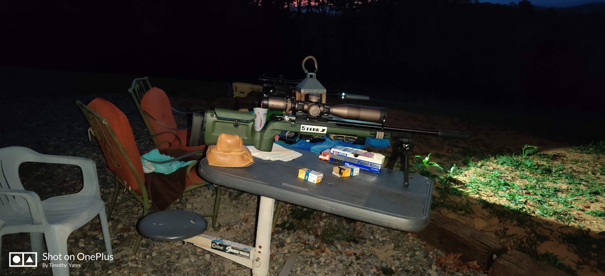

I did some 200 yard shooting last weekend. This will eventually be my new home and shooting range. I can get 300 yards back to the tree line as shown in the last photo. These were shot with my Tikka #3 but I left the targets back in VA. I'm pretty sure Center-X is on top then followed left to right, Pistol King, RWS R50 sc, Fiocchi Official 300 and Fed GM Ultra Match. I shot other rifles before the Tikka and by that time it had gotten dark on me. Those dots are 3/4" and just barely good enough to get a good picture with my Vortex Razor Gen II on 18 power. After the first group I went up 6 or 7 clicks. When using my Kahles on 24 power, at that distance I can't see a single bullet hole but when a cluster develops I can, such as the little cluster on the top target. I might could do better with a better bench. The Nitecore easily brightens up the target at that distance.
I normally shot with this setup using a cut piece of plywood but I left my clamps and didn't have a way to hold it.
Would you believe F-class Buckmark Silhouette?
At 200 yards?
4Qr4cGTMutLgqoLpuAqAr_Jz2WUUZaeyKJLh-u5NDx2E9EoL1X0PTLHLmbOKAd71XZplazk6jyrG7KCZiqq4NIF-oKcCY2EiP97gjp_jBSW4OOFwDPkSgj3FhJGkqHwzpJ3e_GrM59rXEUP3Dqz4B0kCSx2-SHAmc5lBZtZoRYlzIJxjArTkwTkwrMib9DlMb9Vg2VFxFk1mmLX3XzKiZ8kCUkWIyFbdOlcBUy7-PROghsWlJatYXORWOFVLfdmDVKNZUpXSqfUUqeV0stBV2TebN82tScQ-NTlb7xxL20xaAx9UQ0pwa35A3fRP9eSocbuDerT-zZEs0fR3O9wo-ghfdcU2B-sFIpQGiuoBZkzZwBbhC9bDsLDi84Xx-Sh6x_pjtTEVUrp5RE1HLs3RVa9RYNO4DNe-MVIjx7PBUHHjVl9X3IEnt9XBygLnJ6EjlOZRe49suroOgJKqj1qXvPCaWUOHmqMxq_JzuCO-Yexw_ZHfhIducd6XLj9VQTdFUhs2BrdDXMFsGDeYq28Q062MOZLK4GcGXcJTSGznOXq8vE9Pax11Pl-Mg111r0sWGpWYczRftJJIo4P0fAEDTnrCmBNE1mFigxxbRAtSWGCt3g9X3ivDyNHACi0HlxA24PxXVRMvLKoBF8Kdku8Jm0EXO97rJfQ1PK6UDzJ0Evy1l-Uys4y-6w=w585-h502-no
Looks funny as heck.
But no problem pinging the 14 inch plate at 200 yards.
Once I figure out what I'm doing, need to see what happens with decent 22lr ammo.

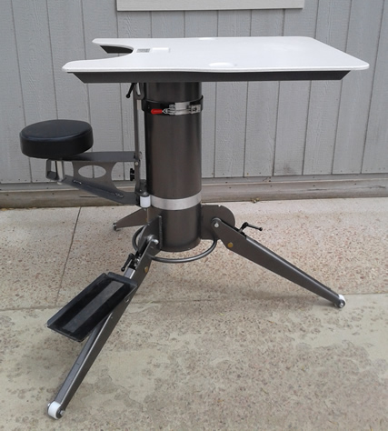

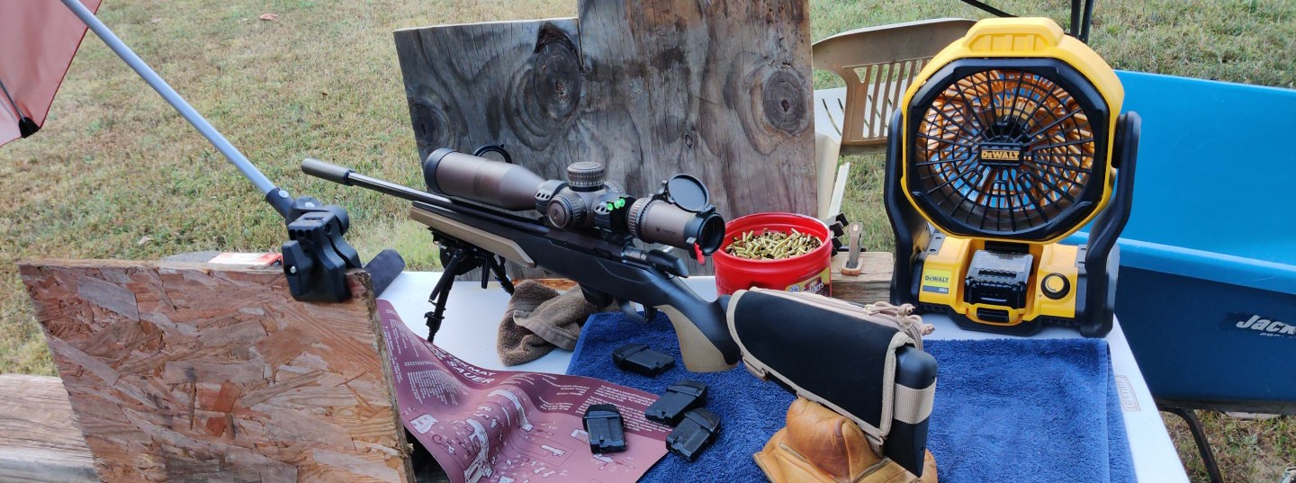

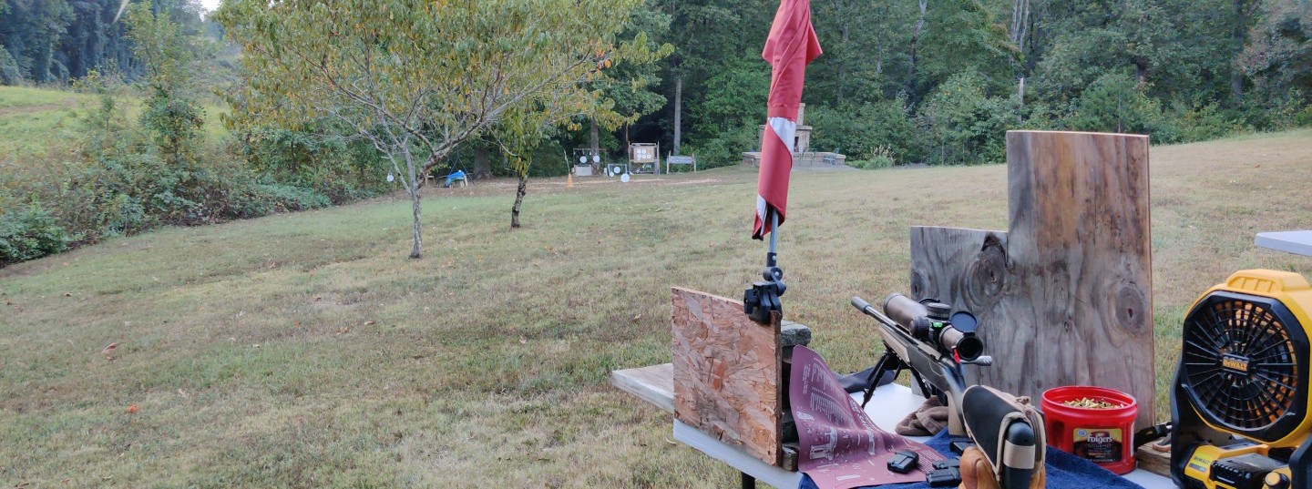

I don't have that much of a problem with the table itself as long as I keep the thumb screws tight. The table top needs to be bigger and I use my 4x4 to support the rear of the plywood addition; like this photo shows.
My home table has evolved to this and it works pretty good. Fan to keep me cool, umbrella to keep the sun off me and a deflector shield to keep from having to pick up empties.

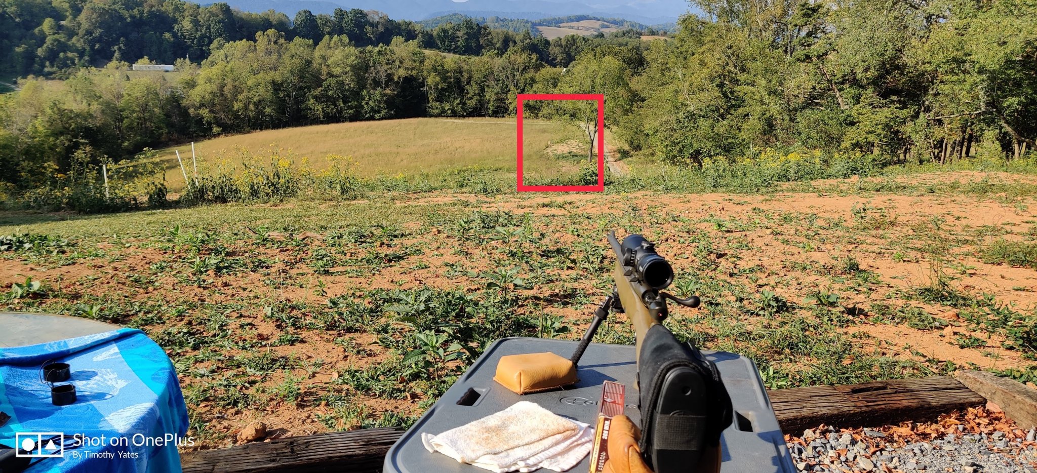

the 1-5 is at 100m, the 2 white squares in the middle are at 200m and the white blob on the right just before the shadows is a target i put up at 50m. When the range is open there are electronic targets at 100m and 200m but at other times, like in the picture, they are withdrawn into their underground silos.
That's what I was thinking. That's a nice range, however I'm not a fan of laying down and shooting.

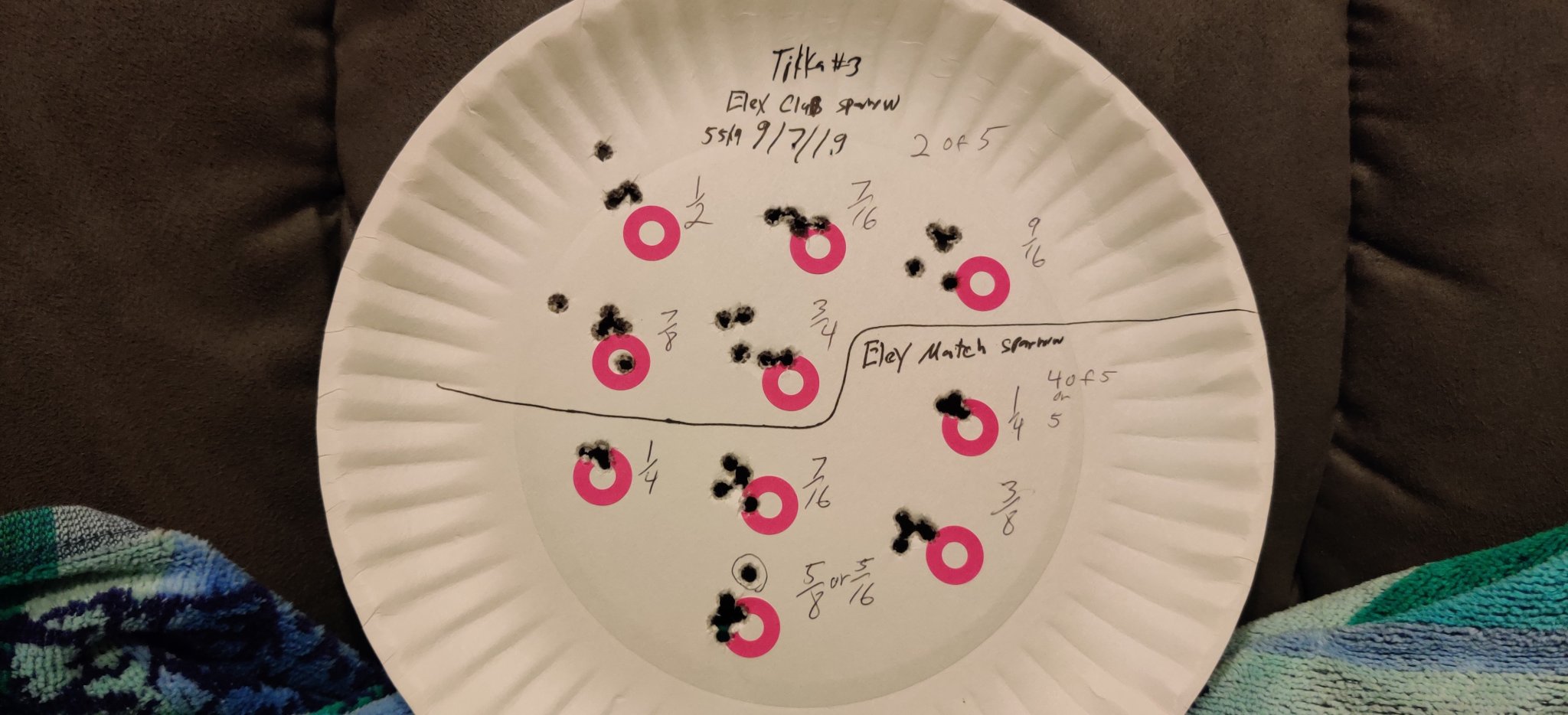

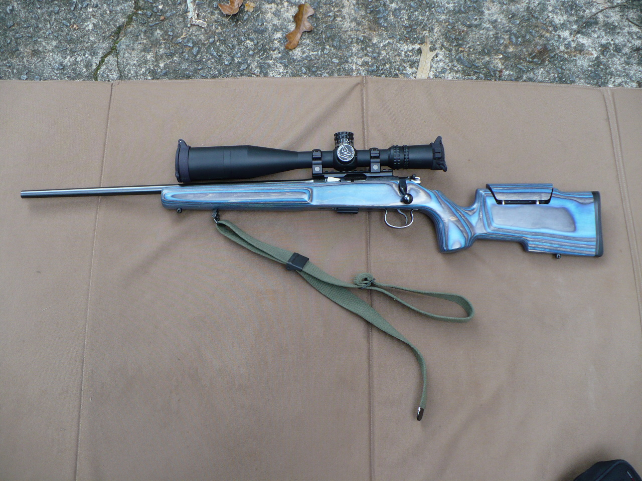

Wow your TIkka #3 is a shooter! I have only tried the cheap Eley Ammo (Target/Contact) at 200 yards and my groups are 5-6". That Pistol King looks pretty darn consistent.
I bought a brick of Eley Club and Eley Pistol match and they do pretty terrible @ 100 yards, so I haven't bothered with 200 yards with them. Only have a few boxes of Eley Tenex left, and given how it shoots at 100, pretty sure it'll look good at 200, but I am just saving the Tenex for matches instead of burning them on paper.
Littlepod,
If I recall, Eley as a whole was not a standout performer with any of my T1x's. I went back and checked my targets and Eley Match was the only type worth talking about. I have yet to shoot Center-X at 55 yards in the #3. I only had 25 rounds left of each type on the target shot with Eley. It's worth noting that I shoot suppressed with my Silencerco Sparrow all the time. I am a firm believer my Tikka's are more accurate with it. If I may, I would recommend 3 boxes each of the following:
Lapua Center-X
Lapua Pistol King
Federal GM Ultra Match
RWS R50 sc
Eley Match
I know this is pushing $200 for ammo but that's just what the cost is. Maybe start out with Center-X and Pistol King and go from there. When Brownells had the Pistol King on sale for $7.79 per box I bought quite a bit over a period of time and I know I had at least three different lot numbers and they all shot fantastic, and it shot well in all my Tikka's.
I would recommend CCI SV but honestly I hit the lottery with my lot number. I just opened up my last 5,000 round case too.

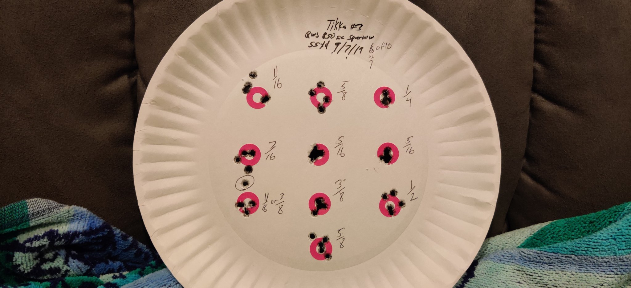

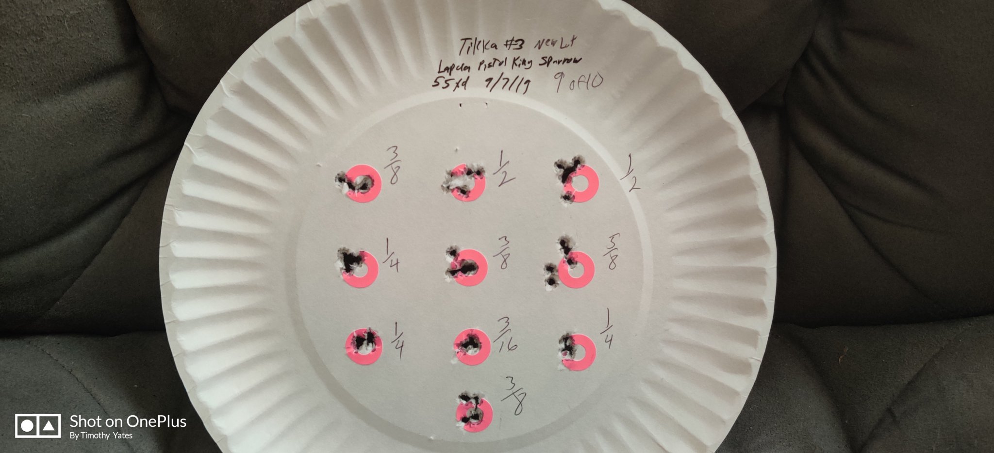

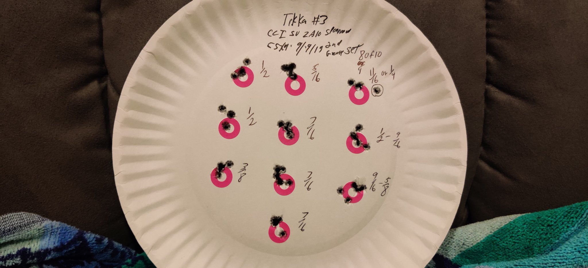

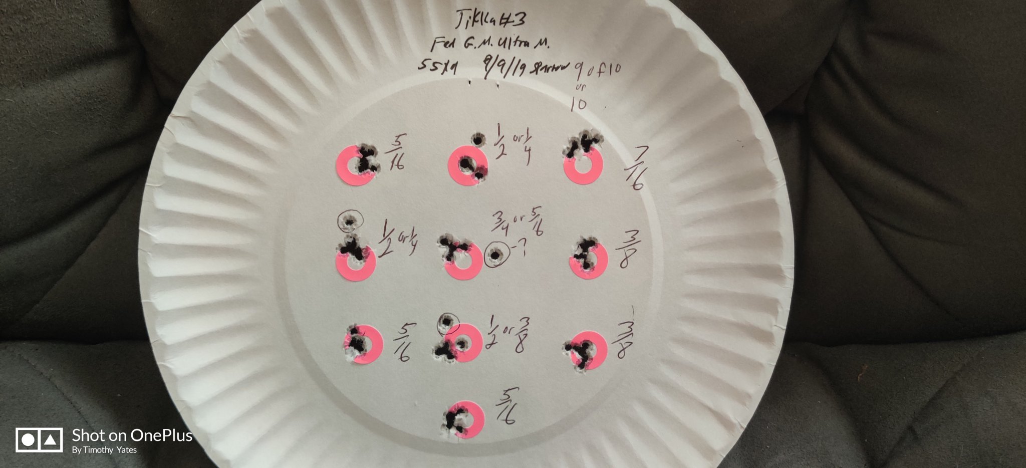

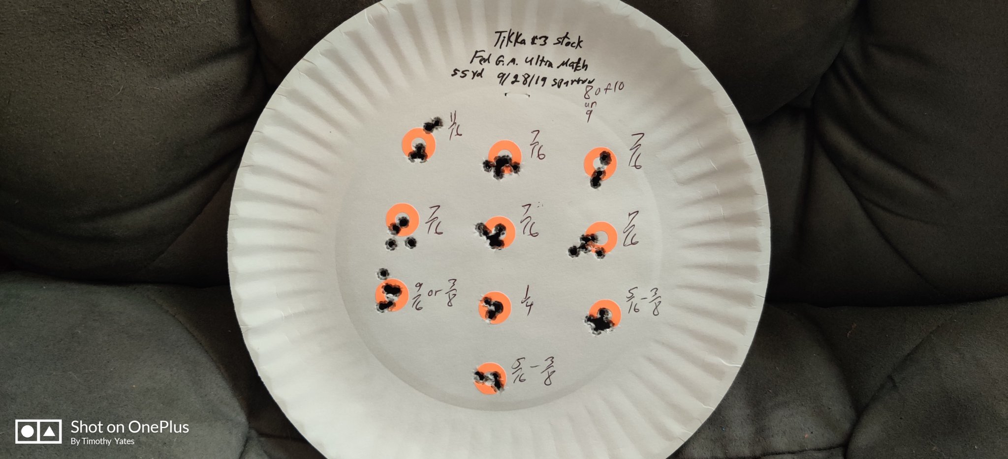

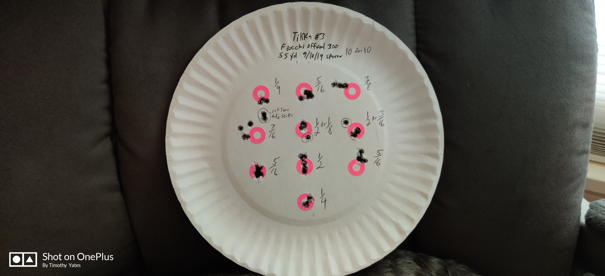

I believe I have put these up before but here are some groups shot with the used but LNIB Tikka #3 at 55 yards. There are 61 groups at 1/2" or better out of 74 total, that's 82%. There are 48 groups under 1/2", that's 65% of groups better than 1 MOA and that's accepting the MOA = to a true 1 inch. To top it off, this is with 6 different brands of ammo.
This is by no means meant to be a bragging post, but merely to point out "with evidence" the Tikka T1x can and will shoot consistently with a variety of ammo. Some people may ask, "why I have three". Well, the first one I bought when they were very scarce and I found one for $450 shipped. The next one I got lucky and Whittakers honored a pricing error on their website and I got the 22 LR and 17 HMR for $362 shipped, each. Kinda hard to pass that up wouldn't anyone say? The third come via a Rock Island Auction, roughly $360 shipped LNIB with box "looks like it was never fired" plus it come with a 20 MOA DIP rail and 4 extra mags, 3 of which was still sealed in the Beretta bag. That is how I ended up with three. One is up for sale, the Tikka #3 will stay in stock form and the other will have its barrel replaced with the IBI barrel in the next few weeks.
What a lucky lot of CCI SV! Yeh mine performs horribly. Pistol King did pretty well in my Tikka. I bought 1 box and it averaged at .9" at 100 yards, which is pretty nice. Tenex though has always done amazing. I bought 10 boxes during the SWFA sale for $10 a box, and it shoots for me .75" at 100 yards, with some groups in the .4-.5". Down to 5 boxes. I wish I bought a few thousand rounds at that price...
I had a box of Eley Match Biathlon that shot well, but their Pistol Match has not shot well. I might go back and try again.
Eley Club looks like your groupings, where random rounds would fly. 8 more boxes... that I don't really want to shoot. I guess it can be practice ammo, or maybe my Ruger 10/22 would like it.
I need to get a box of SK Pistol Match Special.... but right now I'm currently just focusing on competing in PRS style competitions and nothing requires sub moa shooting so I'm okay just finishing off all my Eley Target/Club/SK+ before going down the rathole again for tiny groups.

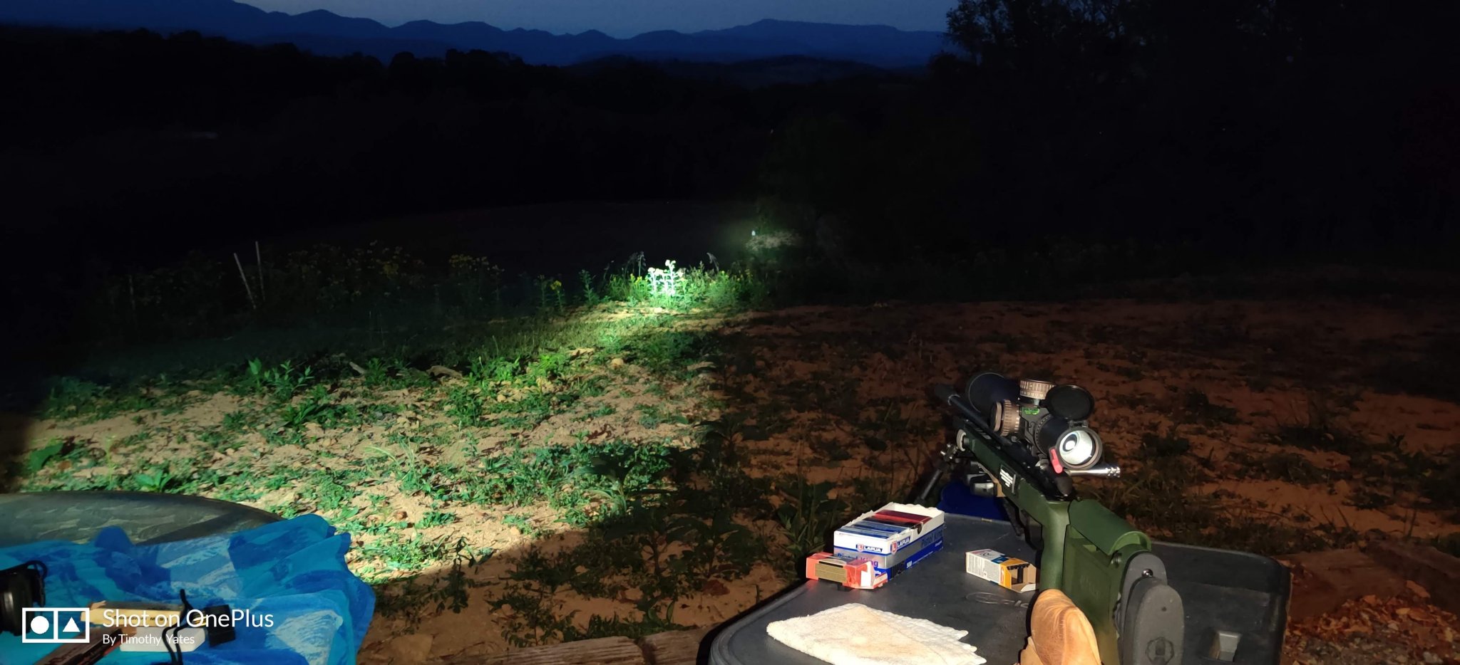

Wind from the East at 12 to 18 mph.
Gusting headwinds, not really conducive to consistent results.
Good excuse to play with the F-Class Buckmark Silhouette. :D
That way when I mess up I can blame it on the wind. ;)

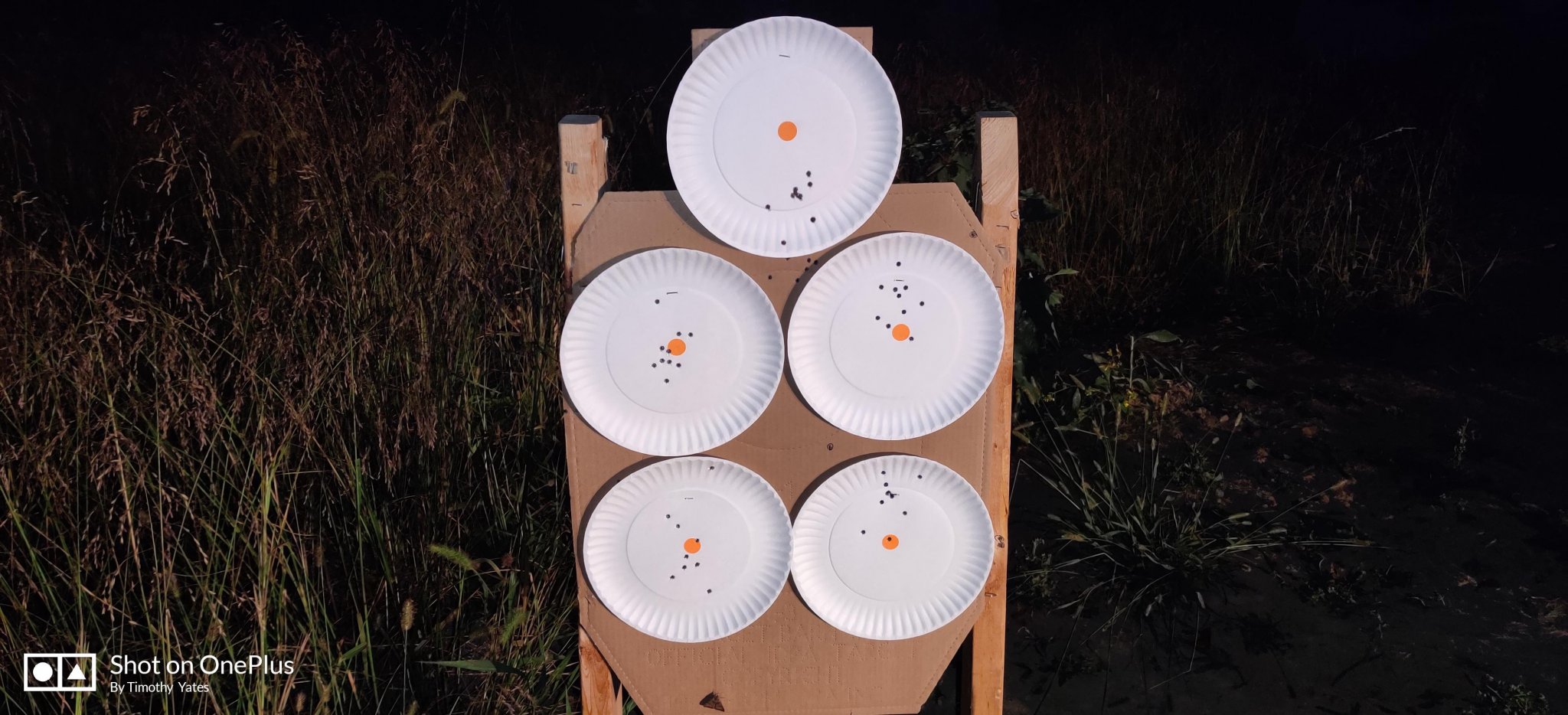

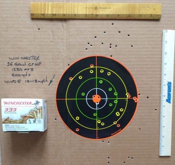

Grabbed the bulk box of Winchester 36 grain cphp left from earlier this year
and set 3 big targets on 3 backers at 200 yards to work with.
Chewed up the first target adjusting the scope and trying different body positions
looking for the most comfortable and stable which allowed the best control.
Then sent 50 at one target, adjusted the scope a little more, then 50 at the last target.
Old Remington tray holding 50 cartridges of the Winchester to keep track.
IaIHz2X6KyC9OEpuNvoybC9v5UIyULaNosXJdKPZfZb5BlZDT7p2q8vFRnqXO8wFZ0D0sfKbip41tpebjUf5Lumky3cwKs_wng8UrXp0WdnETrFCsJ-1x-DQg7Fed8bE5nztOfNvtw0rcTCqFPARpAT0G3MitUXNts8f-zZaw80YqOPli_EqF2vIQysRK05dQp-4NvlC_PX_sX2fCi7kQieKoLr7kz5DjtETt53Ayku_aT2V_bdyG-Vrl1yiKgPChI8a5XW3bqplyAwnIsii2St8hgpd229Fgme1ss29CagDnagKHySPnwBBz6cCoknkeSkUQPVz3OGFx1f3bKaiZSG-vrKEqJdRdYS-XfDlT8rzgNOnn3vKCEgVPW_nGs7prGbgP1wfGeZTGkEPnPd_FIivsDt6xe0Mrh3CZTZO8JeSX7vrPtM0ItQAIFwSMB1v0rKLk5g9vhV9mkrcyOdRcjOlAVZovJ6mvCBInnaahleSWJVhssO3UOr8TBkFVOLlpKRx3EpjJf6db4xO1i8Ek_crqA0o3IMu_FbfBNHDZsYdW62A4yOGdwl8P74FylPQqataPdGo5tVlULqZDFK3oclrrjc7ovn1D1lZ959G_cM1MkcTRU_ntNU8VR6_aGiIBcZw0WjZt69kDTdIjWYETrUyvqzSsZ8A-98rJAxCXcoaugfMW5N-ubs=w557-h626-no
The first 50 trying to hit the black dot
a84jBEw_IFx1qpruecUsbZZS3pVUhc5cK8s2dADVSG0tOVRD_L7ygfuzO3_TkXlAdSnYezF1xUjzVnBCync0Sj7feg4fUB-qCzaXmQruaZ0_XNB-a3ewN0FzxY_9M6Uk90ZCk7KYD--RV_lDSAIG0eqfhjFQuSWs7lbdrZk_pQePTx61RW2xhPTa7sig7VGyotrneg3UUPbLt1sI245YP6aDjKaS5VlfIRZ4cb_KNQwnFbJhO_14WubbUYqBKbBA-vZpfM-KqHWC9_k1SIOeFumT8oZ-3zPdAh55t1PkyXFhI_SrdBobdSNzM8pYnx9HcupwXhF5xkj7S-ITR6PigEZg7TlNq-vV007TXC3SCiKDlHZ5H803mmk2zzpnQKfv2gxhoIz7toeJm72PSFCn529D1lNDtpf2OvKVcOaKDA0BsQ3NlV90Px_F7LUW9T2ujFlVU8um7Xp1QYoMA0SiaTykcNtLJ7VJ6ZTfHNz0m9Bej7bsa1vDneWyZggxLamgSM9Ls07BRKVJGjBo2HCBYIRUaAB7Fd4w8C6o6Bez3DvUGTuEhoZIGdnGmdnOsvWpI5gAu-h6hKFlBNeF0kRnHEMvww4ZoWLcqLKtos6IQohwPOyrDF4R1n8XCN_BJR9PS-3urbJ8g4cOM2M8BTWmscS9tYAgu5WdUNsiZ-UnF3JOGw6IQyGh-q8=w569-h596-no
The next 50 after another scope adjustment
bwT-UaCDe0X4KVVTKOuAvWCBRMs4SSxTEeT0R9TyeZdkG3H3BL3LRteYGUiIw1_rpY_2OBuUSB_NDclWutHyqnAJXweubuUmYI82Hc7MhJWsjDk_LWmPWLmqgF1X683AN5ViGYpNl2loINVscUd4BEkt1EErYXxPTFV7kCtwFrQmxX3xeoDaH4O030cFmqxpmGIVzXT2KtIgaFBeLG4cSye7Ee9vr1ikSnVgEXyOBQn6iucZw_jk3oiavt2QDH5d1eNl5wnRqB-Uo0Gl-xugW41QG-7llLJUdZEVQ7DtaWk0slP5fkCHsGD-hQrefwzICZJtNTMpzYZfbEMGInPjsoSIdclEKt63Re8-SqX1AF5S71njP3n1G4ZjD4aIhJ09-IAeIQ8Q9r7Ed7cra4PhgtcnYyBX0baSAnBKR2_jbepGIGrdHXPY8rp8YfD8Nd3iTBIBHnBWai-NQkEevag-0CA7xQebnqrLF8mlmzkmdFAHwqvGuDQUMC1vxbhk5c92q3Y_8Udej5QVu8gCp745tu8-KRKBDxqXp5oCNcCy-Wnz8Mqi9IrWxUqPnXWU7SZkiq83JytbLObnqDyuLEPVbSu4AWylUQ6iVYNYfyiulFMbAC-lrELDd8WGjJGYfDMVNOHyjyEG0n1gSEzsjTYGxM1X9sYxAcbMVz5kEhBdeS3_iko4ww74KX8=w602-h567-no
Kept all the shots on the backer this time.
Even with the gusting headwind.
Not quite so much lateral spread.
about 14 inches of vertical, apply the half-third rule
100 yards expect 4.7 inches of vertical
50 yards would be 1.6 inches of vertical
25 yards and 0.5 inches of vertical with a pistol, for 50 consecutive shots.
Bulk 22lr under lousy conditions from a pistol.

Night Force 42X Competition scope, put together by Gene Davis.
Wq2MAXqOBVKDl4VPeDoAZ4pTyQCWYaq6Y-TbggmrfInMk6N6OX7af1XoGCNAF9s-EGCYxfuPhF8C8-XZN7ad3Xh2lp6CmR_6i-DcBokgGPGkQHoTJ7SC1kef2PC6dzdIenTlw4Rot8cTwxRE-Y2xHqB-1jlgC6YGhrkHPmCRB91bKDOturUHIX3nHUsXQAvFNZX4PcRjFpinRdAKl2gzr373FGSKiAmNS6FaYEdKaYGKT4PYNIck554J4JwB8lqhHDzXpIga6iuc7maeTw3N8tcvhXZq_zrJIyO_x7efNSw_2MkXhQbTT6XLLr9IWBbRCyXBBuPRTOnjI308kLdLUztc8e1WK8GjVaBhsKzjh6G-JEhUmDPkufLcPiUlF37aCu9amrJl7R-XBJtkIIFEtwMN95JffgR9n_AQGmjqUyHXjIw5v6vHpguur1cZWBAdGLTkc2GVSe9j67EVoncpaH7zLK9Utk_ZO_pWgpzLvaU4NAZTcVaBPeU1zf0qbUU45Uu2LRIwNtmtOgdM7p0m-Cpi82p23h-uO-0nH5vuygIaizSq7Uqexs7U-39bhJDMF0T_CoMTKgtITD4jxjIELiDMlpC3o_uTsl0f3i8atbAgwxHLiHAVDVaai7qDeAInXSKiRHpiLLqlbTBnyFUUtpo_OtaI_FpTKC2hwqRijdqZy37XCmHlo3T4bc48p2tQG7-Sd7EHKVJ5SzF3HnW9GEZb=w704-h938-no
and a box of Eley Match, lot number 1018-01212.

Maybe this bench would help with your endeavor......
Ummmmmmm....after taking a close look, I'm thinking it wouldn't help.
It's on wheels....I have enough problems when the bench doesn't move. ;)
Who is the maker of that bench? I can see some potential for it. Those itty, bitty wheels aren't going to roll in dirt.

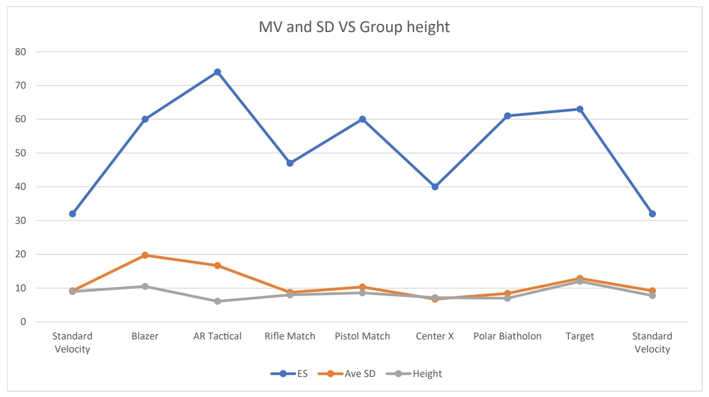

MD, did you run the numbers to compare vertical spread to ES?
And where are my rifle pron pics?
Range and setup images so I can obsess over the facility,
the gear and the chronograph.
Very important, eh? ;)
Here is a graph I made of the results reported before. It also looks like SD correlates just as well with the group height?
Blue line is Extreme spread.
Orange is Standard deviation.
Grey line is Group height.

Eley Team 40 grain 22lr rated 1085 fps
CZ 455 Varmint, Lilja barrel, Sinclair bipod
