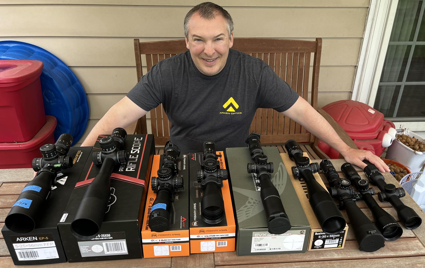

2023 has come, as has the first of this years review products so I guess it’s time to start up the 2023 BigJimFish review thread. As with the previous 2022, 2021, 2020, 2019, and 2018 threads, the purpose of this thread is to provide a catalog of this years reviews and articles, give you a behind the scenes look at what I'm working on as I'm working on it, provide a place for input and comments, and, of course, give you something to bookmark that will ping you when a new article is done.
The majority of this years reviews will essentially be part two of the series of sub $1k long range scope reviews I did in 2018 and 2019. It’s been a number of years since then and we now have a whole new crop of products in the category. I'm excited to see if there has been progression in the performance at this price point over that time or if perhaps Bidenflation has pushed things the other way. My expectation is that progression will be the order of the day.
Sub $1k long range scope reviews:
This years series of sub $1k scope review scopes from left to right: The Arken EP5 5-25x56, Hi-Lux PR5 5-25x56, Primarly Arms GLX 3-18x44 and 4.5-27x56, Optisan EVX Gen2 4-16x44 F1, and Bushnell March Pro ED 5-30x56 as well as some previously reviewed scopes used for optical comparison: Leupold Mark 5HD 5-25x56, Athlon Midas TAC 6-24x50, Sig Sierra 6BDX 3-18x44

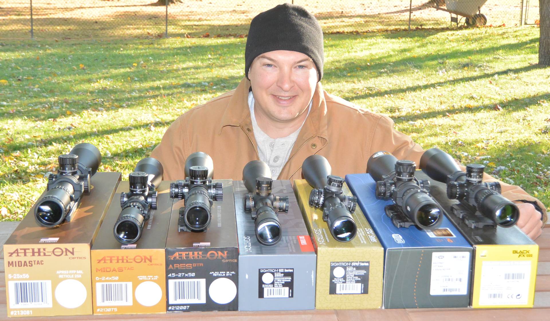

I’ll admit, all written out this certainly seems like a full year. I also wanted to go back and do an Everyday Sniper episode on laser rangefinding sort of summing up the Sig 10k and BDX reviews, the Leica Geovid Pro review, and the nVisti article as well as a second episode on the ~$2k scope reviews from two years ago. We’ll see how much gets done.

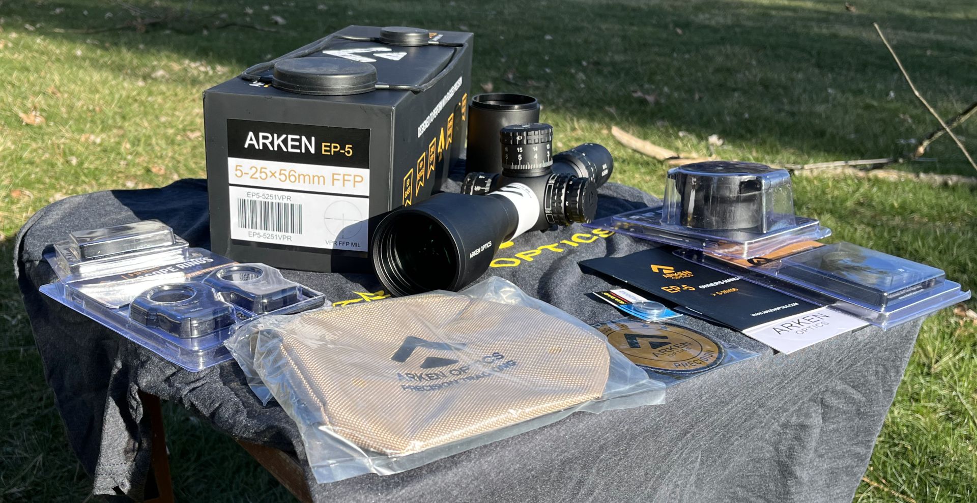

Arken EP5 5-25x56 and “combo pack" unboxing
The first scope to arrive is the Arken EP5 5-25x56 and it’s quite substantial “combo pack". Man is that ever a nice offer from them. The costs to purchase separately vital add on items such as rings, levels, and caps is quite a substantial portion of the overall cost of the sighting system when dealing with lower cost optics. Often, these costs are mostly due to the inefficiency associated with these separate items being separately packaged, advertised, purchased, and shipped. Scope caps, for instance, are less than a buck of plastic. What your paying for when buying them is almost entirely the base cost associated with the logistics of bringing any product to market. Bundling these items this way is just a huge savings and lets face it, you’re not really gaining a bunch of utility when your purchasing them separately. You’re probably going with cheap scope caps, medium-ish height rings, and a strap on bubble level. I'm guessing you would rather save most of the cost than be picky about the exact versions of each of these products you get. If not, Arken’s mechanism even gives you an opt-out by just not adding the “combo pack”.

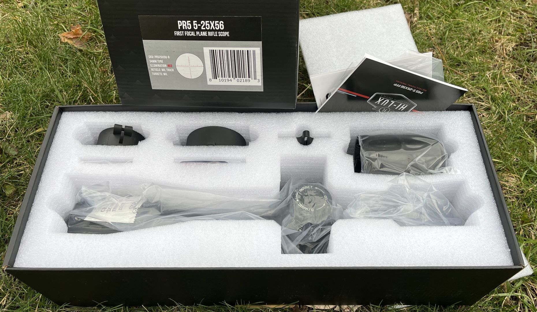

Update 2-10-2023​
The Hi Lux PR5 5-25x56 arrived today. Boy, the Hi Lux guys must have even less faith in UPS than I do. This things packaging is like a challenge to the manhood of all dedicated package destruction professionals. I mean, I’m not even sure U.S. airport baggage handlers could take it out. A slip cover holds tight the heavy duty card stock box encasing custom cut thick closed cell phone. It’s like one step down from a Pelican box.
Hi Lux PR5 5-25x56 FFP in it’s remarkably complete packaging

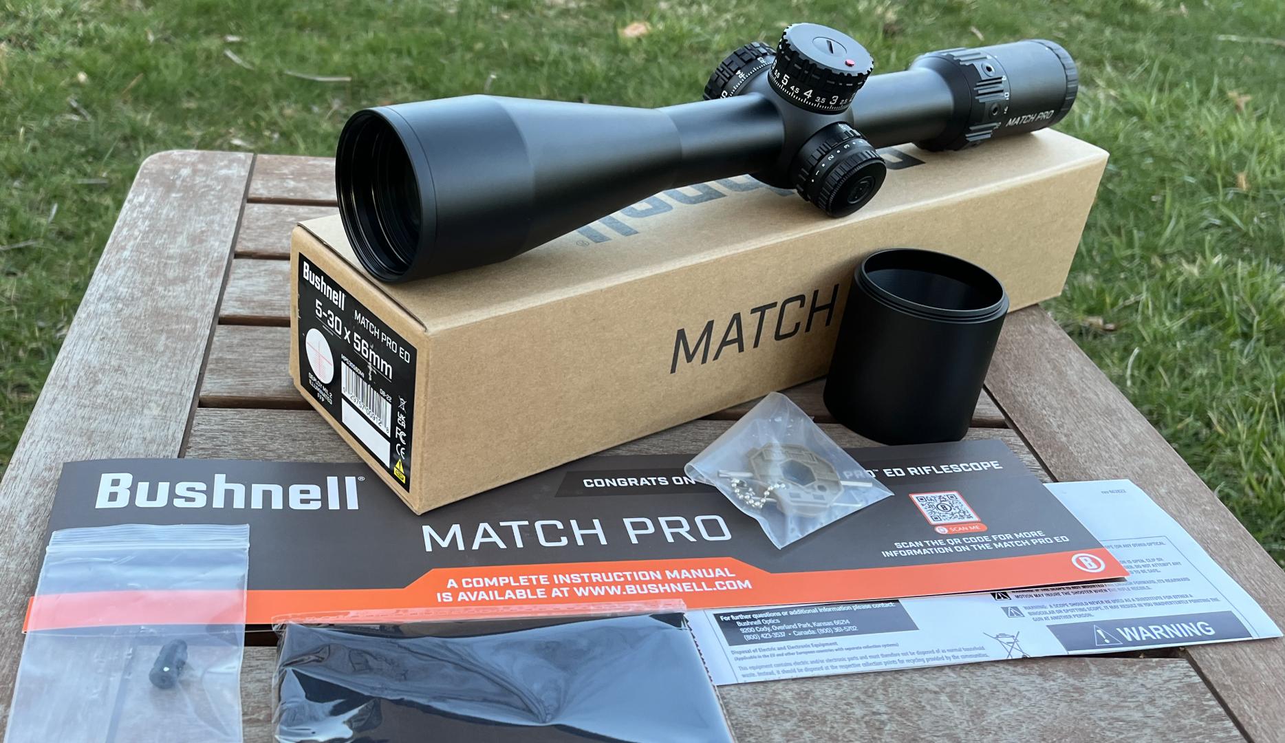

Update 3-1-2023​
The Bushnell Match Pro ED 5-30x56mm arrived today. Amusing that this was the scope I opened immediately following the Hi Lux. I went from the most packaging I have ever seen around a scope to the least. There sure isn’t a lot of the cost going to the box on the Match Pro. It reminds me a little of the plain white boxes the U.S. Optics scopes used to come in back in the day.

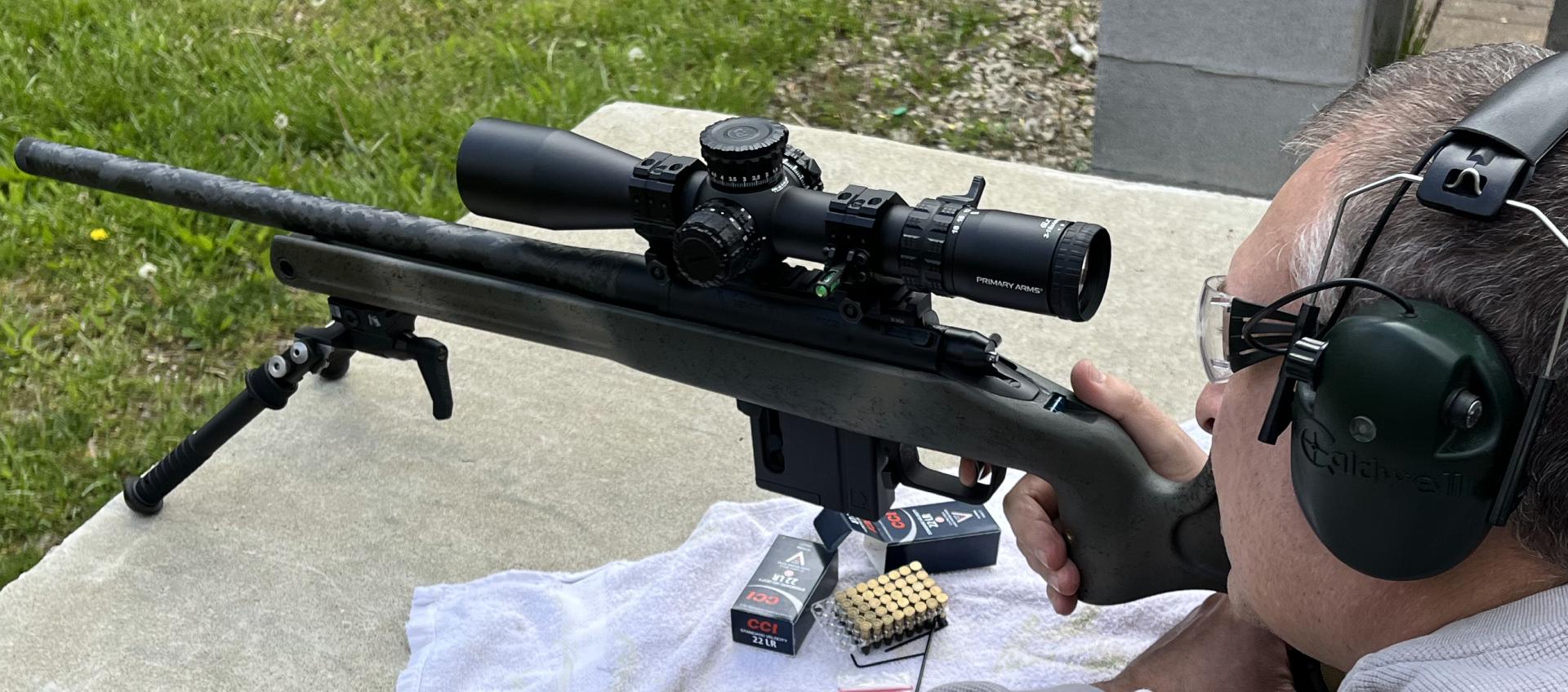

Bushnell Match Pro ED 5-30x56 Unboxing
With 3 scopes in hand now, in addition to a few of the scopes from the last time I looked at this price point, I will probably start to get some of the testing going. ETA on the Primary Arms GLx is also not too far off. I should have that by the end of the month. No ETA yet on the Optisan.

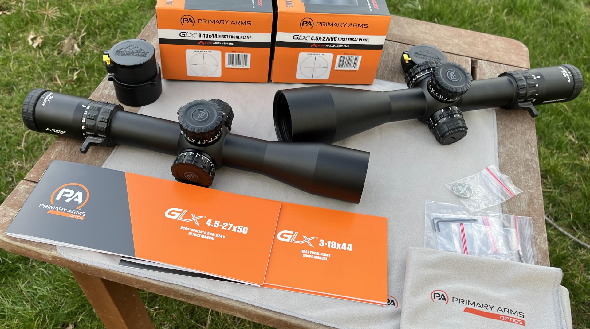

I was expecting to get a set of rings in the mail from Primary Arms today but ended up with not one but two surprises in addition to that. The first surprise was that the GLx 3-18x44 scope for review arrived with the rings. The second was that it brought it’s big brother the GLx 4.5-27x56 with it. I think I may have gotten my wires crosses a little with the Primary Arms guys when setting up the review. I was a bit indecisive on which model I wanted most to take a look at and by the time I decided I think they were both on the way. The upshot is that I'll get to take a look at both. It may end up for the best as most of the scopes in the lineup are of the higher power, larger objective variety like the 4.5-27x56 but I personally have an affinity for smaller objective mid power stuff. It’s going to be a busy couple of weeks between getting my business ready for the year, finishing taxes, and taking a look at these new optics.
Primary Arms GLx 3-18x44 and 4.5-27x56 rifle scopes

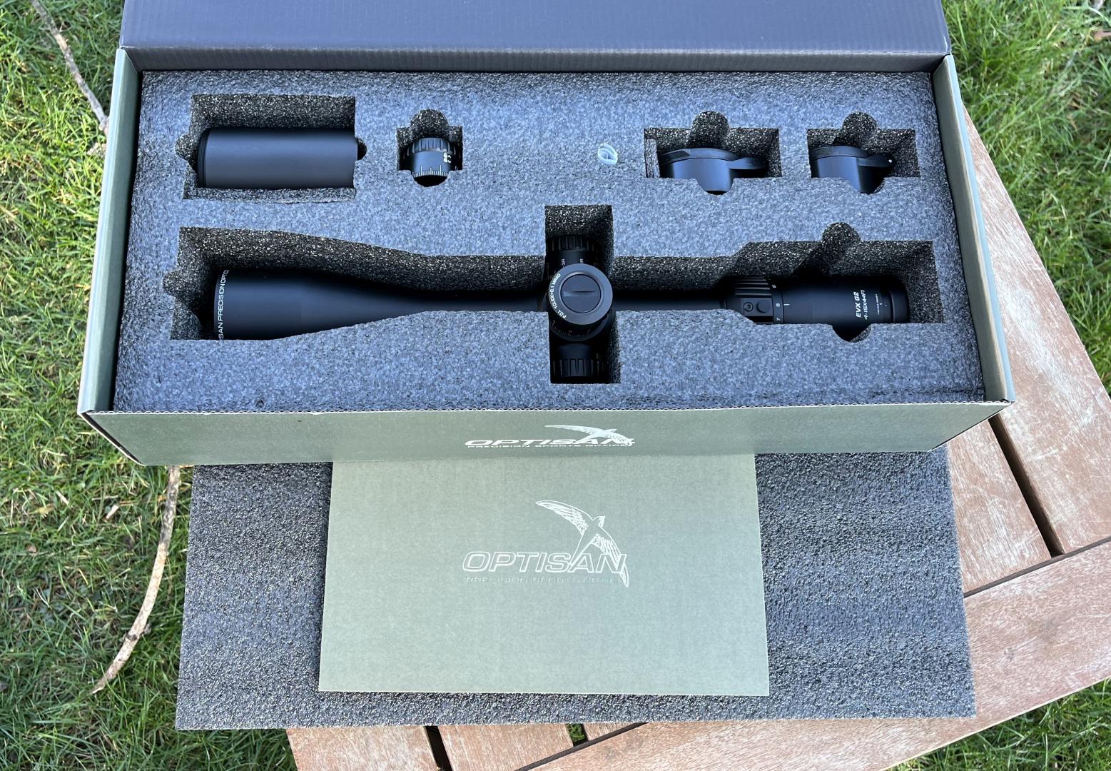

The gang is all here. Friday I got a surprise box from big brown and in it was the last of the sub $1k scopes for this years reviews, the Optisan EVX Gen II 4-16x44F1. This scope sure is light and small. It’s definitely a hunting / precision crossover design. The weight is 26.2oz making it the lightest scope I have reviewed in a long time. Should be fun to take a look at. I am quite pleased to see precision rifle features start to invade hunting scopes.
Optisan EVX Gen II 4-16x44F1 in it’s comfy box

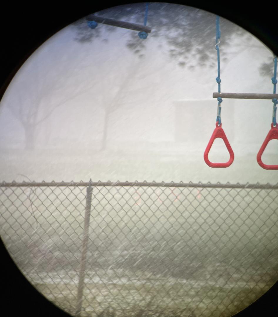

Laser Rangefinders, Snow, and the Sig 10k Fog mode

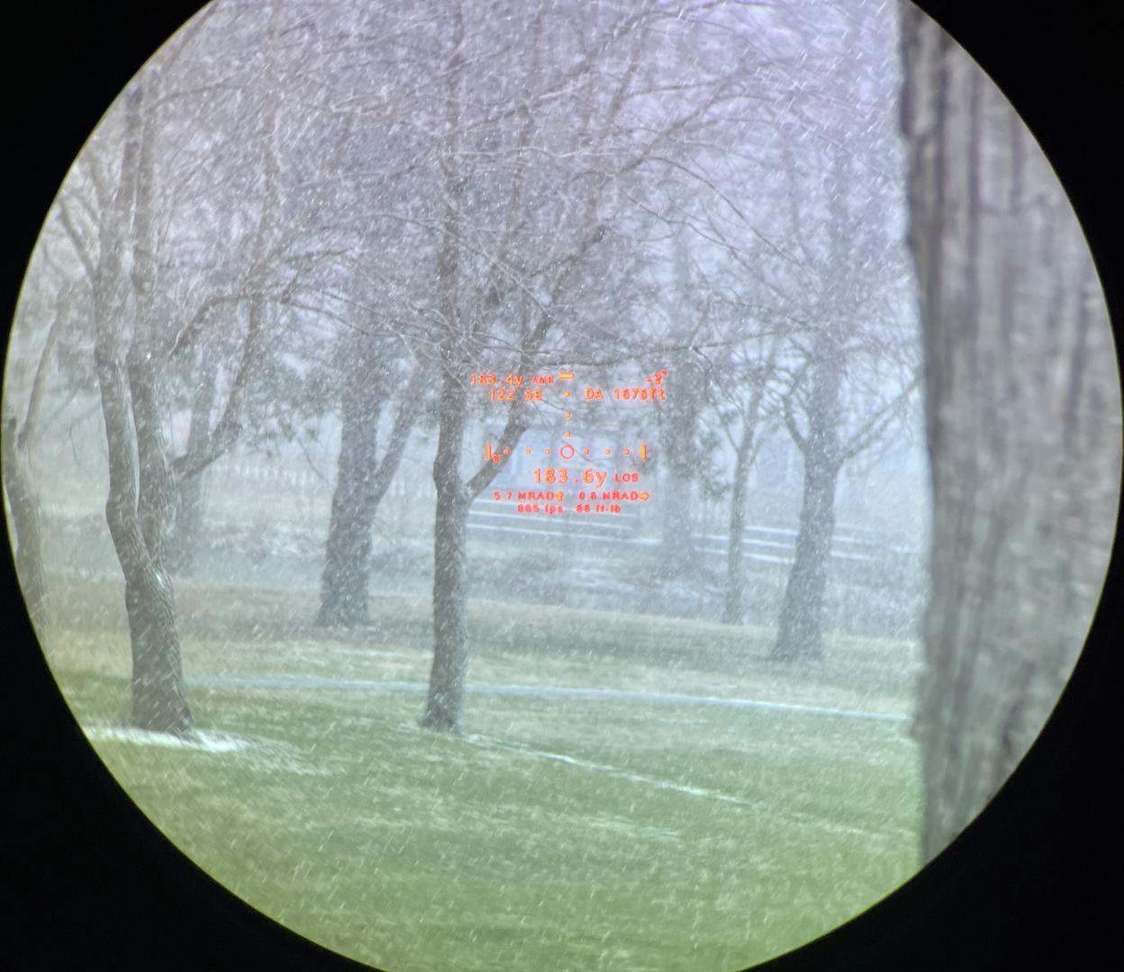

A while back I had a question from a member on laser rangefinding use in the snow. Of course, it wasn’t winter then so I could do little but look it up. For this I went through some white papers on the topic of which this paper had the best information on the effects of snow on both 905 and 1550 nm lidar. Most consumer units, including both the Sig 10k’s and the Leica Geovid Pro's are 905nm but a few of the $5k+ units such as some from Steiner and Vectronix are 1550nm.
Reflectivity of snow on 905nm light is quite high. Not quite as high as visible light, but similar. The same article also indicates that the military grade LRF 1550nm light is simply virtually totally absorbed by snow and returns essentially no signal at all. In the case of 905nm such as the Sig or most commercial RF units use though, you will get a great signal return from this reflection. Twice what you get from bare earth. That being said, stray 905nm ambient light is relatively common from the sun. This will also be quite effectively reflected by snow. So, you should expect both the signal and the noise to be higher in the case of the use of 905nm LRF units in the snow as compared with snow free conditions. I would therefore expect that in low light, you will actually be able to range further on snowy hillsides than snow free but in bright sunlight you would not get results as far. I would also expect 905nm laser rangefinders to have trouble when it is actively snowing. As for the 1550nm units, they are going to suck in both conditions.
Heavy snow through the Leica Geovid Pros. They read 30yds in these conditions regardless of target distance.
This week I was able to test these hypotheses out in both light and heavy snow with both the Sig 10k’s and Leica Geovid Pro’s. Here is a qualitative but not quantitative summation of my experience. Keep in mind that snow conditions constantly change minute to minute and second to second. There is really no way to do this in a quantitative way. I think that the experiences I will relate are nevertheless helpful.
With Snow actively coming down, both units experienced dramatically reduced range. They do tend to return a range however. It’s just wrong and short. They like to throw distances of around 30yds regardless of what your pointing at. The Leica has only one rangefinding mode and so you really can’t fiddle with anything on this. It just doesn’t range well with snow coming down. The Sig 10k however has a “Fog” mode that clearly should be renamed "Fog / Snowfall". Utilizing this mode it's performance is dramatically improved and it can sometimes range targets I cannot make out though the snow such as a privacy fence at 245yds. I know where this target is and how far because I range off my back porch all the time but I couldn’t actually see it some of the time I was ranging it with the Sig 10ks on Fog mode. I don’t think there is any real rule of thumb I can give you on the limitations of the Leica or Sig in standard mode except to say that you will still be able to make out some targets though snowfall that are well within the normal rangefinding capabilities of the unit but that you cannot range due to the snowfall. This is not so with the Sig 10k’s in fog mode. They appear to be able to range more than you can see through the snow anyway. So, if you see game that is in range, you will be able to range it. I’m sure your overall range capability is dramatically reduced, but so is your visibility so your not really loosing anything. If you can see it, you can range it. It doesn’t really get any better than that. Fog mode is a game changing feature for folks hunting in the snow.
Sig 10k’s in fog mode ranging an outdoor display board in moderate snow.
As for ranging snow covered ground, both units didn’t seem to have any problem. I’m sure if it gets whiteout bright enough your going to see some reduced maximum range performance like you would have in bright sunny desert situations from reflected solar interference but in the overcast snowy conditions I had I was getting totally snow covered hillsides fine during lulls between the flakes. I might add I would expect no return from a 1550nm laser in these conditions as absorption by snow in the first few inches is far above 90%.

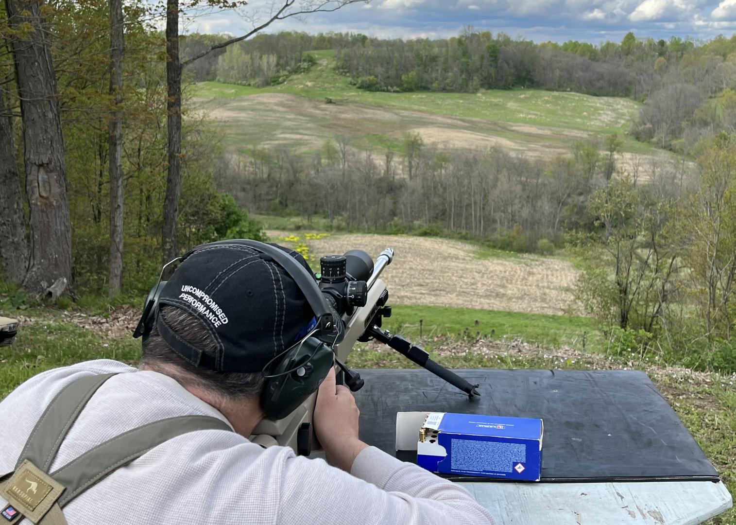

I’ve been doing a lot of testing on the sub $1k scope review articles. Boy is there a lot more variance in performance this time around than with the last set. This is true both optically and mechanically. Obviously, this is a lot better for some of the scopes than others. It will make for some good reads when I’m done though and all the testing is humming along. I had a fun time at the range last weekend with the Arken, Optisan, and Primary arms scopes. Also, I continue to be super impressed with how good those Applied Ballistics custom models are right out of the gate. So many of the ones I have tested have been correct all the way out to transonic without any truing. This has not been my experience with ballistic models in the past.
Arken EP-5 5-25x56 @700yds on the Kelbly Atlas

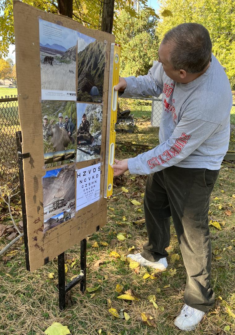

At the same time I’ve been working on the scope reviews I have also been doing the level use article. That article has me creating some alternate optical test boards. This has ended up staving me a bunch of time relative to using the big 4’x8’ plywood test board. It is also much easier to quickly switch out different test target boards in the stand in order to have different testing arrangements. Lastly, you can easily precisely level the vertical axis for calibration when mounting levels to scopes. This has been quite useful given how many levels I am messing with for the article on their use and is the reason for the new boards in the first place. I honestly doubt I will be bringing back the big 4’ x 8’ again.
Leveling one of my new optical test boards

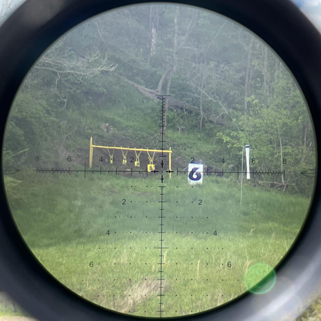

    Update 6-17-2023
    The Arken EP5 5-25x56 review is now live. Boy, this scope has really generated some sentiment on the Internet. I have heard everything from (paraphrasing but only slightly) “It’s almost as good as my ZCO” to “it’s like looking though a dirty coke bottle.” I can’t remember any optic this divisive since maybe the old IORs. I find this strange as I don’t think anything about either the company itself, or the scopes performance should illicit such hyperbole. I guess I really don’t understand the internet. If I did, I would probably have to be institutionalized though. For my part, I found the Arken a great value for the money and a pleasant scope to use but not one that immediately springs to mind as a comparison to a ZCO.
    Plate rack though the Arken EP5 5-25x56
    Next up on the review schedule will be the Primary Arms GLx scopes. I went a little out of order as the rings for the Bushy were behind schedule putting that review behind and I need to do some more testing on the Hi-Lux as well.

    Update 8-14-2023
    I have just posted the review of the Primary Arms Optics GLx 3-18x44 and 4.5-27x56 rifle scopes. My initial plan was to review just one of the GLx series. However, two arrived so I got to sample a bit more variety. Optically, they proved quite similar though so I combined them into a single review. This optical similarity is not uncommon for scopes in a single series. Often, scopes in a series share not only similar quality glass and manufacture at the same site, but even commonality in large parts of the optical system. For instance, It appears to me that these two GLx scopes likely have the same eyepiece design.
    Zeroing the Primary Arms Optics GLx 3-18x44 on the Vudoo .22lr
