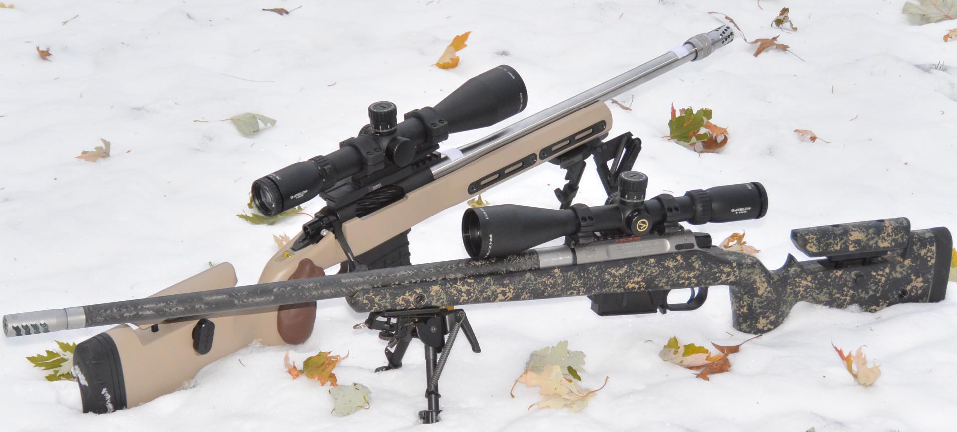

Athlon Midas TAC 5-25x56 (background on Kelbly's Atlas rifle) with the Midas TAC 6-24x50 (foreground on Mesa Precision Arms Crux rifle)

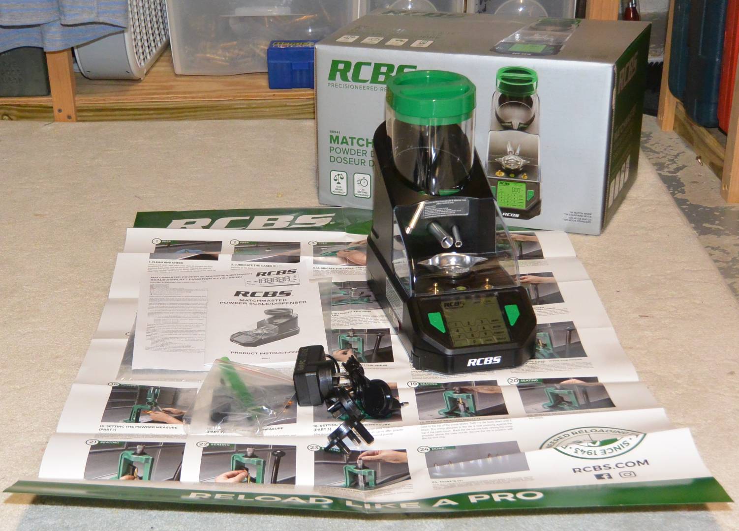

In other news, the RCBS MatchMaster powder measure arrived yesterday. I prepped the cases to use in this testing a few months ago using the RCBS MatchMaster dies. I'll be doing the first round of testing tomorrow.
RCBS MatchMaster powder measure unboxing

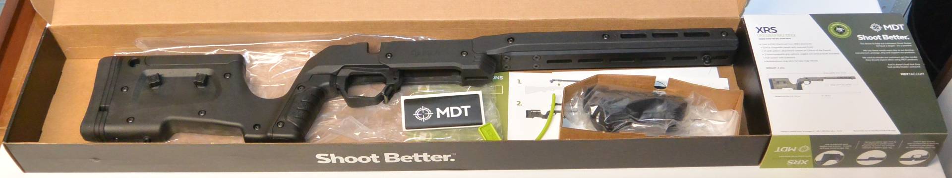

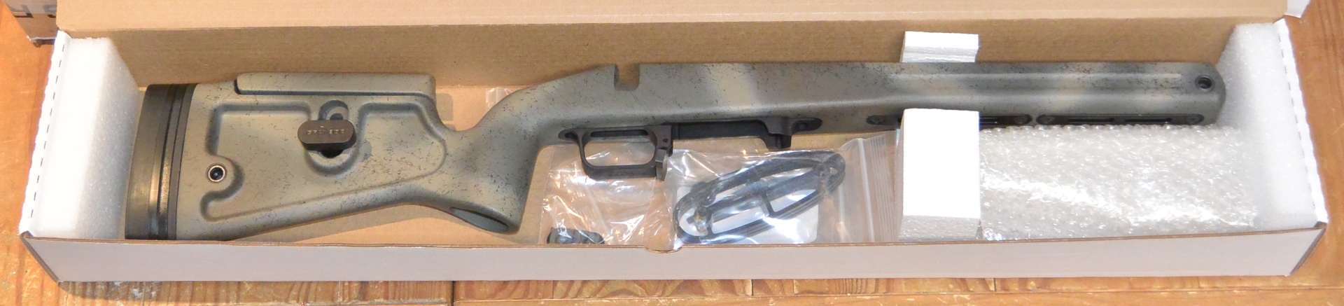

This week I received an MDT XRS "Crossover rifle stock." Here is a link to the ongoing SH discussion thread on the XRS. The last couple years I did reviews on a couple of composite stocks from McMillan and Grayboe. in which I spent a good deal of time talking about composite stock technology and that technologies strengths in general as well as the specific products in each review. I had been thinking of doing a similar thing with a chassis review. There were a few new chassis launched at Shot this year that specifically caught my eye because they added interchangeable grips more involved than just going with an AR15 grip. I think grip fit is tremendously important and very often is not properly addressed so that pretty much made up my mind to do a chassis this year. I think MDT XRS will make a very interesting subject. It has a number of unique features to it's design and manufacture.
MDT XRS unboxing

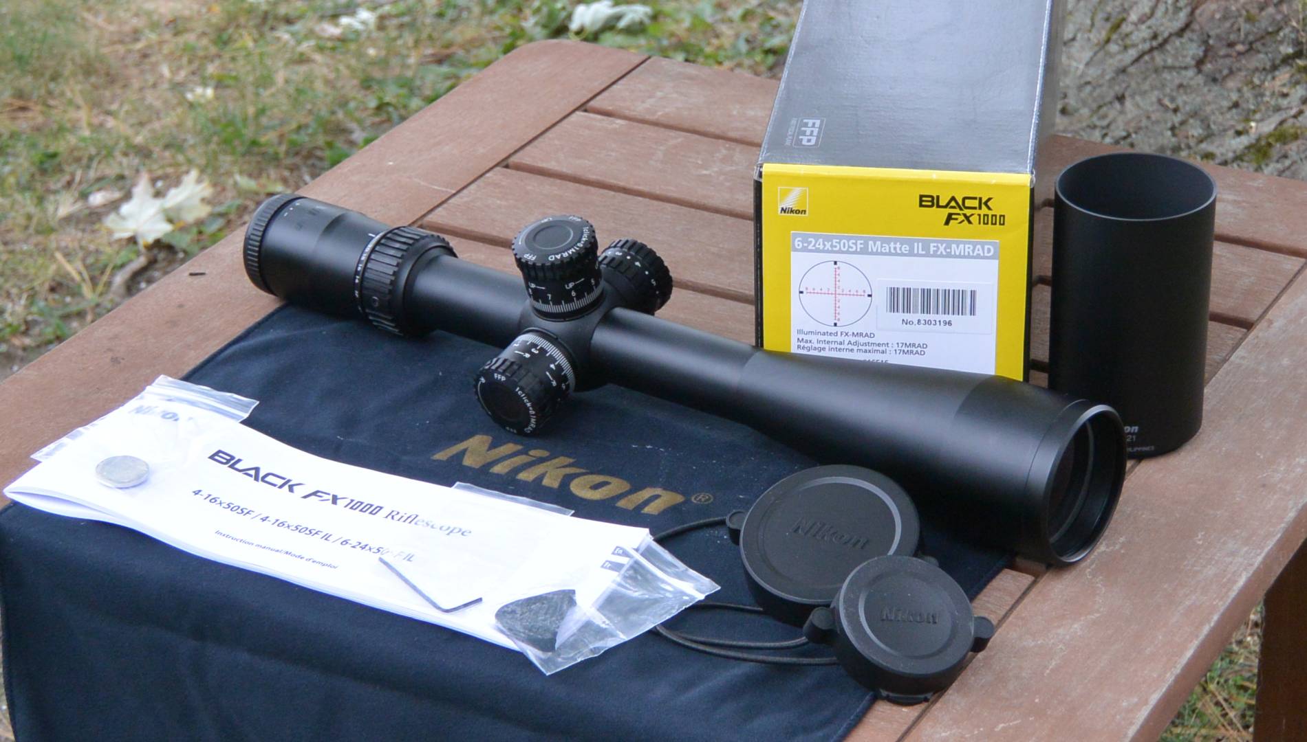

Update 4 -16 - 2020 or What happened with the Nikon Black FX1000 6-24x50SF Matte IL FX-MRAD

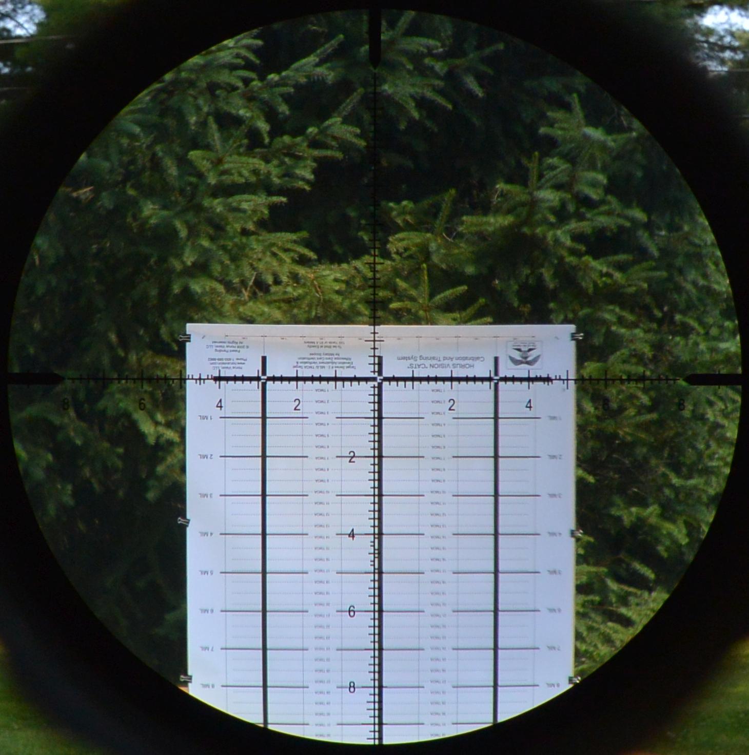

For some time folks have asked me about the Nikon Black that was part of the Sub $1k long range optics series of reviews. Pretty much all I have said is that it had to be sent back because it was defective and, for the obvious reason that Nikon decided to stop selling scopes, I never got a replacement to complete testing with. At that point writing anything on it became pretty low priority and so it just never happened. Now, with most of the facilities I need to do many of the other things on my docket closed at the moment it seemed like a good time to give the people what they want. Since I didn't get everything done that I wanted to for a full review though, I'm just going to write this short summary.

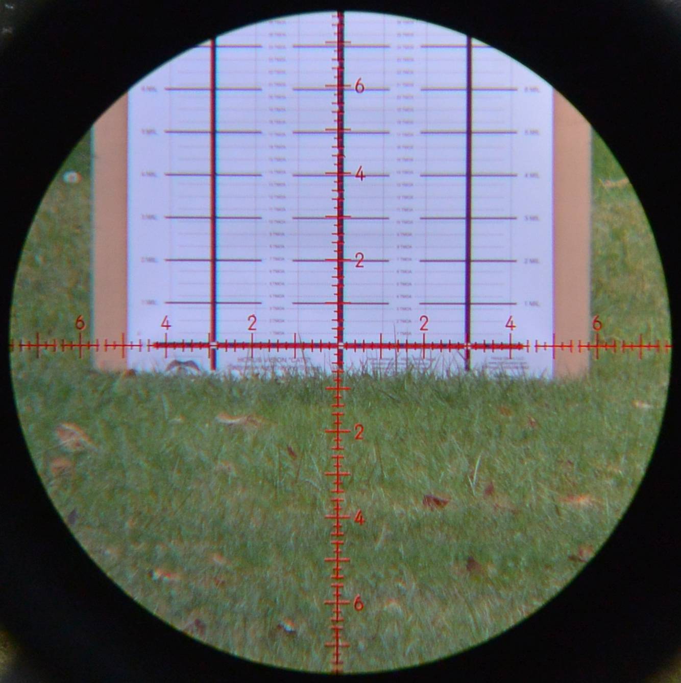

First off, the scope that I had did not just have one issue but at least four of which three might have been related and the other probably wasn't. We might as well start with the reticle, which was almost 2% too large in size. As an example, the reticle read 5.9 mils where it should have read 6.0 mils. You can see this in the below TTS picture. This is a good bit of deviation. While this is certainly not the first time I have found a scope to have a reticle that read incorrectly, it is not that common and almost 2% is a lot more deviation than I usually see.
The view through the Nikon Black FX1000 6-24x50SF Matte IL FX-MRAD at a properly calibrated HORUS CATS target showing the Nikons improperly sized reticle
Moving from the reticle to the adjustments, they had a couple of issues as well. The biggest problem was that increasingly, as you move up from center, the internals begin to lag behind the adjustment. At optical center you can move up and down fine but as you get further up from center things start to lag. For instance, if you dial up to 8.0 mils on the adjustment, you will only get to 7.7 mils on the target. If you dial past to 8.3 mils and then go back you will be closer (7.93mils) but still not there. This is two seperate problems. First, the adjustments are just off by about 1% (7.93mils when it should be 8.0.) This is not a terribly uncommon amount to be off by. The second issue is less common. The erector spring was not strong enough to keep the erector snugged up against the adjustment and so it lagged behind when the adjustment was being screwed out. If you give the scope enough jolts from firing rounds or maybe just smacking it around it would eventually snug up. Since this difficulty can sometimes be caused by a too-tight rear ring binding the joint at the back of the erector I tried loosening the ring at the rear but the erector spring still wasn't getting the job done.
Ultimately it was not these problems that caused the scope to be sent back early though. The issue that stopped the testing was that the diopter would not move far enough in for me to be sure that the scope was at it's best focus. That is to say, I could not adjust the diopter past the point of maximum clarity to be sure I had achieved it. Now, my vision does not need so much correction that I should exceed a scopes diopter range. I certainly never had on any other scope. Uncorrected, my vision is still better than 20 / 20 but it is better than 20 / 15 corrected. Not being able to be sure the scope was focused as well as it possibly could be would make it a bit unfair to be comparing it with others optically. That being said, based on the rate of change in the image as I turned the diopter, I think it was close and the Nikon was not stacking up well optically.
So, at this point it seems to me that Nikon may have had the right idea in ceasing to sell rifle scopes. Certainly, the one I had didn't do so well. That being said, I'm not so sure that rest of their products are doing much better. I write this a few feet away from a $700 Nikon paper weight shaped like a portrait lens that even acted like one for all of 6 months before it just inexplicably decided it would no longer focus. Furthermore, that lens fits on a camera that since has developed a wonky LCD from what should have been a trivial 4 foot fall in a padded case onto carpet. None of these are cheap products but there not worth a damn now. It's safe to say it hasn't been much of a run for me and Nikon lately and this is hard to square that with the superb experience I have had with the Venturer 8x32LX binos that have been my field glass for almost 20 years.

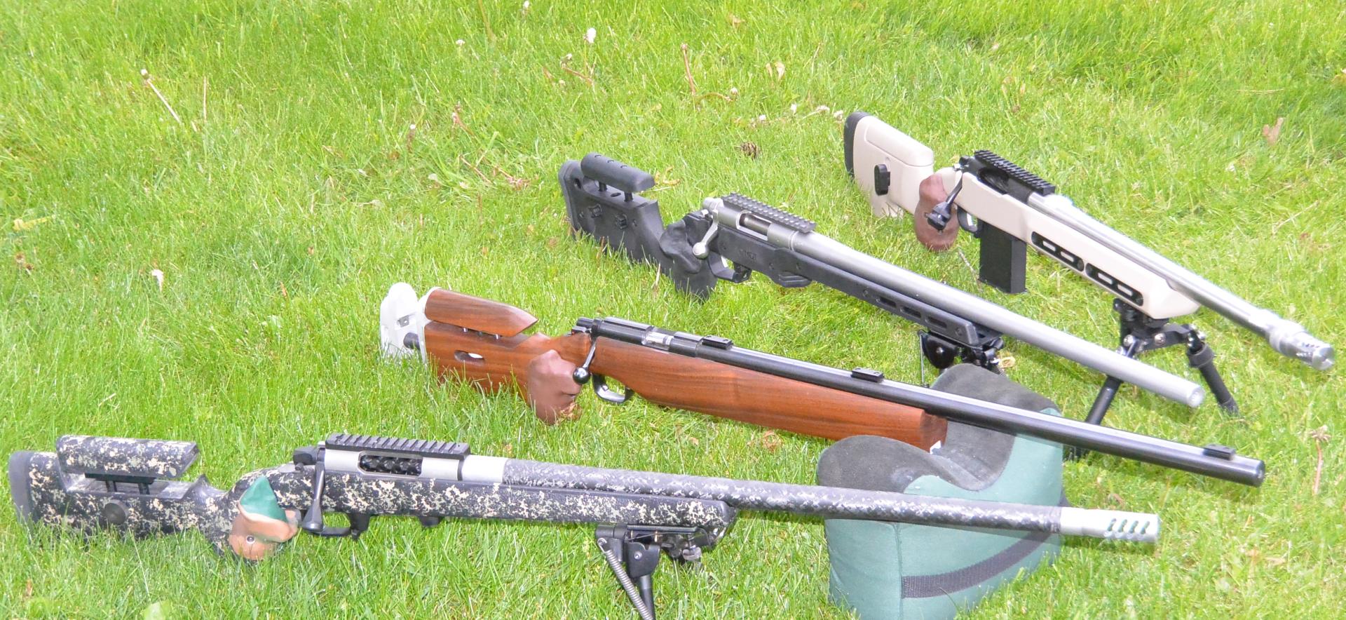

I posted the article on making grip build outs from polymer oven harden clay today. I think this is some of my best work. I hope you guys find it interesting.
Oven bake polymer clay grip build outs on four of my rifles

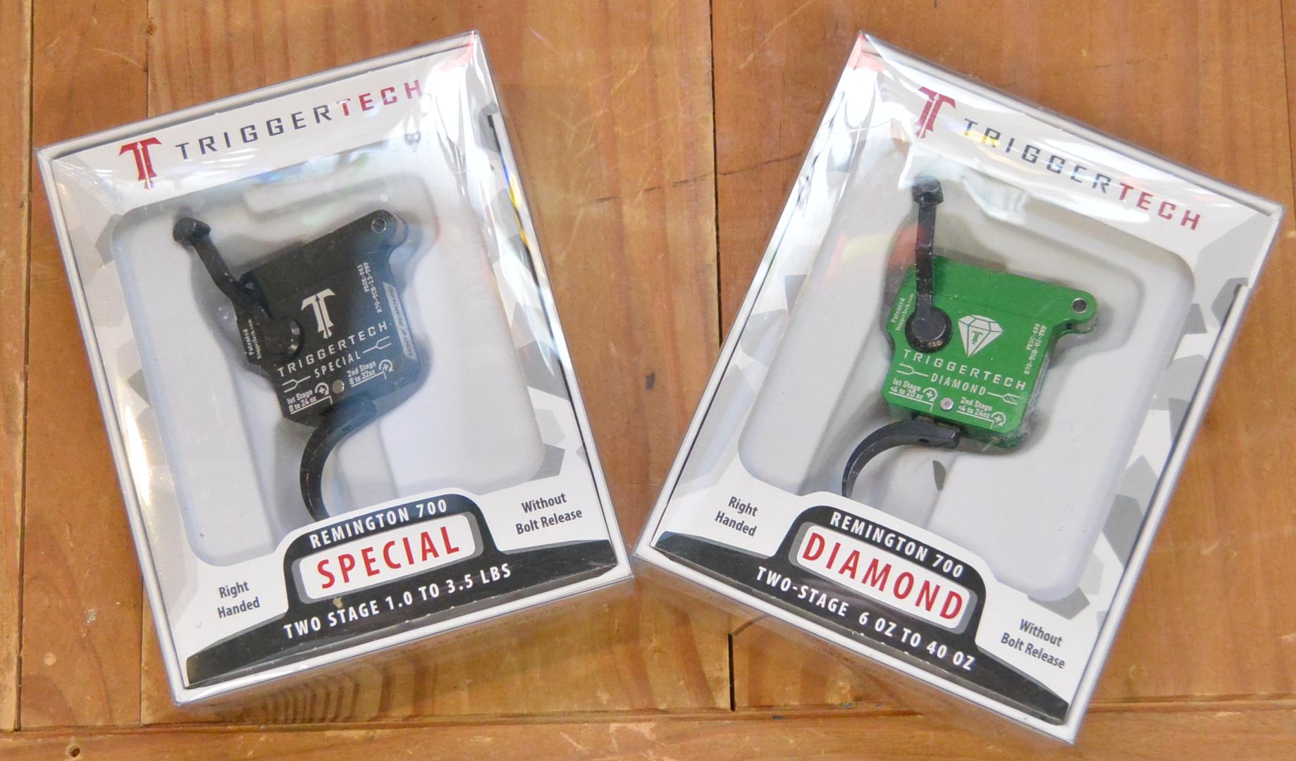

The TriggerTech 2-stages are here. Between them, the MDT XRS, and playing with the loads from the RCBS MatchMaster, it's going to be a fun post quarantine return to the range as soon as it stops raining here and I can catch up enough on work to run off for a day. Until then, it will be fun with dry fire time.
The TriggerTech 2-stage 700 platform triggers arrive

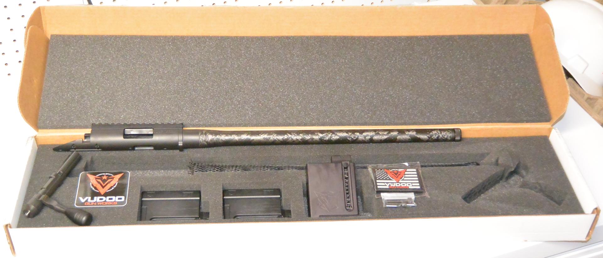

This is shaping up to be a big week. First off, the V-22 barreled action arrived yesterday for use both in the V-22 review and in some research I am doing on Proof carbon wrapped barrel harmonics. I have shot a few of these V-22's before but this is the first time I have had the opportunity to disassemble and really get a feel for how it all fits together. I'm quite impressed with the fit and finish as well as the tolerances. I have fit it in the MDT XRS with one of the new TriggerTech 2-stages and will have it out at the range in a couple days. I'm excited to see how it does.
Vudoo V-22 gen 3 with Proof wrapped barrel unboxing

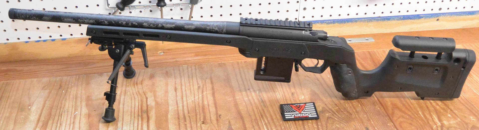

The V-22 all ready to go with the MDT XRS chassis and TriggerTech special 2-stage

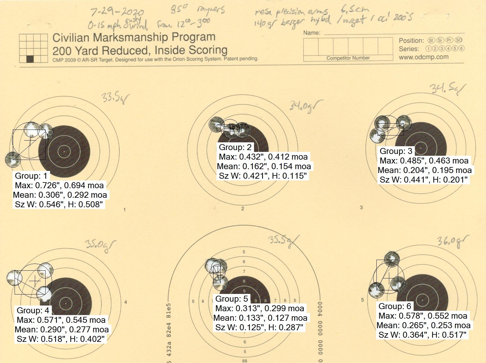

Lastly, I have an interesting test target here from the Proof barreled Mesa Precision Arms rifle. It is a charge weight variance load development target where only powder charge weight is varied. I think there is something pretty unusual about it compared to every other load development target I have done. Take a look at it and tell me what you think is unusual.
Proof barreled Mesa Precision Arms 6.5CM load development target.

Looks like the point of impact did not change through 2.5 grains of powder.
LRCampos.
No impact shift though 2.5 grains of powder and also not much variance in group size. If I hadn't labeled the target as a load development powder charge weight stepping target it would certainly have been thought to be an accuracy test target using all the same ammo. That is not what I have seen with other rifles / barrels in the past. However, it does fit nicely with my suspicions about the harmonics of Proof's carbon wrapped barrels.
- that the carbon wrap damps the harmonics?
That could be it. The wrapping might damp the harmonics in the way wrapping up a pitchfork damps it's sound. That is certainly a theory. It might also be more about how the carbon wrapped barrel vibrates than if it is having the vibrations damped. In removing steel and adding carbon, you get a barrel that is significantly lighter and tremendously stiffer. Both of these changes will result in a barrel that vibrates at a faster frequency and with lower amplitude. You would expect a faster frequency to mean it is harder to find an accuracy node as the node would be smaller. However, you would expect a lower amplitude to mean that being on a node should matter less as the barrel does not swing as far when it vibrates. Of course, all three of these things might be true (ie. less vibration from damping, higher frequency vibration, and lower amplitude vibration.)
In any case, I think it is quite possible that you cannot really tune a Proof barrel with a load or presumably with a tuner either because of a combination of their not being enough difference between being in or out of a node to notice and the nodes being too small to stay in anyway. In practice, this pretty much looks like the barrel is always in tune and this gives you a great deal of freedom in how you load as you are not restricted to particular accuracy nodes. This also gives you more choice when it comes to factory ammo as all of that will also be in tune. I should note that I have found even though powder charge doesn't seem to have much effect on accuracy with a Proof, seating depth does still matter and you can still have VLD's totally shit the bed for that reason.
O.K., so it seems that the carbon wrap may minimize a particular variable where the barrel harmonics are concerned. That's significant, if it can be born out by a number of examples.

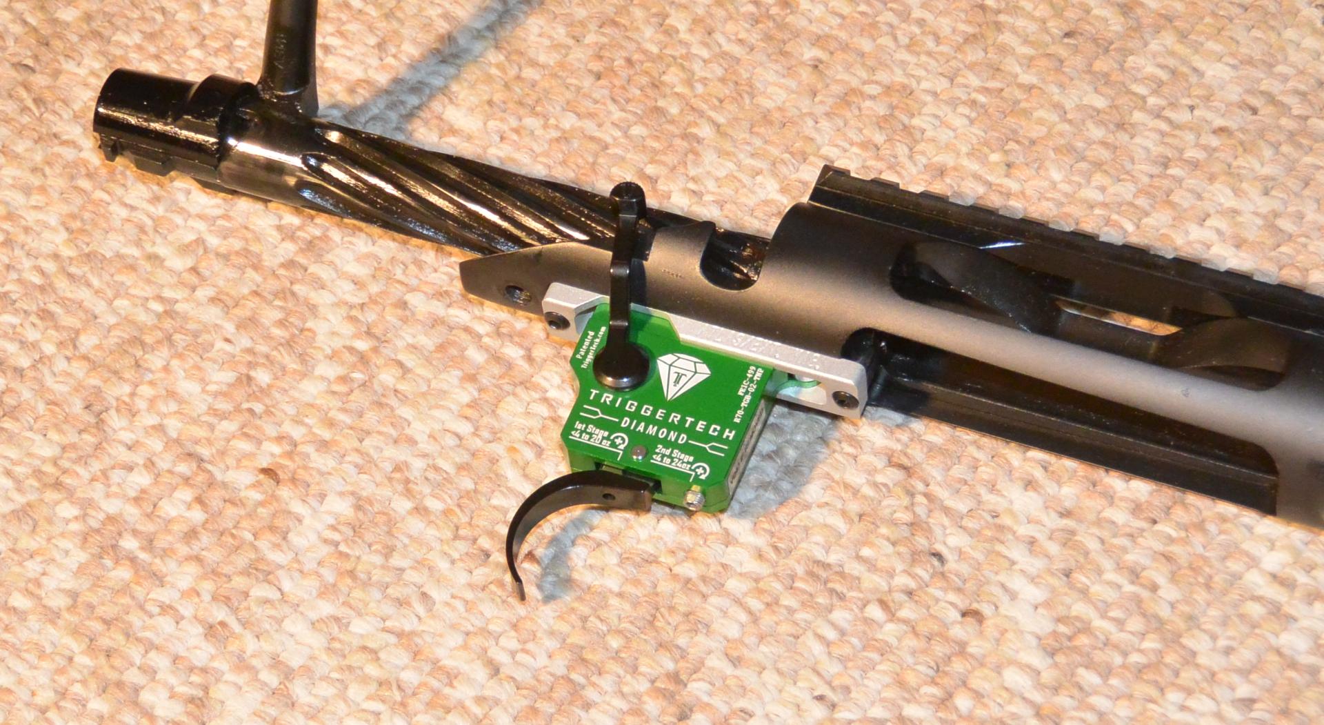

The TriggerTech 700 platform two-stage trigger review is up. Quite an interesting trigger. It is very significant departure from their single-stage in terms of design. As you might expect, it feels excellent. These triggers (Diamond and Special models) will be officially released this Friday (Aug 7th) making this perhaps the only well timed review I have ever done.

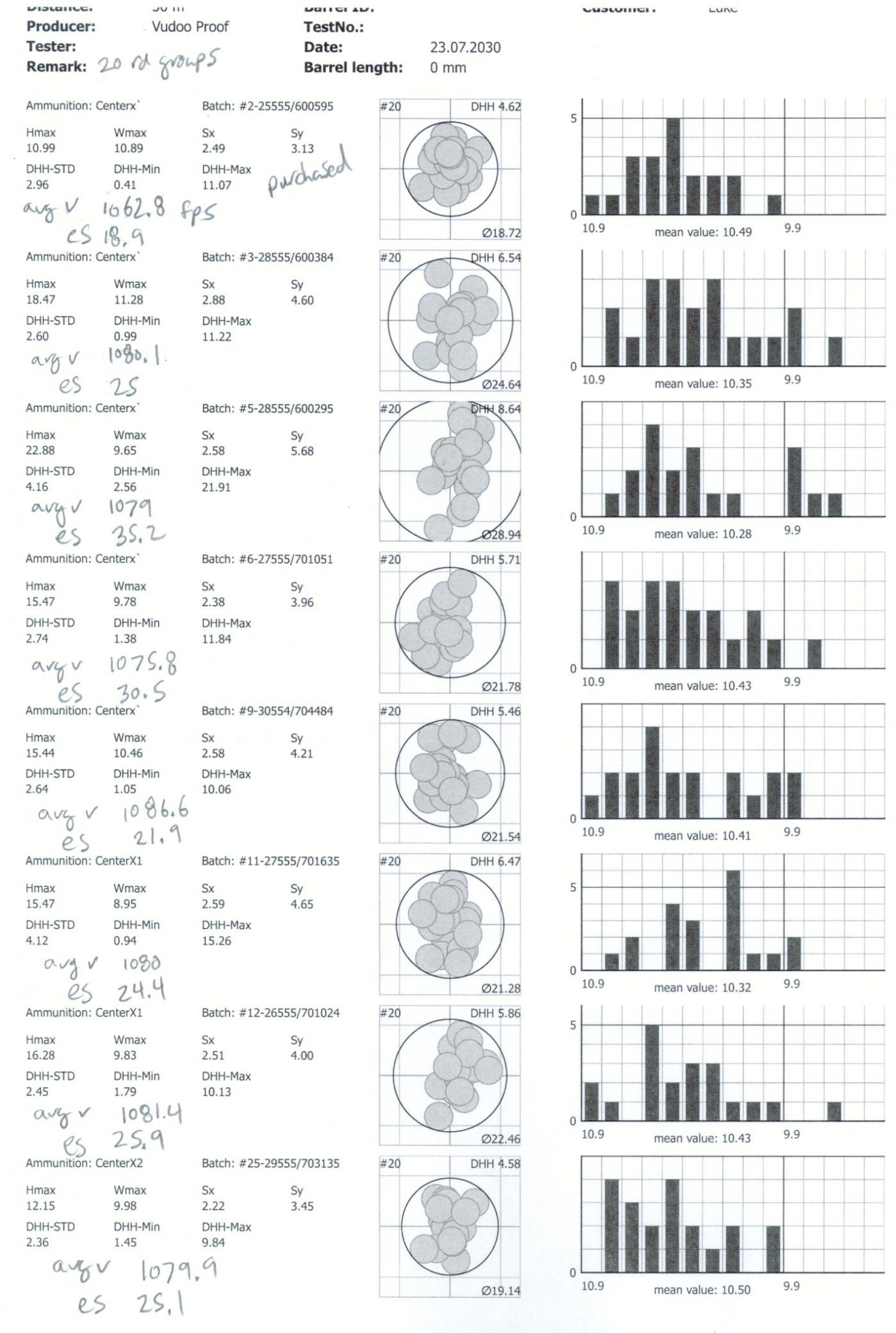

I've actually finished up the Zero Comp ZC 420 review as well as the Proof carbon fiber barrel's review and am just waiting for some of the front page content to age a bit before posting them. I will put the Zero Comp up this weekend or early next week. Come to think of it, I should probably put it in the drafts with a schedule to go live as I have a cousin's wedding I have to be in on the weekend to take up several full days of my time and I'm going to get crazy behind on work. Only thing worse then a wedding is a funeral.
Anyhow, the Vudoo V-22 review shares some data with the Proof review and I thought I would share a couple of test targets.

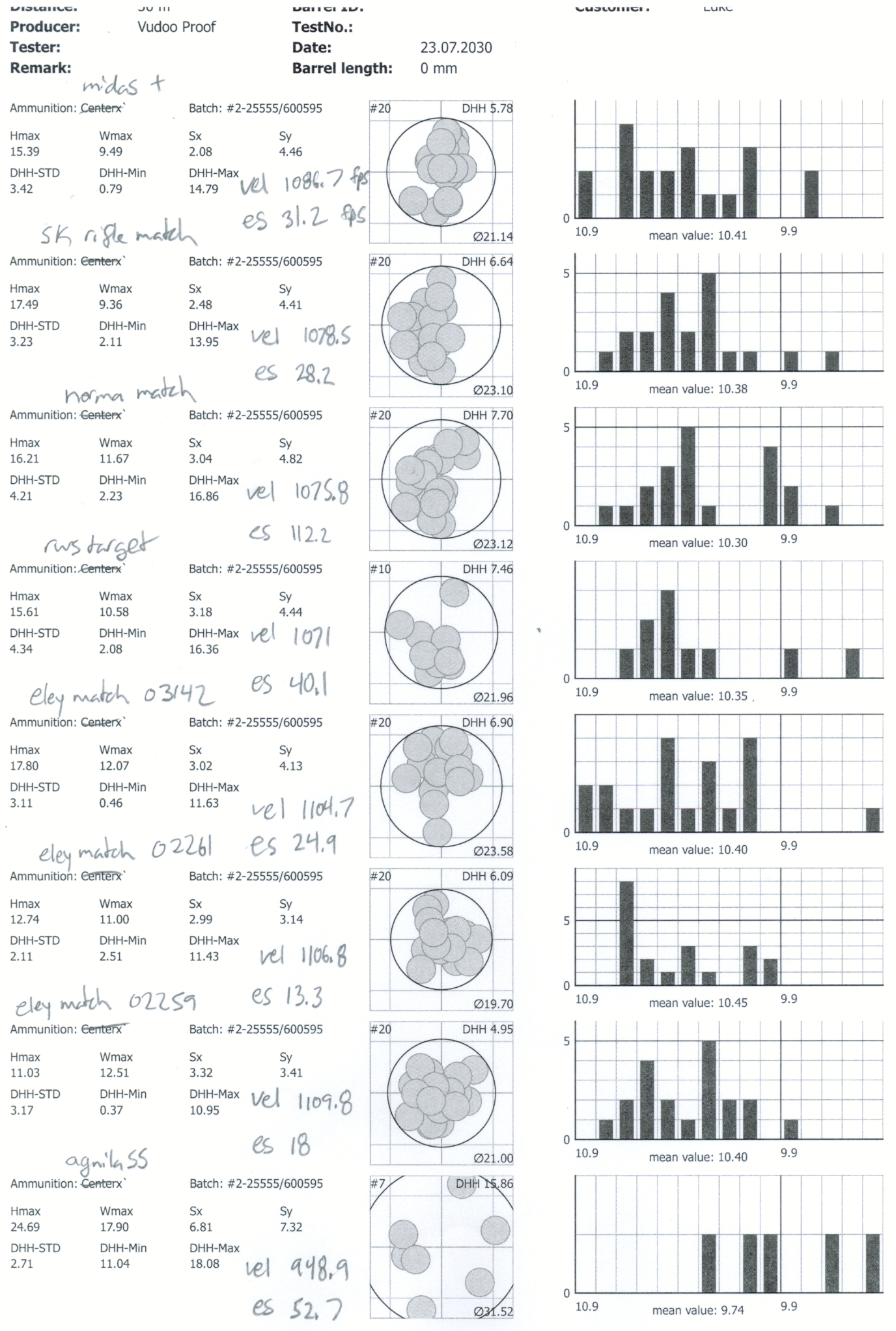

Proof barreled Vudoo V-22 Lapua Center-X lot testing target from the Lapua test facility
The 20 rd groups here are very helpful in getting the best DRMS (distance root mean square) numbers for shot dispersion. This is basically like a two dimensional standard deviation. DRMS is the diameter of a circle expected to fit the center point of 63% of all future shots in it. Eventually, it is this sort of measurement I will be talking about in the quantifying precision article. This will happen once I work with the software folks and get things were they need to be for most shooters to easily generate and work with measurements like this. For the best lot of ammo tested, the DRMS was 4mm or .16" @ 50 meters. Even with conventional analysis, that 20rd group translated to .52" @ 50 meters and that is meters and a circle holding the center of all shots not yards and the distance between the centers of the furthest two. Go to yards and only the furthest spread and you are way under .5" for all 20 rds. Proof has only been doing .22lr barrels for a short while now. I think this barrel may have been from the second run of full size 1.2" cylinder .22lr barrels. Looks to me like it is going well.
Proof barreled Vudoo V-22 assorted ammo lot testing target. Note: RWS target lot was 20yrs old, Midas, and Eley were 7years old. Some groups are 20 rds, others are 10.
I was curious how other stuff would do so I ran through a great deal of what I had in the match ammo box. For those wondering, no, aguila's 60gr stuff does not stabilize in a 1-16 twist. It also doesn't eject reliably from a Vudoo even if you had a 1-9 and the SD is too large to make any improvement is BC worth chasing it.
The Vudoo review is going to incorporate data from at least seven Vudoo V-22's chambered by them and probably an 8th. The best 10 rd group so far is .18" for a circle containing the center of all rounds @ 50M which is really absurd and all the rifles have been shooters. So far, these were all 1-16 twists but I may try to get one of the 1-9's in the review as well. It will depend on timing and how long the review has already grown with the pertinent information about the action design and such.

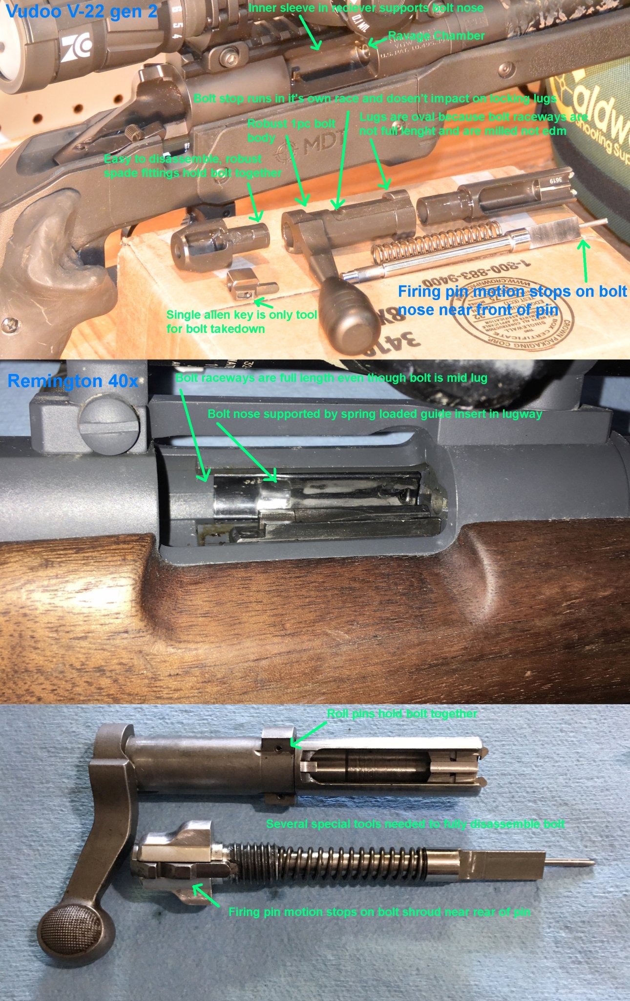

What does the gen 3 vudoo have over the gen 2?
So, Vudoo has made a bit of a mess when they named their generations. They have a gen 1, 1.2, 2, and 3. The 1, 1.2, and 2 all represent different bolts in the same repeater receiver. The gen 3 is a different, single shot, benchrest action.
Gen 1 uses an actual Remington 700 cocking piece at the back and disassembles like a Remington 700 with the funny little tool or shoelace to pull back the cocking piece and has a whole other special rig necessary to remove the firing pin spring if you want to do that as it is held under pressure with a roll pin.
Gen 1.2 replaces the 700 cocking piece with their own which is held in place with a setscrew and threads to the firing pin instead of attaching with a roll pin. It disassembles first with an altered 700 bolt tool but after that needs no special tool for getting to the firing pin spring as you can loosen the allen head set screw and unthread the cocking piece from the firing pin.
Gen 2 needs only the allen wrench to disassemble. You loosen that and then essentially just unthread the cocking piece from the firing pin. Once it comes apart the rest of the bolt sections are attached to each other with spade fittings and you just rotate and separate them. This design is both the easiest to totally disassemble and also can be held to higher tolerances.
Gen 3 is the different, single shot, action. It is 3-lug instead of 2 lug and has a single shot feed ramp where the opening for the magazine is on the repeater. Other than that, the design is similar to the Gen 2 except that it takes it's own, proprietary trigger. The trigger is similar in footprint to a 700 trigger and uses the same pins (why they kept the pin interface I do not know as I think it is a PITA) but features a 90 degree cocking peice interface instead of the angled one on a 700 trigger. A 90 degree interface both puts less force from the firing pin on the trigger and also does not result in the trigger putting upward pressure on the firing pin pushing it off it's axis. 90 degree cocking piece interfaces are superior though you then obviously do not have the choice of all the 700 triggers for the gen 3 but rather will use the one it comes with.
Reactions: sleeplz
I forgot to mention that the gen 1 and 1.2 have a side bolt stop that interfaces with the left locking lug as is common in custom center fire actions. 2 and 3 have a bolt stop that is offset above the lug and interfaces with a channel on the bolt.
I also understand that gen 1 bolts can be upgraded to gen 1.2 without much fuss if the owner is so inclined. I don't remember the cost associated.

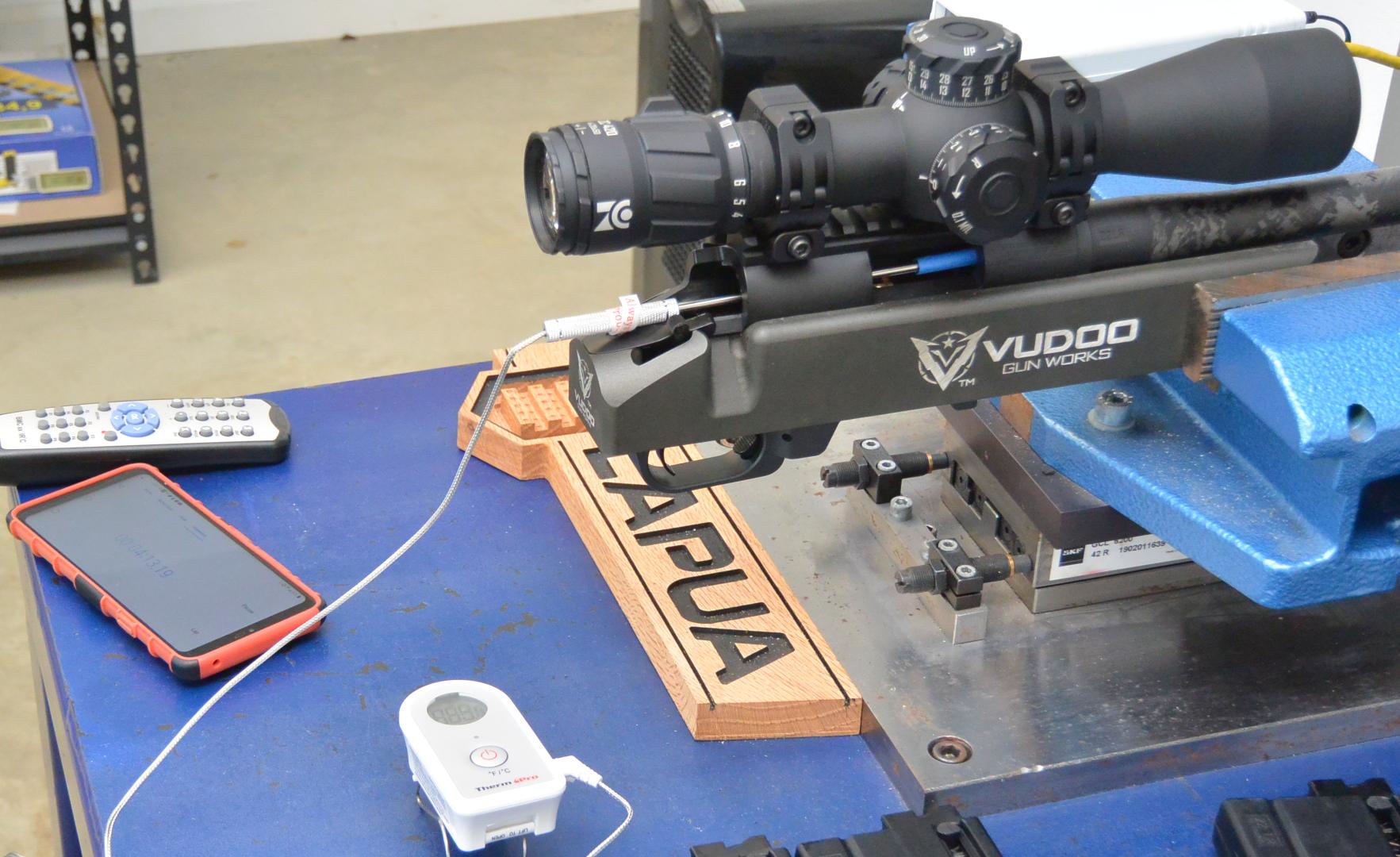

The Proof carbon rifle barrels review is up. This review analyzes the behavior of both a Proof carbon barrel in 6.5CM and one in .22lr in order to understand how Proof's carbon wrapped barrels differ from conventional steel barrels with respect to harmonics and cooling. Of course it also talks about the weight advantages and how the barrels shoot in general.
Testing the Cooling Rate of the Proof Carbon Fiber Barreled Vudoo V-22 at the Lapua Test Center

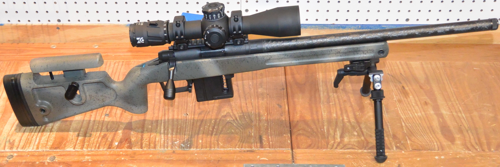

The Grayboe Phoenix lightweight stock and Grayboe's bottom metal arrived Friday. This weights in at 32.3 oz without bottom metal but with the larger, heavier, tool-less cheek adjust knob and 36.2 oz with bottom metal. It should be an interesting stock to take a look at especially since I have it's bigger brother Ridgeback on hand as well as a competitor in the McMillan Game Warden.
Grayboe Phoenix Unboxing (may be purchased with or without bottom metal and M-LOK pic rail section)

The Vudoo Gun Works V-22 review is finished and posted. A lot of folks were instrumental in helping this review come to pass. In addition to the folks at Vudoo, Lapua, and Proof quite a few members of SnipersHide helped me with photos of their Vudoos or 40x's or provided me with their lot testing data print outs. Thank you all for your part in making this a better article.
In all likelihood, this will be the last 2020 review as I expect the Grayboe Phoenix one will probably land in 2021. At that point I will make up a new blog thread for 2021 that will include that stock, the Minox 5-25x56 LR and some of it's competitors, the quantifying precision article that did not get finished this year, and maybe a piece on 700's in general that I have been mulling over.
Image illustrating the key engineering differences between a Vudoo V-22 and a Remington 40x action.
