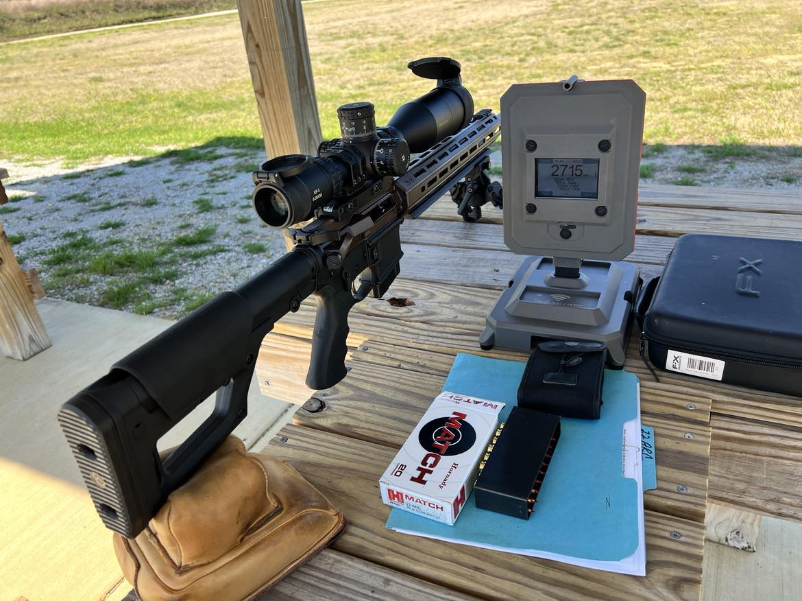

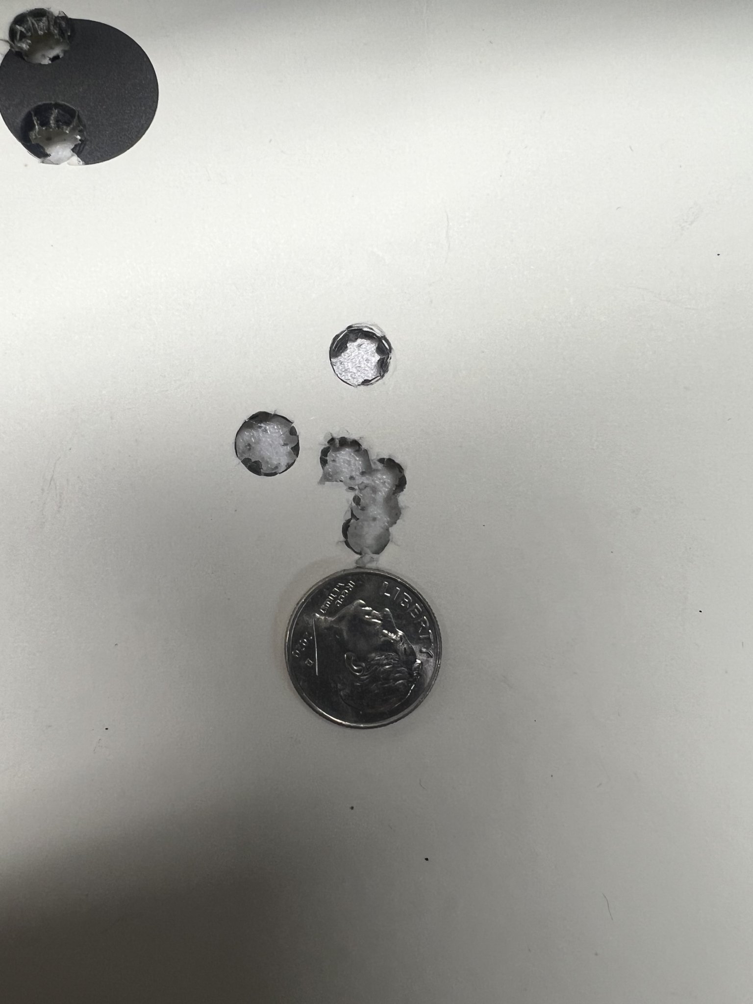

Picked up my Ruger American Gen II 22ARC last week. Vortex DB Tactical 4-16x44 FFP
At 110yds, groups were .7 (88 grain) and .4 (62 grain) Temp 100F @ 4000 fasl, humidity 19%
Will try again next week; I'll load 75 ELD-M this week to test now that I have a few cases.
20" bbl so probably lost 150-200fps(?) over the 24" Hornady uses to test.
Factory 88 ELD-M
Data from Garmin Xero
Factory 62 ELD-VT
Reactions: Farmerbrown32
Factory 88 ELD-M
Factory 62 ELD-VT
You will probably pick up a few FPS after a few rounds through it. My 20" gas gun picked up an avg 75 fps after 150 rounds through it.
