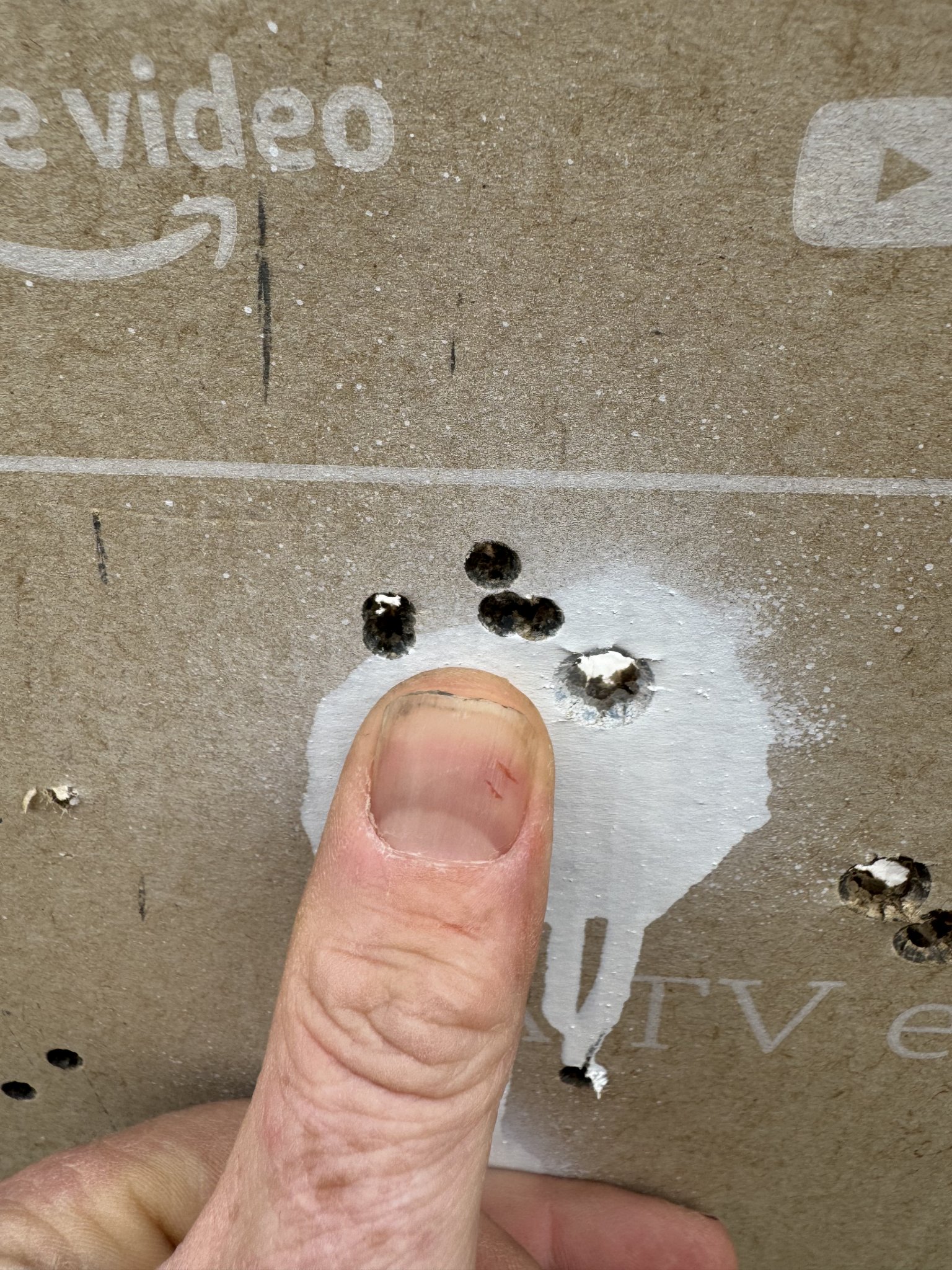

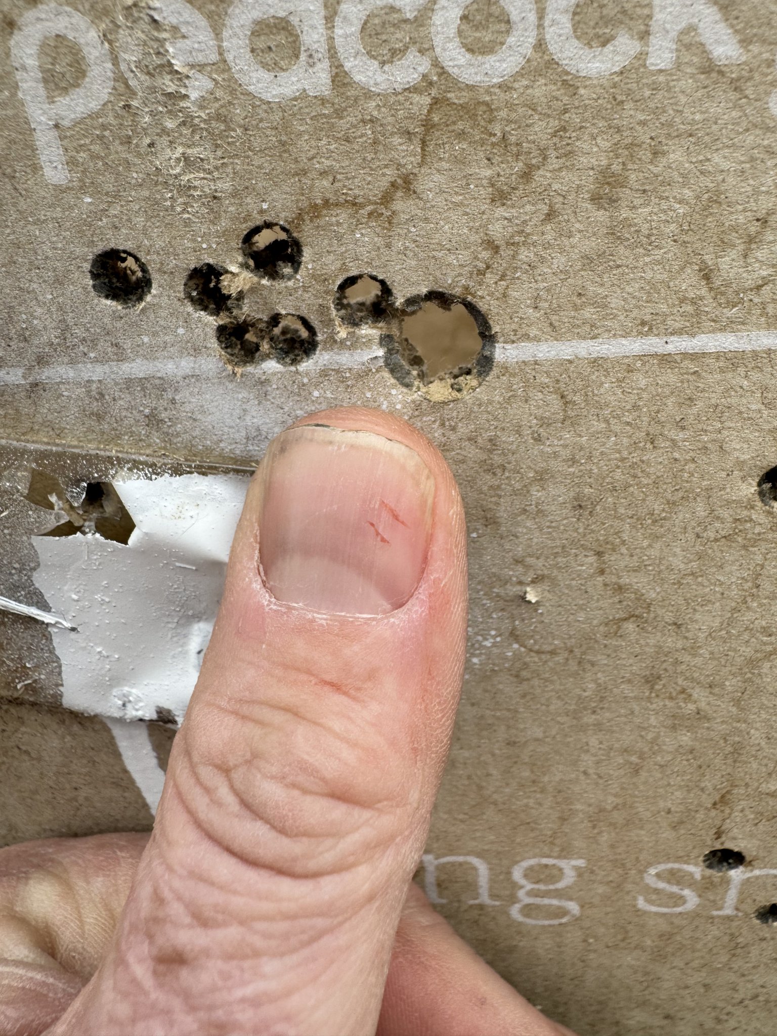

Man this lil satern 22arc barrel hammers. Extremely happy with it. 80eldm and the 53vmax shoot sub half inch 5 shot groups.even In this 20-30 mph wind today!

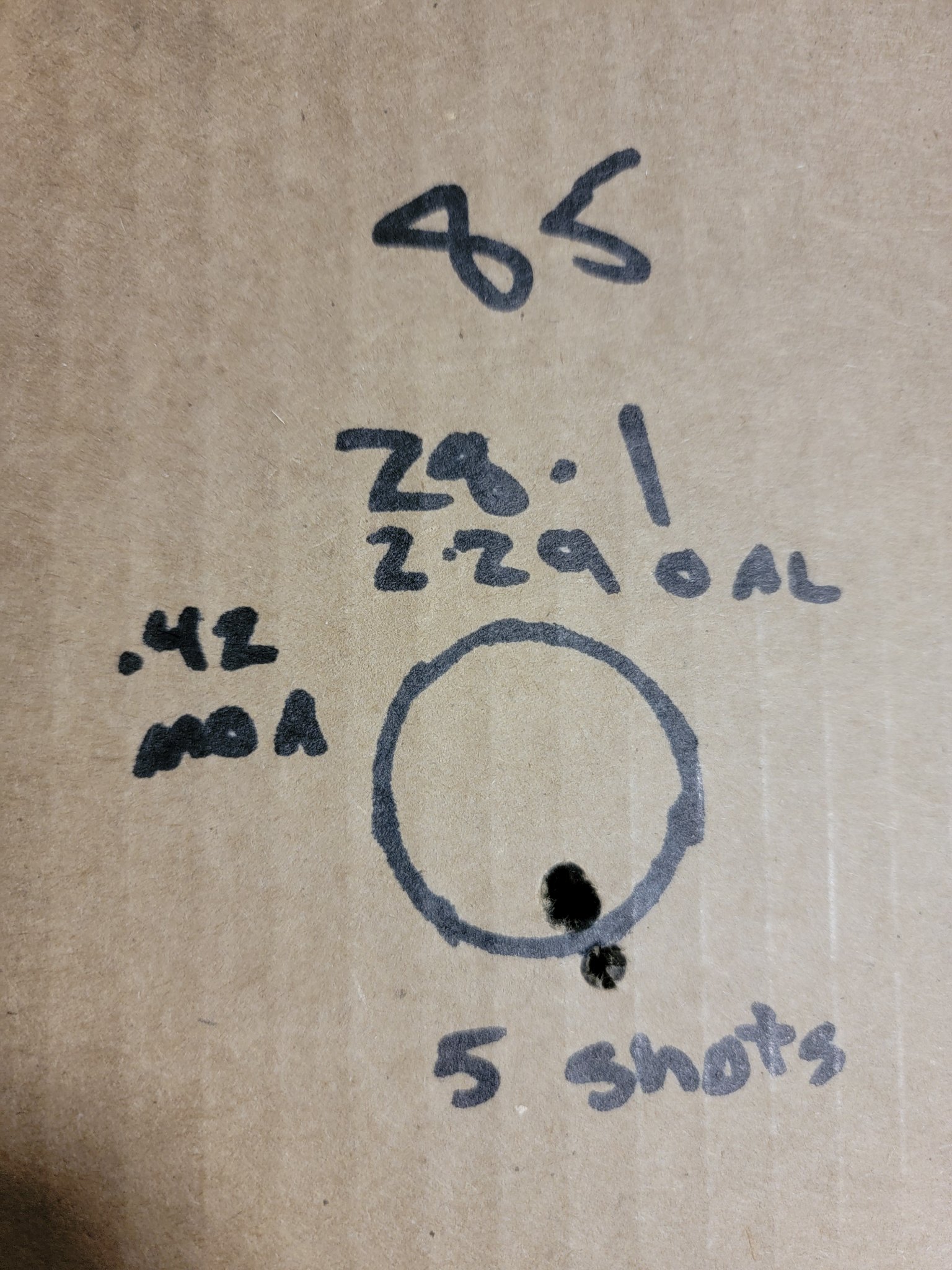

No luck today. I loaded the 75's at 2.250" and shot some 1 - 1.8" groups. Definitely got the velocity I wanted but accuracy lacked. I will try some more seating depths but as of now TAC doesn't look promising. Which is a shame bc I like that powder and have a lot of it. I might try Varget, 6.5 StaBall, or N150 next.
Try the 75 eldm @ 2.30 OAL. Mine didn't tighten up until I got down to 556 velocities. 🤷‍♂️

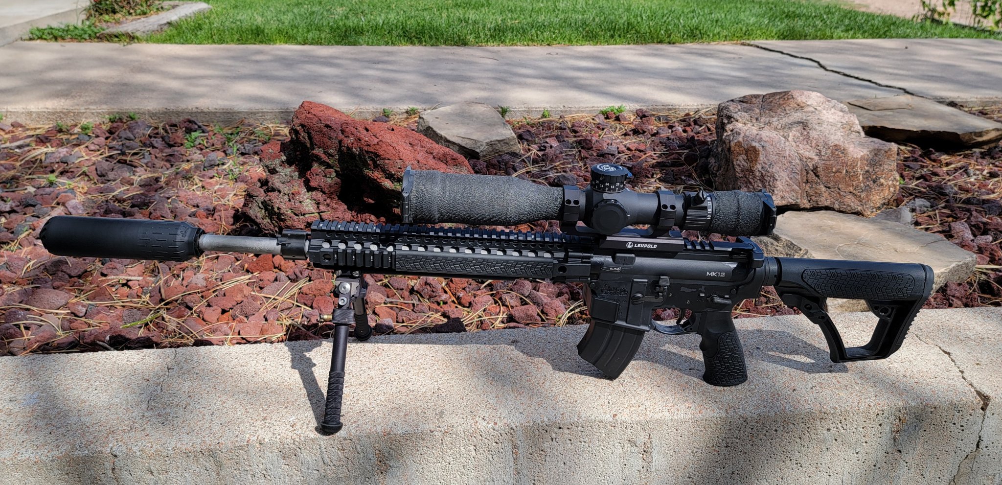

What velocities are you getting? I really want to do another MK12 but in 22 ARC. Even gave thought to just swapping barrel and bolt on my MK12.
How long is your barrel? And have you tried any other powders with that 85.5?
18" craddock RTR
Yes tried RL16, Staball Match, Staball 6.5, TAC, cfe223, n540....
Only rl16 was close on es/SD. I'm fine with the velo. My main issue is the chamber is wholly shit long. Have to create a false shoulder of 12k on new brass. Kinda a pain in the ass, but works ok.
