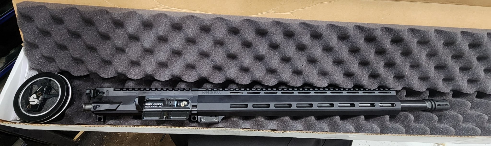

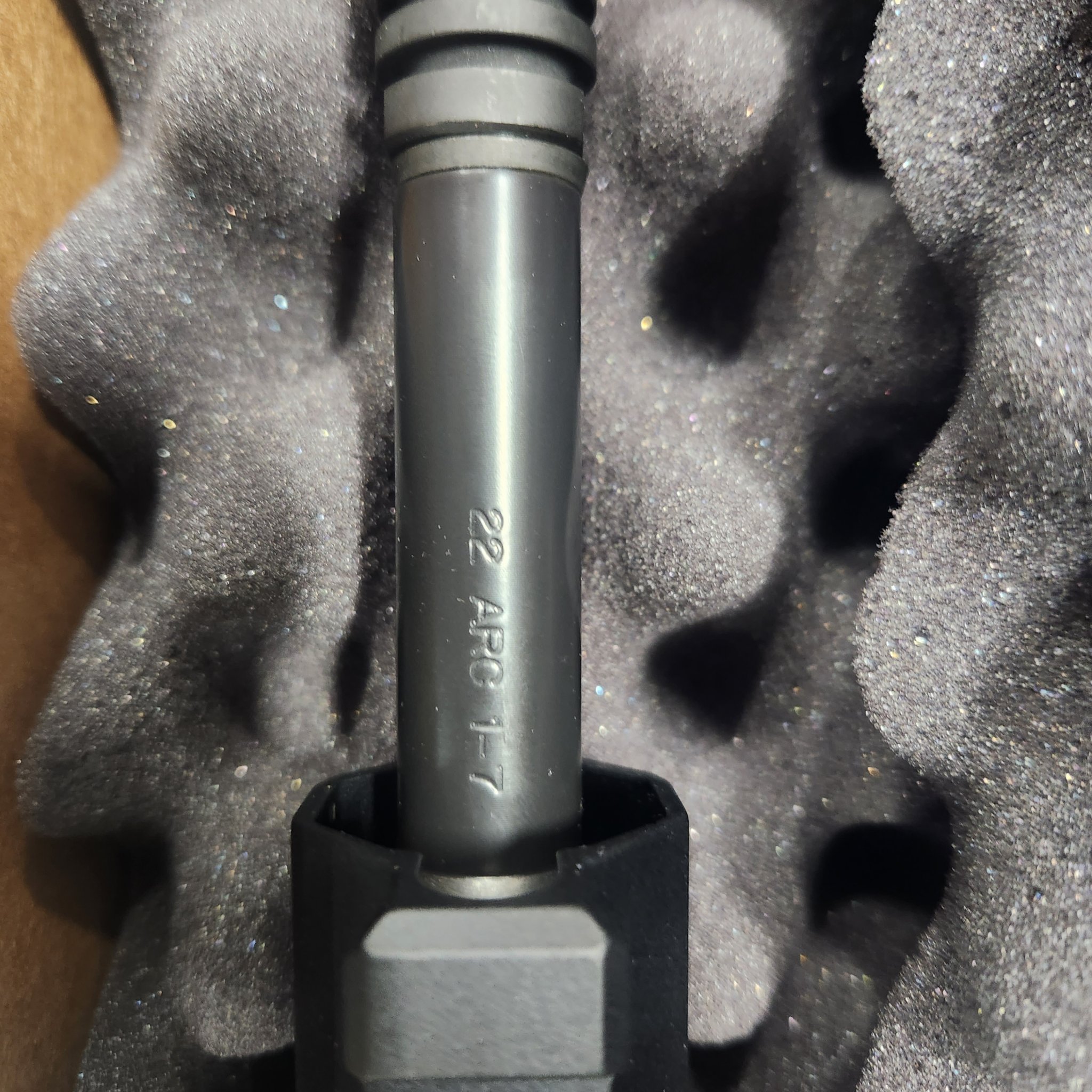

18" Uintah precision upper came today.

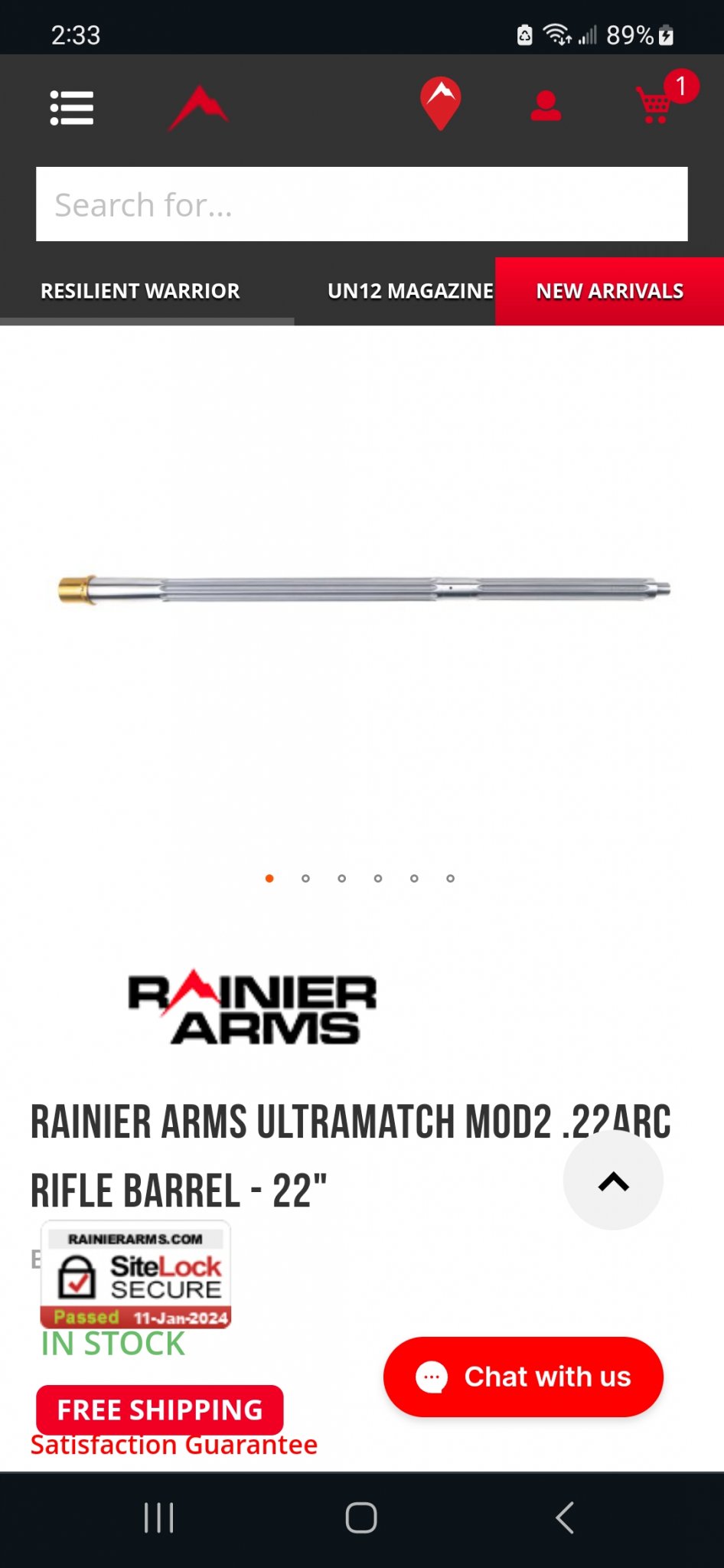

I just spoke with Rainier Arms. They have 22" 22ARC barrels in stock and will have 18" non-fluted barrels coming in stock in a few weeks. Both are Ultramatch series. I don't know of anyone else with them in stock; Uintah Precision has them but $1k+ is a lot of money for a standard upper build.
Reactions: Bevo
I just checked Rainier's website, they haven't added any .22 ARC items to the site yet, looks like you'll have to pick up the phone at the moment.
The 22arc barrel on Rainier's site could only be found by googling it. I talked with them and they're aware, they said they're working through some website fixes right now.

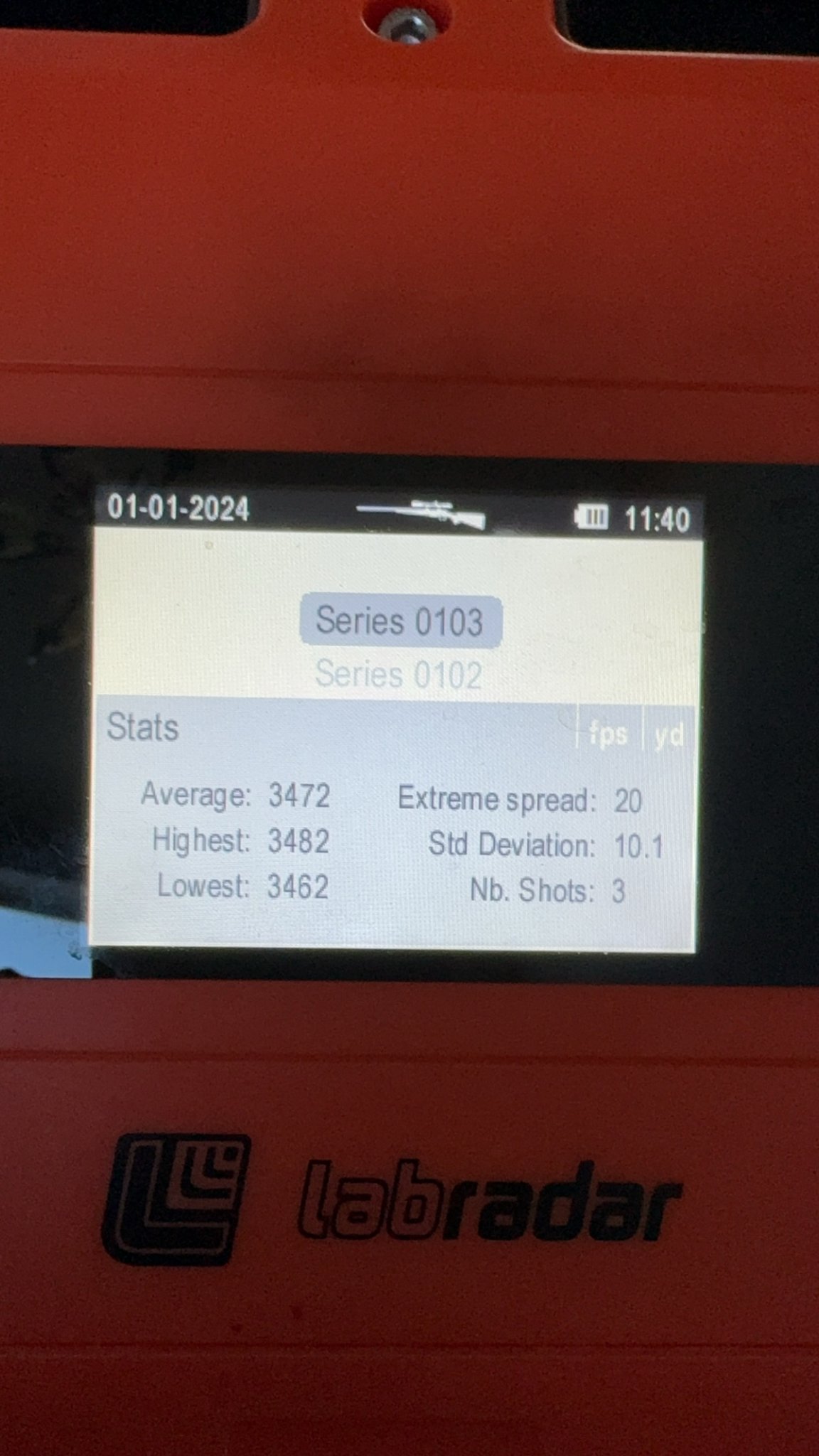

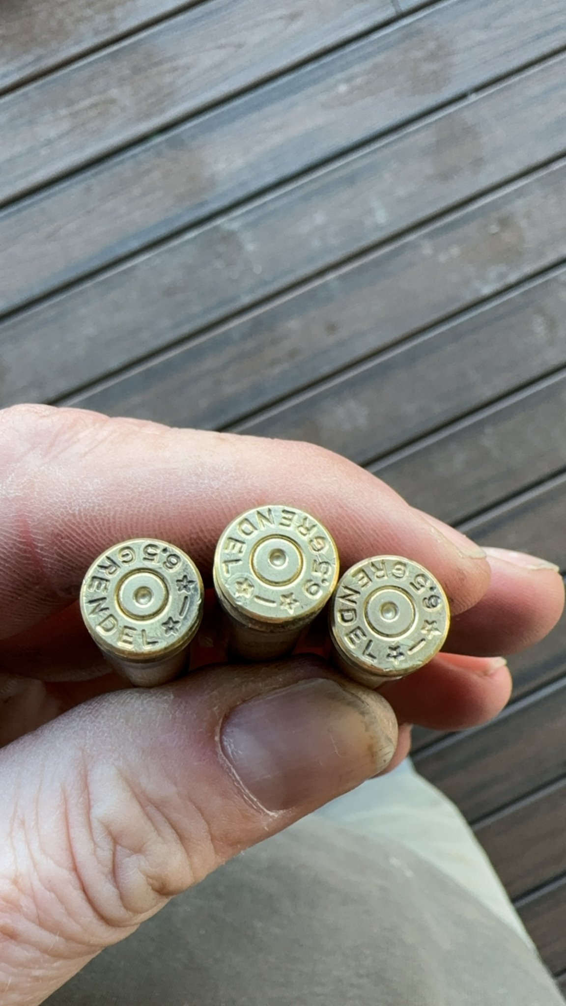

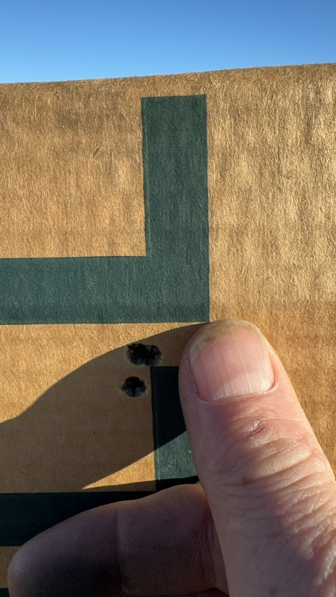

Well its -20 outside with a 30 mph wind so i aint shootin any groups now. But a kind gentlemen sent me 20 62eldvt bullets and i got then to 3300 fps with cfe 223 powder and there is more speed potential left. Also shooting the 53 vmax at 3470 fps with great accuracy.

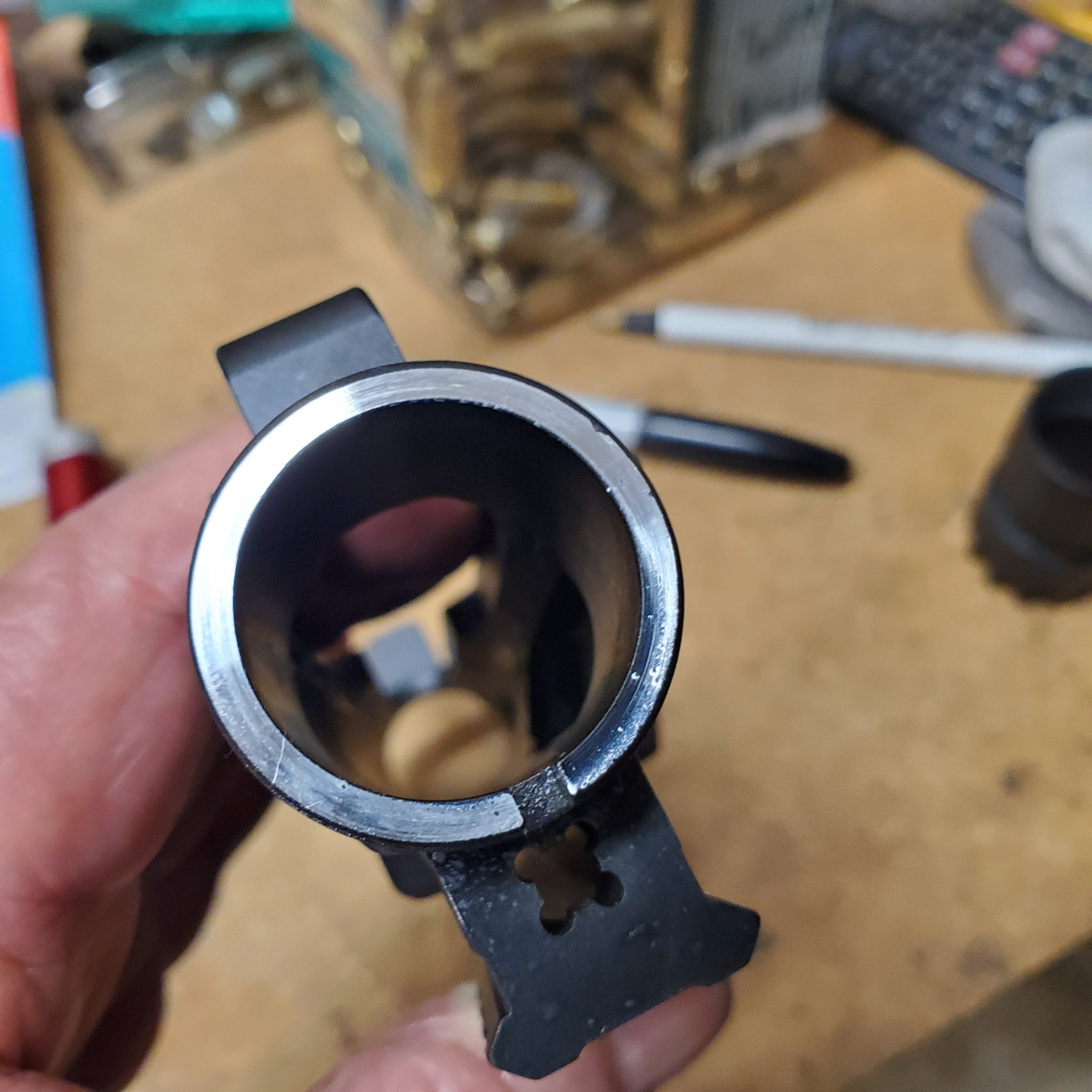

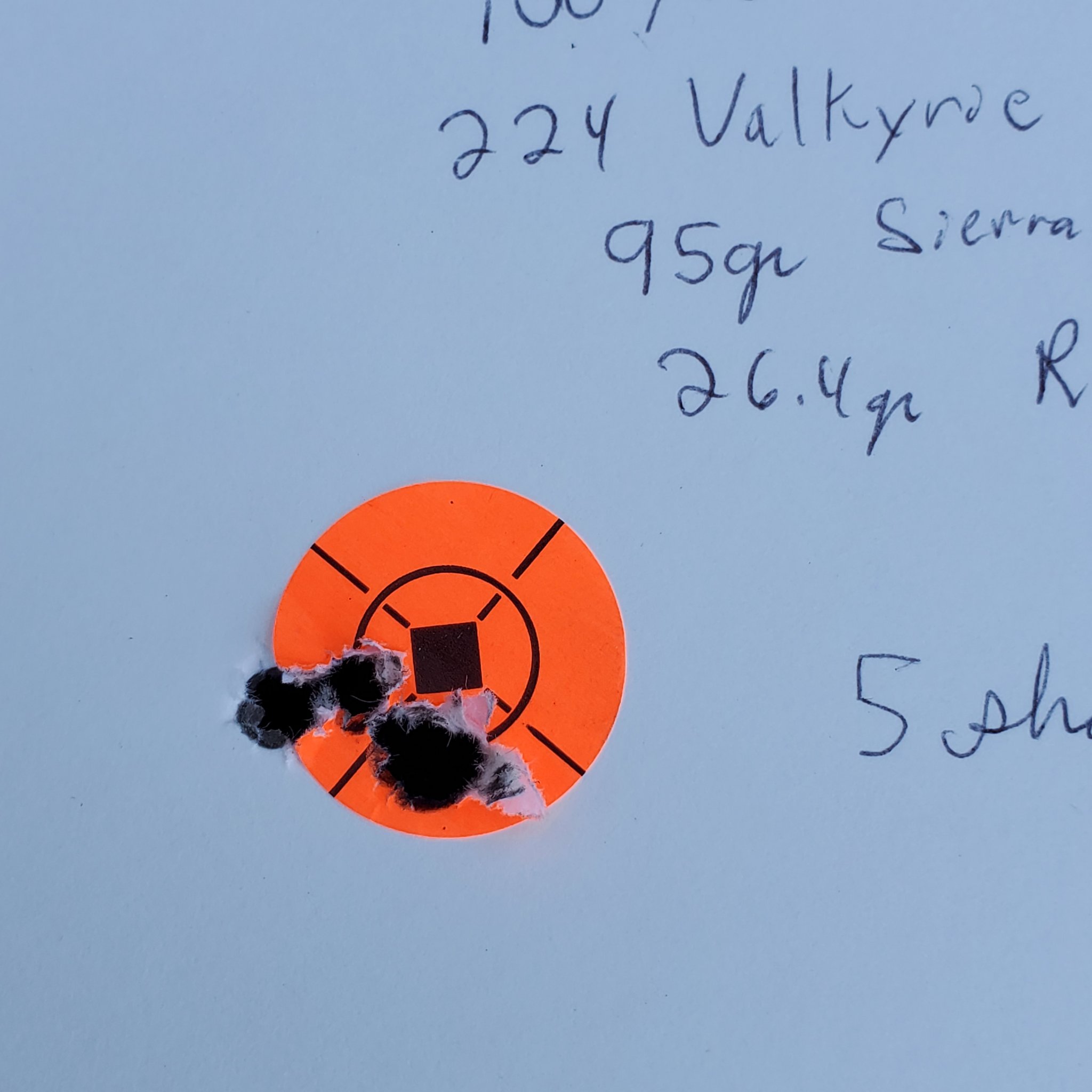

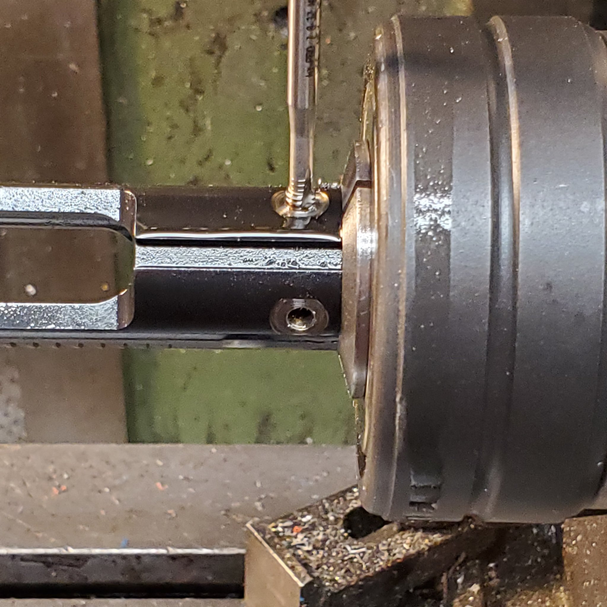

Don't mean to dog the 224 Valkyrie, but it was one of the most difficult bottle neck cartridges to get an AR 15 to shoot 5 shots into less than a half inch at 100 yds.
Got a new 6.5 twist barrel for 95 gr SMK, still not up to tbe accuracy task. Tear it down and investigate, the Areo Precision wasn't quite precise..Machine it. Still not getting there... center the bolt carrier in the bore...that did it!
This poceedure usually only makes a small difference...not with the 224 Valkyrie.
So the 22 ARC would have to exceed this performance with 95 gr SMK before I'd be interested.
The 22 ARC should be an accurate cartridge, it's almost identical to the old benchrest 22PPC.
Most all AR 15s can be made accurate, including the difficult 224 Valkyrie...that's my experience with it. It can shoot small 5 shot groups at 100 yds when properly set up. But so can the 22 ARC, is my guess, maybe easier, depending on the components and quality of assembly.
