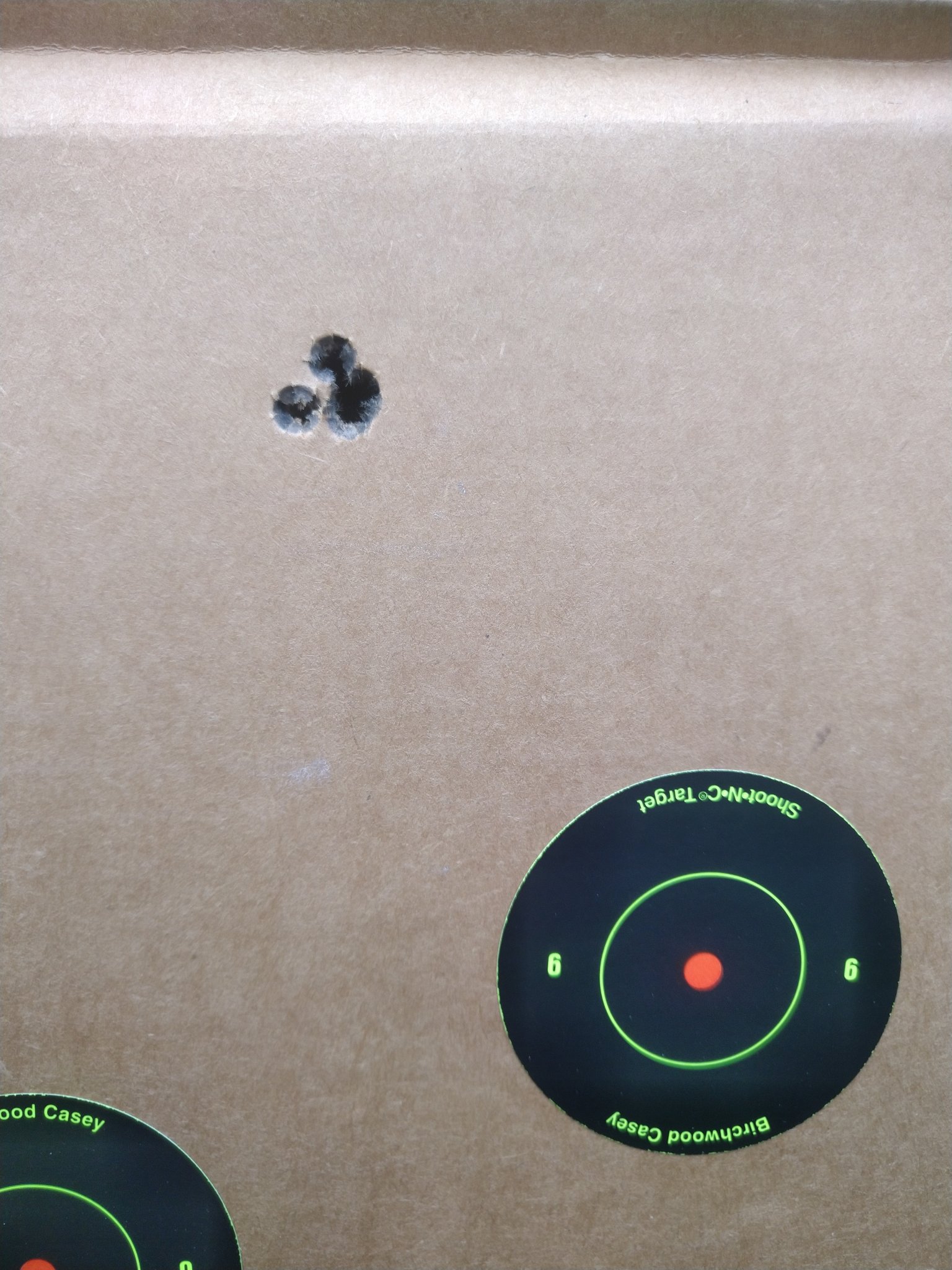

Clipped the top of the back of this one 254 yards 22br 85.5s 3030 fps and the wife shot the other one with a 223ai 85.5s 2900fps 117 yards. Carnage and amazing performance.

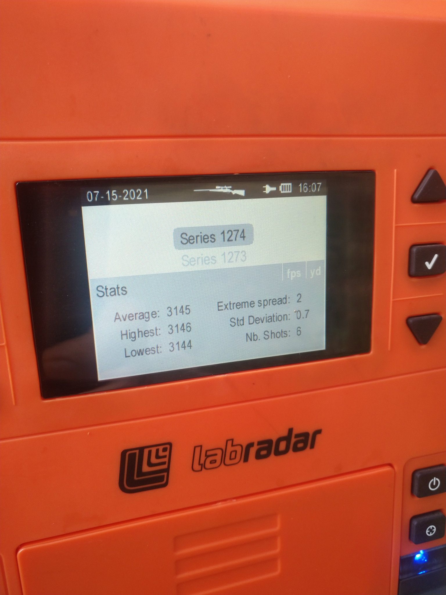

Any info on 95 SMKs? I'm trying to find the right cartridge to launch the 95s at 3000+ comfortably. Something smaller than Creemoor preferably so I can still use Varget/Precision/etc or similar burn rate powders.
i built a 22 brx and had a custom reamer spun up. 95s at 3150 in a 28" tube..... it was freaking amazing. going to do another with a shorter throat for the 75 elds on a 16" barrel for killing dogs

I run that neck size as well on my Manson reamer. And I do have to say, that .180 freebore treated me pretty good.
It took a smidge more powder. The two barrels prior were solid at 28.5grs. I loaded the longer freebore load at 29grs. But it shot great all the way through. And was still shooting great when I pulled it at 2500 rounds. I honestly would have left it on but had a big match to go to. It was still shooting plenty good for local stuff.
I would have loved to give the 95gr SMK a go, but it was fairly high pressure even down at 2850fps. Its just too long and creates too much pressure...
The 95gr smk must be very barrel dependent. I ran a quick pressure test on it the other day and I hit mild pressure at 30.5 grs of Varget going 3016fps. The barrel is a 28" Krieger 7 twist only has 25ish rounds on it. I hit pressure much earlier on my 28" Mueller 7 twist. I think it was low 2900s
