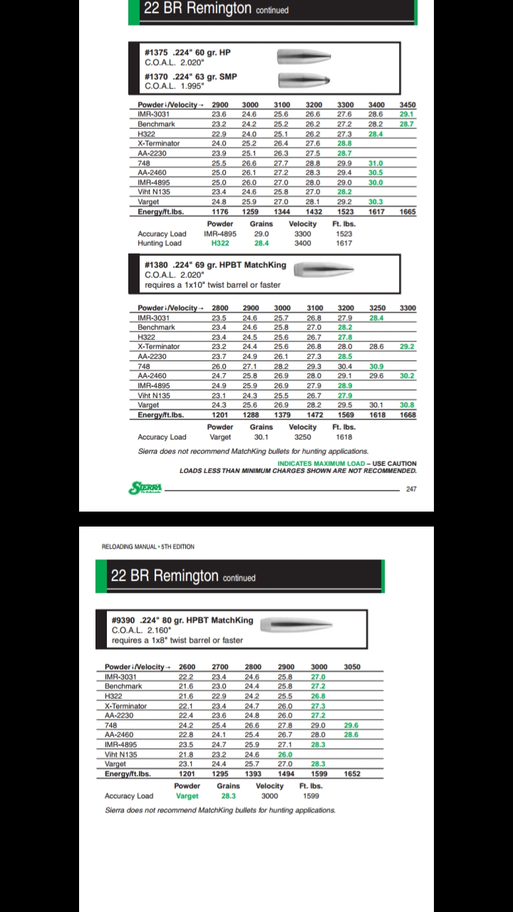

Sierra data has some data with heavier bullets.

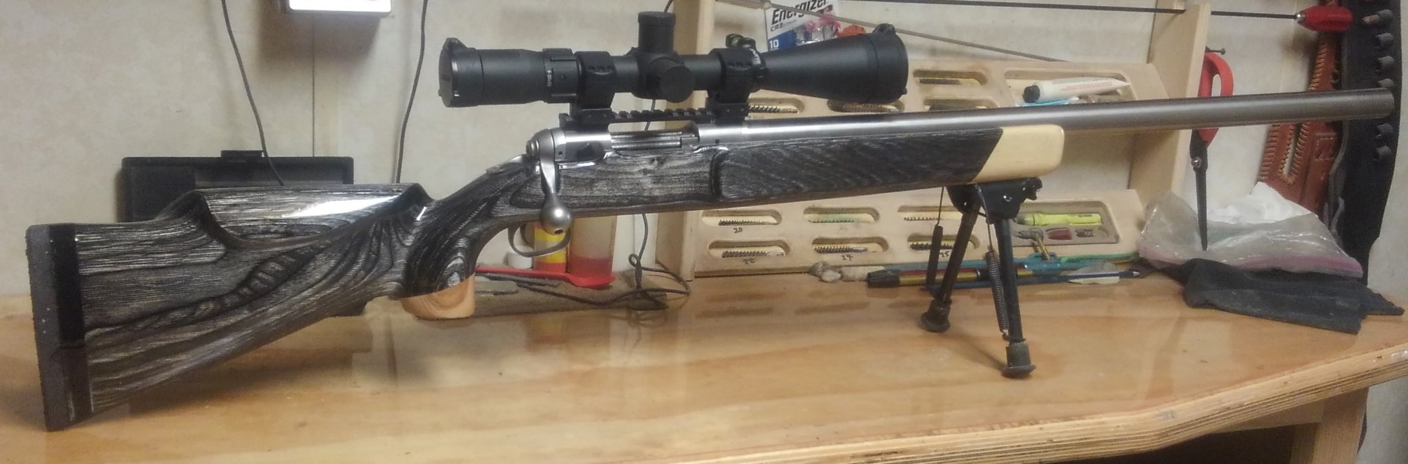

Running through my 3rd 22br now I think I’ve done more testing in this caliber than anything else I’ve shot, still trying to dial in the reamer specs right but I’m starting to fall in love with it as a shorter range prs caliber and a coyote slayer. I’ve been playing with 90 gr atips and 85.5 Bergers both are nasty on yotes and both shoot excellent. My reamer is a .256 neck with .100 fb I’ve also shot a .252 .085fb think I’ll order another at .255 with a .100 fb just to see if it seems more accurate with out the function issues of a tight neck. The .256 functions flawlessly.

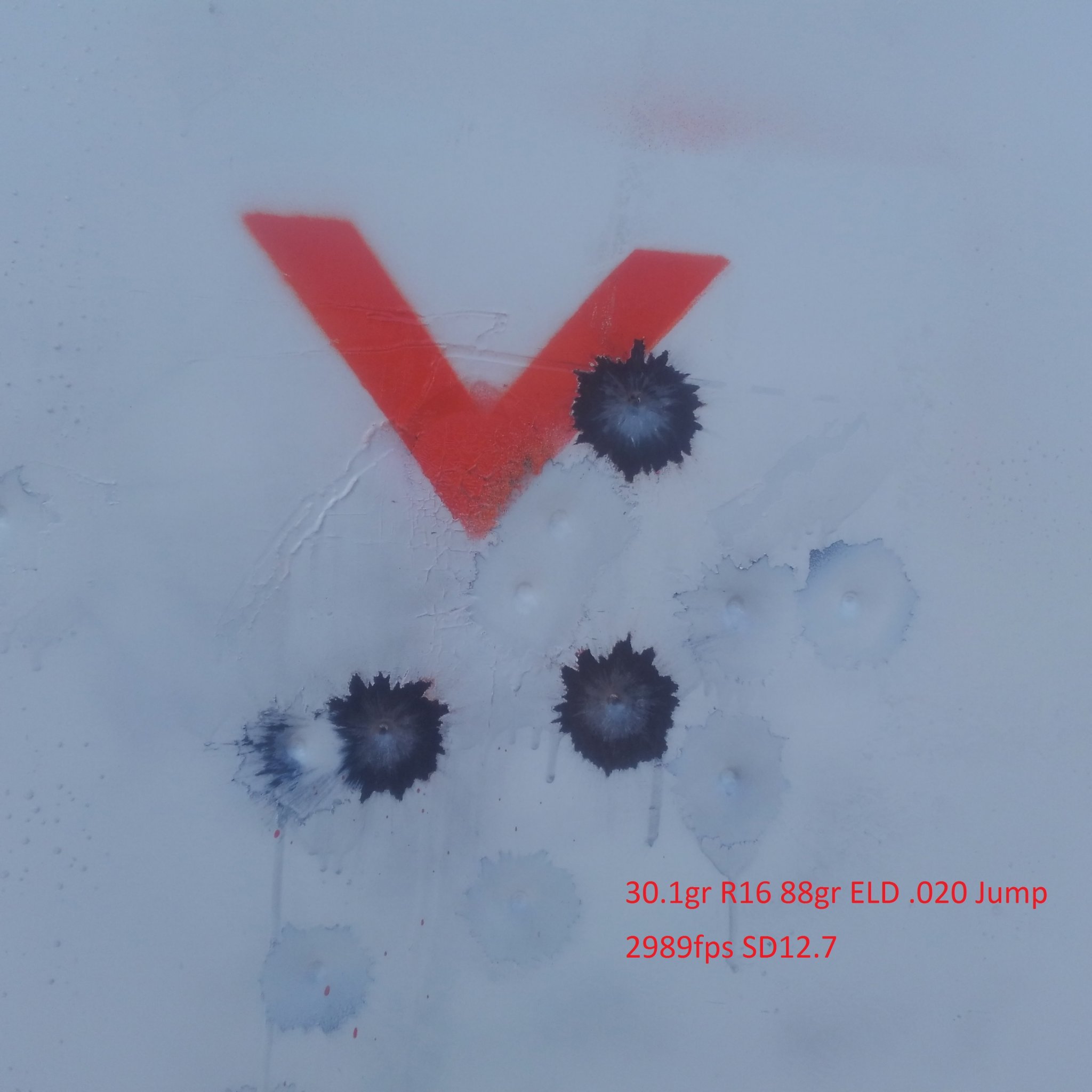

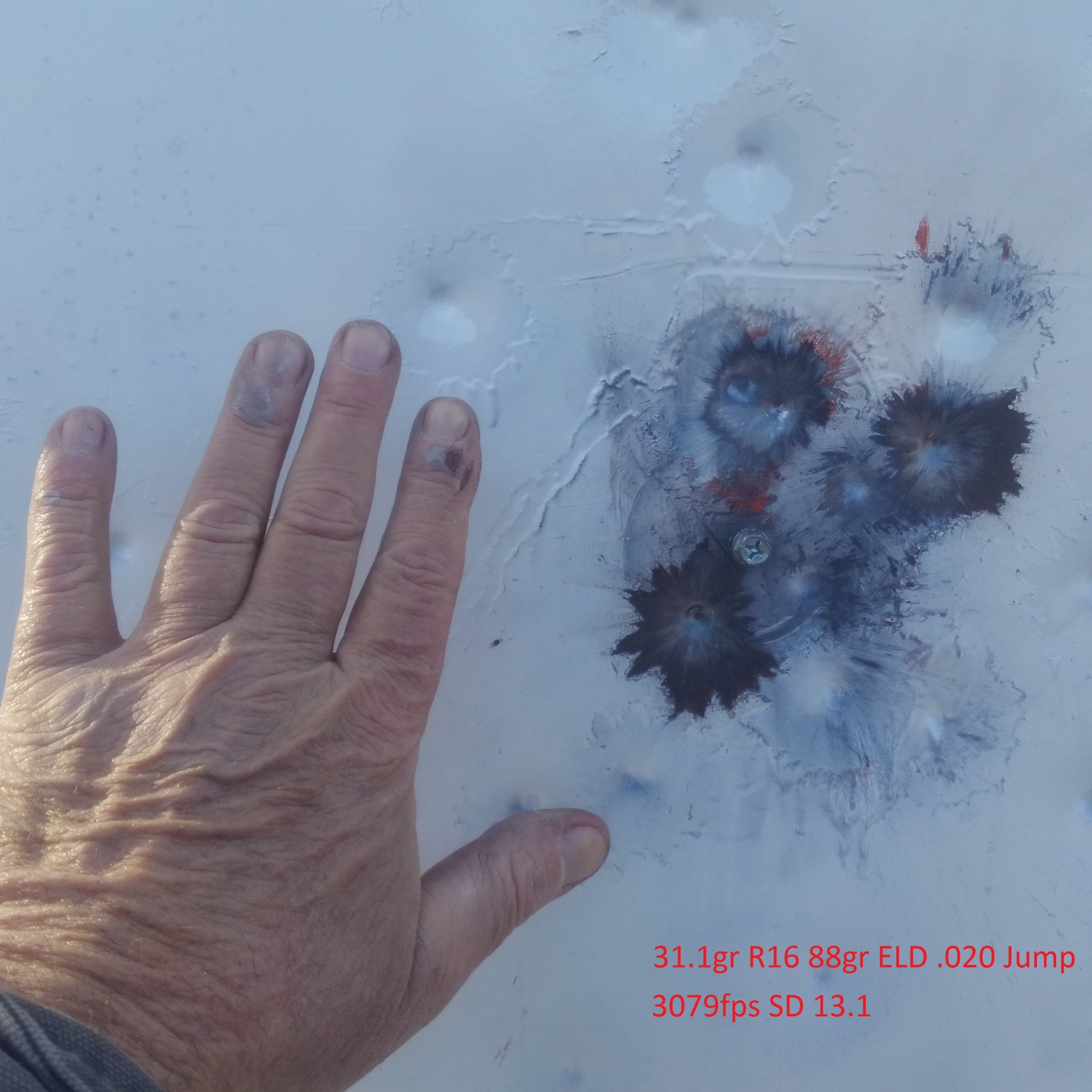

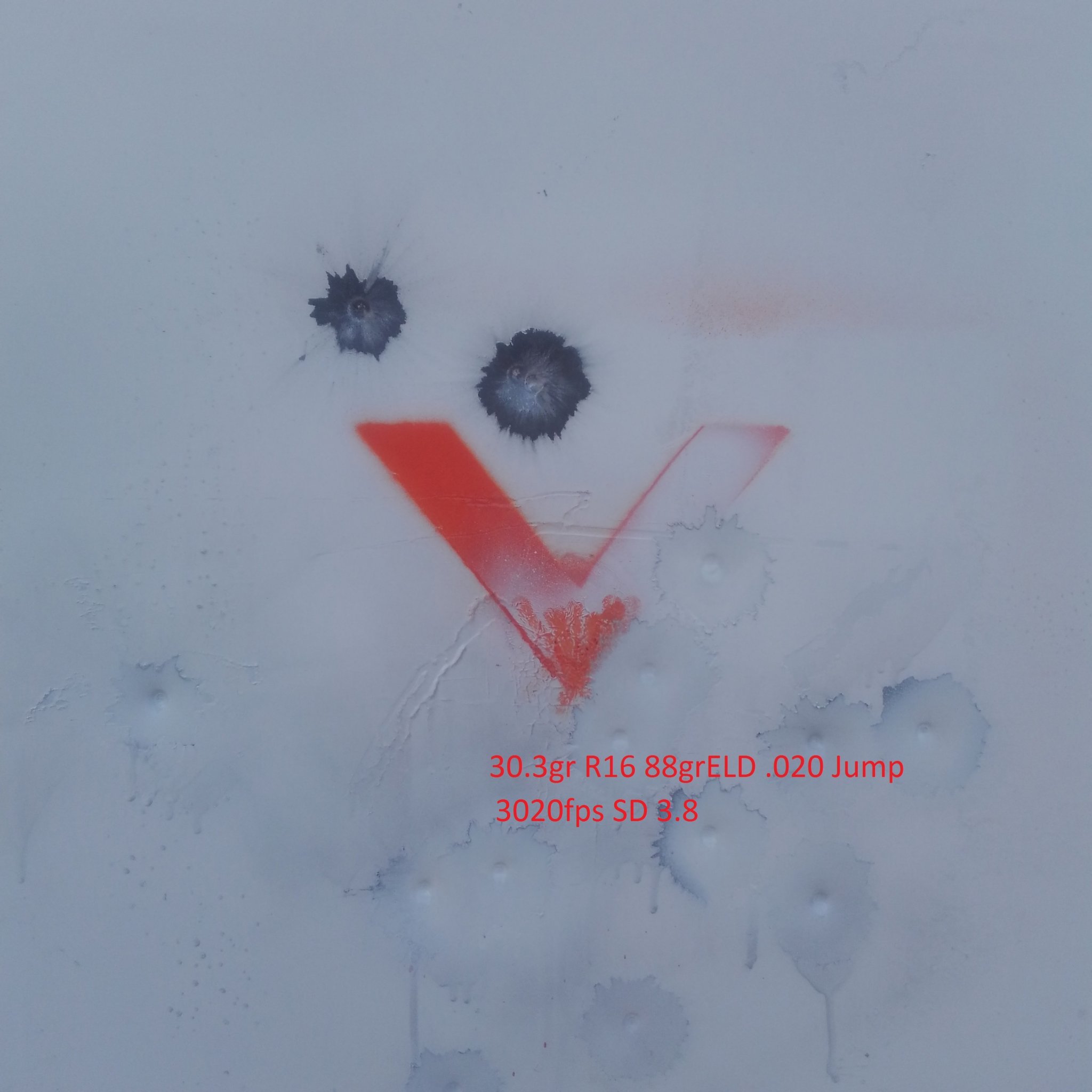

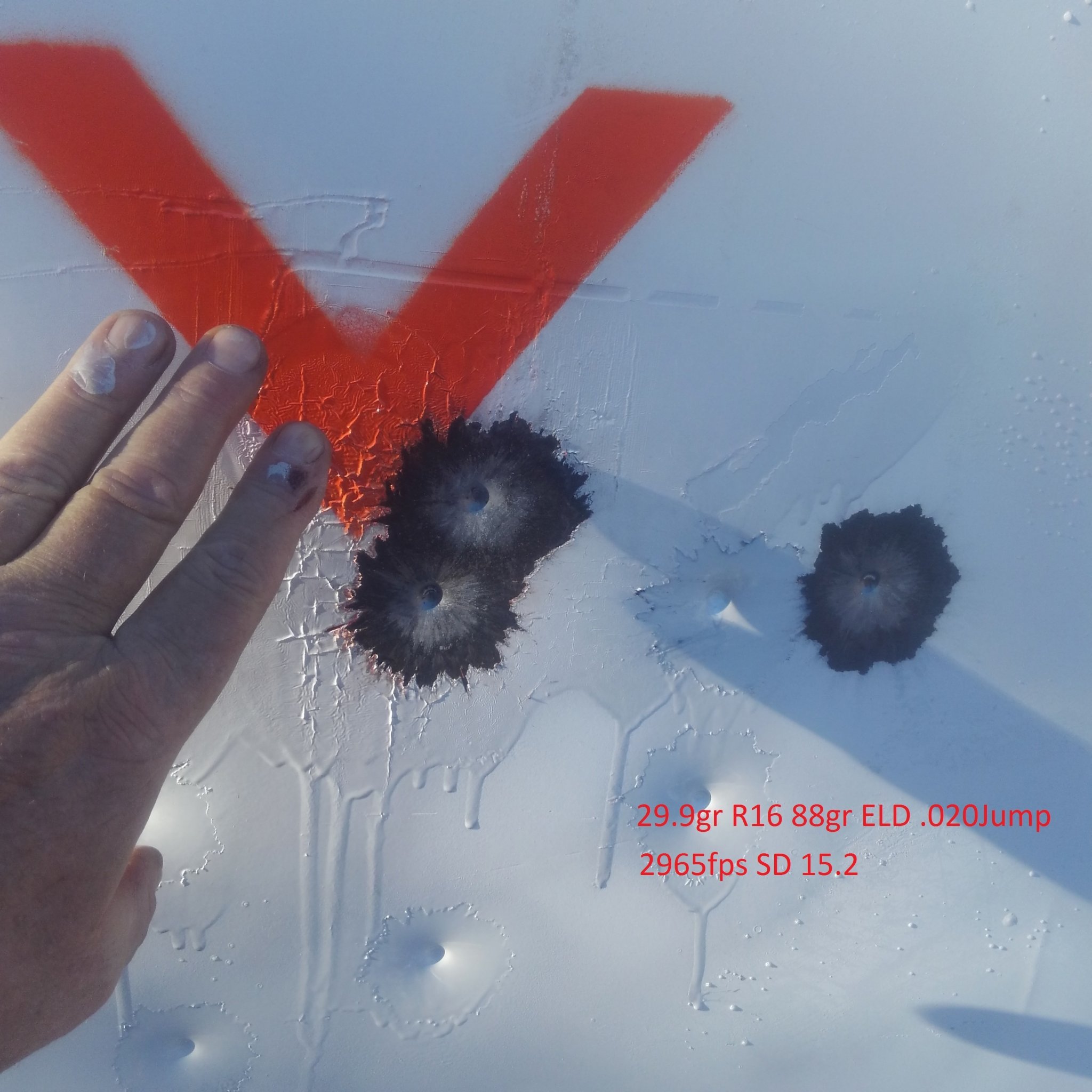

Was doing load development with 88gr ELDs and R16
At 895 yds was getting well under MAO accuracy. My best was 3 rounds under 3" with two in the same spot.

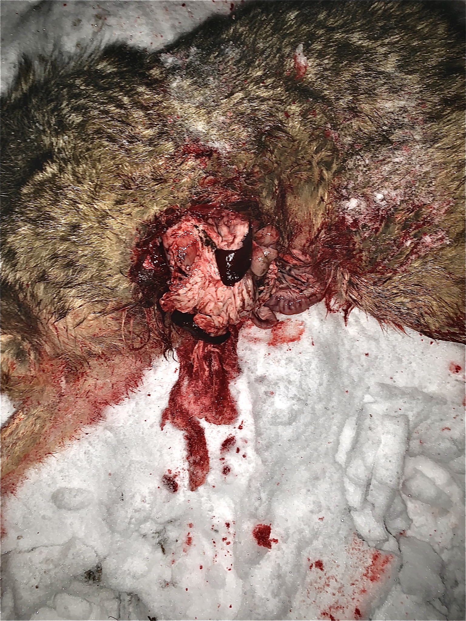

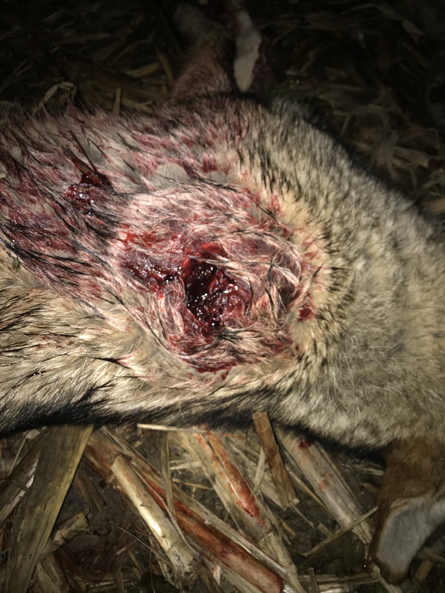

22br kills

i built a 22 brx and had a custom reamer spun up. 95s at 3150 in a 28" tube..... it was freaking amazing. going to do another with a shorter throat for the 75 elds on a 16" barrel for killing dogs
