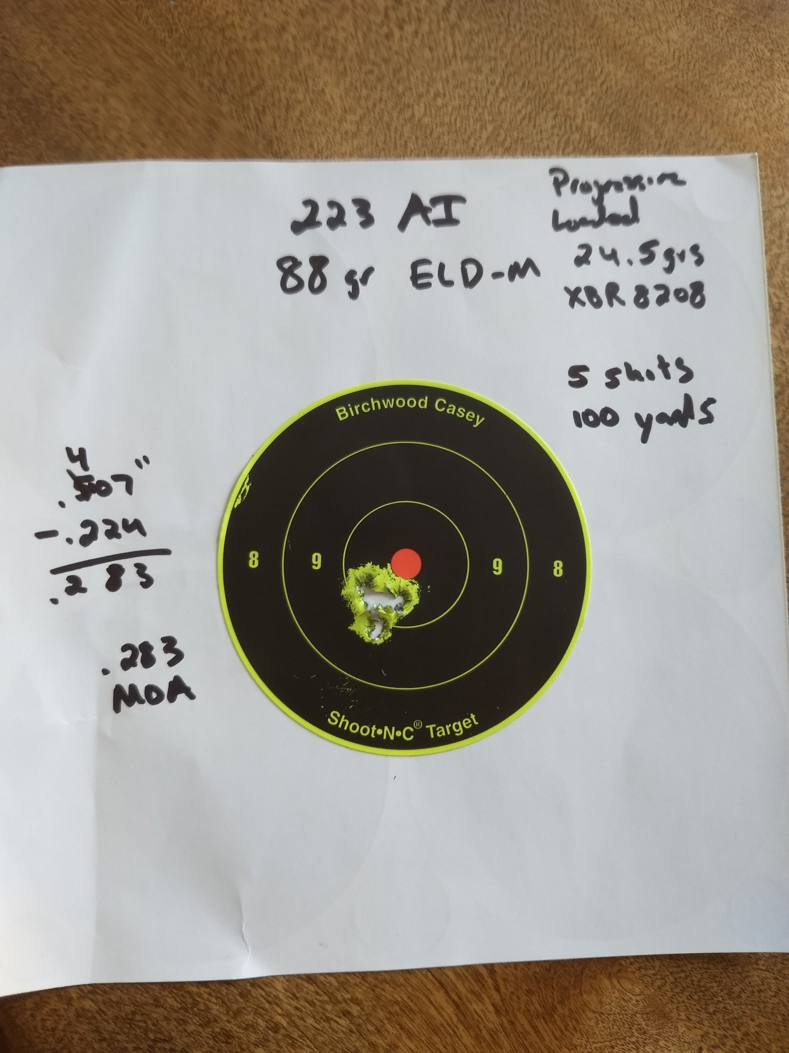

Went back and tried it again. Didn't get a chance to test the rounds in the heat but I did test the brass.
LC 16 is the clear winner. One of the best groups I've ever shot. 2868 fps, sd of 6. Lapua brass just isn't for this rifle I guess.

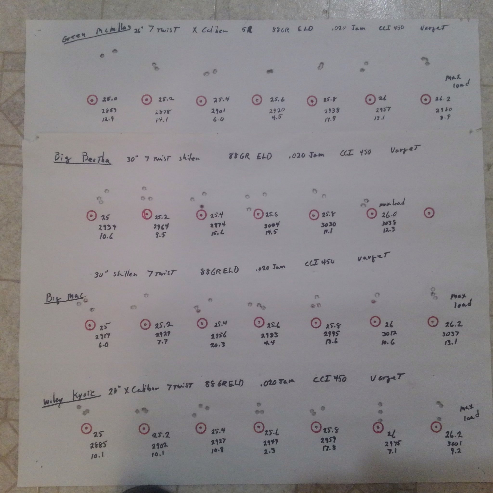

Posted this on another site, figured I'd try here too.
I now have enough formed brass to start diving into the 223AI loads using 75gr ELDs. I've went out once already and wasn't blown away by the results. Figured I'd get some more input from the folks on here to see if I might want to tweak things or start from scratch.
Some background info:
26" CBI 223AI barrel on Origin action
Standard 0.062 freebore
Formed LC brass
CCI 450s
75 ELD Base to Ogive - 1.938"
Temp was about 70 deg
I decided to try out Varget and CFE223 first. Went 25.5, 25.8, and 26.1 gr Varget. Went with 26.9, 27.2, and 27.5 gr CFE223 as well. Overall, most groups were under an inch. About the best I did was 0.5". STD/ES numbers were pretty bad for CFE (20s/50s avg) and slightly better for Varget (15s/30s avg) but not great. Velocity from my magnetospeed are below.
Varget:
25.5 - 2941 (best ES/STD
25.8 - 2989 (best group)
26.1 - 3034
CFE223:
26.9 - 2965
27.2 - 3003
27.5 - 3035
So I'd like to be a little faster. I've seen quite a few people with 26" barrels pushing 75ELDs and 80 SMKs/ELDs around 3100-3150. Good news, I have plenty of bullets and powder. I also had no pressure signs from anything shot. I went ahead and loaded up another 3 test groups for Varget, at 26.3, 26.5, and 26.8 gr. Only the 26.8 gr load had noticeable compression. Not sure if I'll put much more into CFE223 after the mediocre showing and the fact it's not temp stable.
I've also seen a few people having luck with H4895 in the AI with 75s, so might give that a shot if these next Varget loads don't turn out how I'd like them to. Anything else I might want to take a look at? Any experience with H4895/Varget/CFE223 loads and 75/80 class bullets you might want to share? Thanks for any input.

Ive Got several 223ai bolt rifles, I love the cartridge
Normally I use R15 with the heavy bullets but decided to give Varget a try and see if I could come up with a "common" load that all four rifles would shoot well. Then I discovered that Varget is in very low supply right now so, Ill probably have to start over using R15. But anyhow, I thought 25.6-25.8 seem to shoot fairly well in all four rifles. The 30" shillen barrel hit max pressure before the others likely since its the newest barrel with only about 75 rounds through it.
All these barrels were cut with the same reamer from JGs with a .170FB. All barrels were headspaced with the same gauge and I can interchange brass from one to the other. All the brass is Starline and neck turned just enough to clean up about 90 percent. All the ammo was loaded at one sitting. This is my 200yd target and was using a lab radar for velocities
Im not a big Varget fan but had a bunch left over from my 6BR so was using it to find a "common" load. R15 is actually faster and more accurate in my opinion.
I dont know how to rotate the picture?

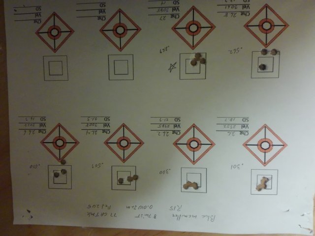

I use RL-15 in my 223AI with 75gr Amax and it works out very nice for me.
I use it with the 77gr TMKs too. Good Velocity and good accuracy. This is with a 26" barrel

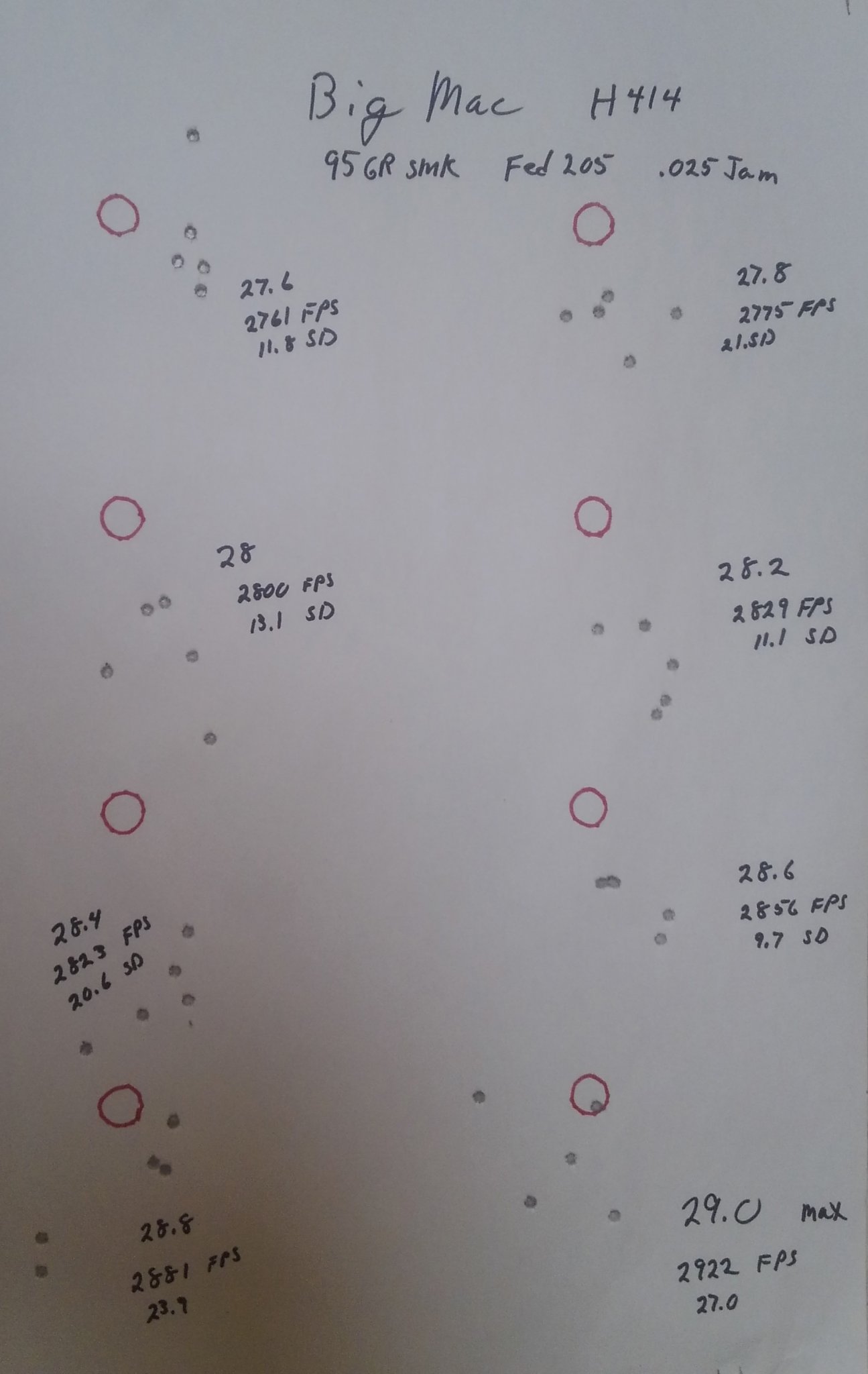

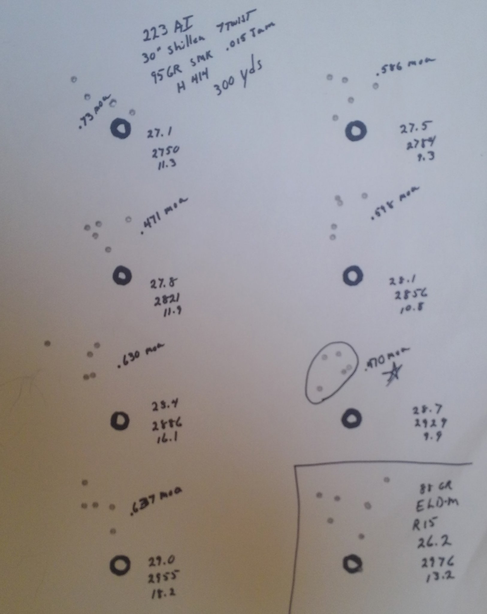

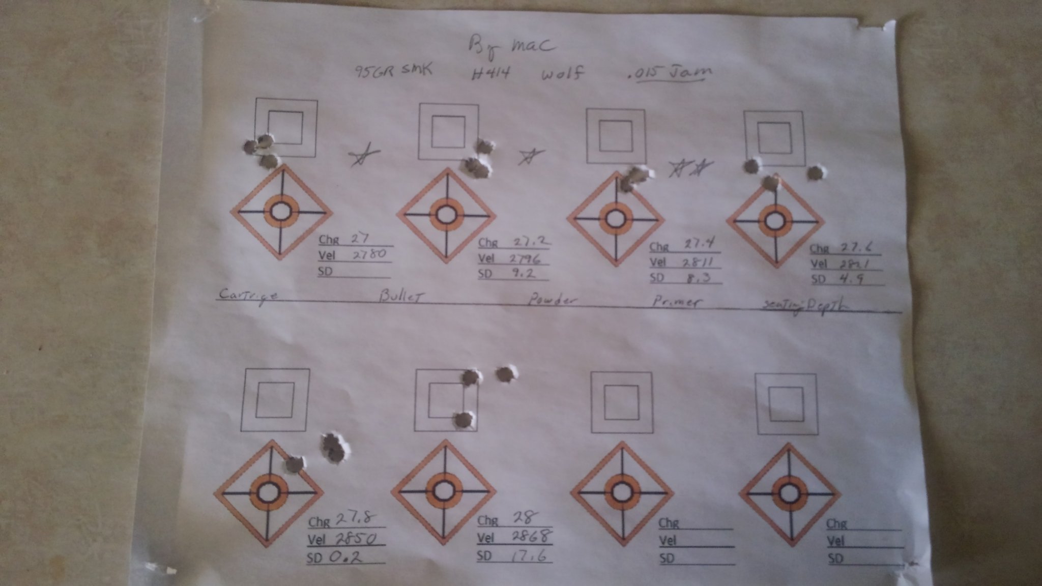

Has anyone tried H414 with the very heavy bullets? Im getting pretty good velocities and decent accuracy at 300yds

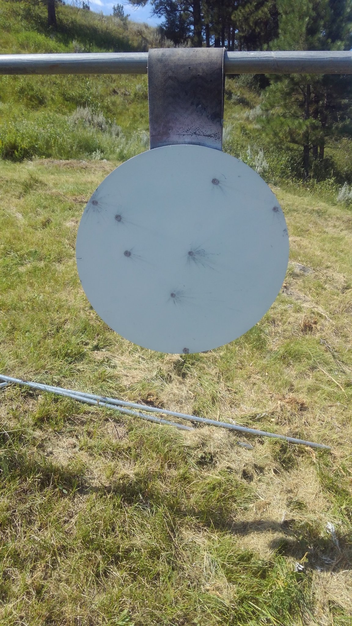

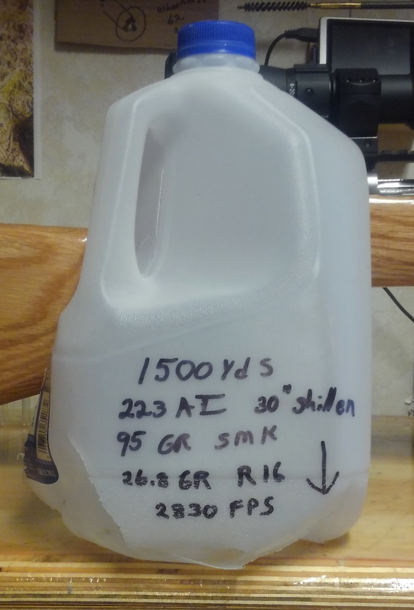

Whats Your Freebore? Im seating my 88s at 2.64 and single loading them.
Those 88s sure do sail nice but I start loosing MOA after 1520 yds. Im hoping the 95s might get me a till further.
  • Love
Reactions: PracticalTactical
I took 10 shots and only hit 18" steel 8 times
I was a little tired after mowing the grass around our range at every steel plate out to 1810. I need to get out and try it again but with the 95s
I don't know what the freebore is. The pipe fitter had a chambering reamer and a throating reamer. All we did was run the throating reamer in until we hit the seating depth I was after.
The goal was to have the base of the bearing surface with the 88s just forward of the neck to shoulder junction.
That's awesome BTW that you're working steel out that far. Most guys assume that's unrealistic for a small caliber. Where I shoot we have 760 yards max, so past that its a rare occasion to test performance.
It also depends on what the farmer plants. Soy beans are fine but corn is so tall it hides our targets.
The guy I shoot with designed the range. We set the benches up on one side of a long creek bottom and shoot down the length of the creek to the opposite side and onto the hills that are formed by the water sheds.
Weve been shooting together for the past couple years and he's been kicking my butt lately.
This time of year its prairie dog season so we dont get out there to shoot the range much right now which actually works out for the rancher since he supposedly has 1500head of yearlings grazing it right now.
Our ultimate goal is 1810 with the 22 creed (maybe the 223AI too) but, Weve already been there with the big boomers. If that gets too easy we'll have to find a different location to stretch it out further since the creek makes a turn and our range is done.
I was told, (since I dont spend much time on the computer) that some boys were having good success with the 224 Valkyrie at 2100+. Why isnt the 223AI shooting those distances? What does the Valkyrie have that the 223AI doesnt?
I suspect that if you had a 224 Valkyrie, you would be using it at those distances. Most guys... myself included have no access to anywhere to shoot that far, so its just not an option.
4 shots to get my dope and 3 to hit
Been trying r16 a little because its so consistant but just cant get enough powder in the case to get my velicity up.

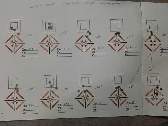

I ve had poor results with H4895 but havent tried it with 75gr elds.
When I was trying it with 88gr elds I hit pressure way sooner than expected and popped primers. Even Quickloads said I should have expected higher velocities and higher loads. I Had to pull bullets on two hotter loads that should have been safe.
However, 4895 works pretty good with 55gr bullets.
R15 will safely get 75gr elds to 3080fps with a 26" barrel and 3210fps with a 30" barrel.
made it to 26gr H4895 with 77gr TMKs (dont have any 75gr elds right now) before popping a primer,
barrel is 26" 7.5t criterion and Im using starline brass. Labradar batteries were dead when I got there so couldnt get velocities.
Looks like the accuracy node is down around 24.2gr
If your over pressure at 25gr you might check for a carbon ring?
I doubt bushing the bolt is the problem since Im using a factory savage bolt head that blanks (pierces) primers except CCI450s and Wolf Mag primers.
I still prefer R15 though

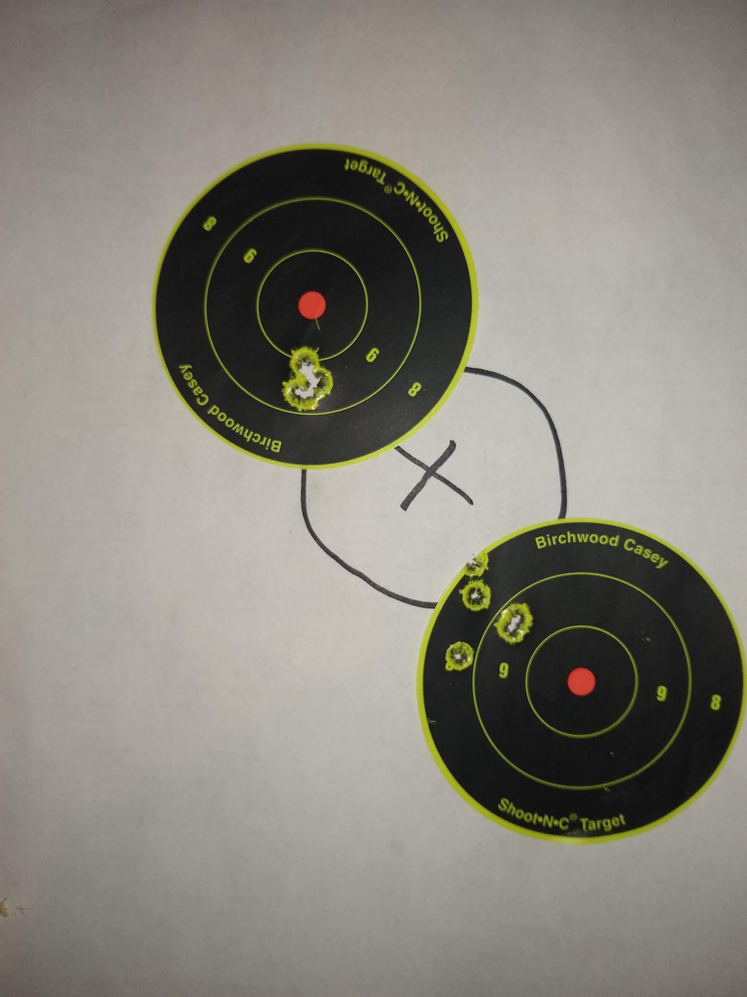

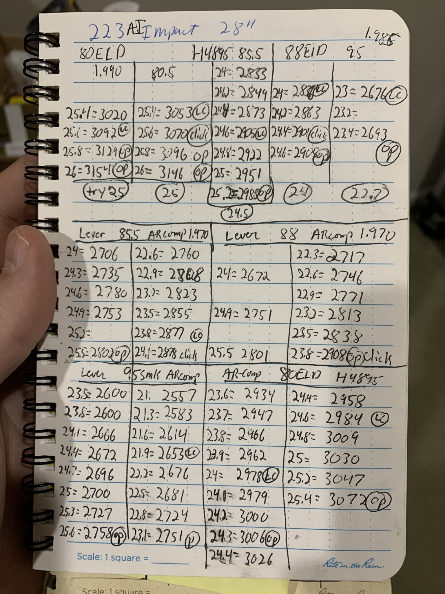

I’m running a 28 inch Bartlein, 5R, 7 twist and not pushing it to fast with lapua 1x fired brass
Reactions: DIBBS
Went and tried a few ladders with all of the different primers. CCI 400 pierced on the lowest charge so no data but here is the rest
Reactions: DIBBS
Wondering if youve tried H414 with those 95s?
