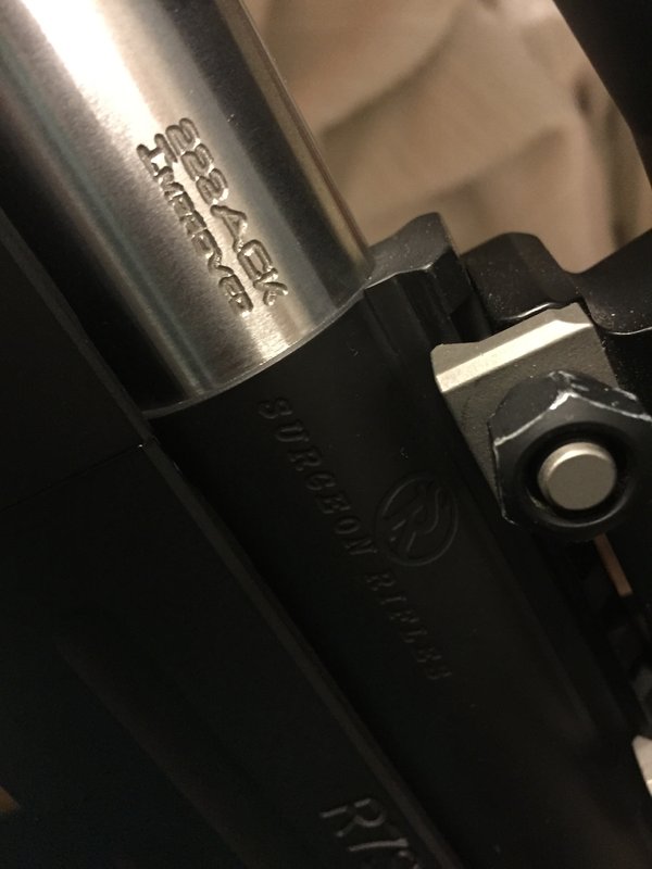

Got access to a 1100 yard range. I'll be building a 223 Ackeley Improved with .169 free bore, same as the PT&G ISSF reamer commonly used for F-T/R. I'm hoping to get 2900fps with the Berger 90gr VLD and 3050fps with 80gr ELD-M and 80.5gr Fullbore. Most of my parts are in the mail and on their way to Long Rifles Inc.
Parts list:
-Surgeon 591(used to be attached to a 16" 223R barrel)
-Bartlein Rem. Varmint .224 7 twist 5r barrel (24"-28" ?? not sure yet)

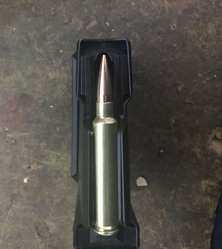

This is a 80vld .010" off the lands in a .100" free bore. Accurate mag.

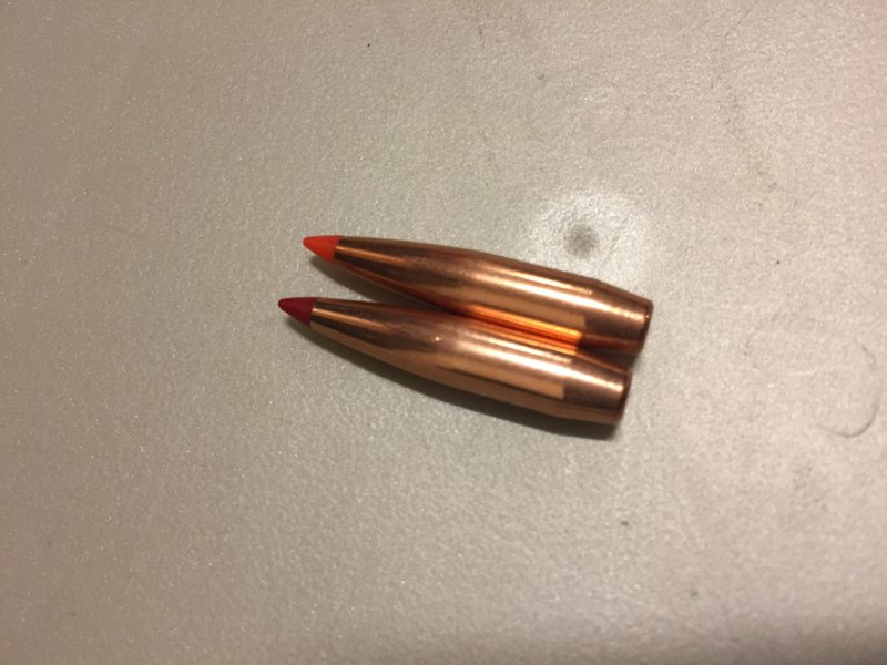

I needed to make up a dummy round for LRI but was going back and forth over COAL and AICS vs Wyatts mags. I just got the 80ELD-m in the mail and started playing with them.
ELD-M vs A-MAX

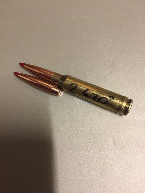

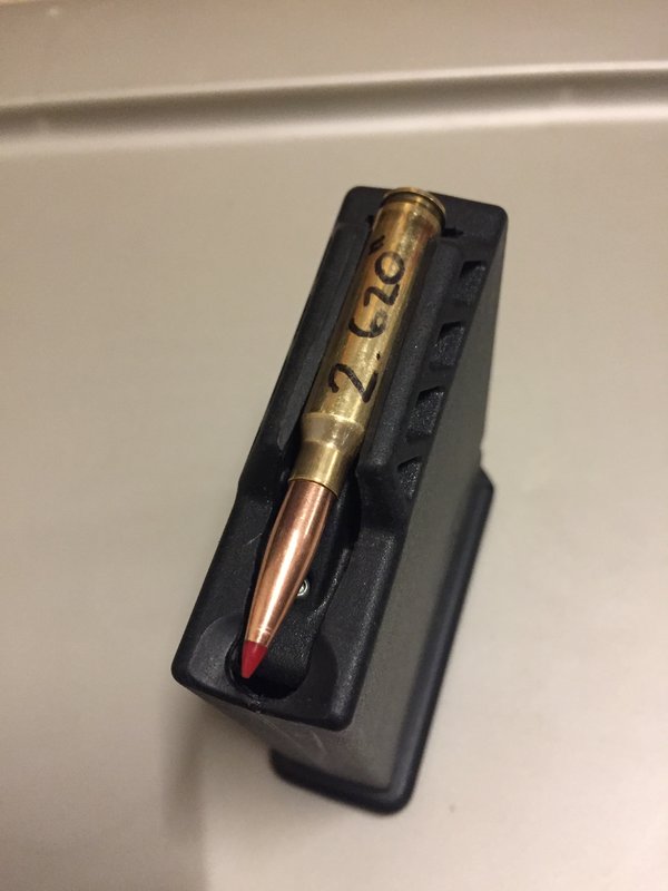

I decided to go with a 2.620" COAL. This puts the end of the boat tail just out of the case body.
No issues yet, cycles without a problem. Hopefully it will stay that way after they transform to Ackeley Improved.
The 90s will still be a little cramped. I'm hoping the 80s will get the job done, "1100 yards", and I won't need to play with the 90s.

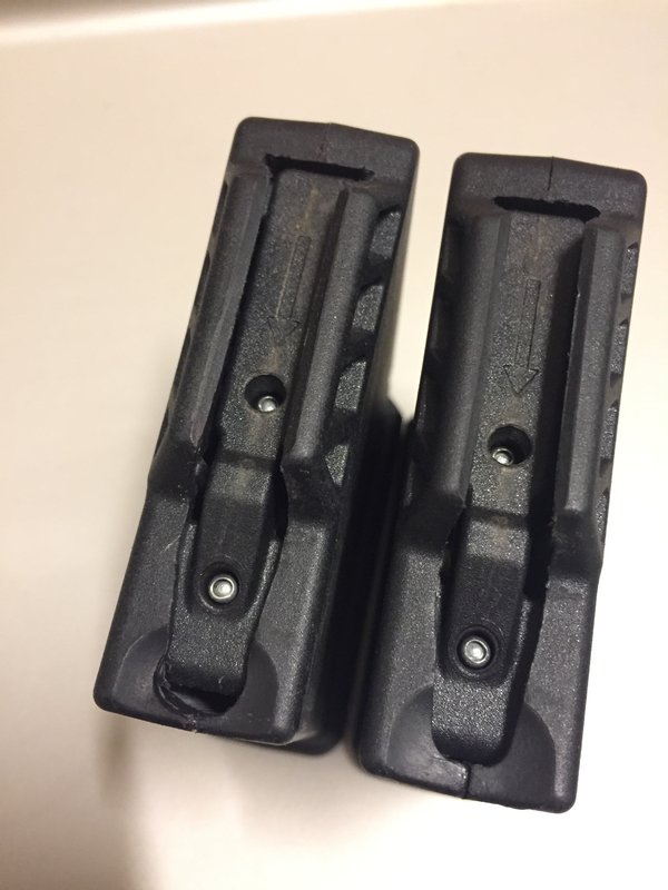

I modified one of my AICS mags to give me a 2.620" COAL. We'll see how it works when I get my barreled action back from LRI. With my Mcree Precision G7, stock pack, bipod, and Nightforce scope I'll be running a 13lb. 223ai. That may be a little heavy for running around in the back yard with.
