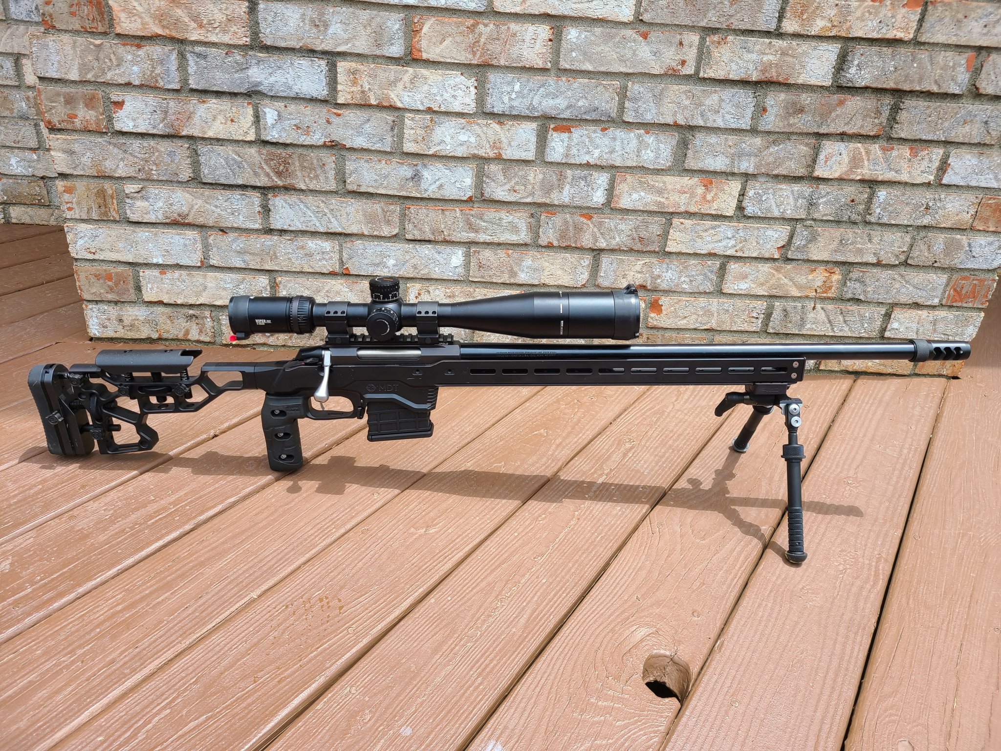

Anyway. Here's a photo of my T3X Varmint in MDT LSS-XL chassis and skeleton buttstock with MDT 20MOA rail, MDT ARCA rail, and Anarchy Outdoors bolt handle, fed by 10-round MDT polymer magazine. It ran as slick as any of my customs.
Only downside to the XRS / T3X Varmint rig is the barrel is not threaded. Of course, a brake is not really needed for a .223, and any competent smith can thread if desired - but the cost is a significant percentage of the cost of the rife.
When I made the move from factory rifles to customs, both of my Tikkas sold in a day. They were admirably accurate with factory ammo or handloads. Full disclosure: I had light-strike issues with attendant failures to fire in the .223 Varmint with handloads primed with CCI 450 magnum SRPs. I never had a problem with factory ammo or handloads primed with the thinner, softer CCI 400 primers. The problem turned out to be the firing pin had an almost flat tip; once it was radiused to have a normal rounded profile, I had no more problems with the CCI 450s.

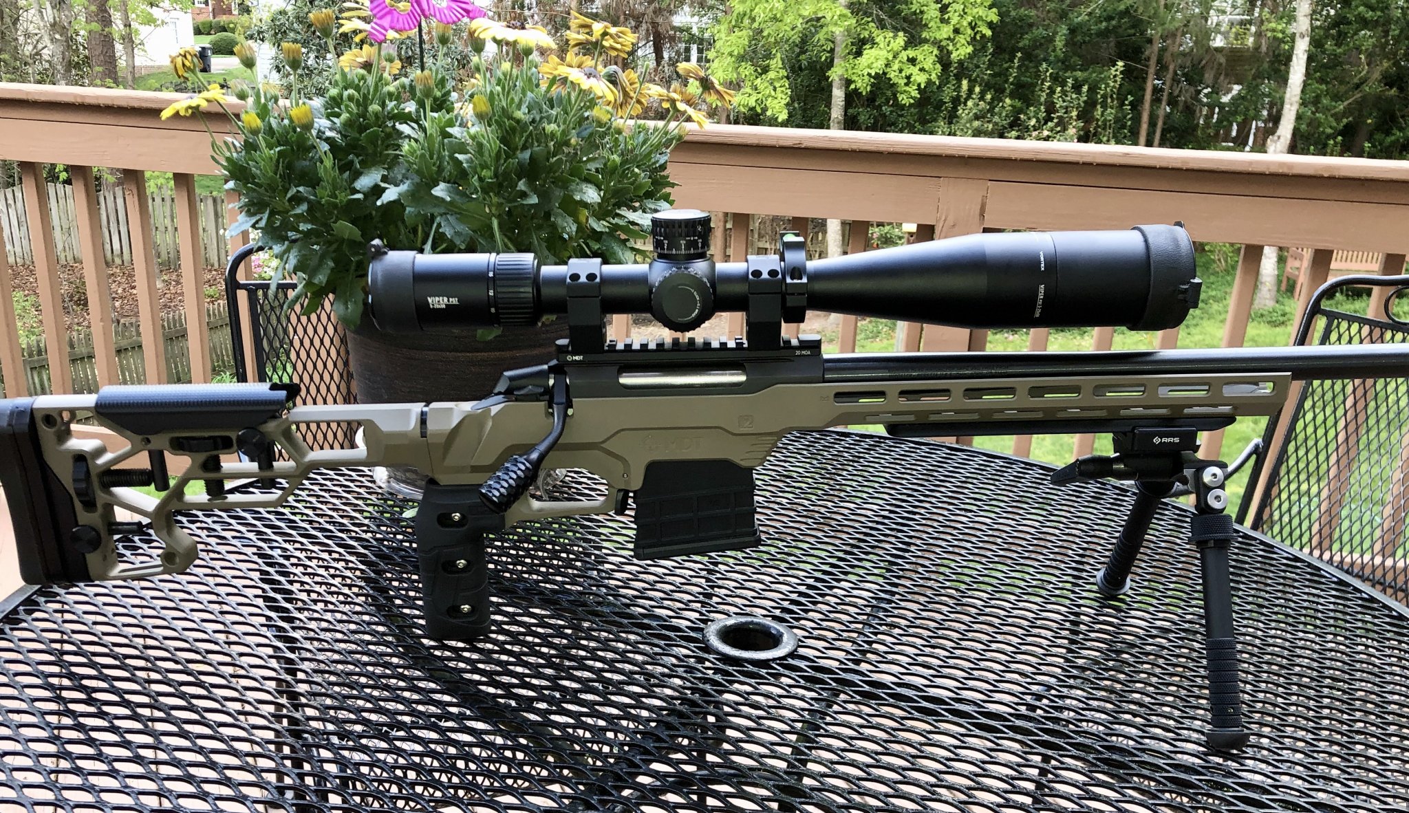

Tikka T3x Varmint gets my vote. This is my rifle, it's a Tikka T3x Varmint in 223. Bought the barreled action here on the EE, previous owner had the barrel threaded. It's in an MDT ACC chassis, Leupold scope rail (from previous owner), Vortex PST Gen2 5-25x scope, Atlas Bipod, and MDT 10 round magazine. This thing shoots like a laser, highly recomended.
Would like to swap out my bolt handle for something bigger though.
Reactions: 300rem7
