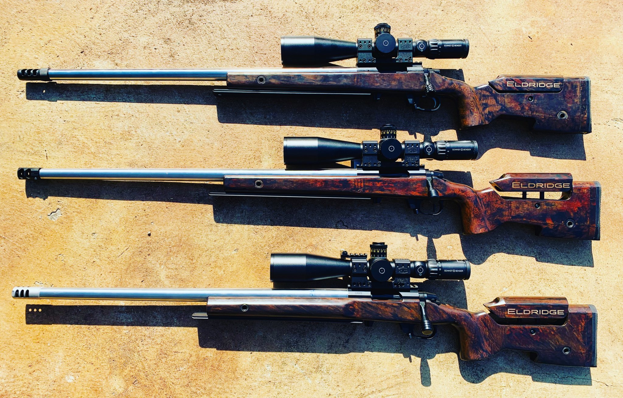

If you don’t have matching rifles are you even a PRS shooter? Lol
I don't get it.
I stand by my statement as true regardless of "who" any of you are or are not.

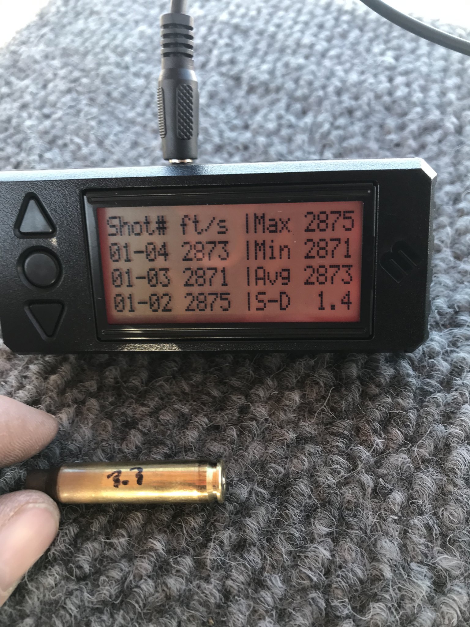

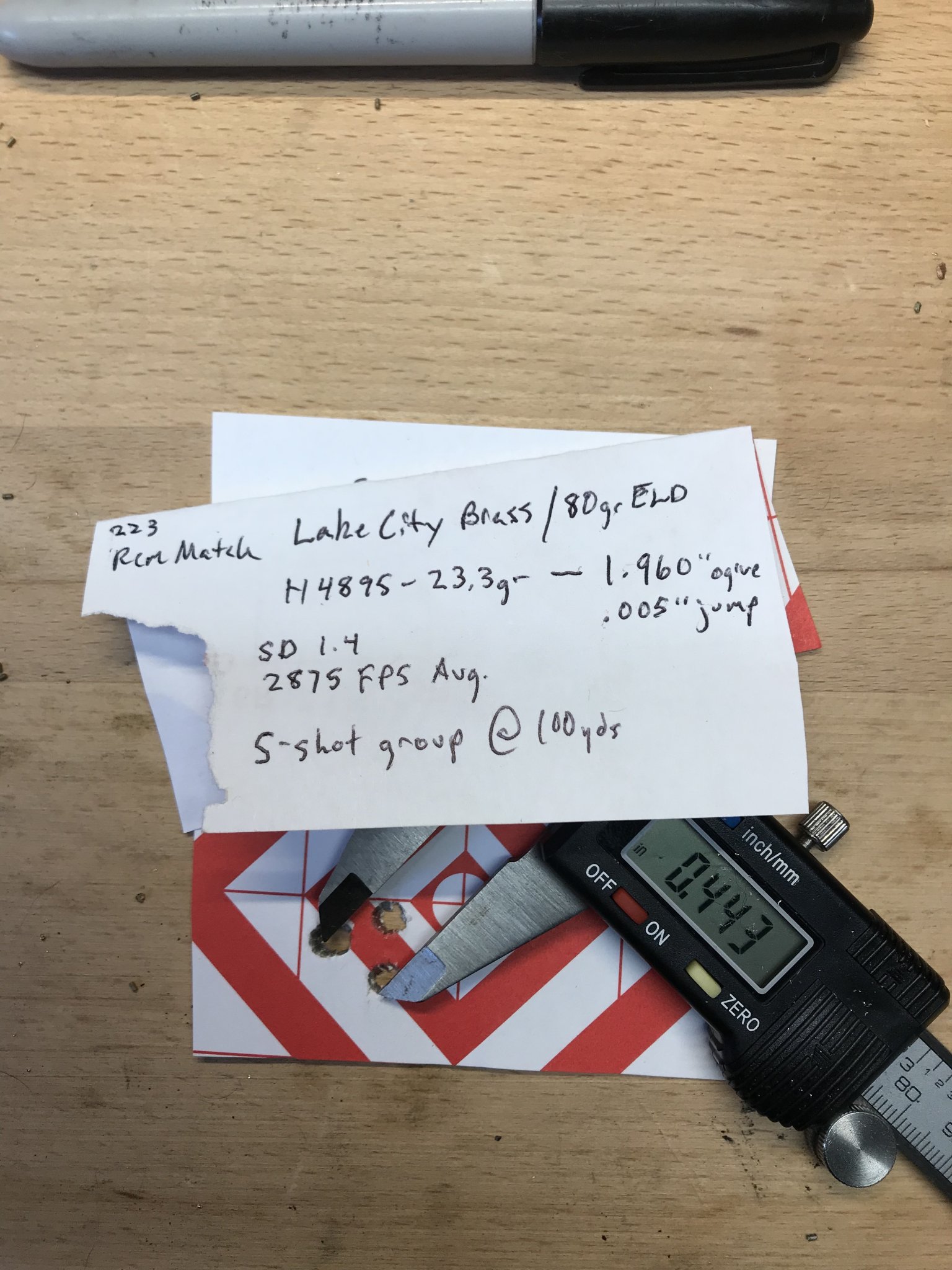

Thank you to everyone who gave me info to help my 223 build. It is a success! Here is what I have narrowed down too for a load and will test it at a local match Saturday
H4895-23.3gr
CCI400s
Lake city brass
80gr ELDs
1.960” (.005” off the lands)
SD 1.4, 2875fps

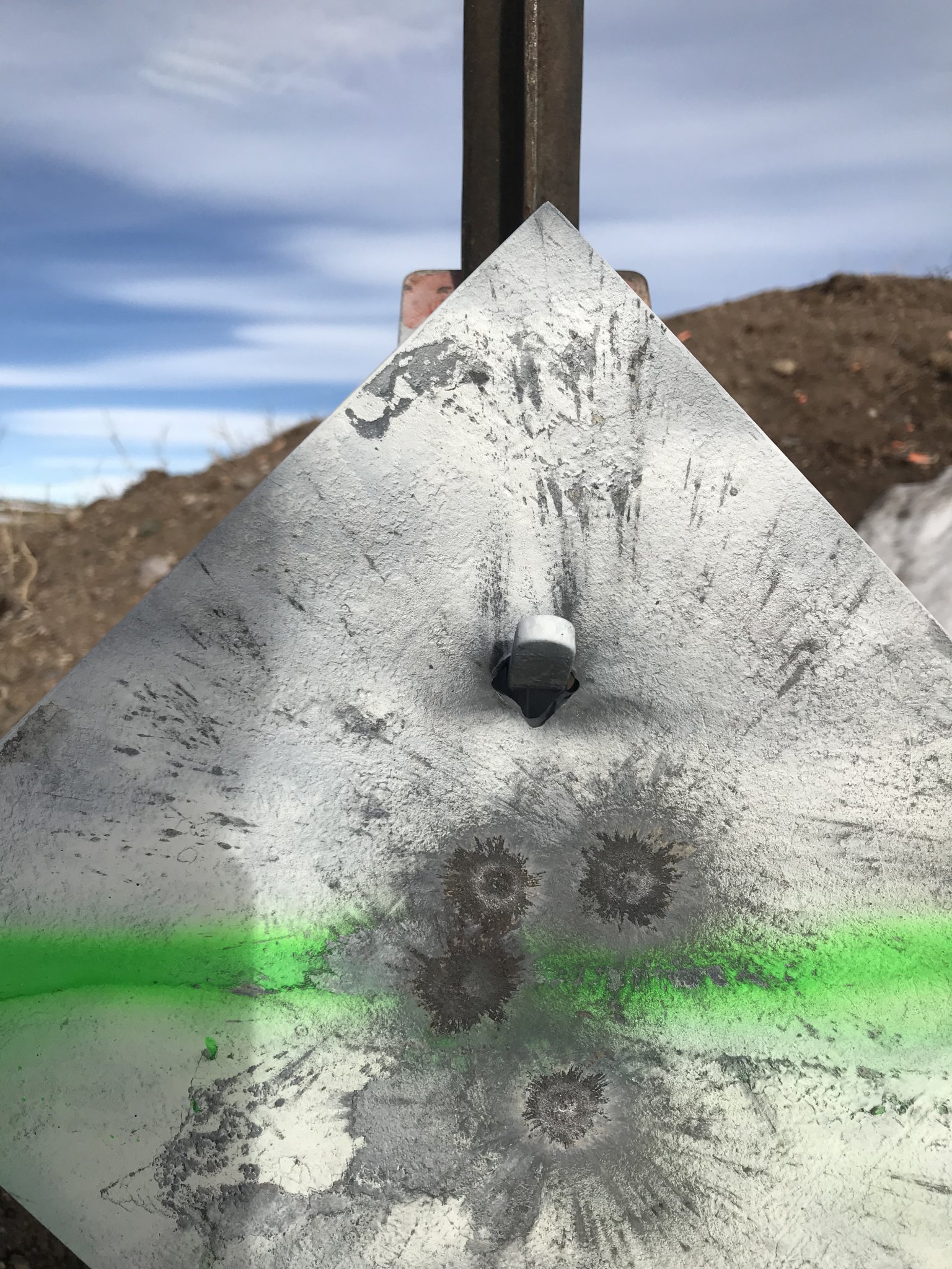

The steel plate is @600yds for a tight lil butthole of a group ??
