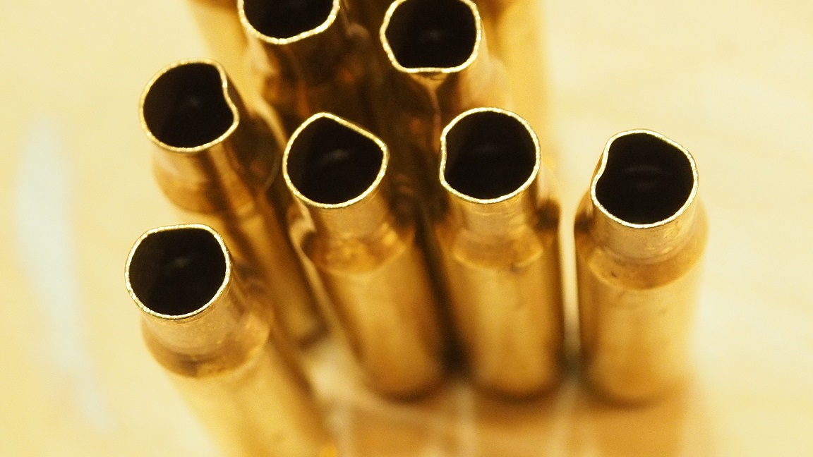

Here's a picture of some case mouths that were dented from ejection from a Rem 700 clone.
I have since shortened the ejector spring and now it's almost not noticeable.
Good luck reloading cases like this and getting low runout.
If I was to buy a new action tomorrow it would be one with controlled round feed for this reason alone.
Yes the problem can be resolved with a shorter ejection spring on a Rem 700 but then we flirt with less reliable ejection. That's fine for a bench rest or F Class rifle but it sucks for practical field use.
