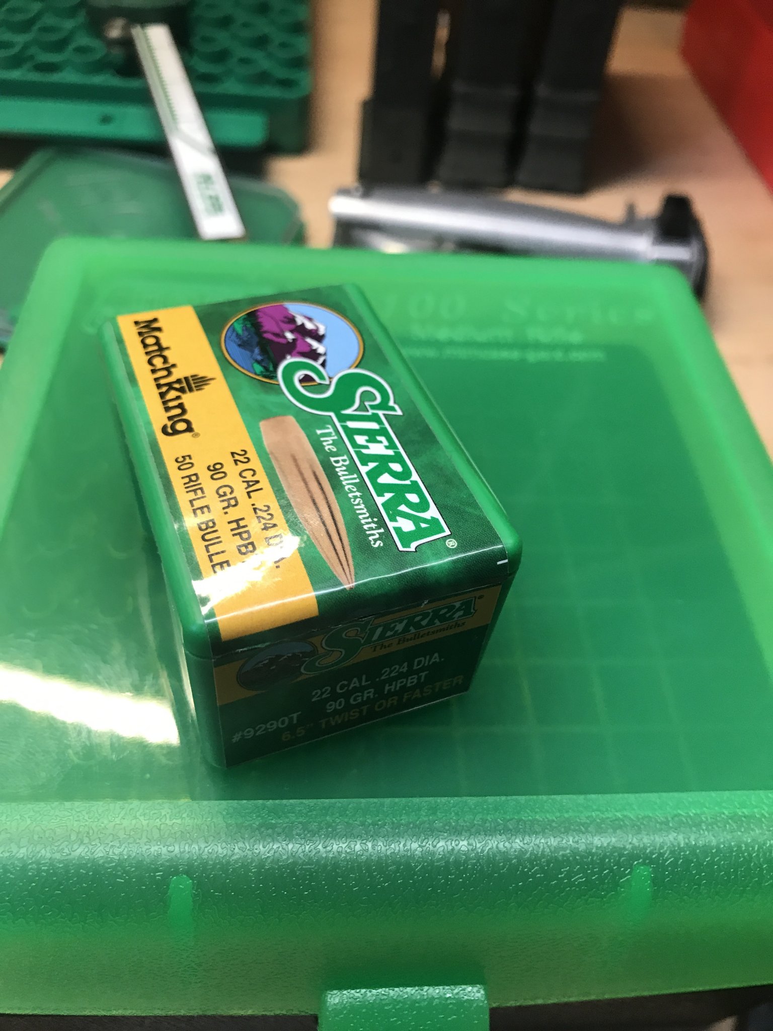

You must have some of the old non-pointed 90smk with the G1 BC 0.504?? The new pointed 90smk are fucking awesome and have a G1 BC of 0.563. They are my go to bullet in 220TB running them with a mild load @ 3040. 0.5moa was easy when I tested them at 900yds a few weeks ago. Elevation was dead center of target with 6.7mil out of a 26" 1:7 Bartlein.
Once I get home I’ll see what box I have. I haven’t done the Satterlee test with them yet, might just steal my 88ELDs load and try that with 10rds
I’m not sure, it doesn’t even say on the box lol

Here is the new pointed 90 SMK. You can see the obvious pointing on the new ones... the old ones did not have that at all.
It’s the new ones. Now I’m gunna give them a go!
