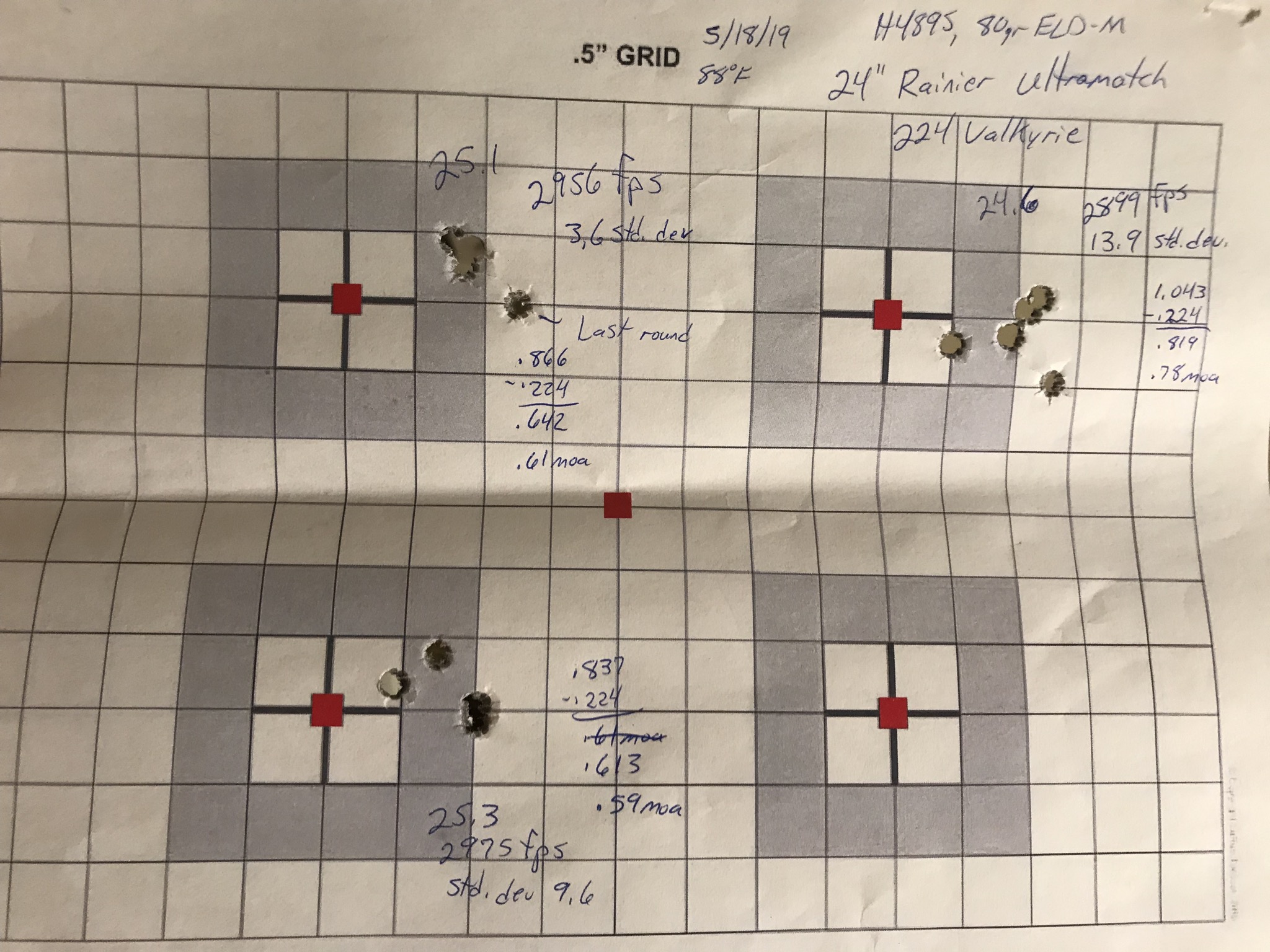

I shoot matches <800yds with a 20” barrel Rainier Ultramatch Mod 2 and my go-to is an 80gr ELD over 24.8gr H4895 mainly due to velocity gain over 88s/90s and cost of the bullets. I’m around 2910fps with that barrel length. Could go hotter/faster, but the accuracy was the same but the primer pockets died much quicker
It’s proven that the more you hot rod it, the lower the primer pocket and brass life is. Either get a longer barrel (24-26”) to start with or get used to buying brass every 2-4 reloadings if you want to run them super hot
I don’t have a place to shoot 1000yds near me but the caliber does very well with:
77gr TMK
80gr ELD
88gr ELD
90gr SMK
I would like to try 80.5 and 85gr Bergers because of the reputation they’ve got for accuracy. I don’t plan on using 95gr SMKs
Again, I haven’t shot to 1000 and developing the loads I have WAS very time consuming compared to .223, .308, etc, but my 20” gasser is a rock star. I was given the barrel, otherwise I’d of gone with a longer one for speed’s sake, but running moderately “warm” loads, I can usually get 5-6 reloads within a very accurate node with H4895 with 80gr ELDs
If I go heavier with 88gr ELDs or 90SMKs, Varget or Reloder 15 works better for getting some extra speed

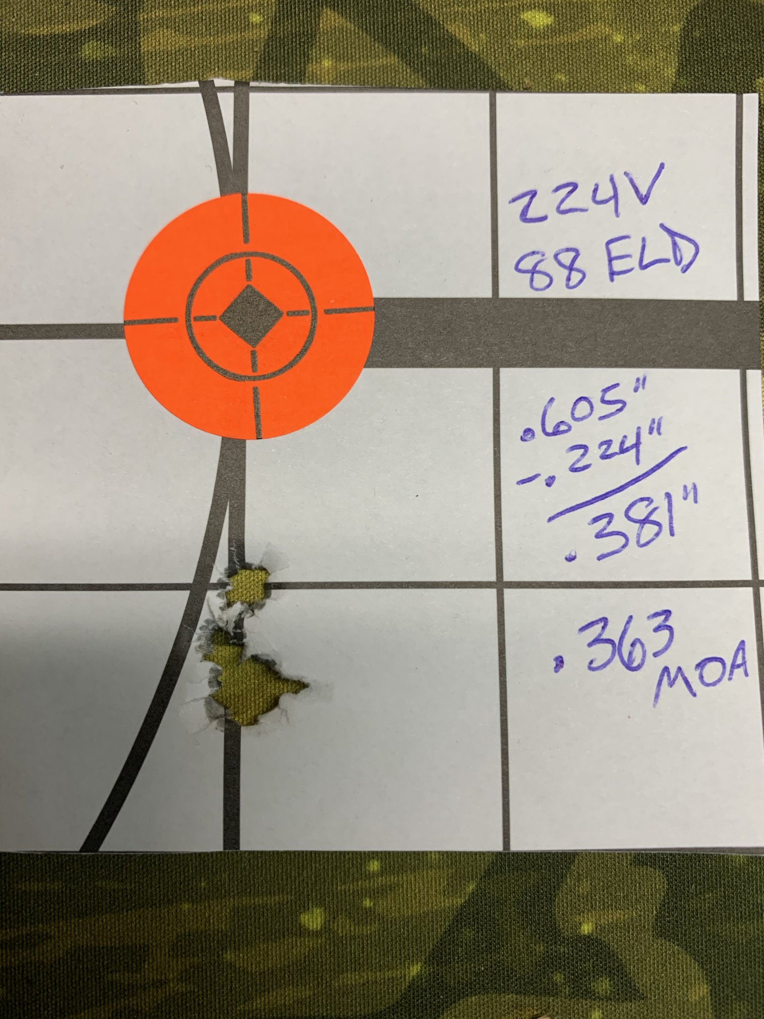

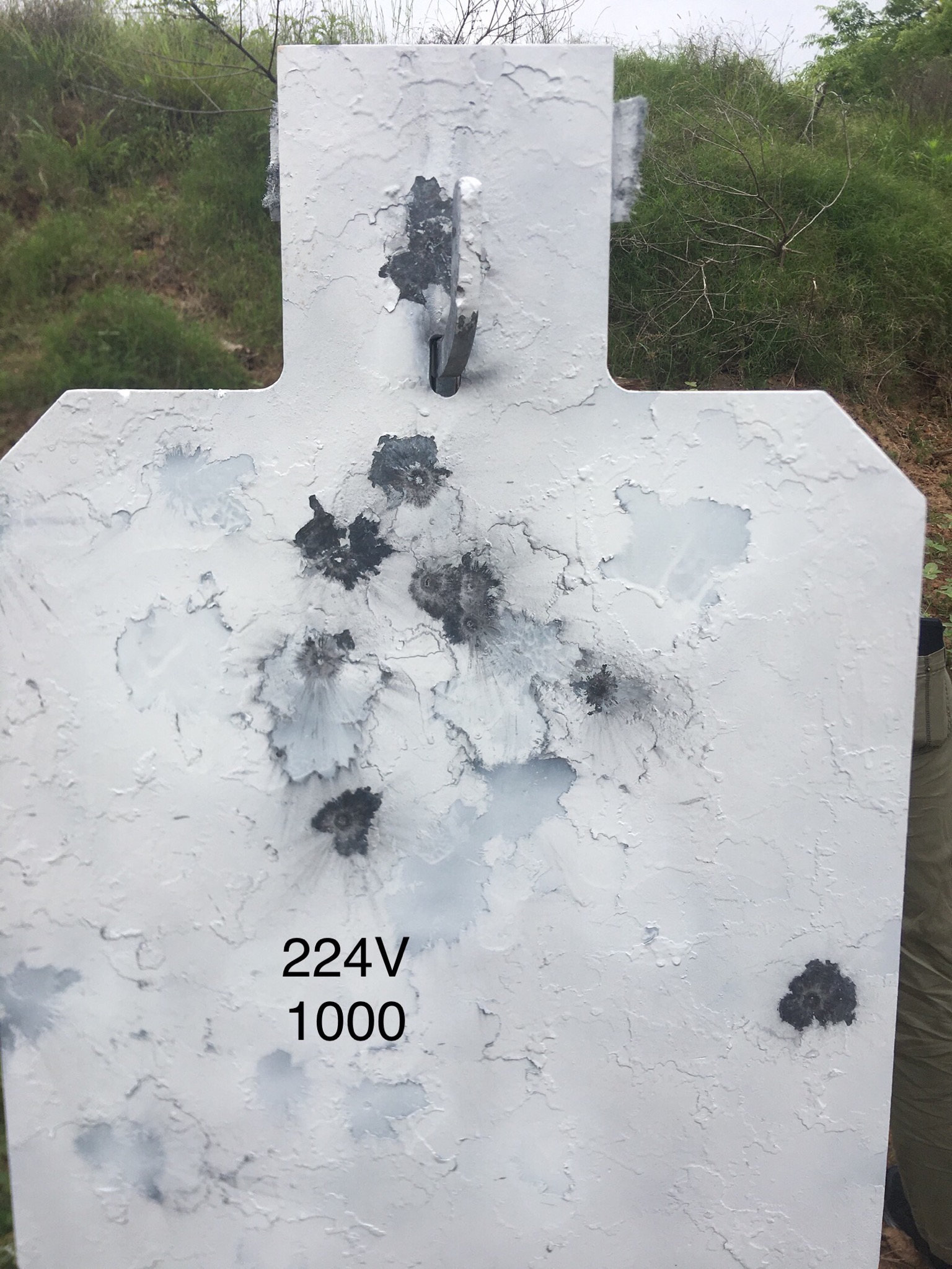

I really enjoy shooting my 224 V Craddock/Bartlein. It held its own with my JP LRP07 6CM today our to 1k.
Shooting 80s around 2900 is just something I can’t do with my 223 Rem ARs.
It’s been a rough launch for this cartridge for sure, and I had challenges as well. But I’m happy with it. This was 1000 yds with 80 ELDs 8.9 mils/ 1.1-1.4 mils wind.
Great shooting, was that on a regular IPSC size target/steel?

Seems like a fast 20", or my 26" is slow/hasn't come in to it's own yet. I'm running 25gr h4895 and only getting about 2900. Plenty accurate though.
Seems a bit slow for a 26”. This was my first 24” during load development. Less than 40rds on the barrel at that time. I haven’t chrono’d the second RA 24”, but it shoots great with the same load.

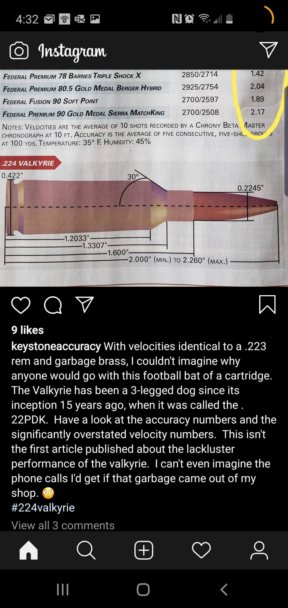

On another note, this just came across my Instagram.
Lol. Can’t imagine why he’d post that. It was obviously a bad barrel/reamer combo for that testing. Too many ppl have had good results for it to solely be the cartridge/factory ammo now.
100% agree. In fact, whatever publication doing testing should’ve realized something was amiss and contacted the supplier of the barrel/rifle

On another note, this just came across my Instagram. View attachment 7307686
I’ll be keeping my .224V thank you very much. That barrel/chamber used to test for that article was obviously a dog.
Mine has shot all three different factory loads I tried just fine. Each under 1 moa at 100 yards. I can plink out to 600-ish with the cheap federal American Eagle and I use the Hornady 88 ELDM for further. With either, it’s a fun laser like AR and all the kids and anyone else that shoot it like it.
Reactions: Colin10 and TACC
Oh I know. I just thought this was funny because he cut my 224v barrel and it's the most accurate gun I own. 80.5gr beregs are at .23" @100.
Also he is pushing for the 220TB so it makes sense that he's no valkyrie fan. I'd just think he'd be a little more on top of things then to bash the valk based on a crappy test.

I went to AK with my JP 224V and had them grab me 75gr American Eagle at $8 a box in Alaska
I went the range to zero it and was like WTF because there was only one hole in the paper, so I moved my POA up a tick to see if it changed, well yes,
This is 3 shots, not 2, made me laugh at all the complainers

I never said it was a deficiency with the cartridge, only the execution on the part of manufacturers making bad barrels with junk blanks improperly reamed.
For now, I'll wait until the cartridge becomes more popular and manufacturers figure out how to execute for less.
