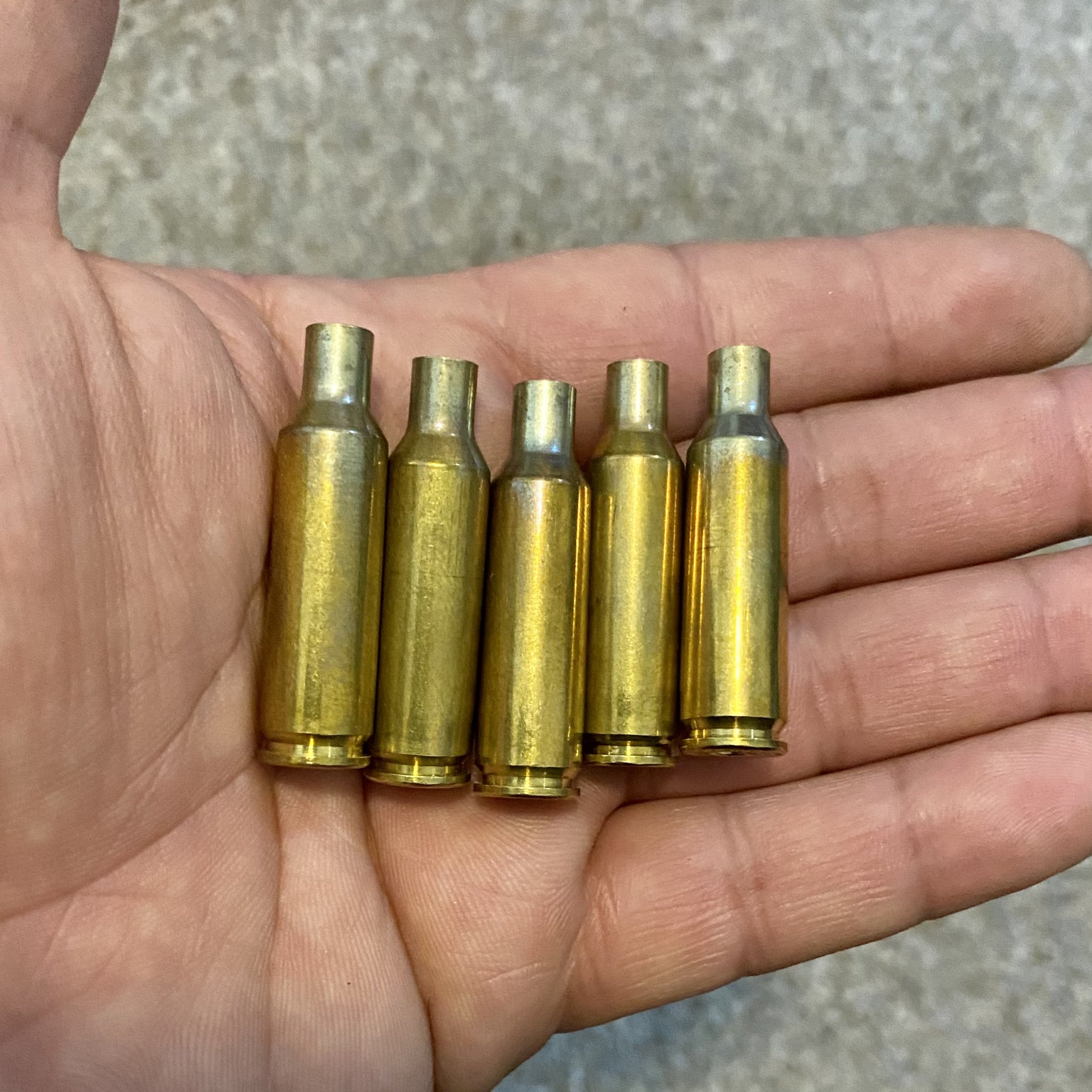

If you have any empty Hornady brass left, do a water capacitor test.
“I use this method to determine H2O capacity:
Syringe with a 18-22ga needle, preferable long enough to reach the case bottom. I use the stylet needle from an 18 ga. V catheter.
Water with approx. 5-10% Isopropyl alcohol (Used to reduce surface tension of the water, % NOT critical....odes not take much alcohol)
I insert a spent primer into the pocket. One company, PMA or 21st Century?
makes a pocket plugger although I have not used one
Weigh the plugged case dry. Fill with water/alcohol by inserting needle to bottom of case and fill with needle submerged to avoid bubbles. Fill until the water reaches the case mouth. Observe the meniscus (convex or concave 'dome'. If it is convex you can pull a minute amount of water out with the syringe; if it is concave add drops until the meniscus disappears. When looking down on the water meniscus with some overhead light you will see a reflection in the water in the center of the meniscus. When the water is flush with the case mouth the reflection will disappear. It only takes a couple of minutes to practice this and see this effect. Once you have the case full then weigh it again and subtract the dry weight and you have your water capacity. With very little practice you can get the total process down to a minute and a half per case.”

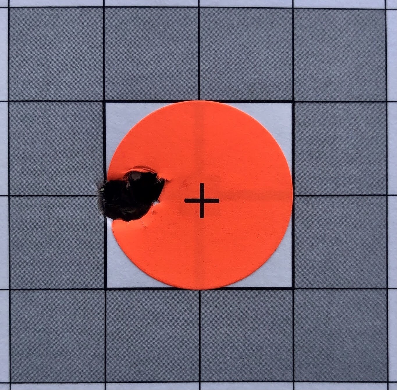

Hello. I will be shooting and testing more Valk over holidays. Specifically, 80.5 berger full bore, which I believe is the most accurate bullet I tested so far in Valk, and I think I tested everything available on the market at this point. After I got a good barrel, basically, I routinely shoot sub MOA from probably 50+ different loads. Here is dozens of loads at 100 and 200 yards, using ELDM, SMK, you name it.
Best group I ever shot at 200 yards, is with 26.5 grains of Reloader 16, and Berger 80.5 Full bore. Not even high pressure.

All those have had really solid groups. Reloader 16, that group is around .3MOA at 200 yards. Thats pretty top tier from an AR platform and not bolt gun. From a $250 barrel? incredible. Having 50x magnification Trijicon Accupower scope helps, but still...
on the H4895. I shot, as you can see, 25 grains+ using 80 grain bullet. Didnt blow primers, but was stamping the brass good, 1 and done. Pressure starts to show up around 23.5 grains, but I think the best loads with ELD 80 is going to be in the 24+ area. High velocity and near 1/2 MOA. H4895 is surely a top tier powder for Valk. If that is all I could get, I would be happy.

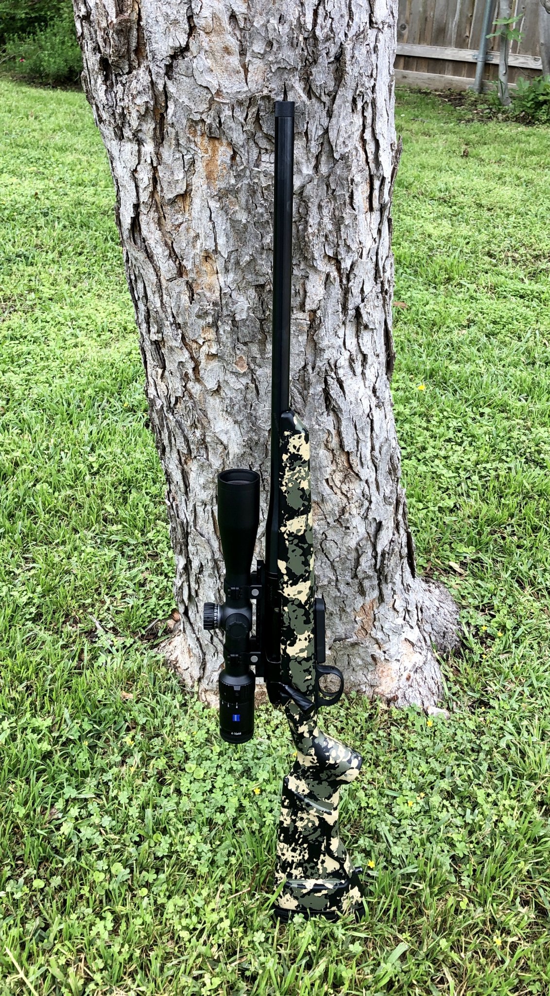

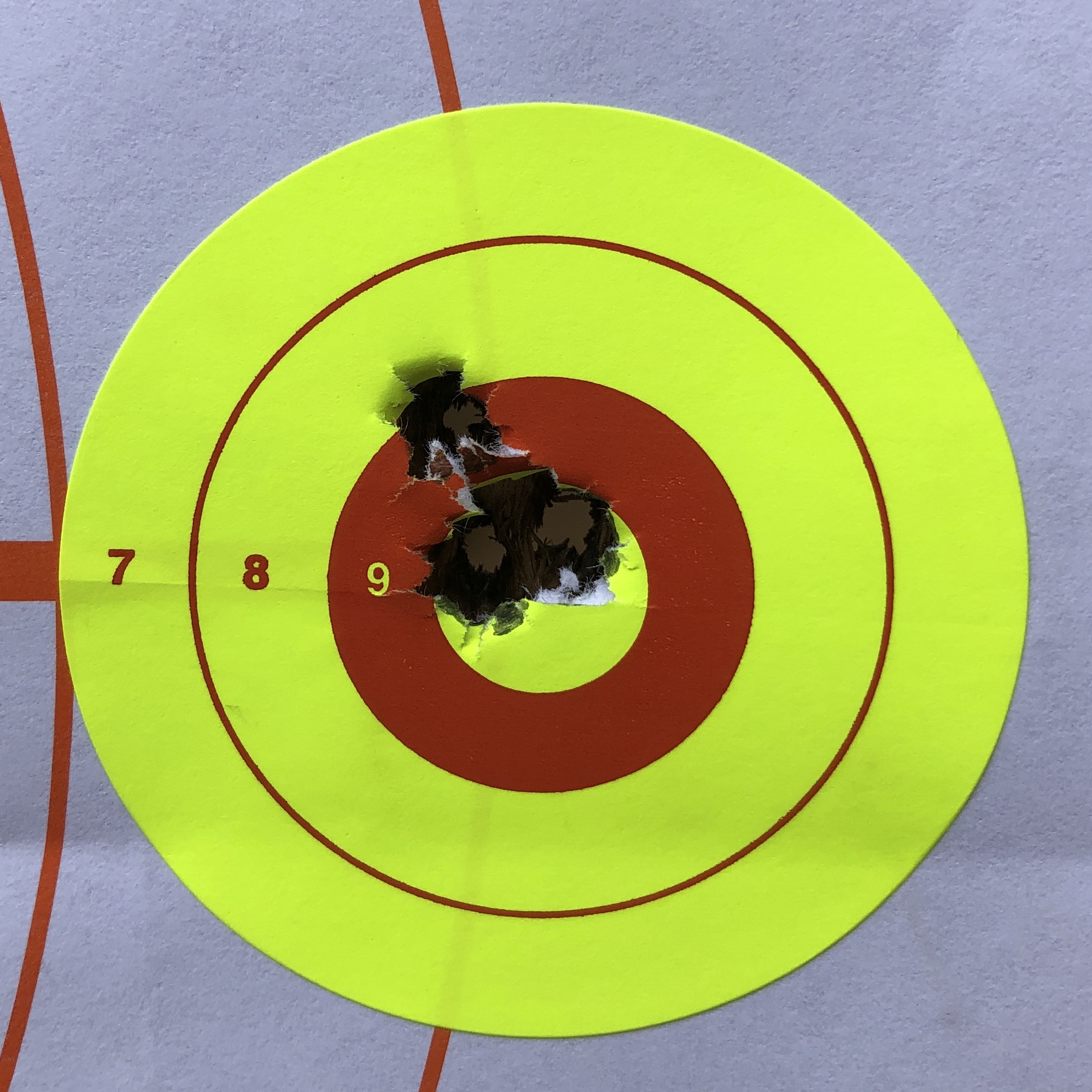

I’m very happy with it especially in bolt action form. 85.5gr Berger Hybrids, 80gr Berger Fullbore, and 90gr SMK’s have all shot exceptionally well except the ELD-M’s of all weights have been difficult. I think annealing every time after sizing has helped.

Finally go out yesterday to continue my testing with CFE223 & the 80.5's. Looks like 26.9gr of this powder is the winner. But that's .2 gr over max per Hodgdon.
26.6gr is what got me my best.

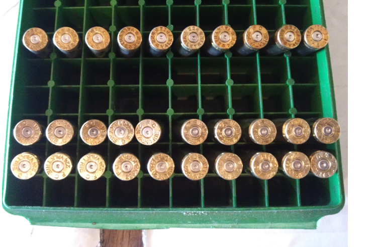

Loaded up 25 rounds @ 26.9gr and [email protected] of CFE 223 using some once-fired Federal crap. If these loads prove out to be the ticket in my gas gun, I'll take some new Starline and see how many reloads I can get. Plenty of extra case capacity but don't want to push it further. I have the gas system perfectly tuned which helps.

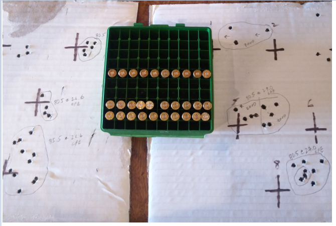

The groups on the left were shot using the Rainer (after zero) and groups on the right using my PSA while zeroing. Range was just under a 100 yards:
Nothing to write home to mom about but 5 out of 10 shots using the 80.5' sat 27.0 gr shows some real promise (lower right group). 5 of the 10 can be covered with a dime. Only loaded up 10 just for this quick test. Going out again this week (alone, no distractions, no kids, and shoot off a real bench instead of a card table!) to test against 26.6 vs 27.0 grains. I'll also chrono.

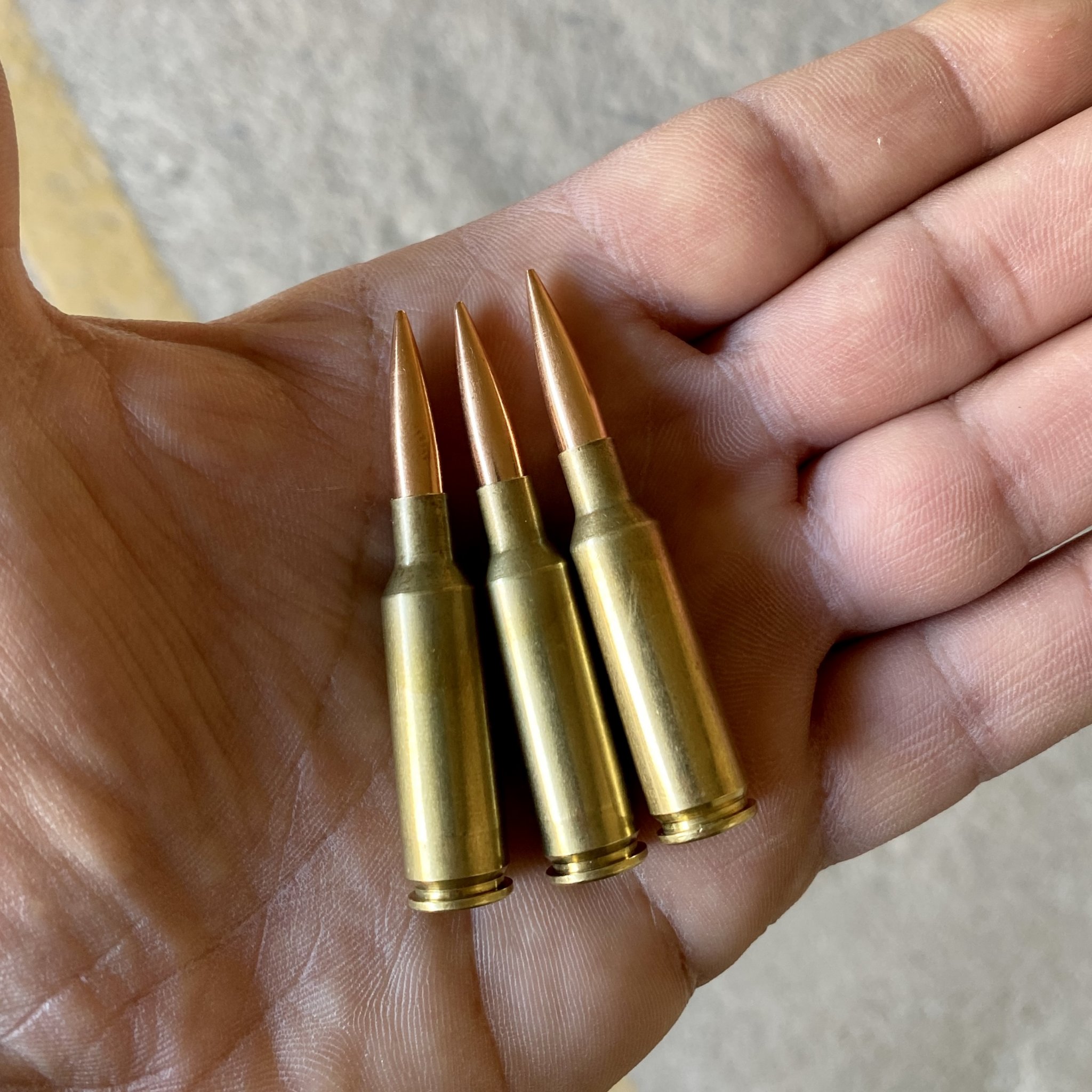

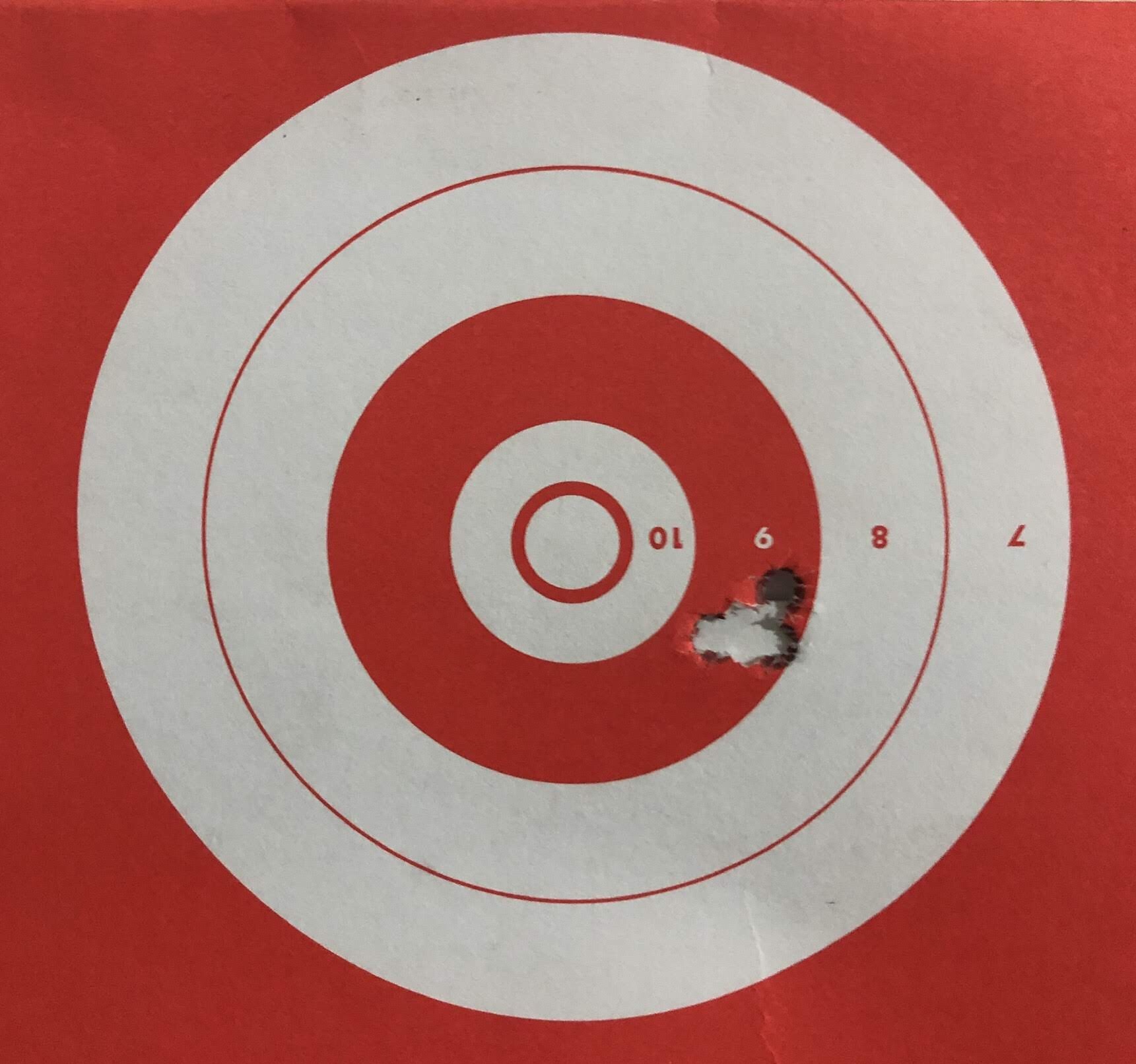

Yup, that’s what I settled on for my bolt gun. 26.6gr at 2.260”, as for the 85.5gr I found they only shoot well loaded at 2.37” with 27.5gr of StaBall 6.5 and actually the federal brass has been the best for me after FL sizing, flash hole deburr, trimming, and ANNEALING EVERY TIME because the FC brass has the highest case capacity letting me run the upper node and higher than the 52k psi of the AR. I push the 85.5gr to 2800 fps from a 22” barrel with no primer pocket issues but that’s also due to the fact the action stays closed after the shot keeping the case rim flush and locked against the bolt face.

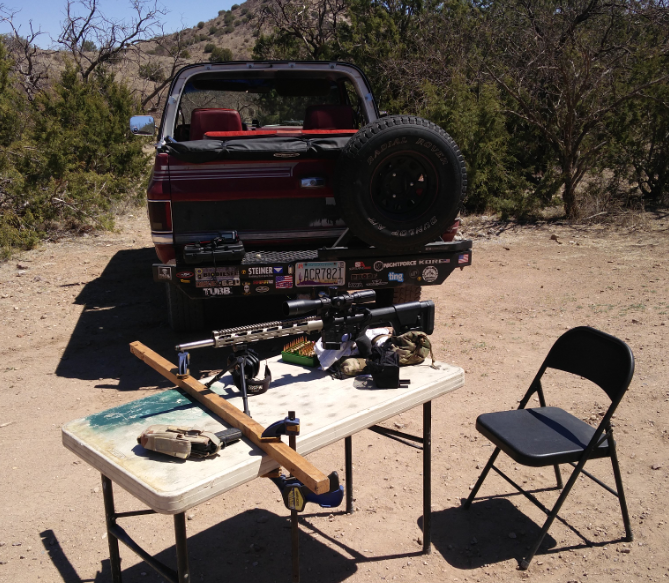

Pretty close, maybe .1 left more. Need to get to the range as this card table is not the best:

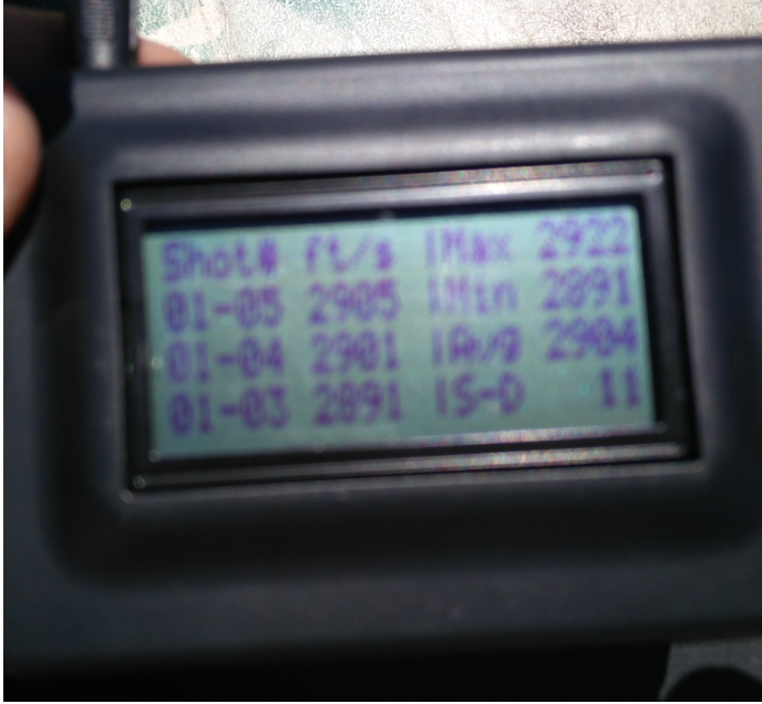

Only chrono'd one, five-round group but pretty darn happy with the speed:
