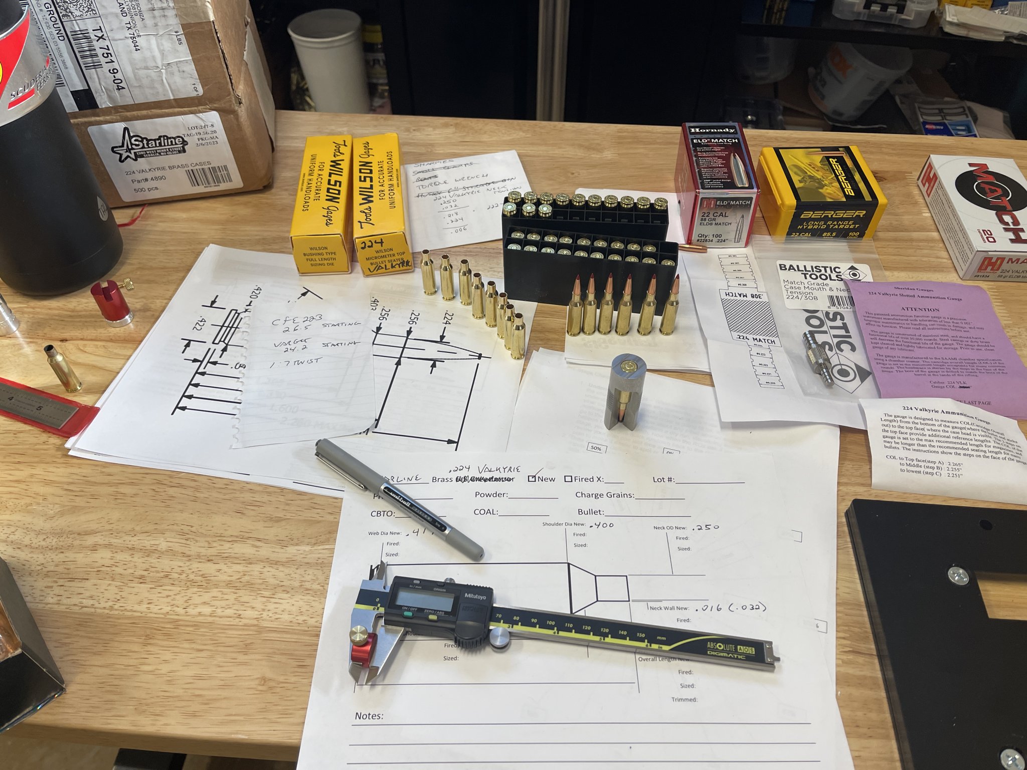

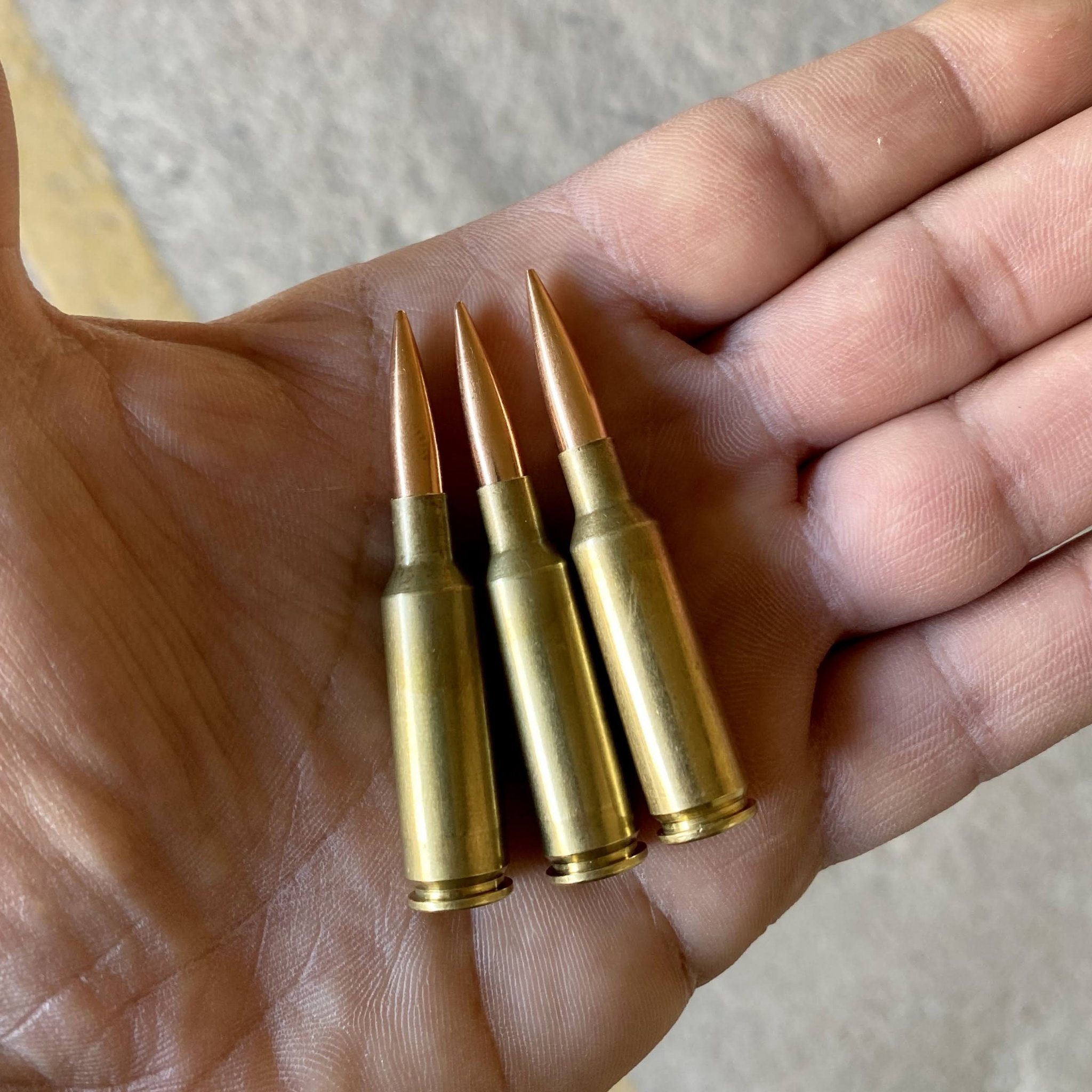

Got my Starline brass in today. Going with both 88gr ELD-M and 85.5gr Bergers to start and will try 2 powders.
Starting off with 26.5gr for CFE223 and 24.2 for Varget. This is in a 26" 1:7 twist. Those should be relatively safe to start increments of .2 with.

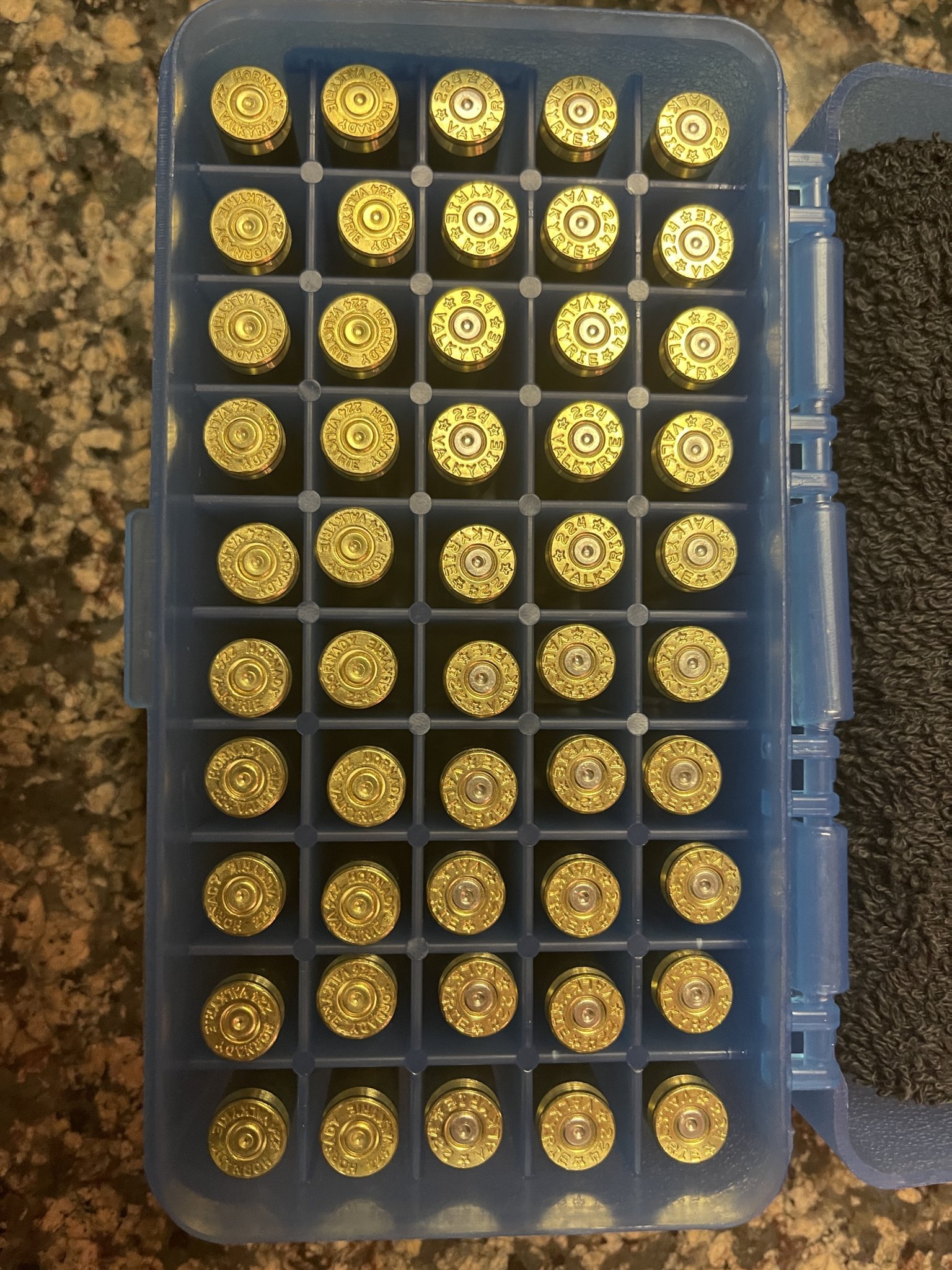

Got some new starline brass in. Took 24.4 out for a spin and came up with this with 5 at 100.
it shot nearly the same at 600... 3 into 1.5" this time with two droping low to make 1 moa total. I'll try it again with once fired now and also 1/10 more and less grain of powder.

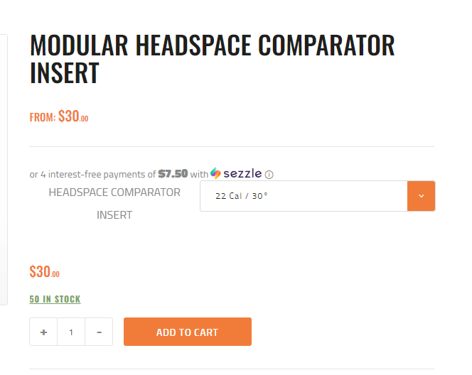

Just now realized I don't have a proper shoulder comparator for the .224 Valkyrie.
Does SAC make one?

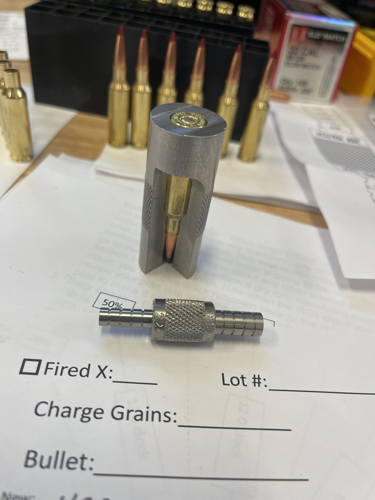

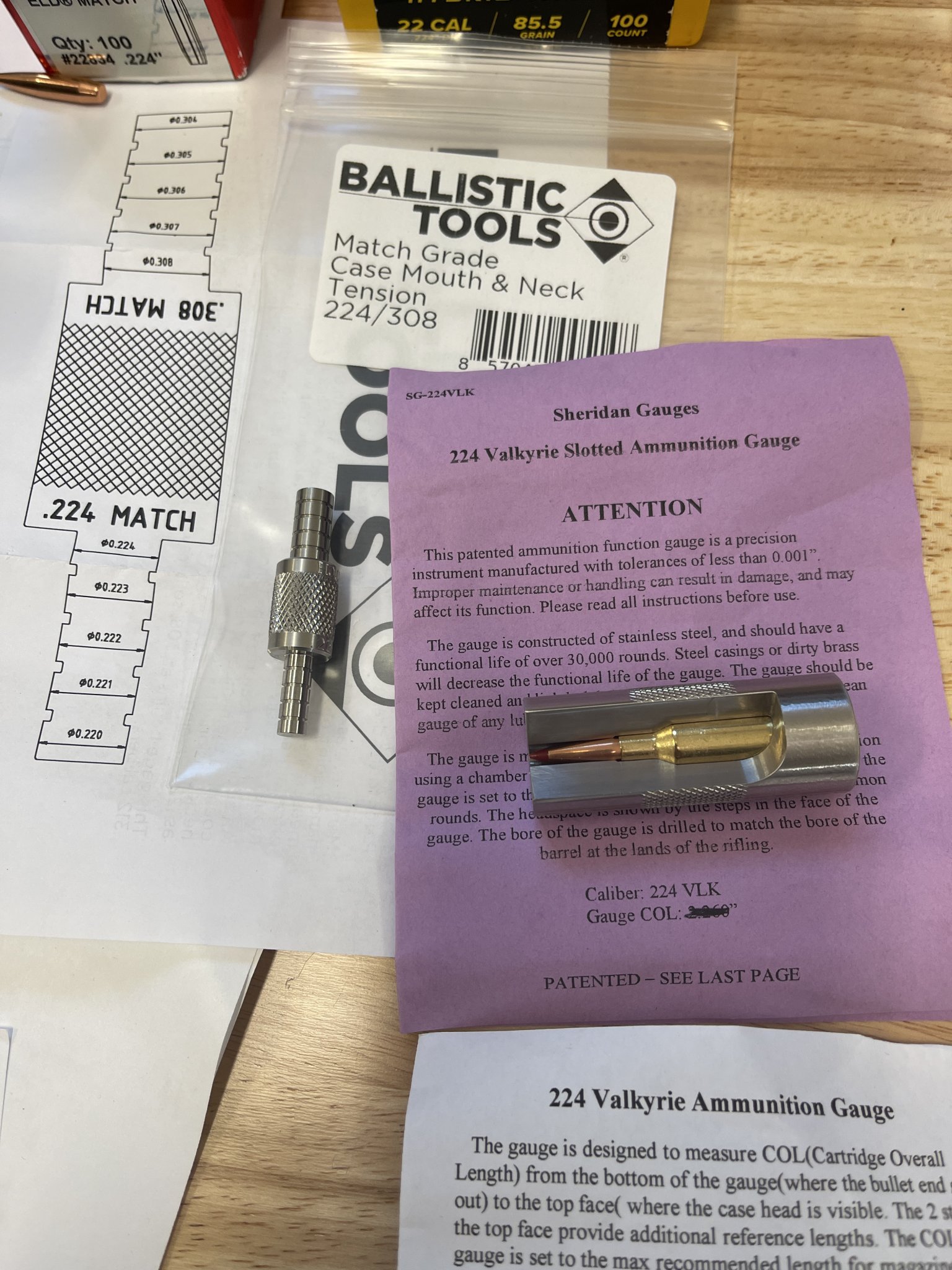

So far I have used the 21st Century Black Nitrided expander mandrel (worked amazing), chamfered and deburred, and was about to install primers, until I realized I don't have the correct shell holder for the priming tool.........bummer......should arrive Sunday.
What I really found helpful were these cool Valkyrie tools.

I did a full development load test yesterday. Tried both Berger and Hornady bullets from 24.2 up to 25.1 gr of Varget.
After that I much preferred the Berger results from the first test, and overall feel of seating from them, that I went back that evening and tested the 85.5 from 25.2 to 26.1 gr of Varget. I will upload the Chrono info and review in more detail the results and where I want to go next later tonight or tomorrow. I'l really liking what I'm seeing so far.

Not a single extractor mark or issue with primers with a top load of 26.1 for my testing. It was creeping up there in the possible compressed area, but I'll leave it there for now. I was more pleased with the 85.5 Berger smoothness of seating, all things being identical.
I've decided I'm going spend more time group testing 26.1gr and 25.5 grs of Varget to play around before I settle on a final.
My top speed at 26.1 was 2878 for both rounds, and for the 25.5 it was 2844fps. I'll load up 10 rds of each and see what happens next.
There is some Factory Hornady 88gr Match in there I used to warm up the barrel and get it ready for the load testing.

Right now I'm slightly past SAMMI by 0.13" with a COAL of 2.390". My jam was 1.888" and I seated CBTO at 1.838".
I ran about 50rds with those specs with no issues at all.

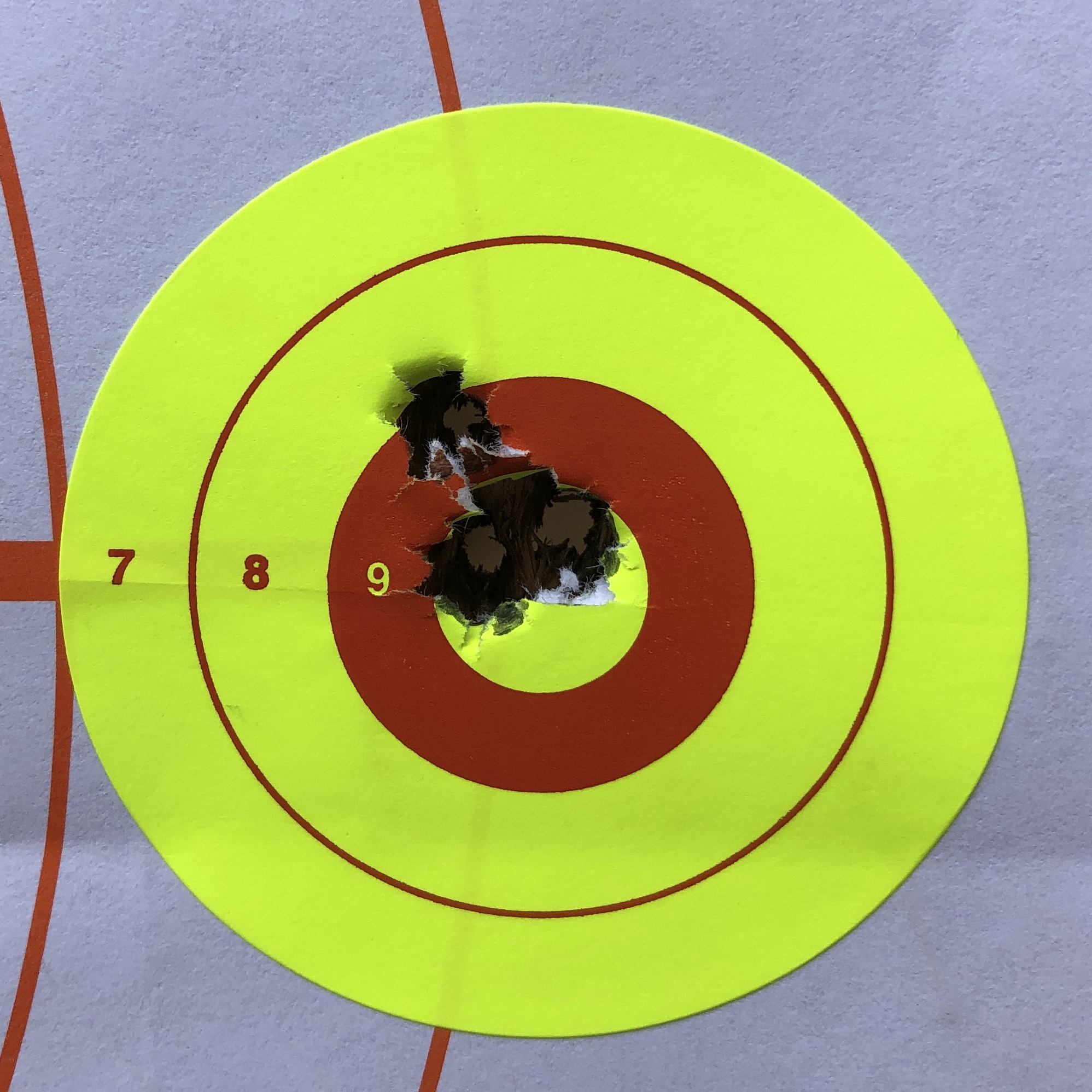

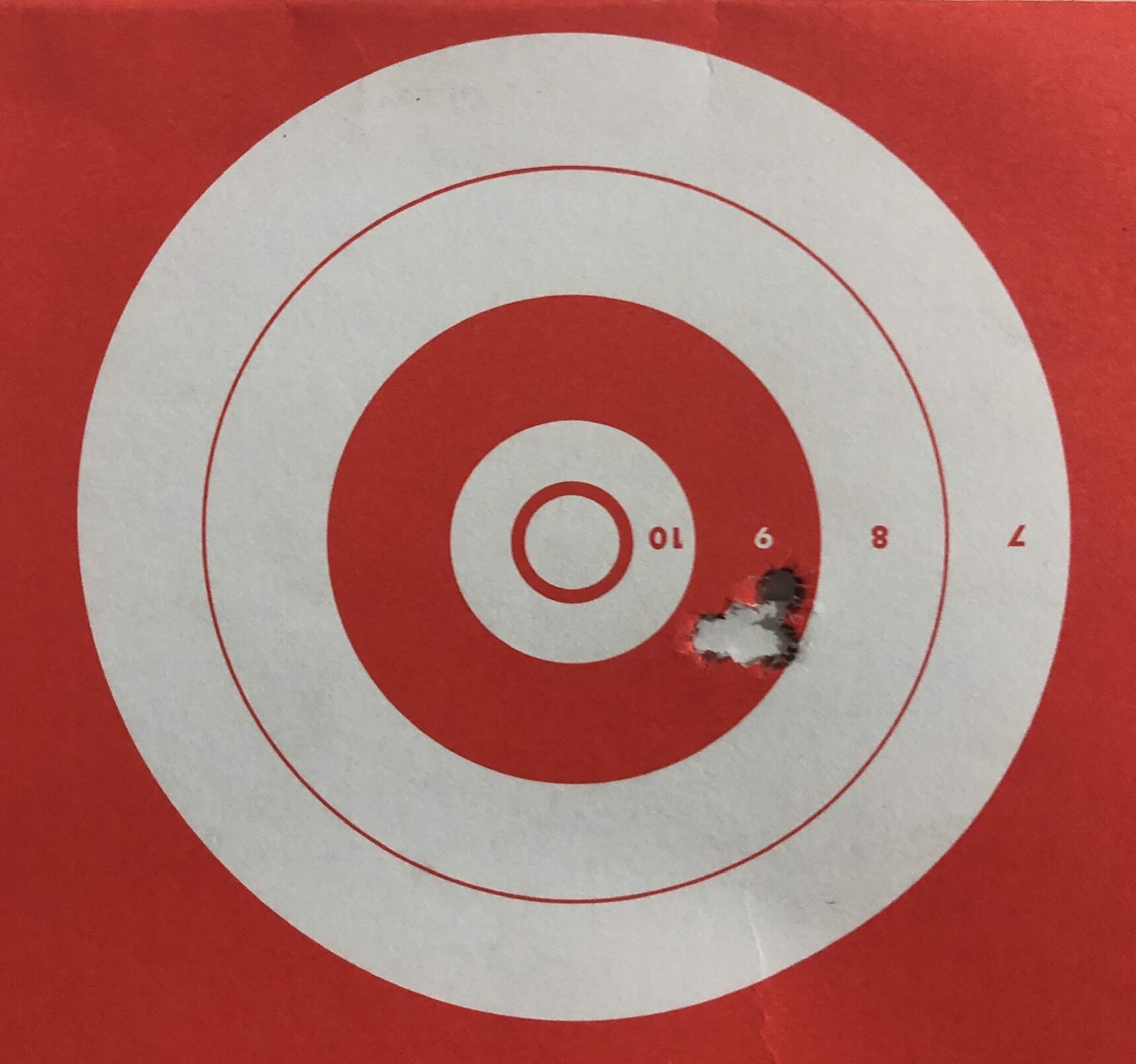

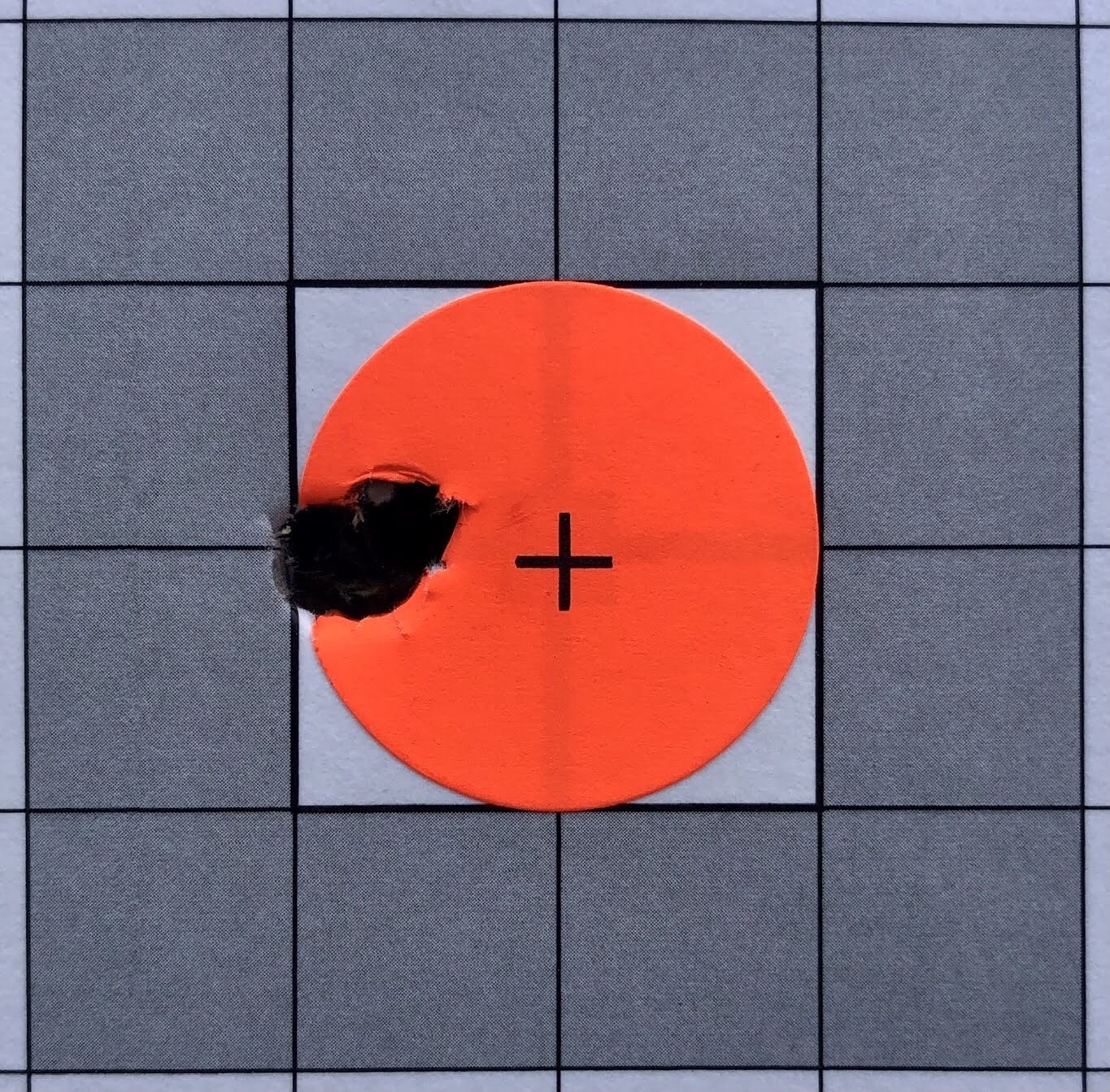

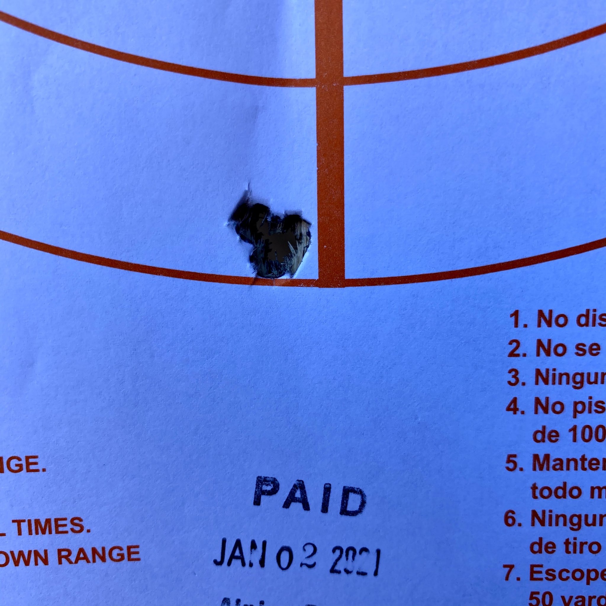

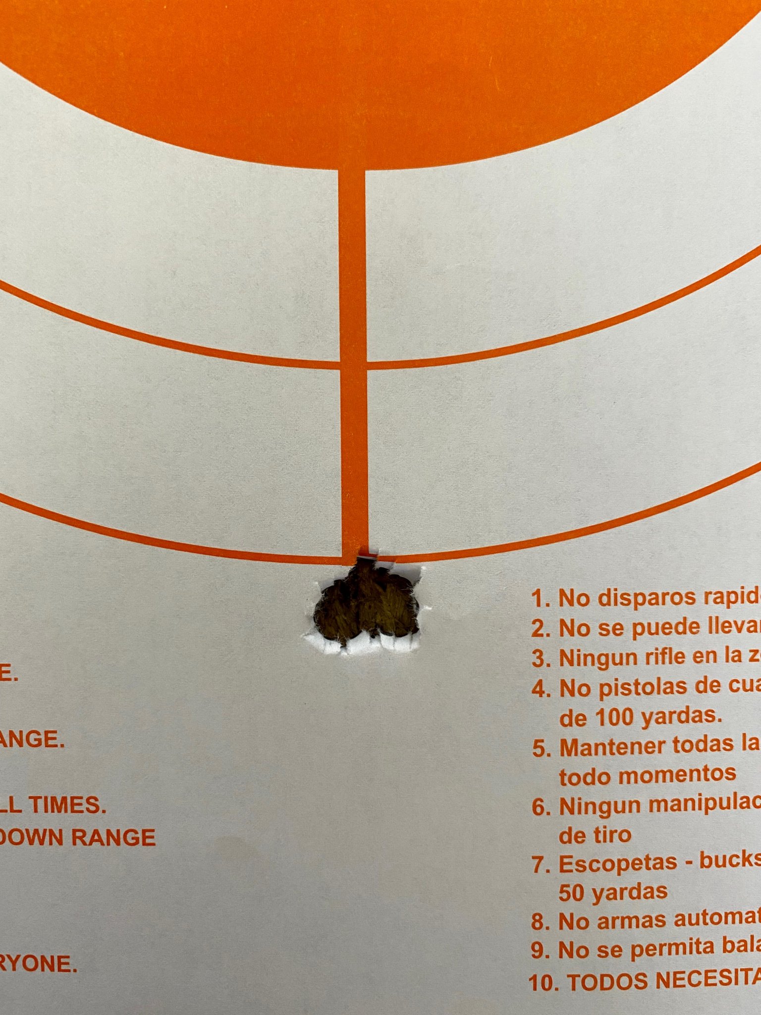

80.5gr Berger Fullbores shoot 1 hole @ 100y for me in a 20” JP gas gun barrel with no pressure signs. I have a 22” 1:6.5t on a Bighorn Origin that I run 85.5gr Berger Hybrids at 2767 fps with 2.32” Coal that also shoot sub moa. The loads below are for the gas gun and all shoot submoa in a 1:7t
I cant even remotely push a 223 Wylde or a 5.56 chambered gas gun that fast in a 20” running anything as heavy as the Valkyrie without toasting the brass. I think if you like running .224 caliber bullets routinely passed the 500y mark in a gas gun, the Valkyrie is a good option if you get your reloading on point. Definitely anneal, it’s dropped SD’s into the single digits for me. These recipes below are all gas gun only loads. FC brass has the highest case capacity but tend to suffer from loose primer pockets if they’re run in an over-gassed gun.
You can get around this with CCI41 primers when they start to loosen up. The Hornady brass has been the most consistent for me.
80.5gr BFB, 26.6gr CFE223, Hornady Brass, CCI400, 2.260” (1.8” BtO)
88gr ELDM, 26gr R17, F205, FC(a), 1.717” BtO (2.270”) 2590 fps - submoa
80gr ELD-M, 26gr R17, FC(a), R7.5, 1.724” BtO - 2702 fps ES 18 SD 7.9 - submoa
80gr ELD, 27.4gr H414, FC(a), R7.5, 1.724” BtO - 2707 fps ES 16 SD 6.3 - submoa

Are those groups from gas guns or bolt? I've had the same experience trying to find good loads for that caliber as well. I like the round, but it sure makes you work for consistency. I finally got some loads to shoot under 1 moa, but none shot into 1 hole like yours.
I'm getting ready to build another one. with what I hope is a much better barrel, so we'll see how that works out.

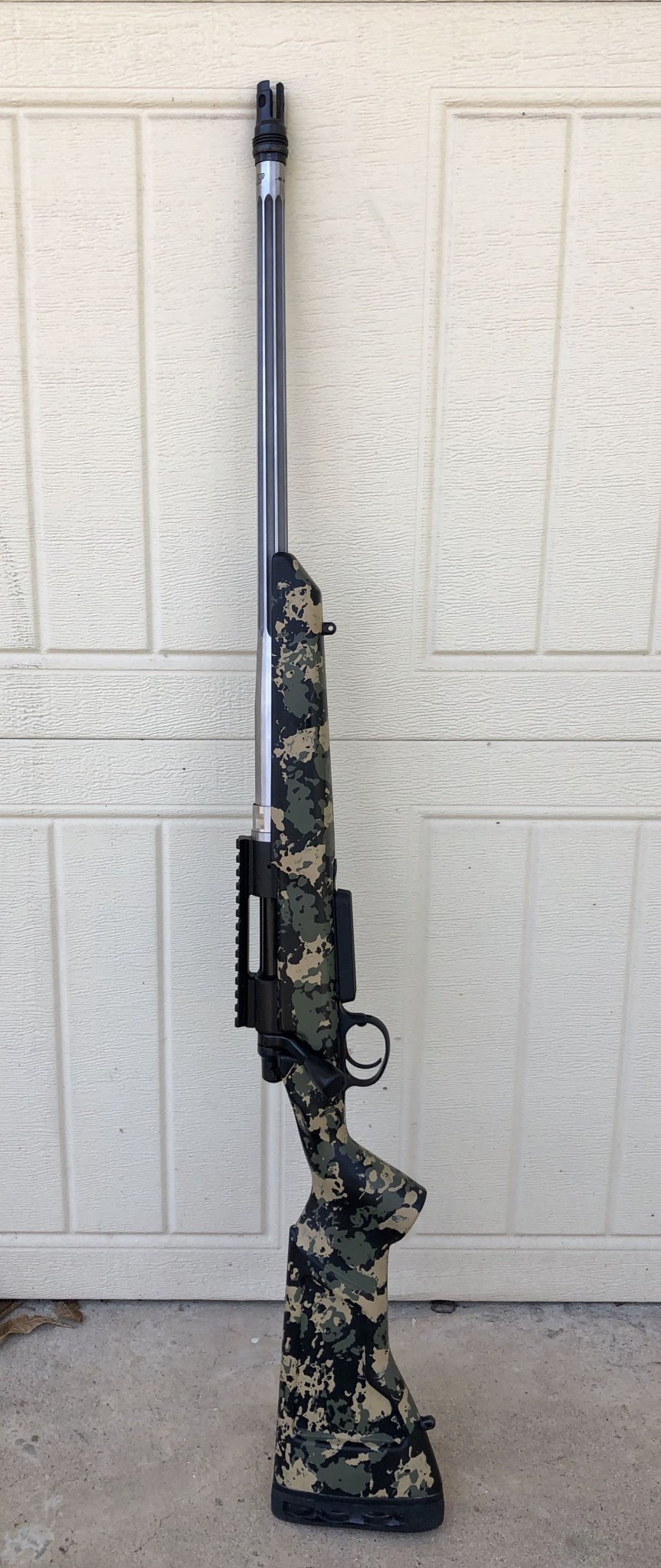

Never mind, I just saw the pic of the rifle. I think the heat is getting to me.
The only one thats the gas gun is the 80.5gr Berger Fullbore and its the one on the little Orange dot. The rest are bolt gun. The gas gun targets are hovering around .7”

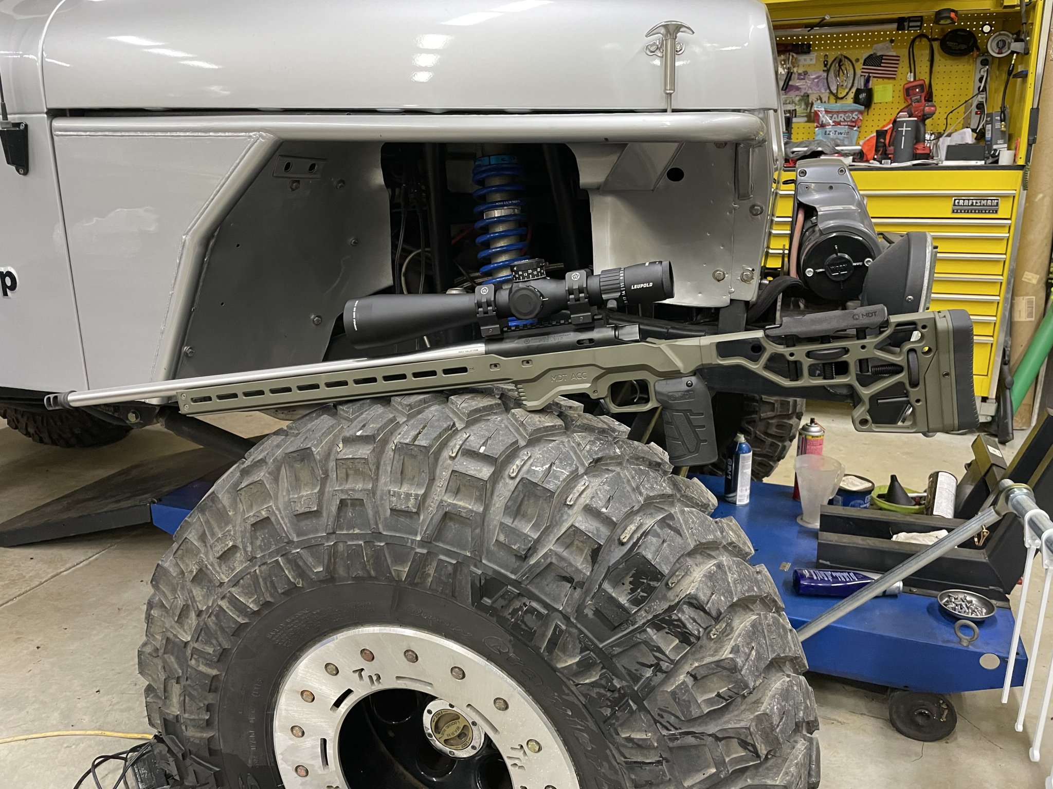

Love the camo job. How was that accomplished?
