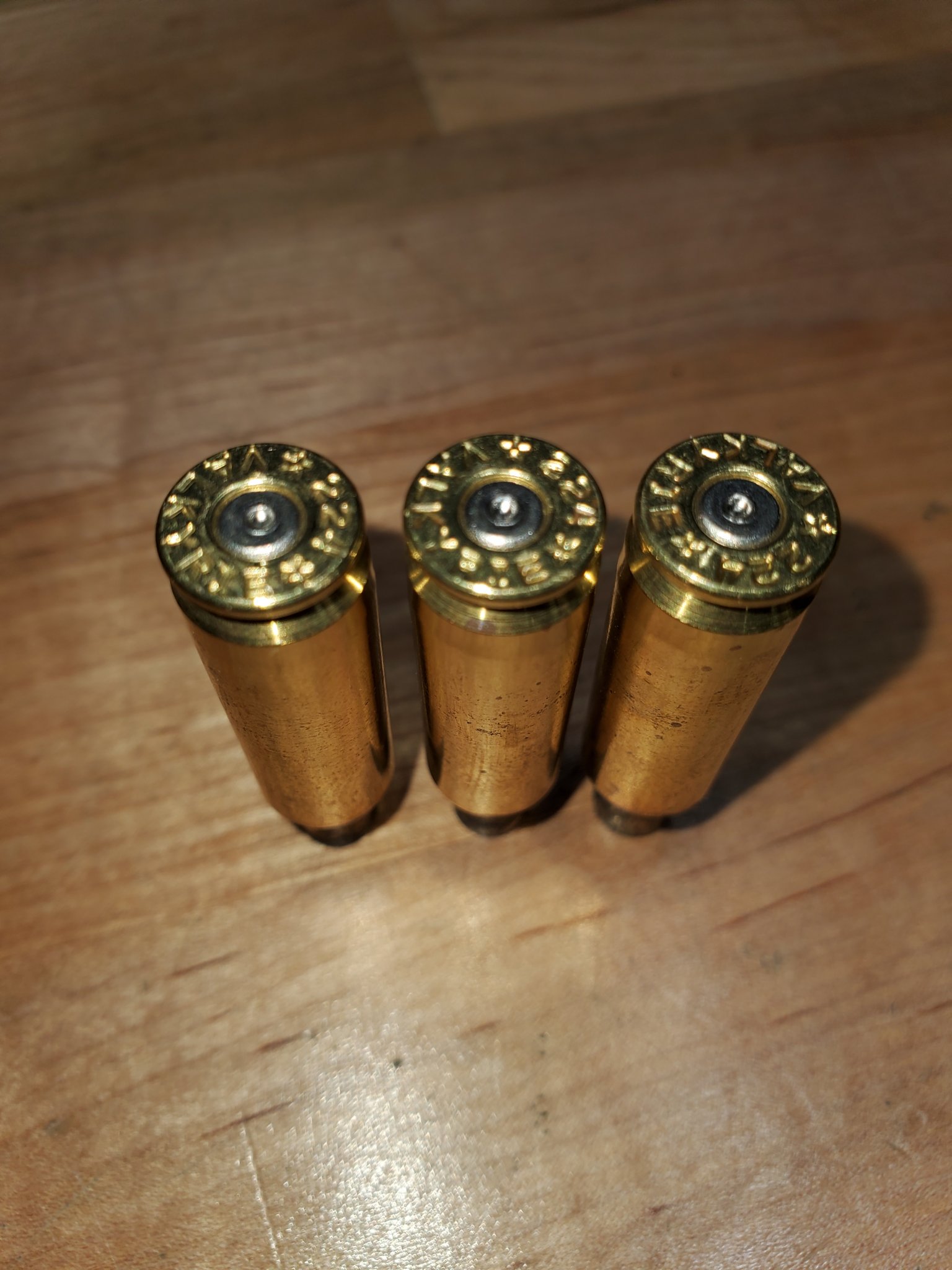

As a first adopter from 2018, was truly surprised seeing the first 3 - 90 SMK go into an oval at .163 MOA with the WIN 760.

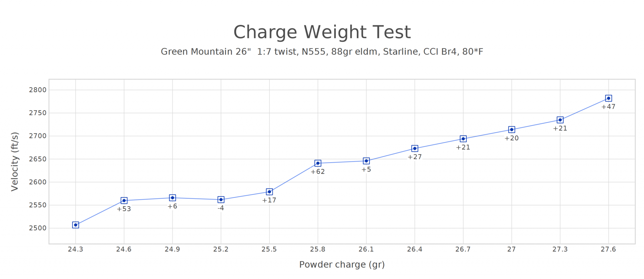

OK, I got out with the N555 on my lunch break and decided to spend these 88gr eldms on some prairie dogs. If the goal was 2900fps then this powder isn't the best choice. Absolutely no pressure signs so I'm tempted to cram more powder in there maybe 28gr +

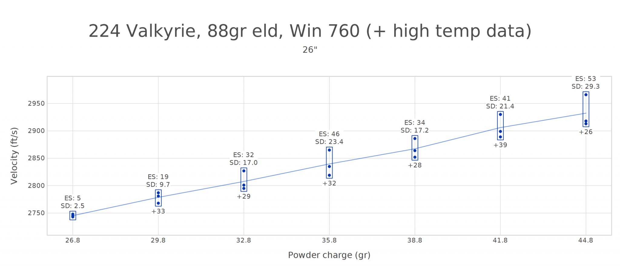

I got a sheep tag so Valk is on the back burner for a bit. I don't feel bad about it either 😏
Between strings 2 and 3 I decided to shoot the handgun some to let the supressor cool. I forgot to hide the mag in the shade and the colorado sun cooked that thing. Thought it was worth shooting still just to see if the speed was worth the trade offs in temperature stability.
Once again. My barrels happy spot is 2750fps.

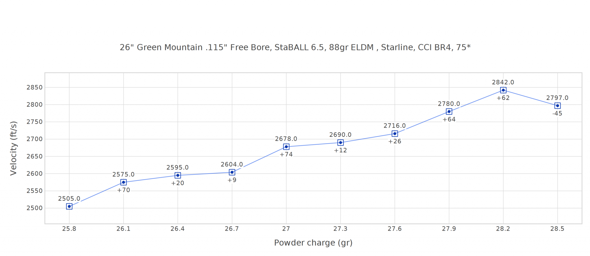

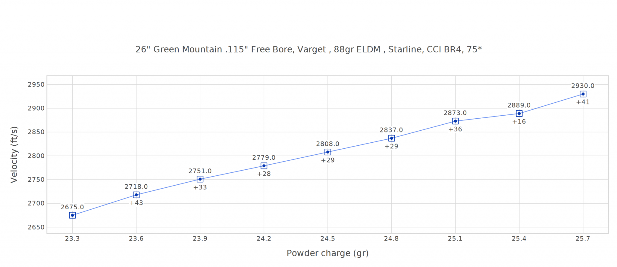

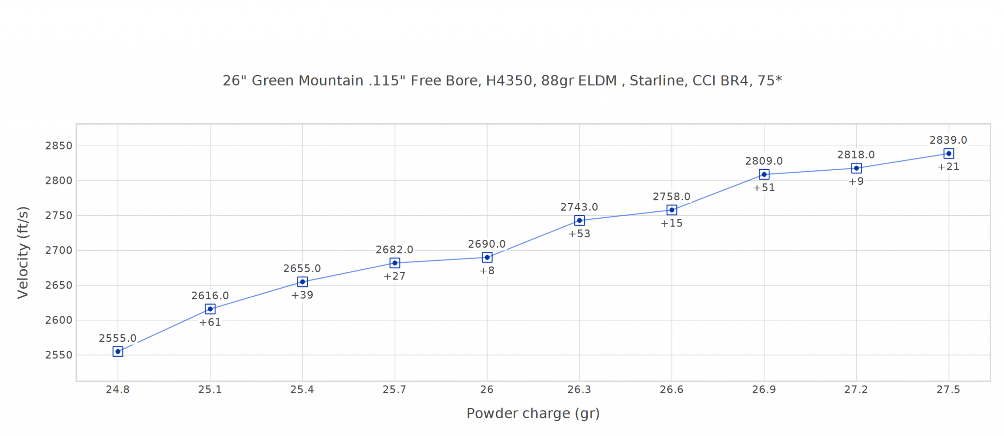

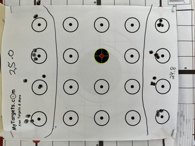

Varget hit pretty hard pressure signs at 25.7 so I stopped, not sure what happened with the last shot with StaBALL, h4350 was just starting to shot the ejector on the last shot and IMR 4350 was beyond packed in there. I may play with IMR4350 more just because I have so much and its easily achieving the velocities I've already been using.
Shot today at Bang Steel in Wytheville,Va. Ran the 85.5 Bergers with 25gr of Varget. Temps in mid 80’s. Alt Dens was around 4200. Wind would come and go at around 7-8 O clock to the line and speed anywhere from 0- highest I saw was 4.2. My personal best was a target today at 1040. Rules of engagement on this target was 5 shots, and you had 20 seconds for all five from your first shot. This was the last target in the series of 6 previous targets. Not a fan of cranking out 5 shots in 20 seconds after shooting about 15 prior, but hey, it’s Valkyrie baby! I hit 4 out of the 5. Closest shot today was around 430 or so I think and longest was 1200. My biggest disappointment was the 1200. It was a 2/3 IPSEC torso I believe, three shots, no indicator light. I think I hit it at least once out of three, but no joy on the call. I think this is the price we pay for the Valk at longer range. No big deal as the match is more bragging rights than anything, but , the asshole that went to the match with me beat me by one target to take third place. LOL! 14 shooters today, no one brave enough to try the Valk. Most were 6.5 Creed. The guy who took third was shooting 6GT. Great round, and he is a good shooter. Beauty of the day was that I was able to spot hits and misses(except the 1200) , make corrections, and rock on. Wind played little effect today. Most I held was .6 at the 1200, and the rest were .2 or .4 making center hits. DOPE from Kestrel AB was spot on as far as elevation. And I entered the info manually. Have learned not to use the AB bullet data….but that is whole nother discussion.

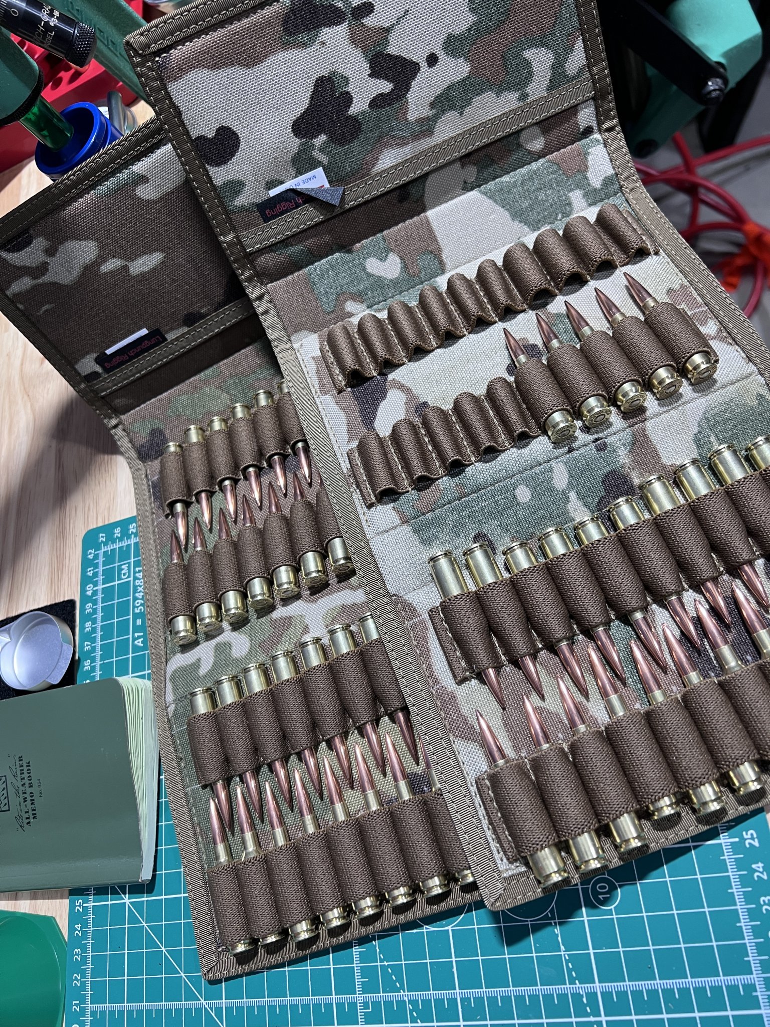

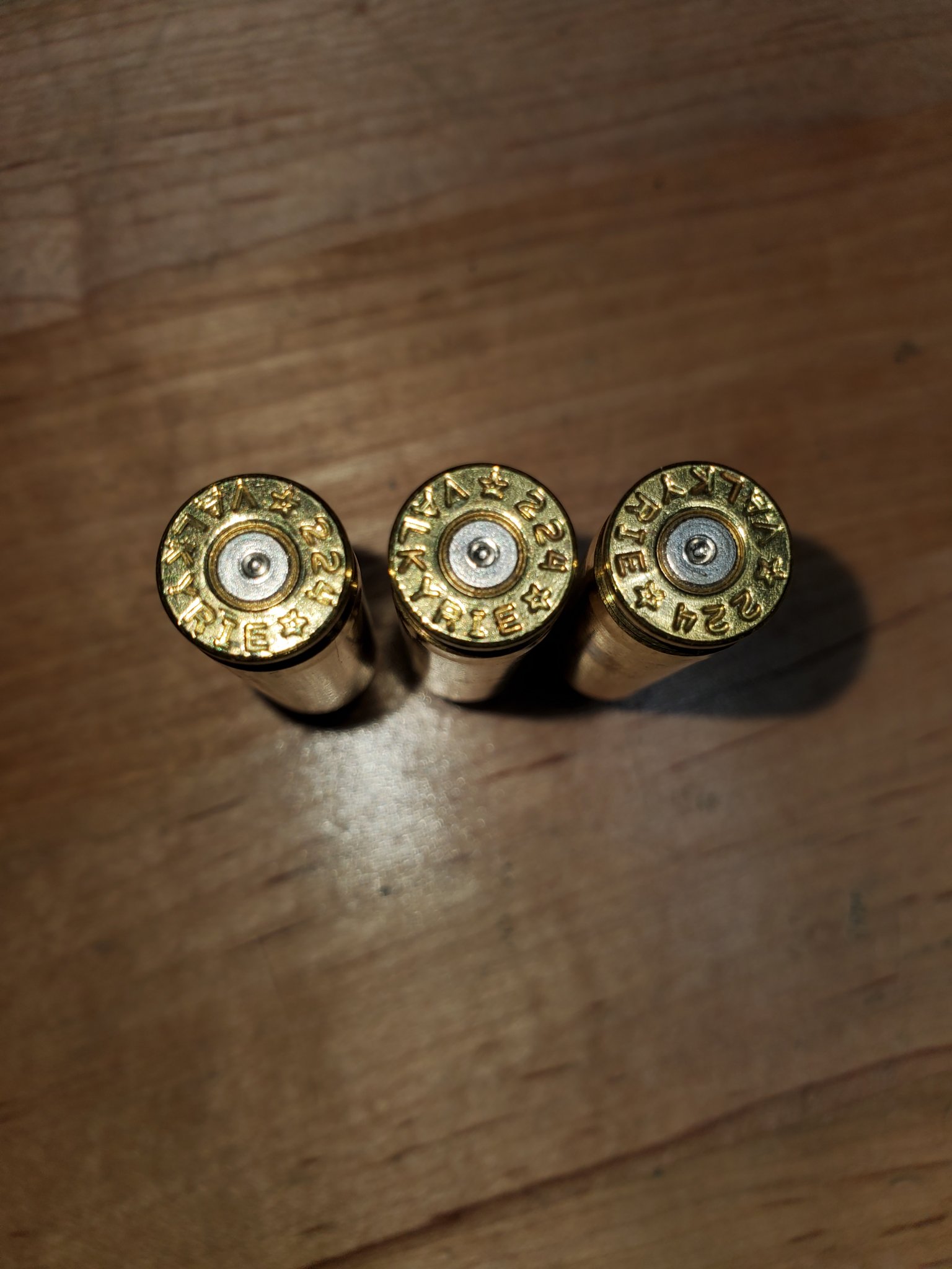

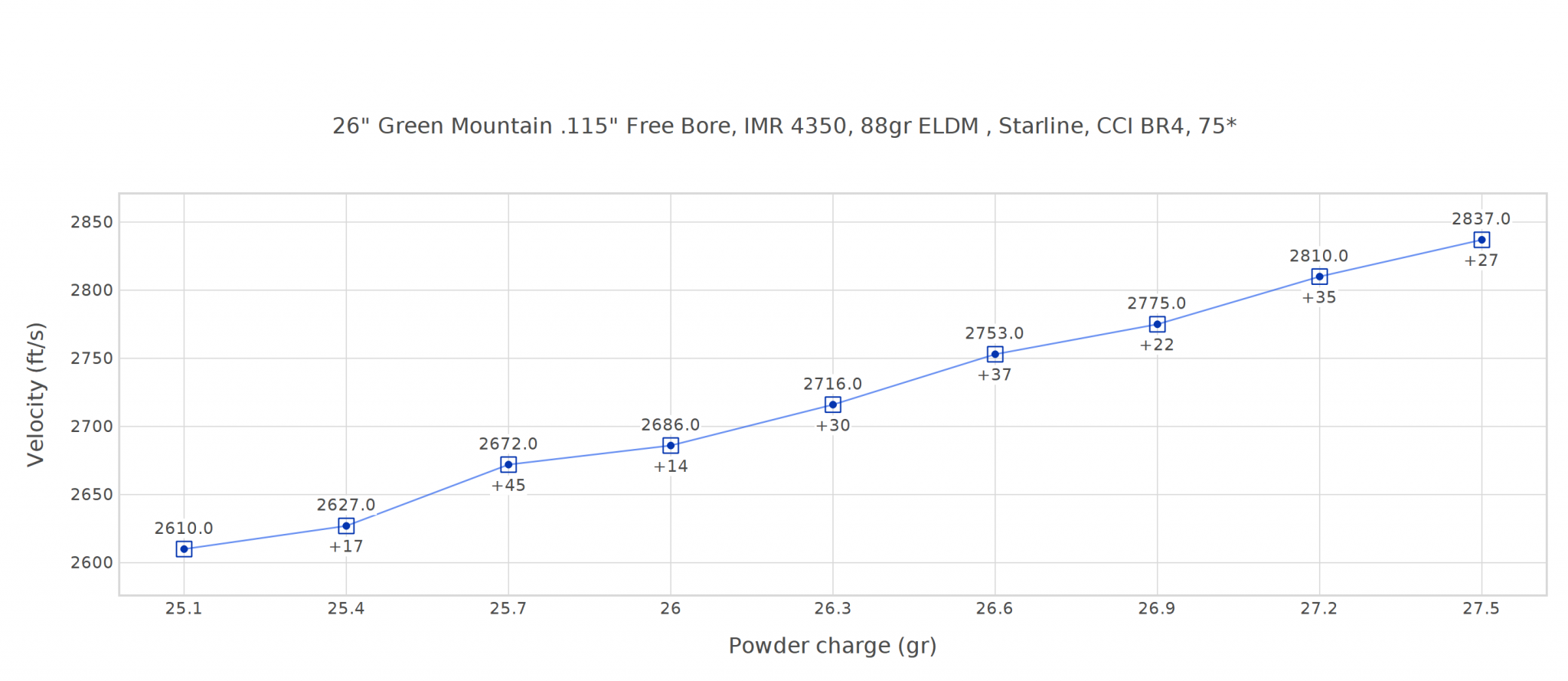

Not advising others follow this road, but I’m doing some load development with starline brass, h4895, 85.5 Hybrids. I’m just really getting started trying to speed up the Valkyrie with a little bit lighter projectile. I have had good success with the 88’s at 2800-ish, but felt it was too much of a compromise to the 6mm for competition.
I’ll include a picture of my note card with velocities, but I was overall pleased. I’ve loaded 25 more at 25.0grn that should be at 2900fps. At this speed Im right with the BR/BRA crowd and a lot of the shooters are starting to throttle back their dashers with the 105-109 projectiles. More to come on this, but I think the 85.5’s @2900 are a legitimate option for me.

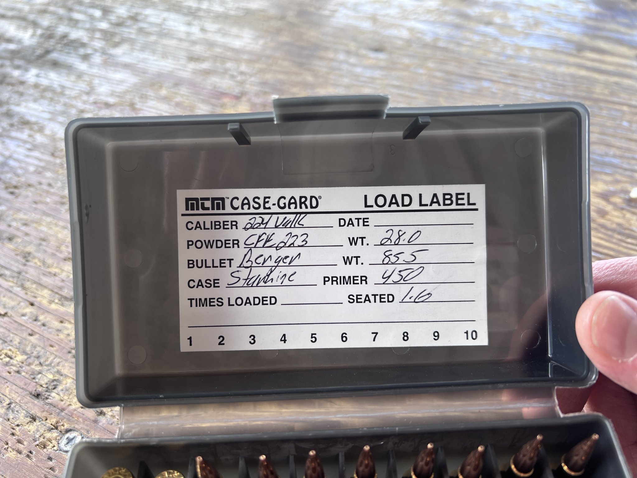

This was my first look with 28gr of CFE223 and loaded to 1.775, I think I can knock it back a bit, and then tighten it up,
I am thinking either 27.7 or 27.5 and then load for accuracy, although I am thinking of using a Tuner and seeing what that does first as I might want to use the Tuner to Tune the Load for accuracy once I solidify my numbers a bit.
The brass looked good at 28grs, but I think I will drop down a tick, it was cooler out and I had one swipe mark

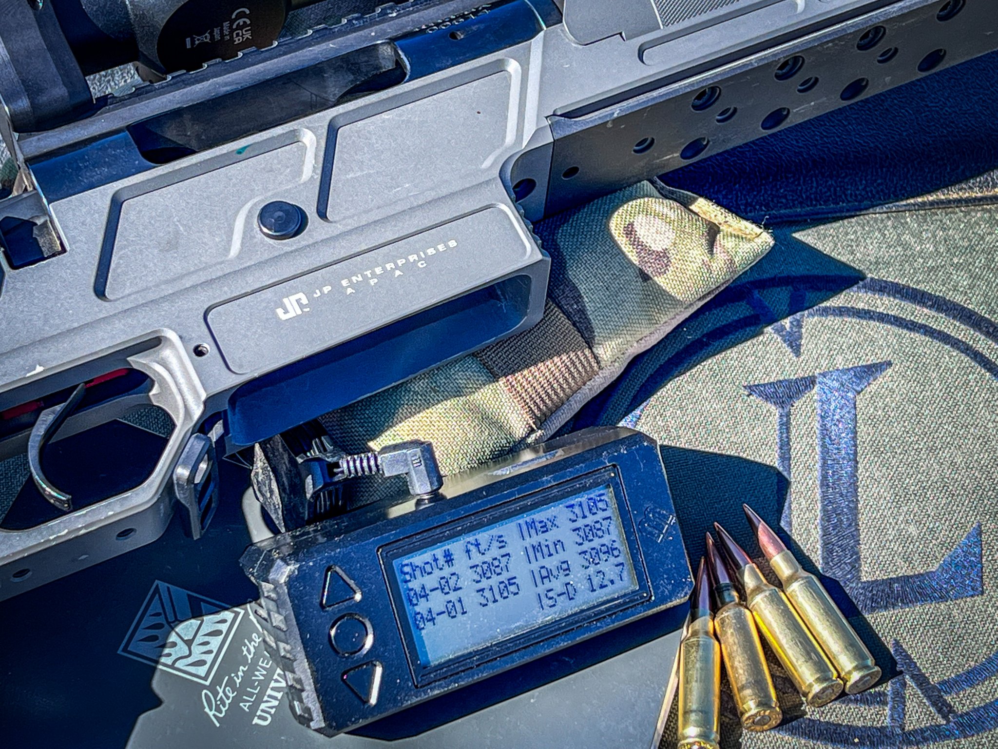

The blue primer is factory 90s, and the others are my reloads, one little swipe and the speeds at 3085fps were faster than I need.
Time to tune up and tighten the load, but at 3085fps I was like 2.5 Mils to 600

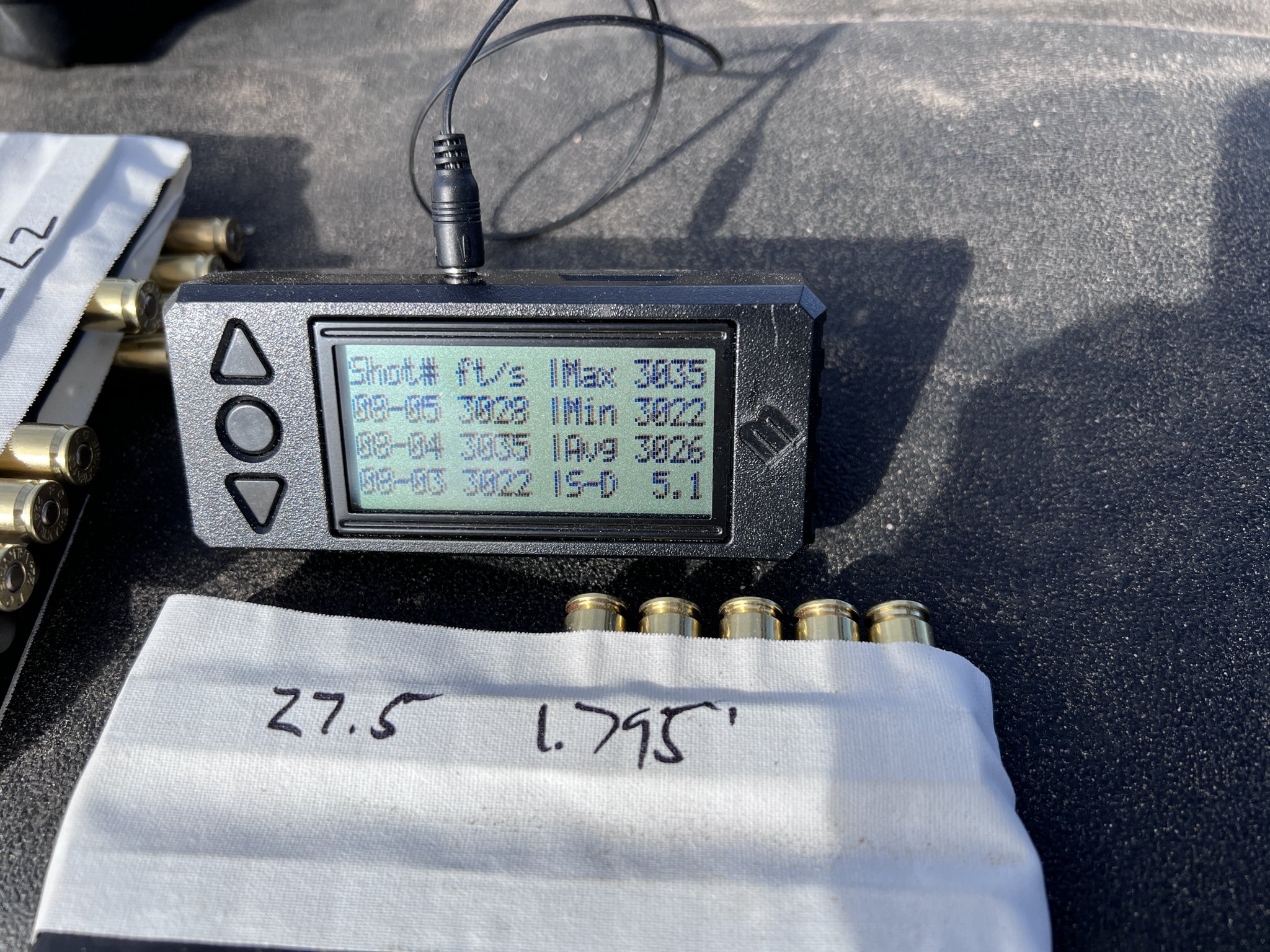

I found my number, the groups were good too, probably not gonna have to tune it with a tuner, it strung a tick vertical on me both at 100 and 600 but it was a solid load
Call it like 4" of vertical, I think I can tune that out, but might not have too, it was pretty good, but I have options

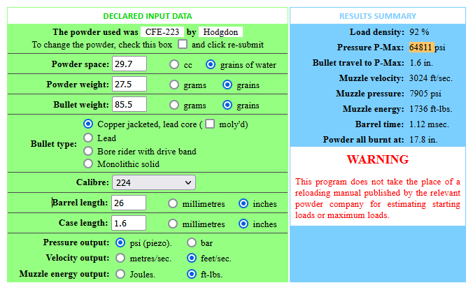

I think I am running to press with this load, 27.5gr of CFE223, 1.795" to Ogive, Berger 85.5gr

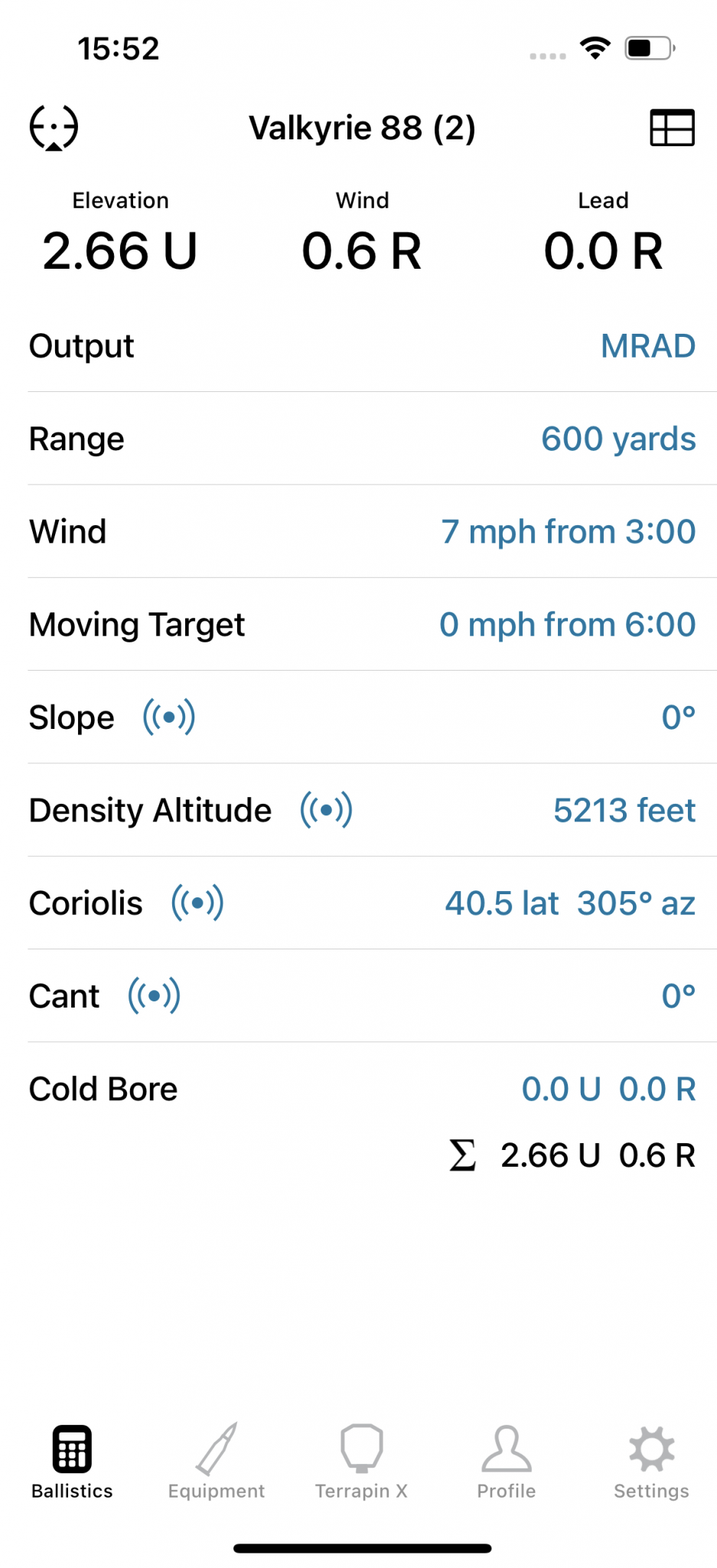

According to the software with this load, and it played out at 600,
65 degrees, 4500ASL, 6000DA
6.9 Mils to 1000 yards
2.8 Mils to 600 yards
At 1000 yards it's a 4MPH Gun and at 600 Yards it's a 7MPH gun as the light bullet falls off

Bit of SWAG on the powder space but lines up in a few ways IMO.
I sorta swagged it,
I had Kevin's starting load, which worked great in his rifle, repeating it, was too hot for my rifle, so I backed off just a tick and then ran 4 sets at different seating depths. Boom, it worked out nicely.

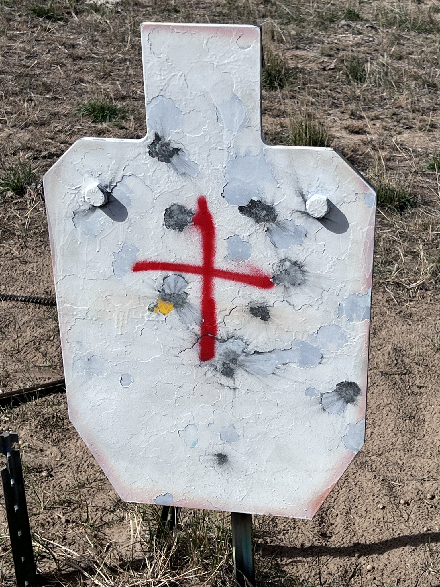

This thing is real now, impacts are visible even at extended distances

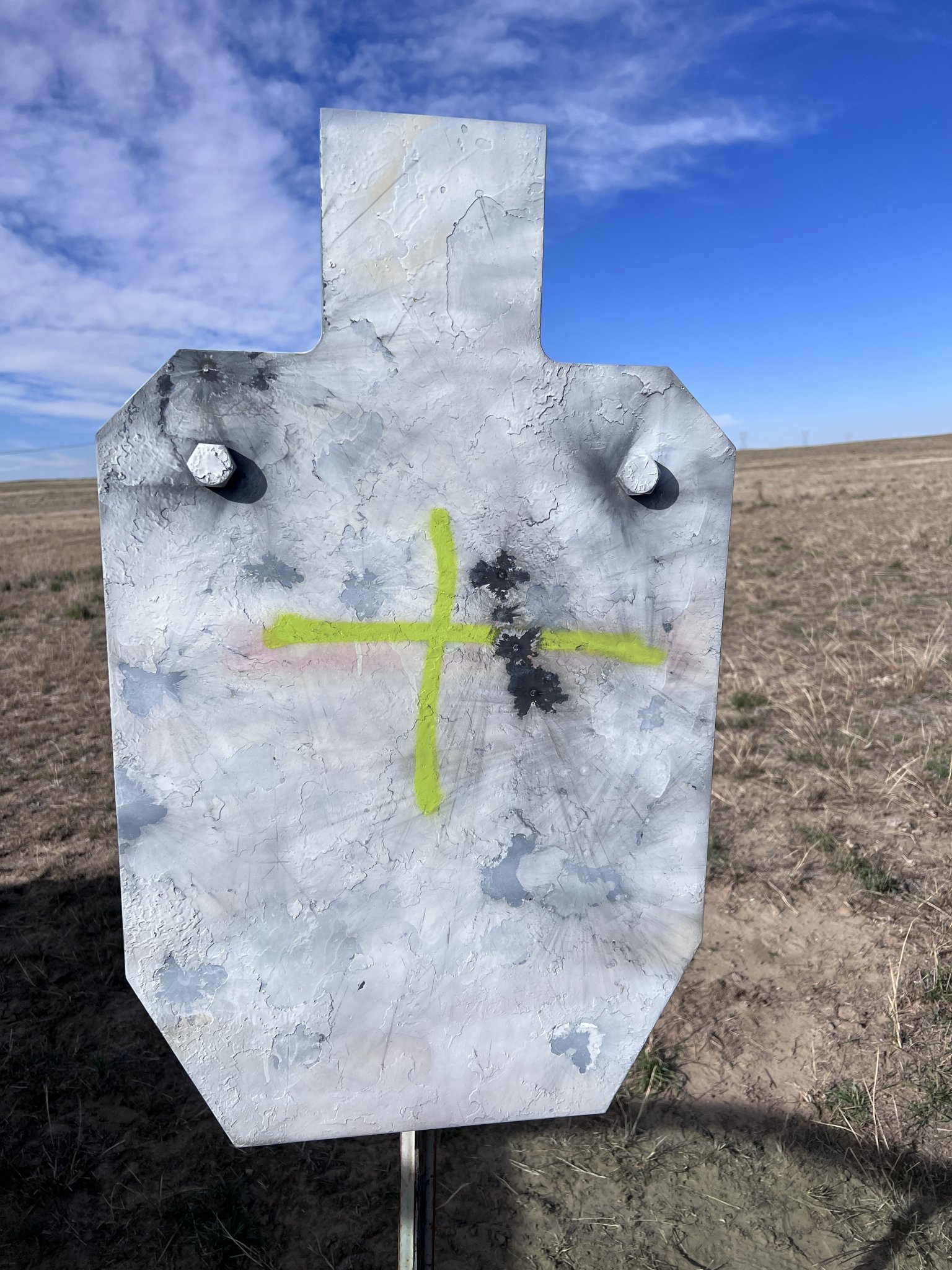

Here is 10 shots at 1125 yards
They were visible behind the rifle and moved the plate.

What's your barrel length? Mine is a 20", I bought some cfe223 and a box of 85.5 from scheels and will be toying with this asap
