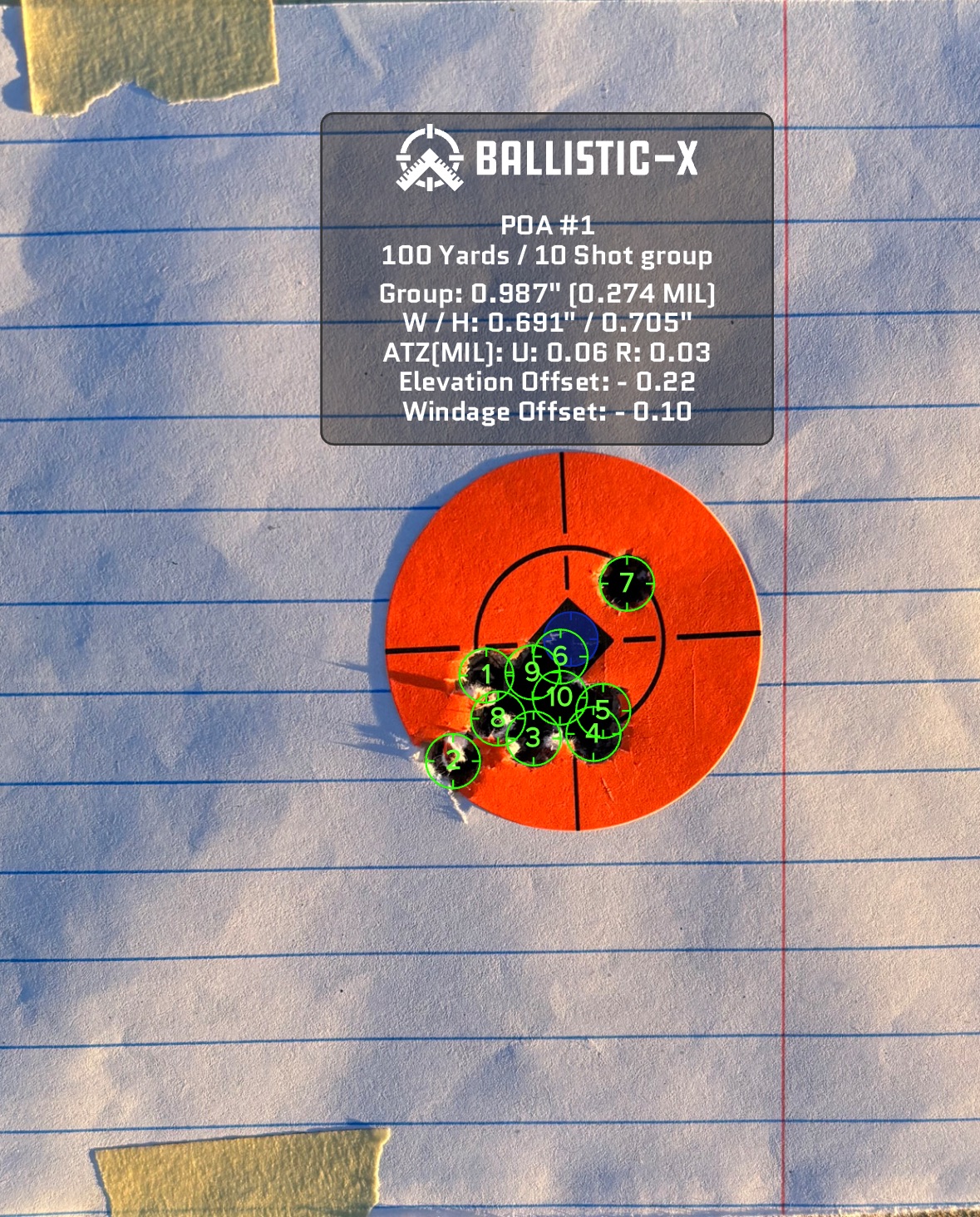

I’m shooting 39grains of N555 with 75eldm, CCI 450, in a 22” 1:8 barrel, Gap Chamber @ 3190.

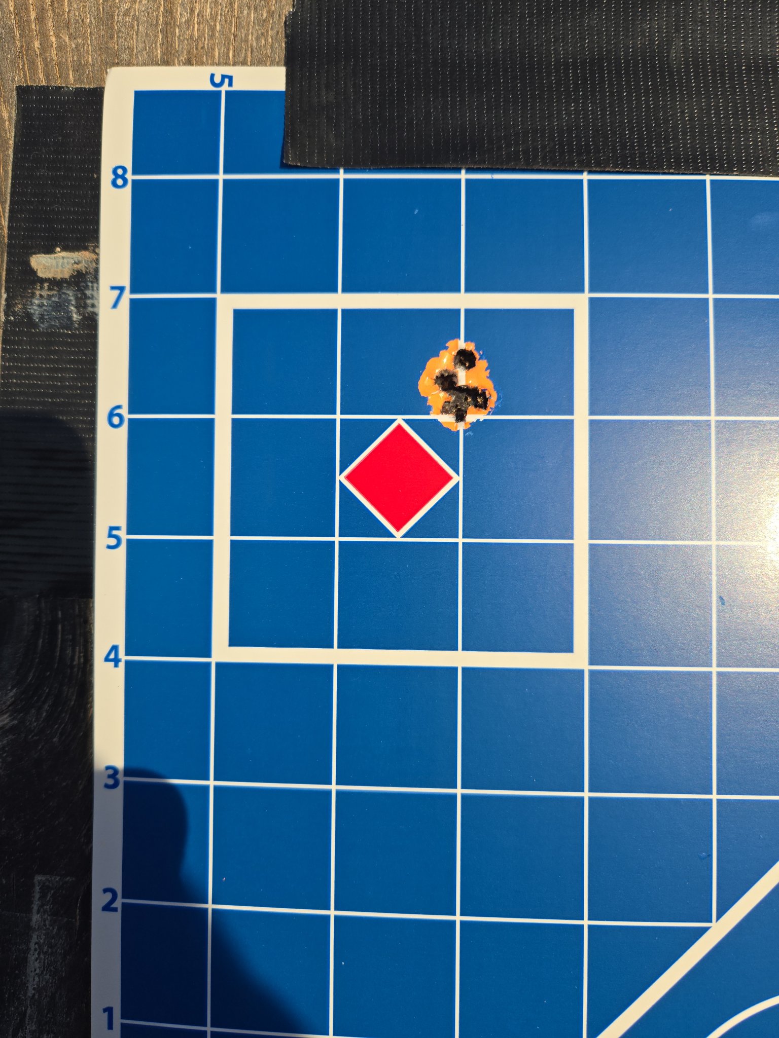

now that I have 100ish rounds down the tube I loaded some rounds down to 37.5 and was not impressed with anything. Went the other way to 40.2 N555 which is very compressed and shot a very nice ragged hole with 4 shots with 5 fps spread. 3271 FPS w 1:8 22” 75 ELDM. Bolt lift is good and no noticable pressure signs.

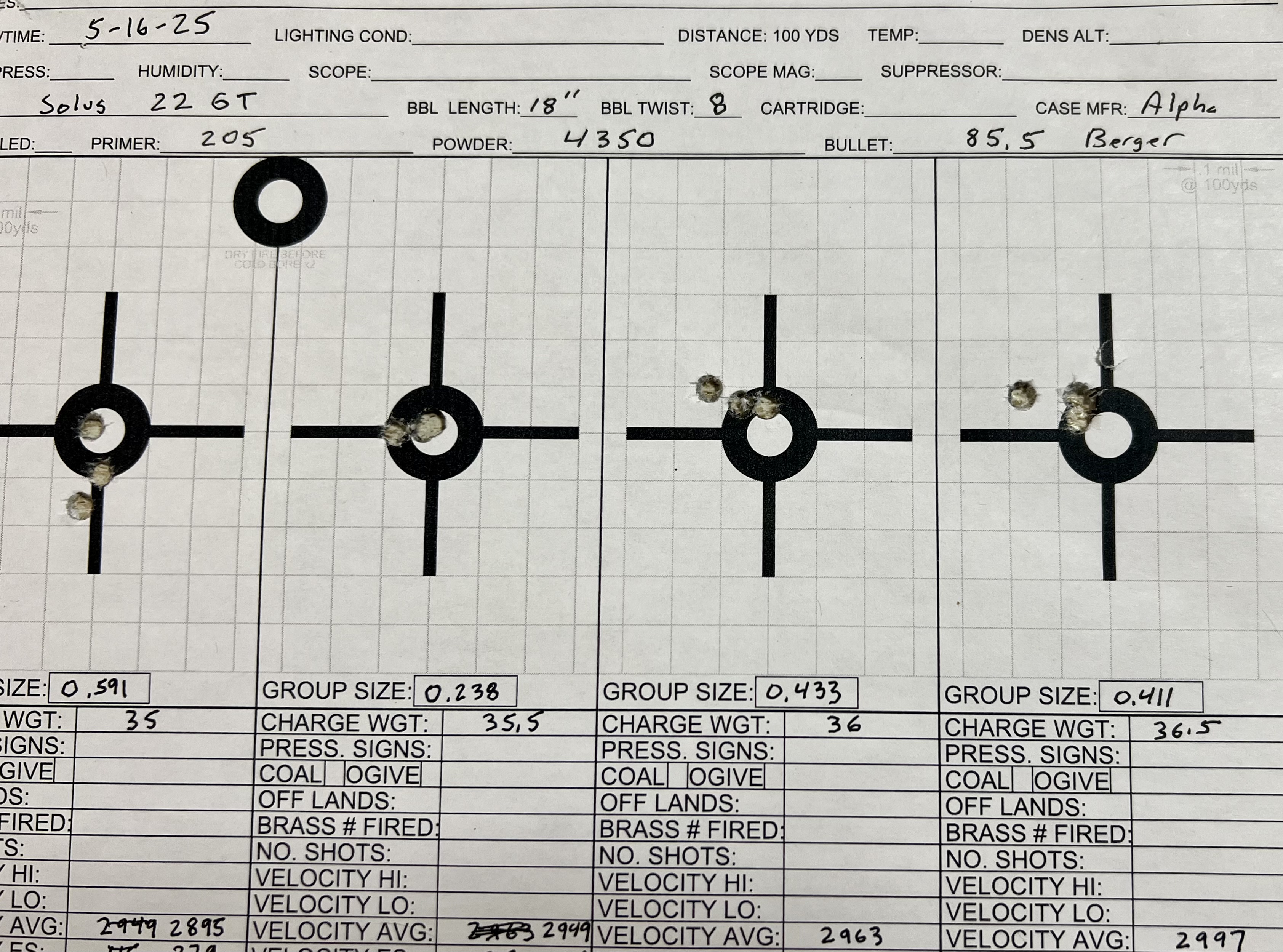

Tested out my first loads with the 22GT today. 85.5 Bergers with H4350 in new alpha brass. 18” bbl. Didn’t see any pressure signs on any of the loads.
I saw someone here had issues but wanted to give N150 a try. Has anyone got a decent ladder work up for N150 either 85.5 and 80.5 Bergers?
80gr eldm and N150 was stupid accurate in my rifle. N150 just fouled so heavily so fast, I went to H4350. 33.7gr jumping 45k was stupid accurate, running 3150fps from a 22in 7.5tw.
