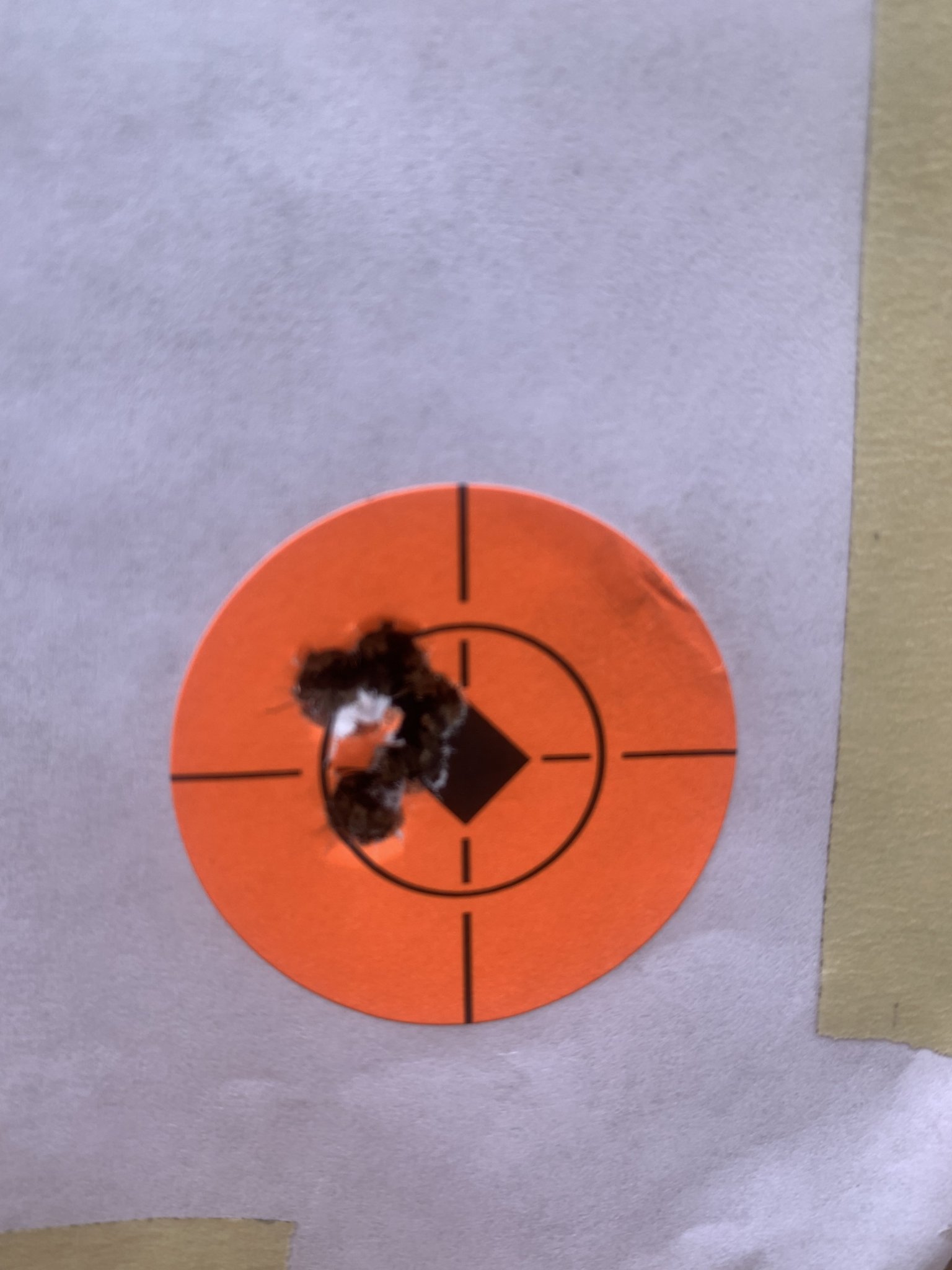

Very new to 22GT but managed to squeak this group out a couple days ago. Loaded up 5 each in .5gr increments from 33-35gr. H4350 cci450 and 88eld loaded in virgin necked down GAP 6gt brass. After fireforming I will explore that load a little more. Pictured group was shot with 35gr, didn’t chrono any of the ladder loads. But the fireforming load of 34.5gr is averaging 2925fps out of the 20” suppressed barrel. Also plan to try 4831sc

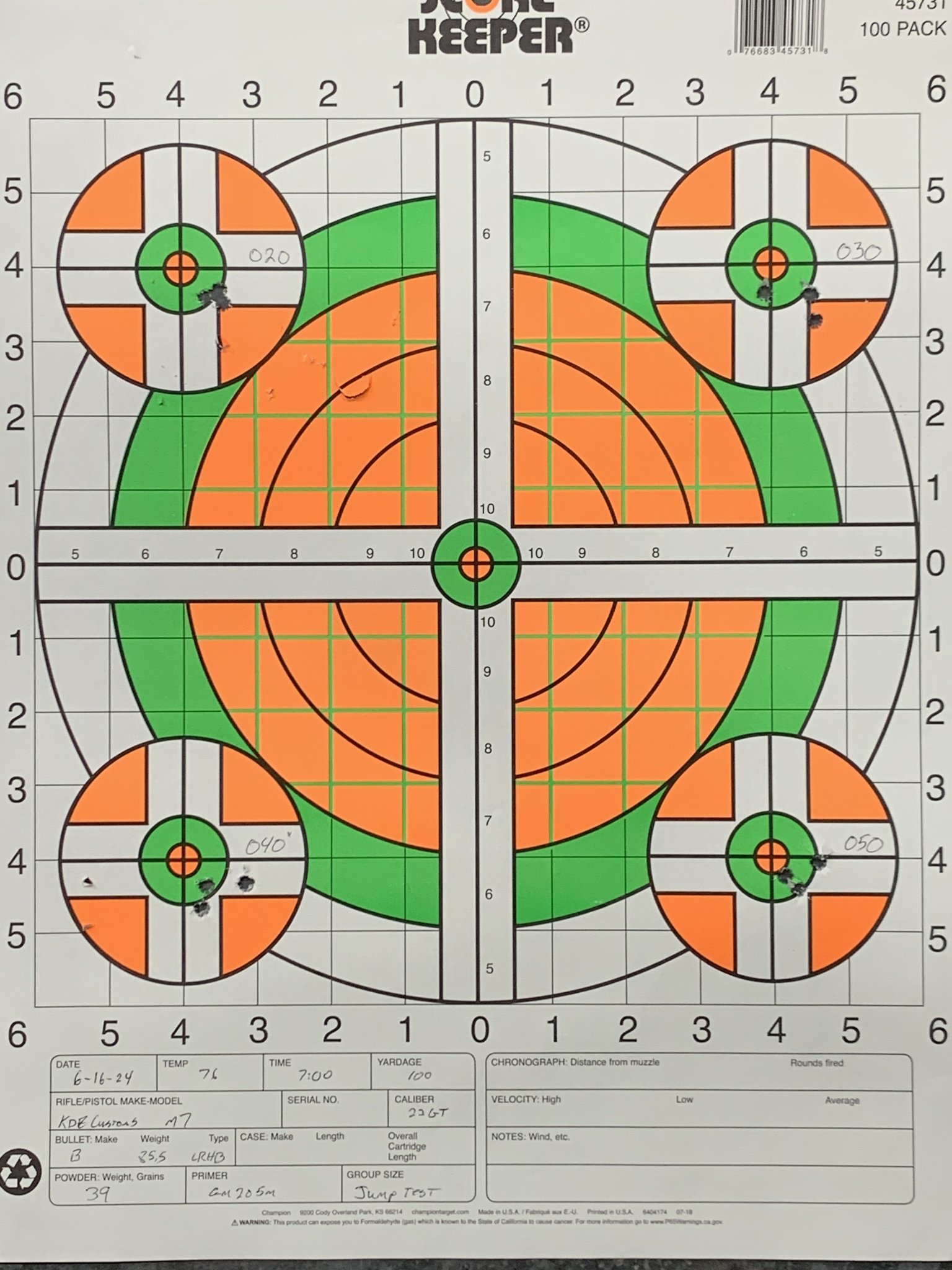

I’m running a 20” proof .118” bore 1:7 twist barrel on my KDE Customs m7 build. I chambered the barrel with a over sized reamer, by .002” in body diameter with a .169” fb. I increased head space by .007” to increase body length and shorten neck.
I’m working on load development using alpha brass, berger 85.5s, gm205m, and IMR 4831.
Built my own bushing in the seater die and bushings and expanded in the sizing die, running .003” neck tension.
I started with 33g and worked up to 40g.
First 33g-38g were .010 jump to lands, one round each. First rounds through the barrel.
80*f day
33g. 2640
34g. 2757
35g. 2847
36g. 2909
37g. 2971
38g. 3070
Below are .020 jump to lands, two rounds each.
85-90*f day
38g. 3066,3037
39g. 3143,3137
40g 3200,3204
Took 39g and loading three rounds each at different jump distances. Will shoot them in a ladder test sequence.
.020
.030
.040
.050
Hope to shoot this string in the morning. Will post results once finished.

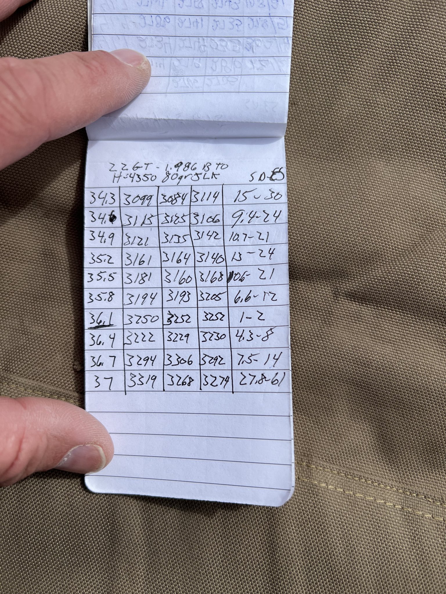

I have noticed my groups leave a lot to be desired with any charge below about 35gr of h4350. 35 and 35.6 have produced a couple .5” 5 shots groups. It would appear most using h4350 are using ~35-37ish grains which is 1.5gr+ above the published Hodgdon data. I know lots are not seeing any pressure signs but what’s the deal with most having to shoot that much over book max?

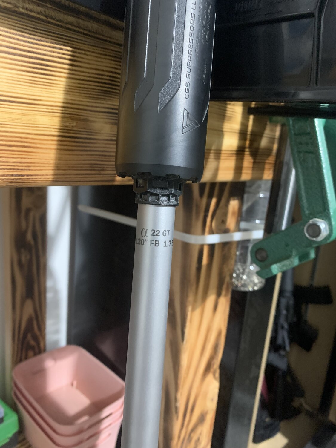

I will say my barrel (suppressed 20” 7.5tw .219 bore) seems to be a little on the faster side given that it’s giving me about 3000fps with 34.6gr of h4350 with 88 eld’s and cci450s. Just recently got some alpha brass I’m playing with, most my info is coming from hornady brass up to this point.
Again I’m very new to this little round and so far have really liked it but it’s just got me curious.

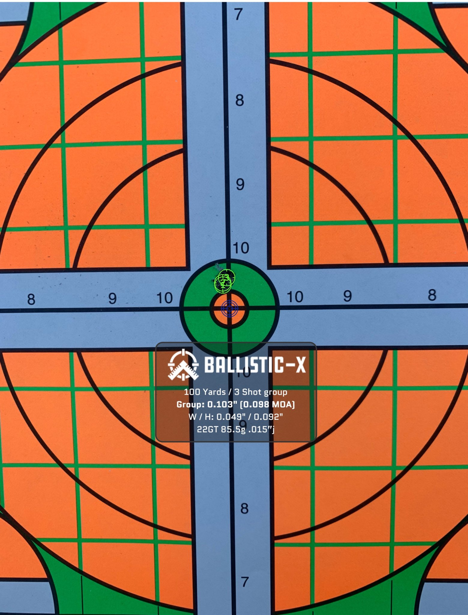

Got to shoot a few rounds today with a Garmin by my side. Not mine, but definitely getting one asap.
With virgin brass 5 shots averaging 3150 fps.
With a 320 yd zero.
At 200yds hold is 2moa down, 500yds hold is 4moa up.
Shot one round at 500 corrected for wind and shot two more. Those two were under .5moa. Went to 200 and shot two, they cut each other in a .092moa.
Hoping to get out this weekend and shoot 3 shot group at 200yd, 500yd, 800yd, and 1000yds.
So far it’s looking promising.
