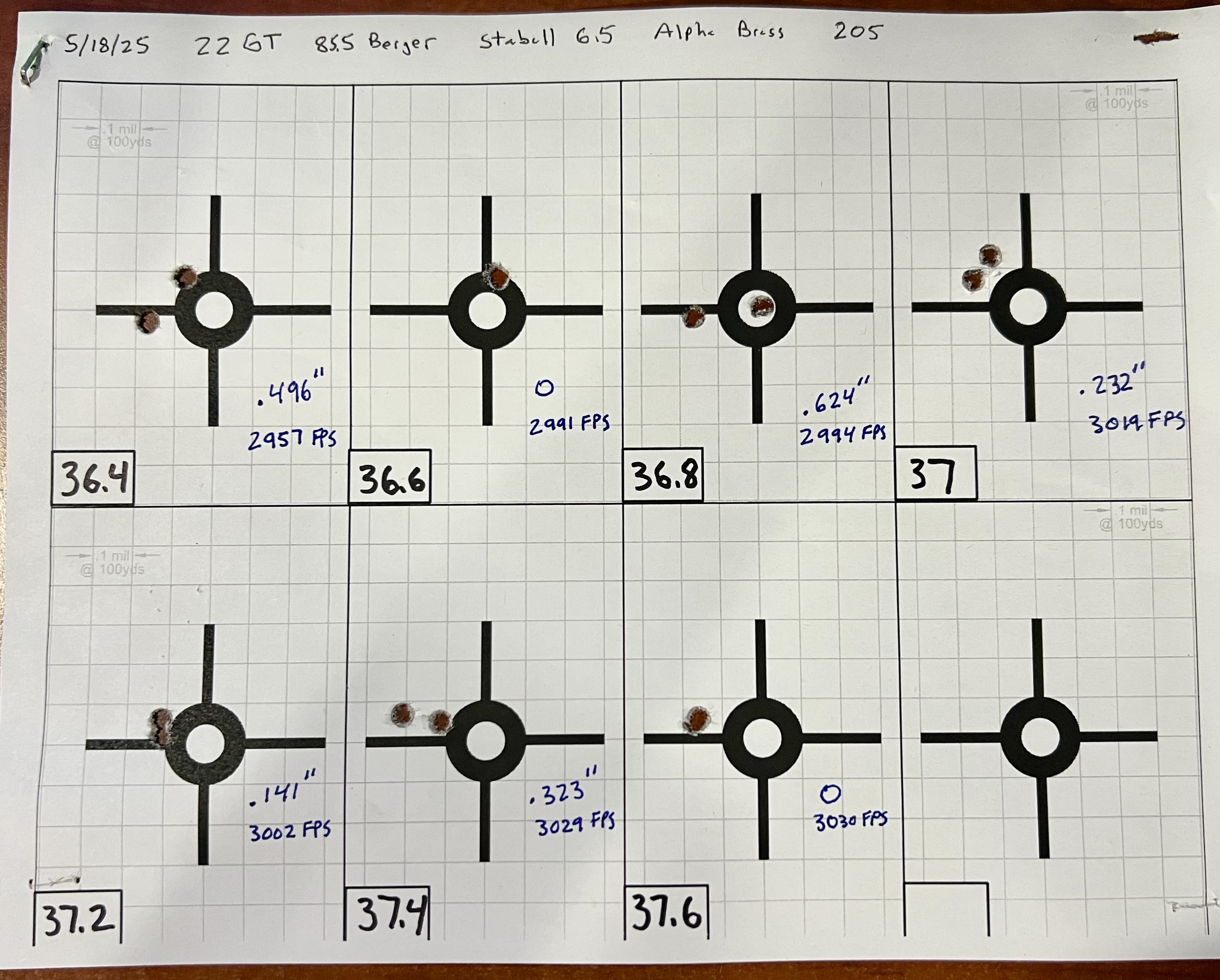

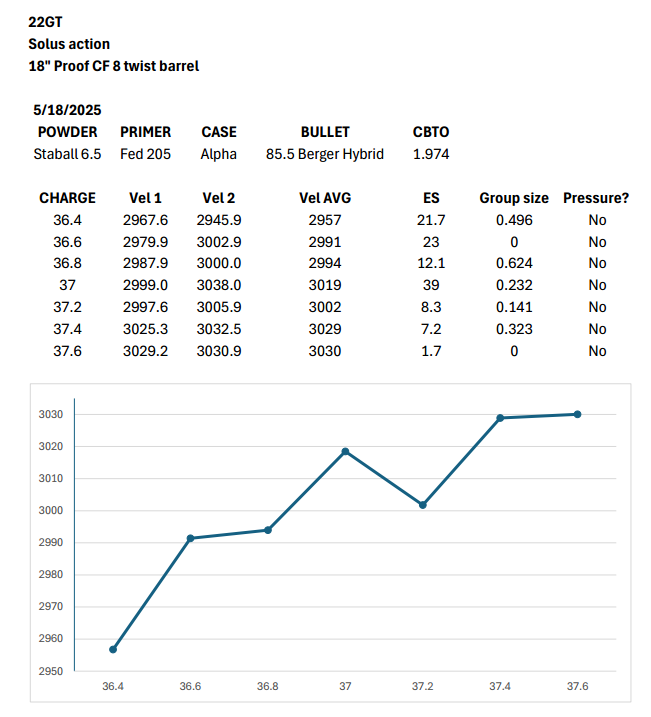

Did some testing with Staball 6.5 today. Looks very promising - better groups, SDs, and faster than I was seeing with 4350.
