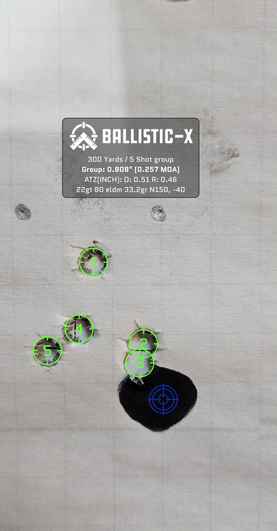

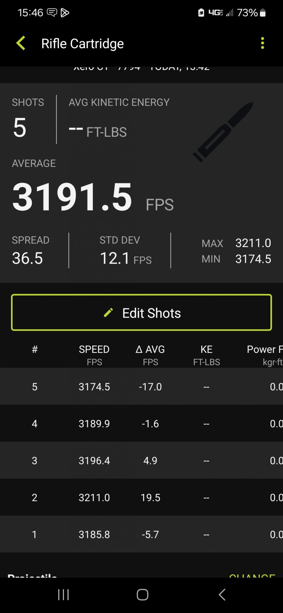

My second 22gt barrel is more varmint/utility rifle, 120 freebore, 7.5tw 237 bore hawkhill finished at 22" in Bow4 contour(small shank 3B essentially). It's cut to tl3 tenon but running it on one my origins with HLR recoil lug. Ultra7 supressor.
33.2gr N150 with 80eldm at 40k jump, they usually run 3190-3200. This 5 shot group at 300y is tiny, but es is crap!
