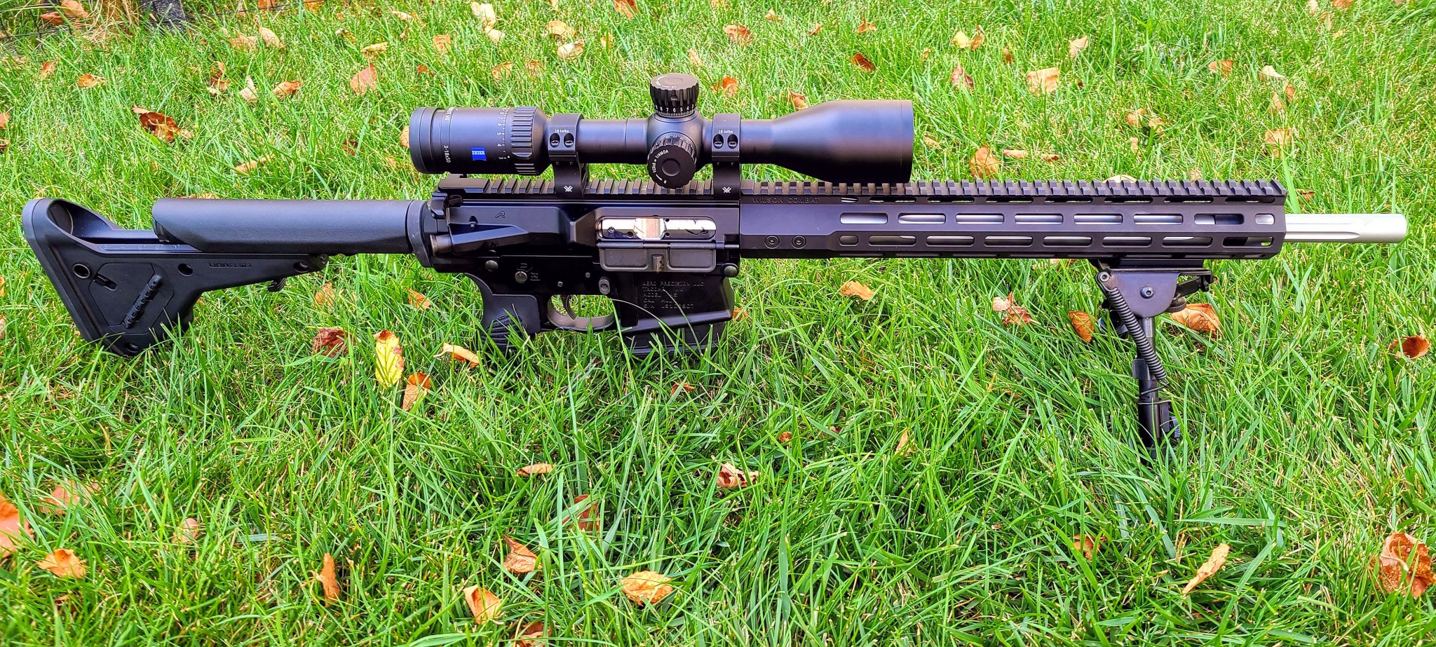

    I'm not sure if anyone else has suggested it yet, but how about a 6mm Creedmoor in an AR10? It has better factory loadings than the 243 as far as match ammo goes. Yeah it's probably overkill for 800 yards and in but so are any of the other options.
    The 6 Creed vs 243 is an interesting proposition in my mind. I have a 243 AR-10 and would not want one if I didn't reload. The vast majority of factory ammo choices for it are hunting focused and quite frankly terrible for at distance stuff. It's not like you're going to get some GMM for it unless you want ones with Game Kings. The price compared to other similar function ammo isn't terrible once you get out of cheap surplus land which the .308 likewise wins hand down. Then again I've seen 243 on shelves I have seen zero 308 lately.
    From what I've read about 6 Creed you should really have a +2" gas system with it. If I bought another 243 barrel and had the choice I'd probably do +2 gas with it as well so I could run slower powders and a 7.3 twist for something like 115 DTACs. That said the initial testing I've done with mine looks good in allowing for slower burning powders (just not super slow like H1000, Retumbo or Magpro.) Looking at Nosler's site they're saying a 40ish FPS difference at most in the win for 6 Creed. Not a huge swayer in my mind.
    In an 18" gun with a rifle length gas system it's a kitten to shoot, lots of fun (my 8YO loves it,) accurate and reliable. I can say I've had one FTE in it ever and that was a book minimum reload which means it was probably under gassed at that point. The fact that I'm running PMAG 25s and have zero worries of anything Creedmoor specific being required would also be a huge boon in my book. I want to try a D50 for shits and giggles once but don't want to just burn up 50 rounds of ammo or barrel life to do such. ED:I also forgot to mention it was reliable with 58-105gr ammo, it just eats ammo up and doesn't care.
    Re:Body armor no idea, it's interesting to see the tests though. I'm kind of surprised about the inability to punch through. That said if cracked ribs are a real issue there's always the old fashioned method which is a 12ga or perhaps if you're into new age some heavy 458 SOCOM or 450 Bushmaster rounds.

    I have built every version of the 308 parent case AR, except for the 6mm Creedmoor. That is about to change.
    I would not build a 243 unless I could find a 8.5 or 9 twist barrel and then I would not even consider a 308. With that said, I would build a 6mm Creedmoor if you intend to shoot heavy for caliber bullets.
    Which ever you choose, make sure it has a Slash's HeavyBuffers.com buffer kit in it and cyclic issues won't be an issue.
    My mcgowen barreled 1:8 twist runs great with a standard M4 buffer/spring setup. It's soft, like Drake soft. Fixed gas as well.
    Why 8.5 or 9, we have been using 8 twist barrels for 12 years with 105s and 108s. I think the 115s and 17s need a faster twist and the 110 SMK definitely needs a 7 or 7.5 twist?
    That is even better if you are going to shoot nothing but those heavies, that is why I referenced the 6mm Creed since both would have to be reloaded.
    There are just not enough fast twist 243 Winchester barrel manufacturers out there, most are 10 twist, but most every 6mm Creed is a much faster twist

    243 is a hard thing to find in an LR308 build honestly. 6.5 Creedmoor took over the world pretty much and 243 stuff went away by and large. That said the Midway barrel above was 8 twist. I would be hesitant to have a 10 twist unless factory ammo was a requirement. My Mcgowen barrel was something like $250 on a Black Friday deal and $300 without flutes now. Well worth the cost to get what I actually wanted. Next one will be fluted, 20", 7 or 7.5 twist and +2 gas I think.
    As a question to the others here who have had it, what's the heaviest weight you've gotten away with at 1:8? I am shooting 105s right now but haven't taken them to a decent length range, nor have I tested heavier. I was tempted to grab some of the 115 DTACs that seem to be sprouting up for sale in the PX to play around with but an not confident they'd stabilize especially in the short length 18" barrel. I think I'd wind up down about 225 FPS compared to a 24" barrel based on what I've seen online and I just don't think that's enough spin to give the super heavy bullets a fighting chance although I'm open to being told otherwise.
    I have a Dracos barrel on my 6 Creed. Its a 22" 9 twist, but they claim that it behaves more like an 8 twist. At 2900fps I don't have a problem stabilizing the 105's. I have also been curious about the 115dtacs as well.
    From everything I've read people run a 7.5 at minimum for the 115s. That being said, I remember reading an article from Dave Tubb himself saying an 8 twist will work. I believe it was on 6mmbr.com if I was more savvy on snipershide.com I could attach the link.
