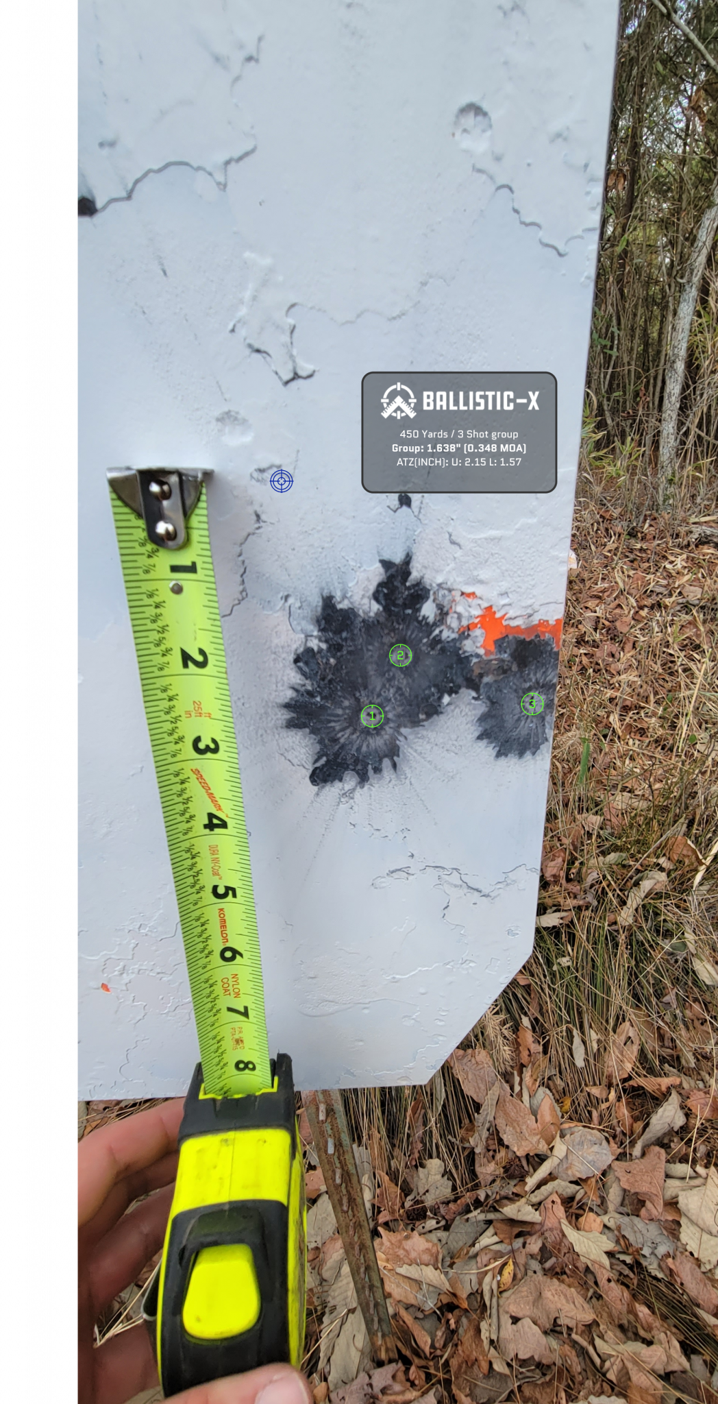

I know there's plenty of discussion about the 25 cal stuff, but I just wanted to share my brief experience thus far. I put a 25 Creed barrel on my TL3, Proof CF. I like playing with calibers, and I wanted to see if the juice was worth the squeeze. All I could find were the Berger 135 Hybrids as Blackjack seems to be in disarray. First off, load development was very easy. I found several accurate loads after work up, but settled on 40.9 grains of H4350 in a Lapua case. It shoots around a 4 SD, and consistent sub 1/2 MOA groups right at 2,800 fps. I haven't done any seating depth testing, and really don't plan to as well as this shoots. In any case, I try not to dwell on 100 yard groups any more than necessary.
I was able to take it out to 800 yards and true it up. Number one, I had about an 8-11 mph crosswind going. I held .2 off the left side of the plate and hit. My three shot group had virtually zero vertical. Shot it at 300 and 400 on prairie dog target and right edge hold nailed center. This thing is truly a laser. I know there's a lot of questioning the validity of the bullet and if it will gain popularity; my opinion is it's the perfect bullet for the Creedmoor case. I've loaded and shot a ton of calibers in competition, and in the early stages, it's really working it's way towards my favorite.

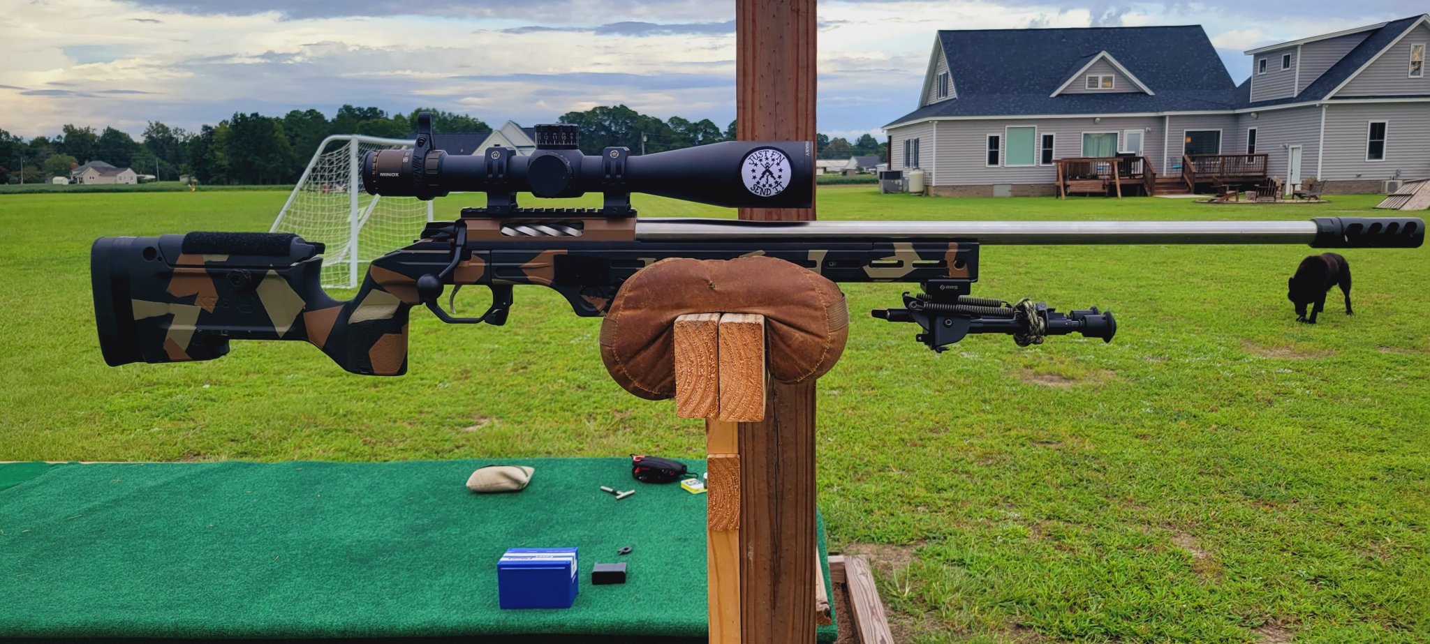

I’ve considered building one. I have a 6 creed and love it dearly. I have a 22 creedmoor as well and I’m very impressed with it. It’s a laser beam and is easy to load for.

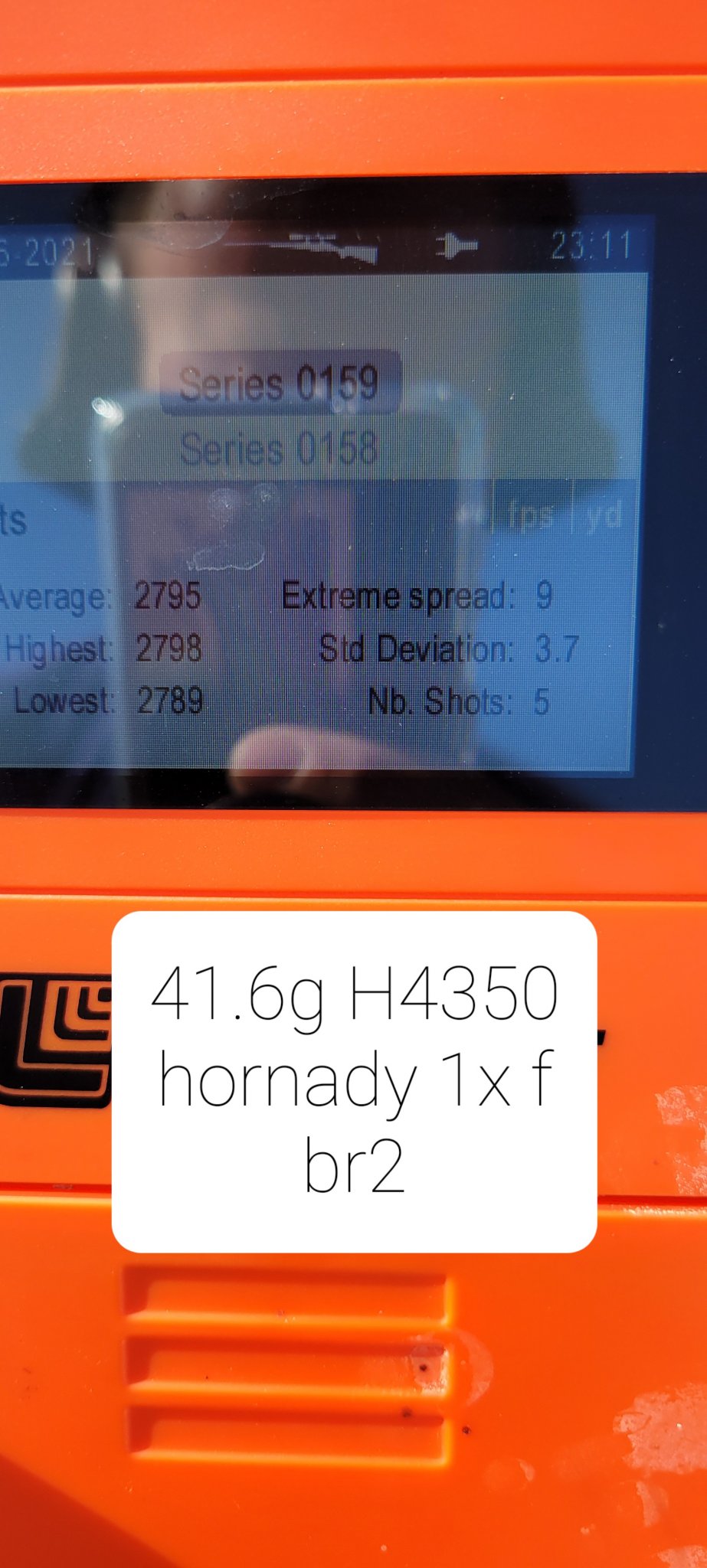

I run my 25cm with 135s @ 2890 w/ rl16 in peterson brass, cci450s. Shoots pretty good, consistent half moa or better. 131s were slightly better in this barrel, but I've been out since July 21. Had to sideline the barrel till bergers came available. Sierra will eventually run the 131s but at their convenience. I heard datcs are in production now. Sierra has really fucked with people on this. Shit business ethics for sure. They'll just say, oh but govt contracts to fill! D-bags

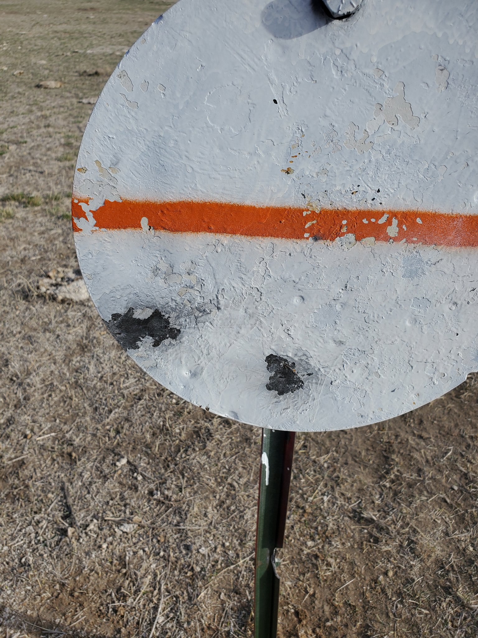

I really like the larger bullet for field matches than the 6mm stuff because you get more splash feedback on a miss. That 131 carries a lot of energy so there are very few times you have a questionable call on plate. The 135s are good, but I will say I noticed a bit of jump sensitivity with them as they were shooting 2" groups from my NRL Hunter rifle. Once I tuned in the jump around 0.020-0.025" jump they shrunk down to clover leaf groups.

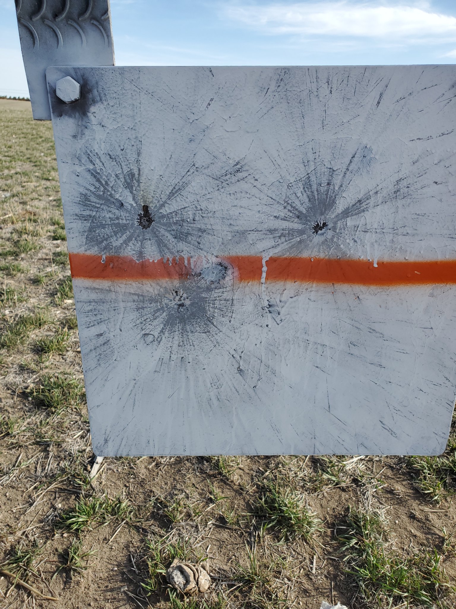

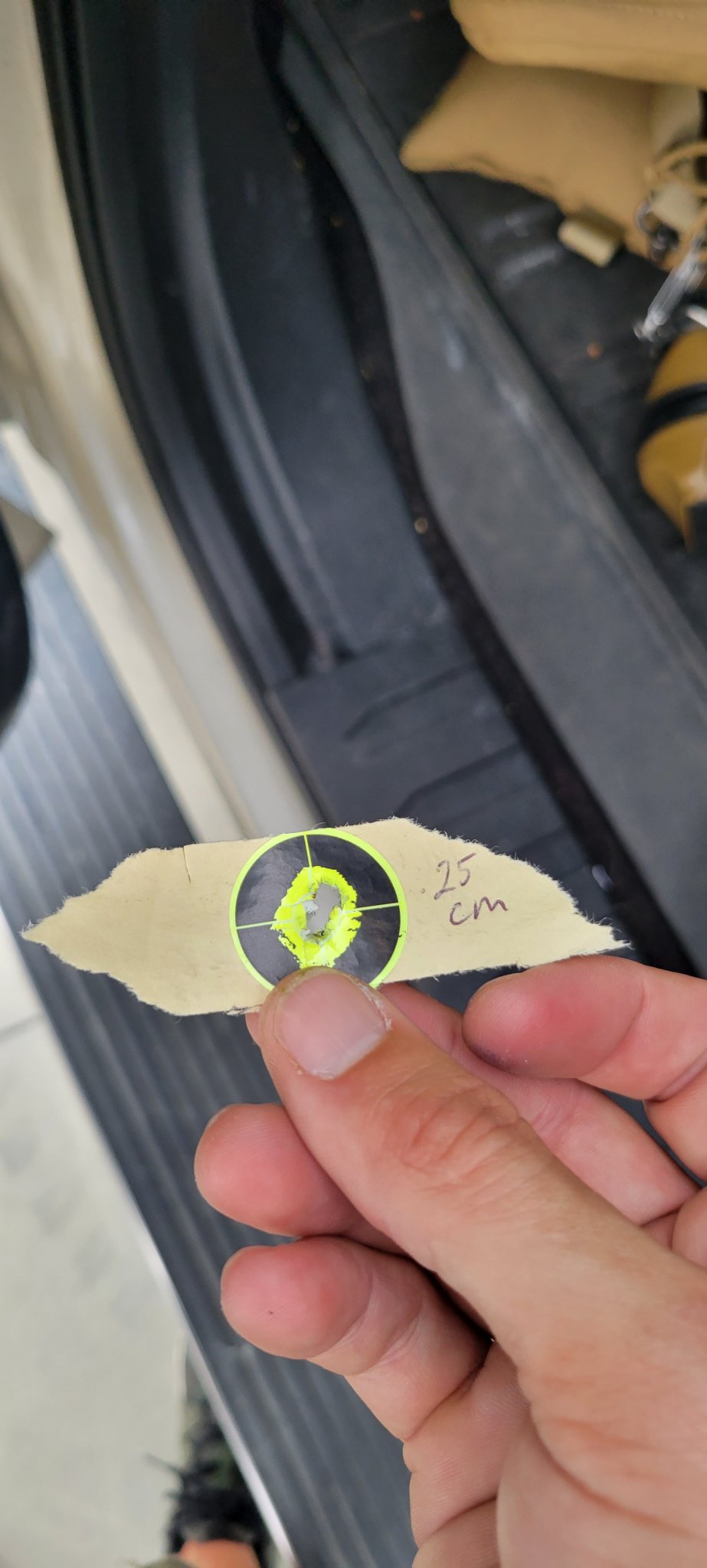

Threaded my 3rd 25cm barrel, but this one is a hunting barrel on my tikka. Screwed it on, bore sighted, shot 1, adjusted, shot 2, slipped turret, shot 3 off the dot. All with a random ass charge weight and some shitty 100gr Nosler Spitzers. Well it groups at 100. I'll shoot 100 of these total and work up my loads for the 133 berger elites and 117 PVA Cayugas.
