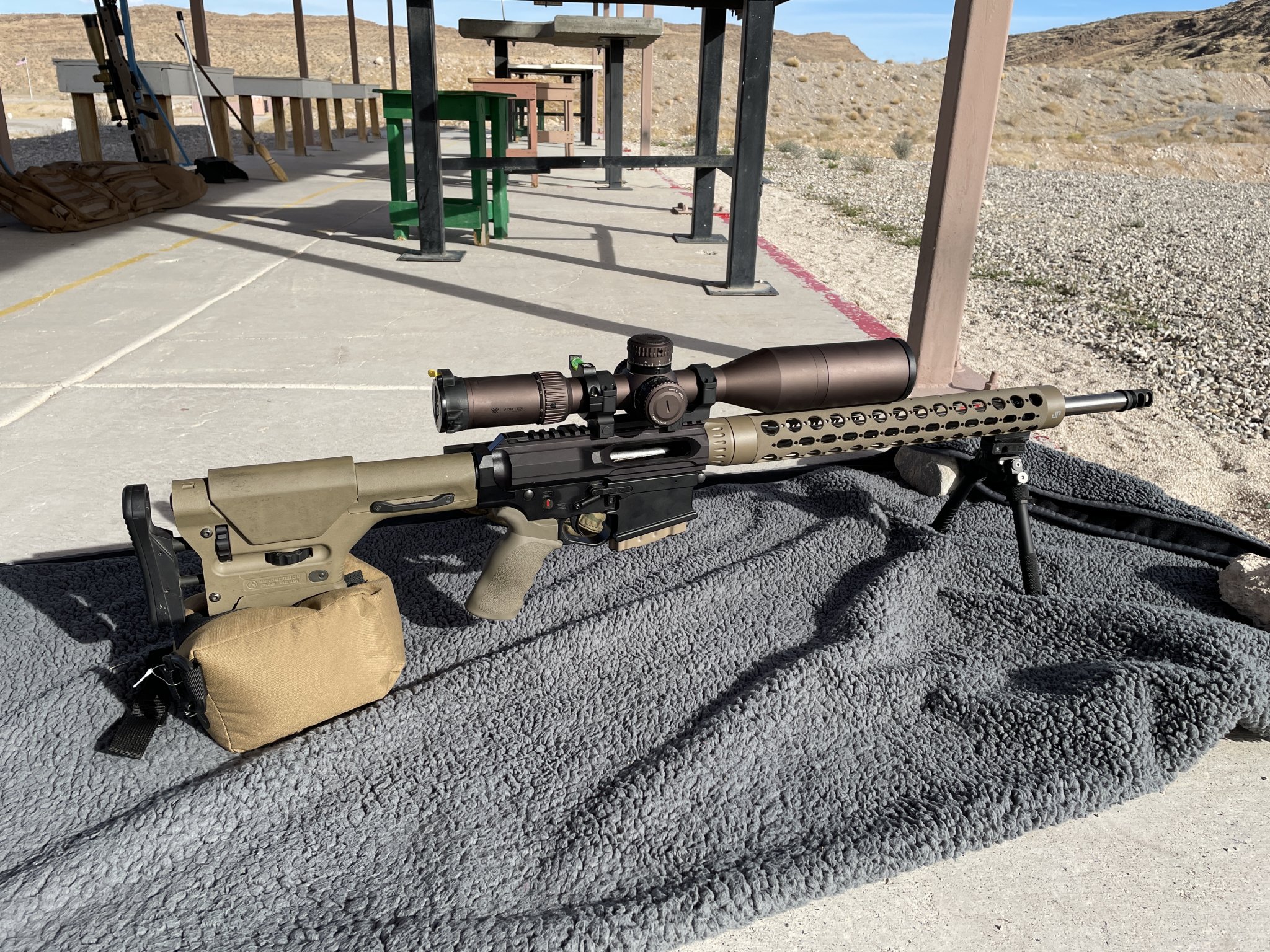

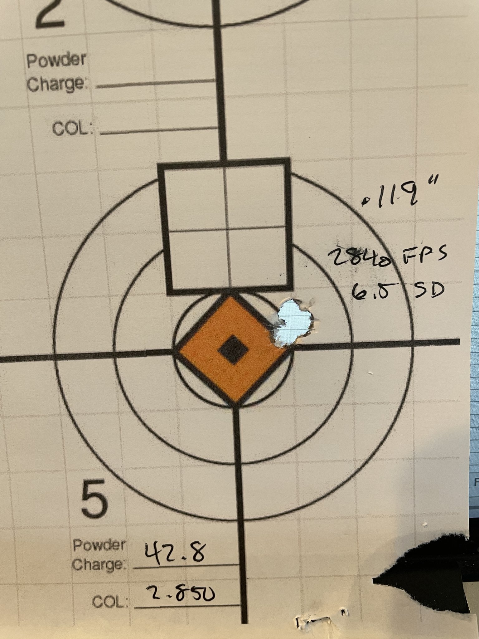

I've been working hard over the last week to get a load developed for my new .260 Gas gun upper I just built. I think I'm stopping here. ;)
22" JP AR-10 barrel (unsuppressed)
130 Berger AR Hybrid OTM Match
42.8 H4350
Lapua Brass
Fed 210 primer
2.850 OAL
2840 FPS
SD 6.5

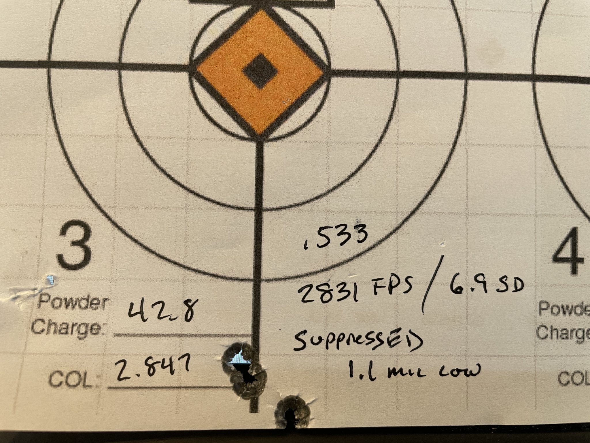

I went back and reshot it today @ 2.847 because 2.850 are not reliable in my ASC Mag. The accuracy repeats pretty much the same. It was really windy this afternoon, 15 gusting to 25, so not ideal for a retest - but it repeated.
Here is the same load @2.847 suppressed (TBAC Ultra 9). It shot about 1.1 mil low from unsuppressed POI.
The wind was buffeting the gun, so I lost the one round low. I eventually had to shoot prone for the rest of the day as the wind gusts were shaking the bench to much.

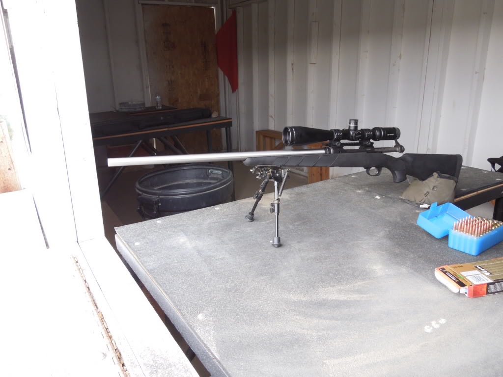

Finally got to shoot my .260 last weekend. Love that little cartridge. I've shot the .308 Win for so long, I'd forgotten how nice the .260 shoots.
I still have more load development to do, and will post up my results with IMR 7828 SSC and Nosler 140 RDF and Berger 153.5 Hybrids.
