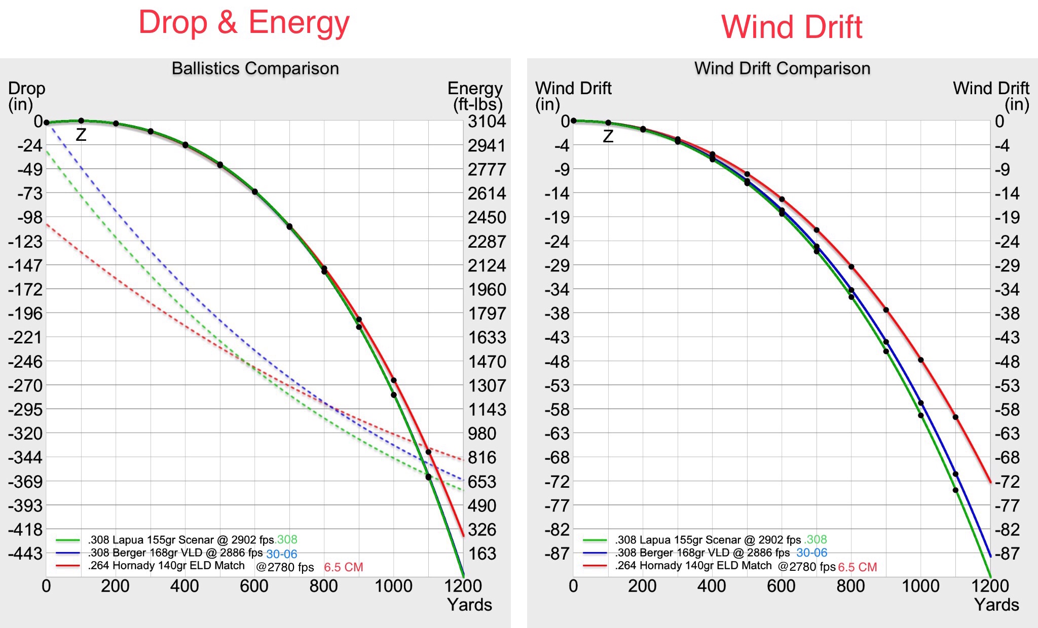

Here are my ballistics showing my 24" 30-06 Shooting Berger vld hunting rounds over h4350. 24 inches is plenty.
Reactions: RandyG
